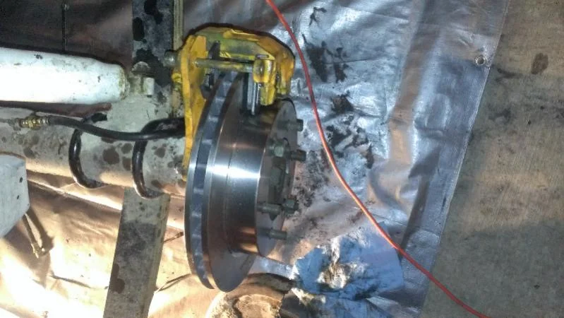

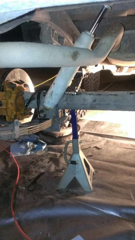

Rear disc and super happy

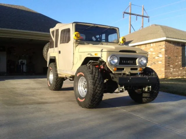

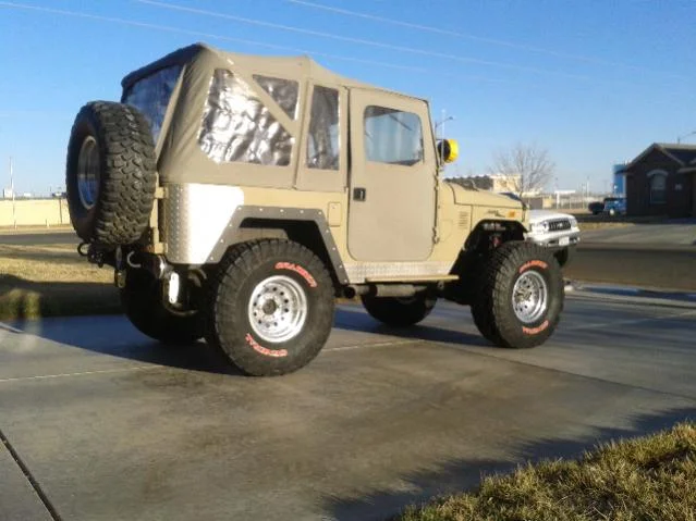

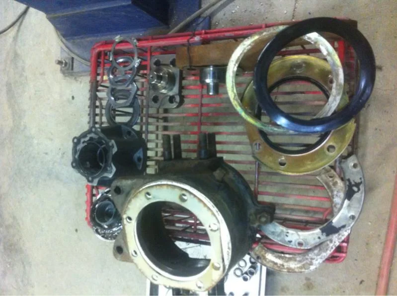

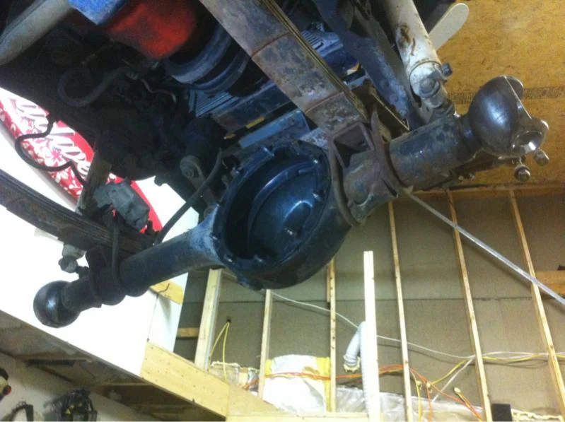

Rebuilt knuckles, new frame to axle brake hoses,
completely rebuilt all 4 spring packs, moved the rear axle back 1.5", added 2.5" shackles with degree shims on the front for caster and put some new 35s on it.

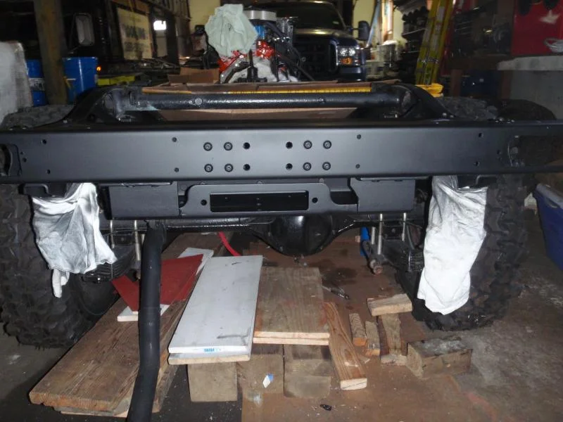

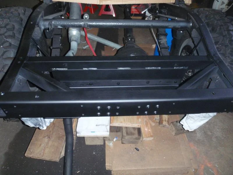

Which winch are you going to run?
ElHefe, I Bought a 9000lb Warn for the front a couple years ago , Then heard great things about the HF winch. So I bought the 12000lb for the back. As you can see my biuld process is a little slow, The longer I take , the more I dream up Silly things to do to my 40.:D Also got some Synthetic Line from Southeast Overland (eventhough on the forum) He knows his stuff.
