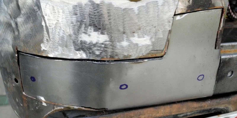

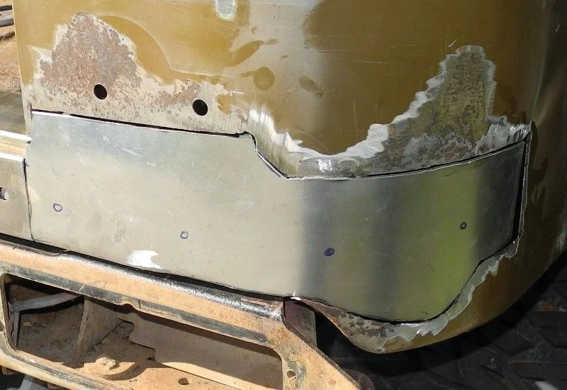

Wish me luck all, I'm going out to weld these up:

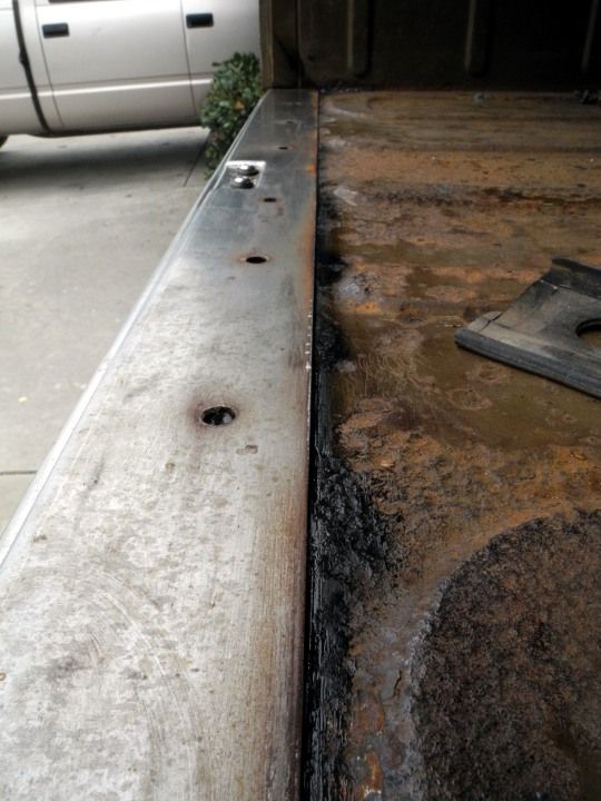

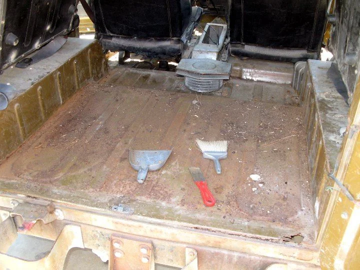

I wanted to do the sill with adhesives anyway, so I got my wish.
This is a lot more like how a new car body would be put together and the adhesives will keep water from between the metal layers. I repaired my bib this way on my '78 too.
The rusty floor is pretty solid other than just a couple little spots, so I'm repairing those and I'm going to coat it with something, maybe color-matched Monstaliner.

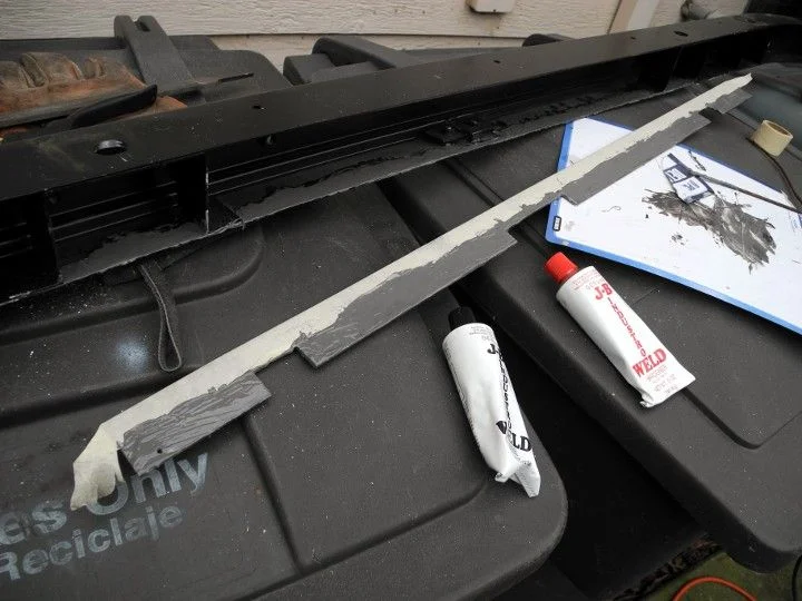

I added a 1.5"x1/8" steel 'shelf' to hold up the floor. JB Weld and rivets on this side.
attachment.php

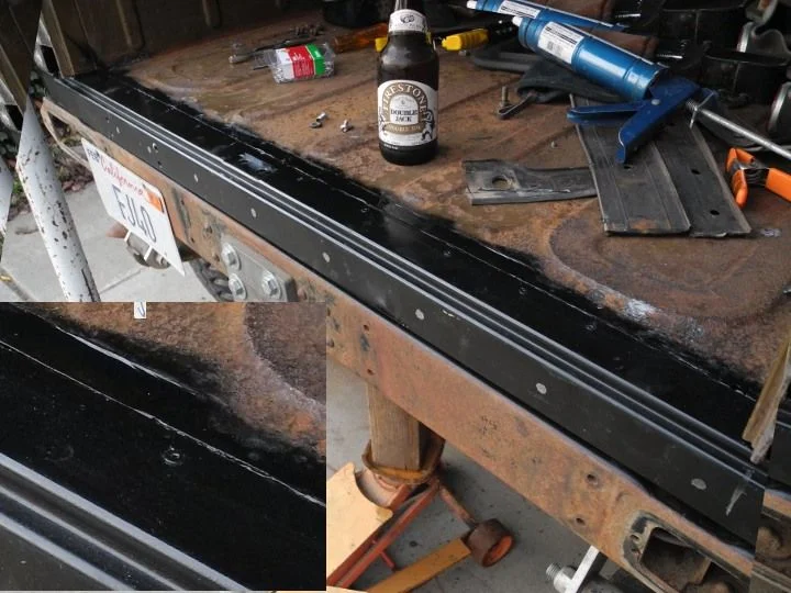

I didn't get a picture with that piece attached but not yet installed. I rushed through painting it so I could get it installed before dark. Here it is with just the sill brace installed. You can see the rivets where the other piece was attached underneath. There is FIPG between the floor and the added steel to keep any noise or water out. I decided I didn't need rivets on this side.
attachment.php

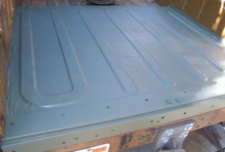

Then I stuck on the sill with FIPG. It will still get tacked at the holes and welded to the sides of the tub where they intersect and the body panels when they get welded up. I'm ordering my welder today. Tired of counting on others for welding.
attachment.php
