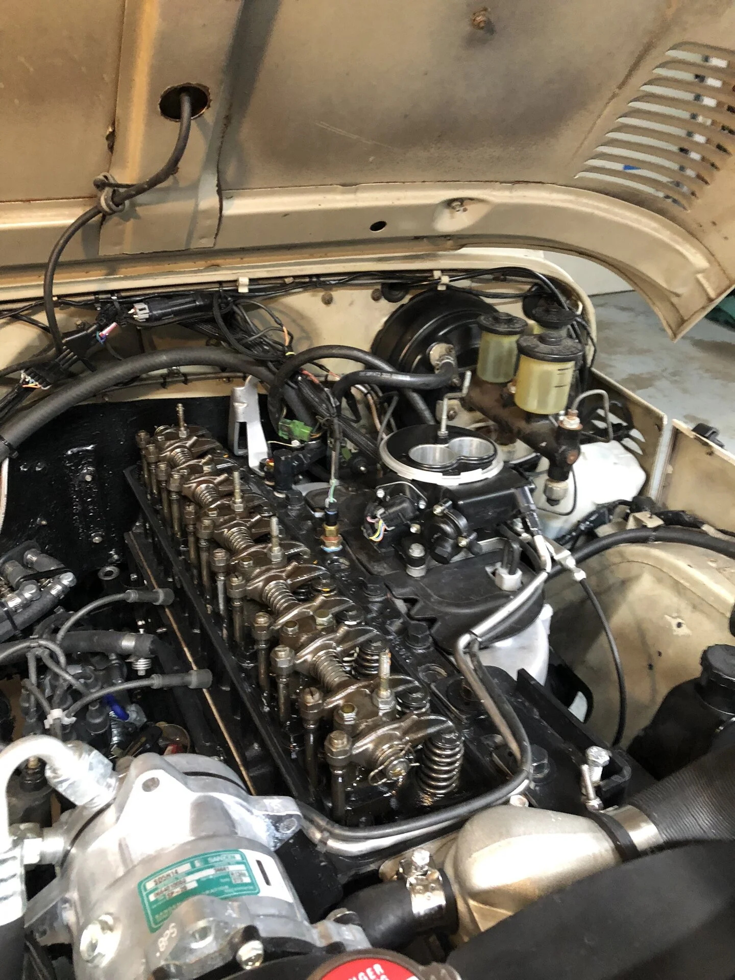

Got the valves adjusted…. Some were a bit loose, one a bit tight and some were just right. But I know they are now good to go for awhile.
She still idles a bit rough, which just started in the last month or so…. Working my way down the list - new plugs, new distributor cap/rotor, (plug wires < 1yr old), reset the timing, re-torqued the manifold and carb bolts ( thinking it might possibly be a small air leak), and even tinkered with the Sniper settings a bit… but no solution so far. Will probably go ahead and replace the fuel filters so I can check that box as well.
But she runs great at rpm >1000 with plenty of power (although “power” is a relative term on these 2F’s 🤣) which still makes me think it might be an air / vacuum leak somewhere.
Help Required.... Any Suggestions?

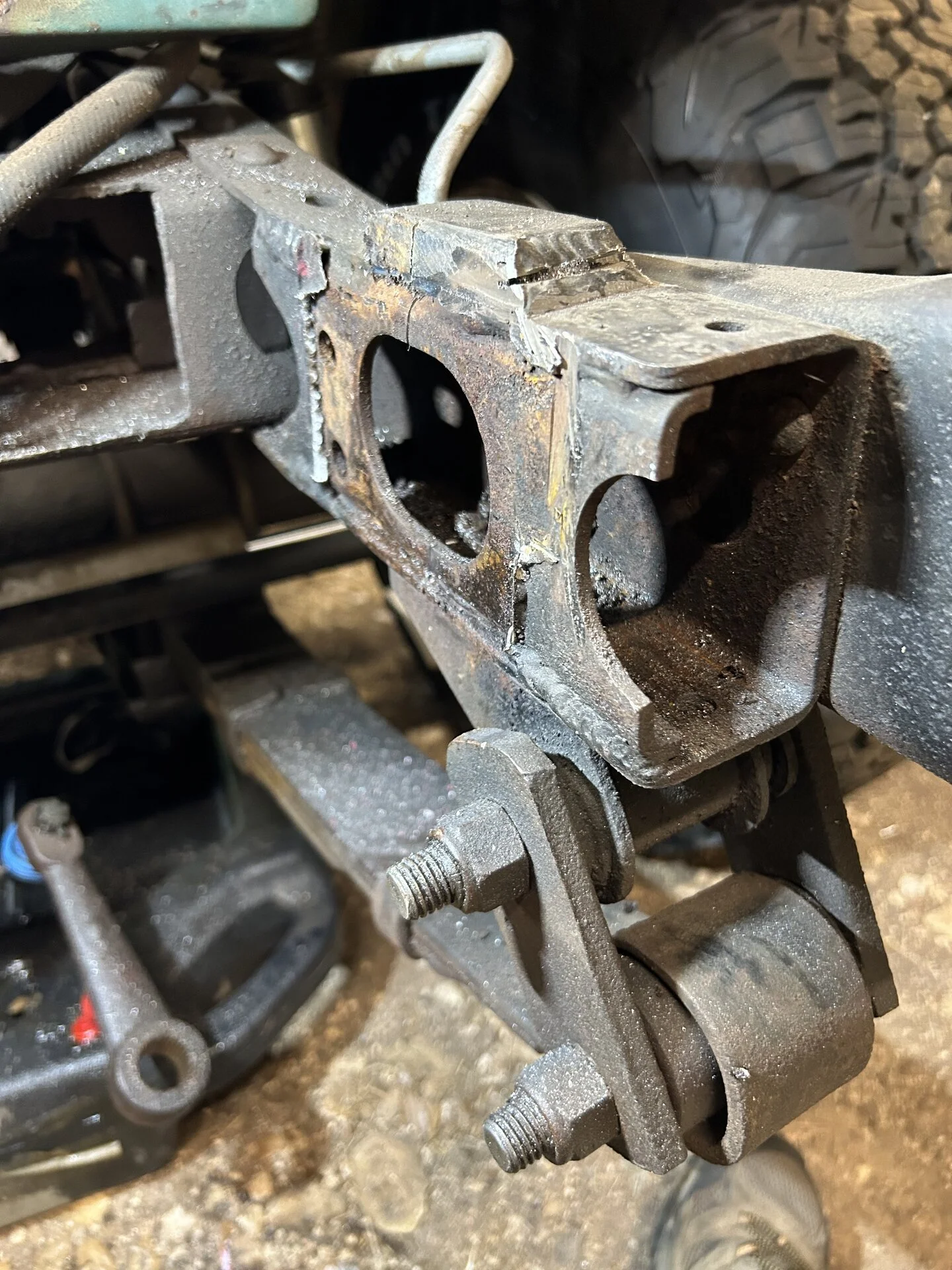

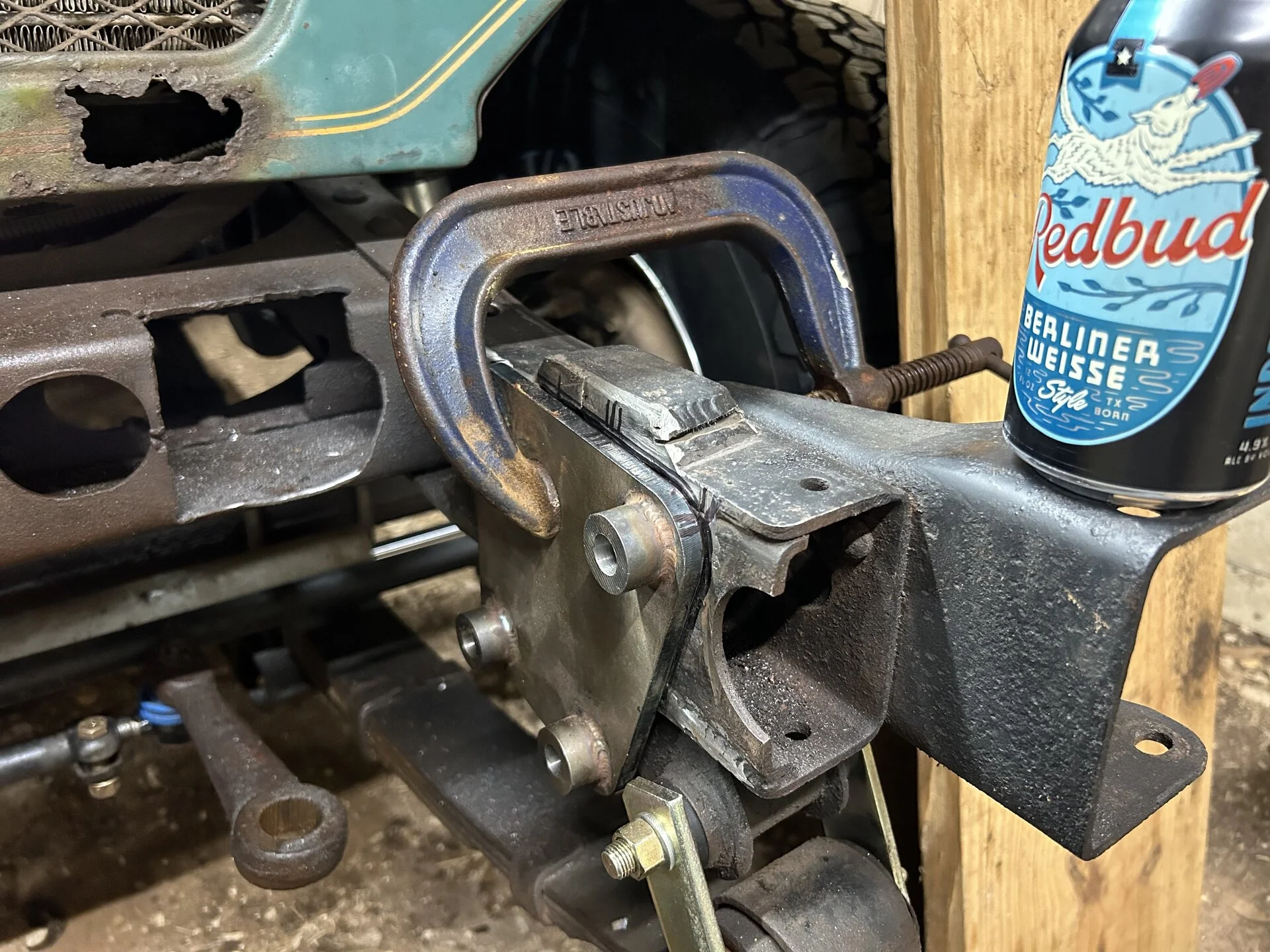

Power steering overhaul continues with redoing the box mount the ignorant PO (in this case that’s Present Owner 🤫) erroneously welded on.
Horn almost all cleaned up, damn that thing was really welded on there…
Plate position mocked up. I am not responsible for the gaping maw in the frame but I am on the hook for how to elegantly fix it.
