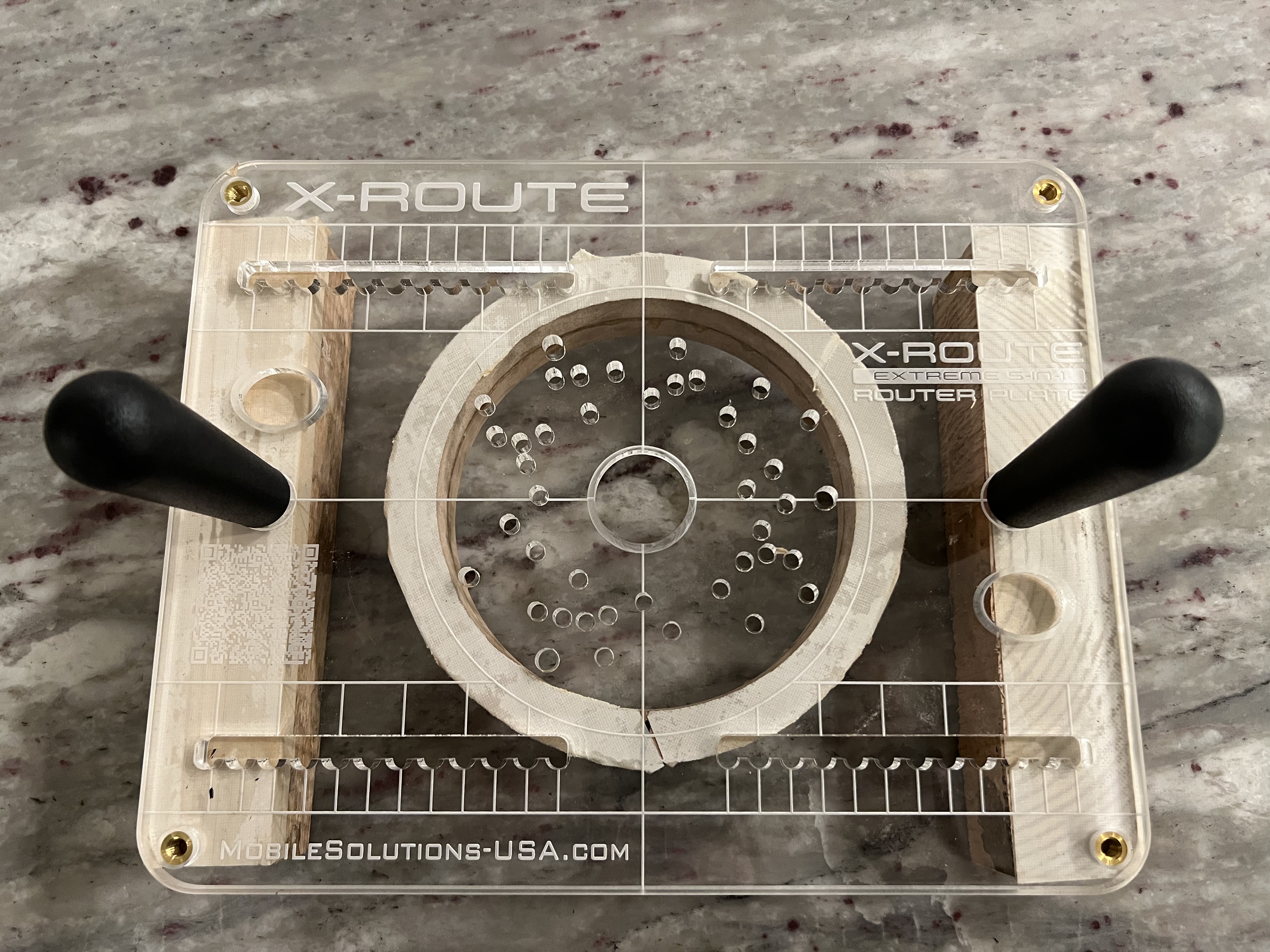

Since I'm using JL audio C600s, I needed to find 6" rings which are very hard to find. Lots of 6.5" rings. Founds some carpeted ones that I stripped off. The rings were 3/4" thick and I need 1 inch stand off, I stacked two and glued them together.

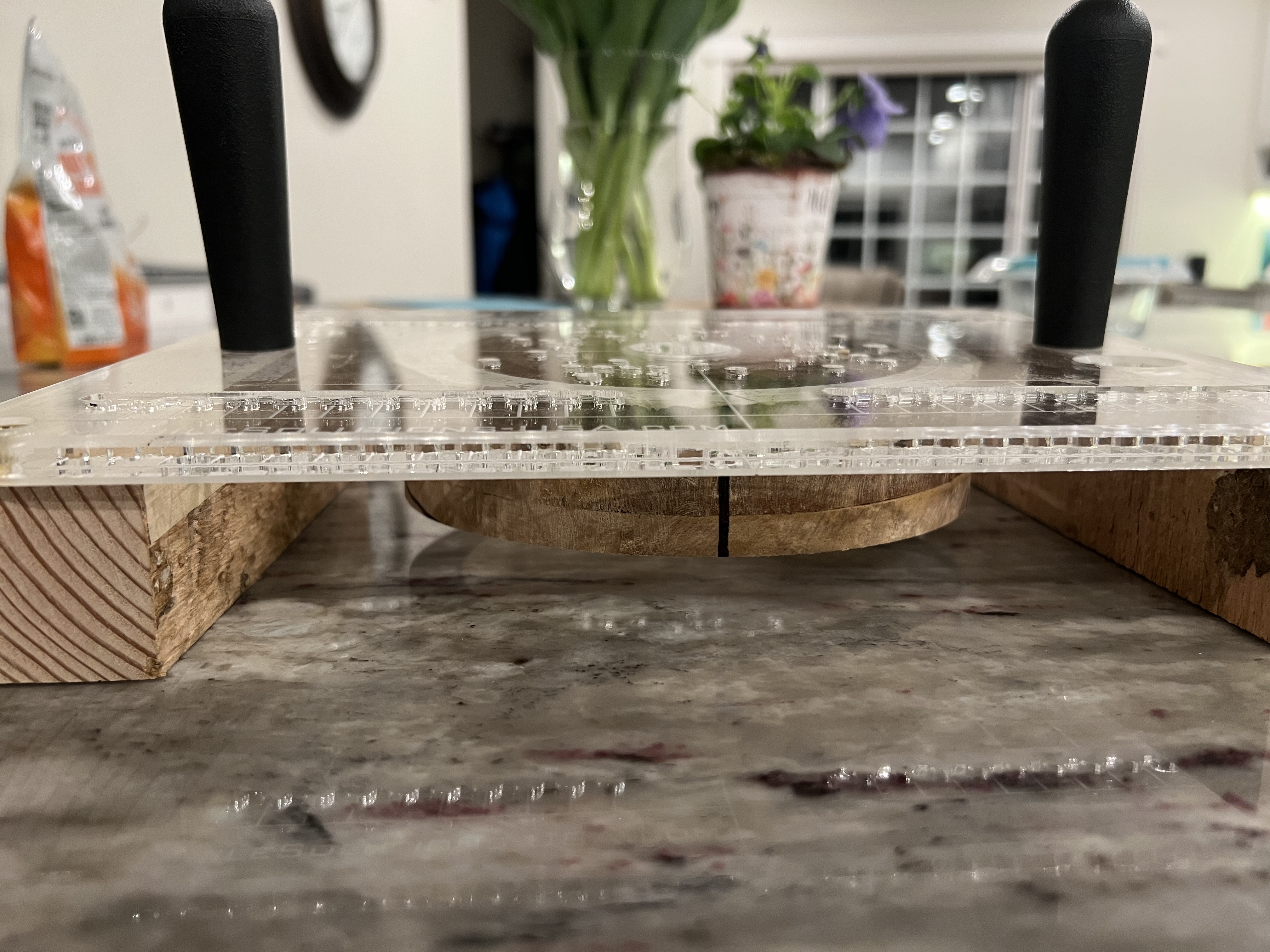

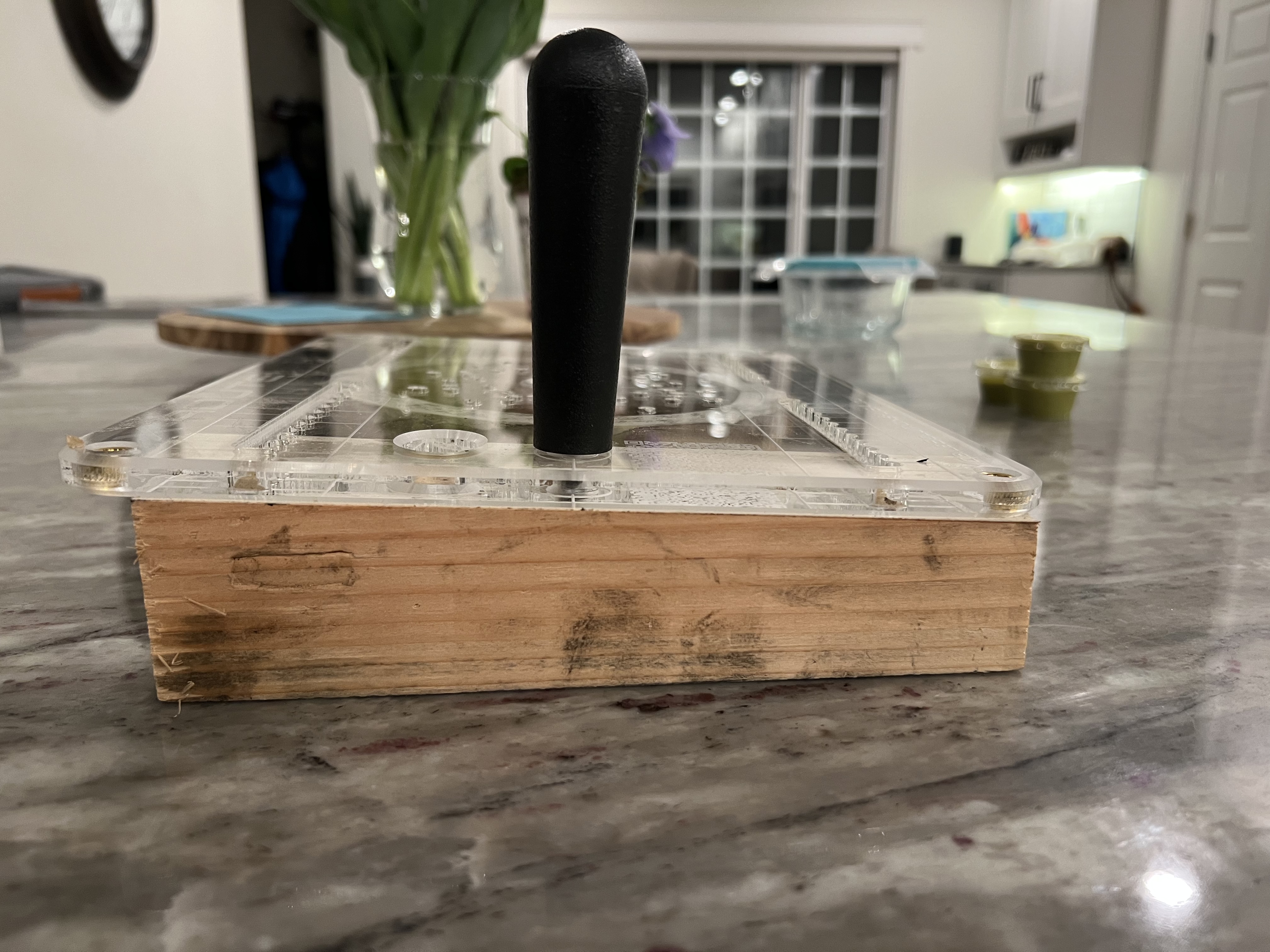

I'd like to "trim" 3/4 inch angled to no trim. I performed some old school trigonometry and found that I needed to angle a guide block by 3 degrees. Once I cut two wedge blocks, template taped them onto my router guide. The guide came with a great center ring to template tape the rings onto the guide.
A quick run through the table router and the rings are beveled at a 3 degree angle. Luckily remembered to mark the low spot so I know exactly how to angle them.
