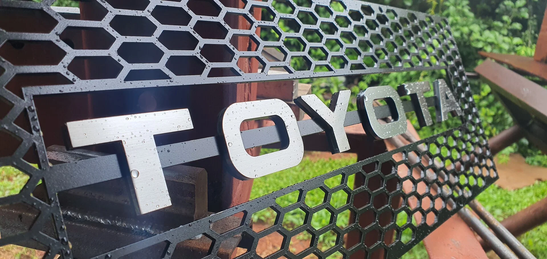

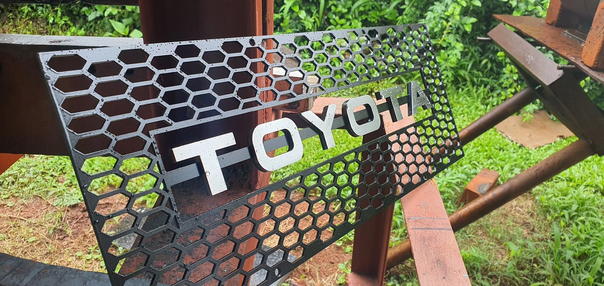

Got my grille laser cut on Friday. Spent a couple of hours cleaning off the letters then welding them to the grille before applying a couple of coats of clear coat. Will get it on the cruiser tomorrow, but so far I'm super happy with it. Old school font, new style hex grille, best of both worlds.

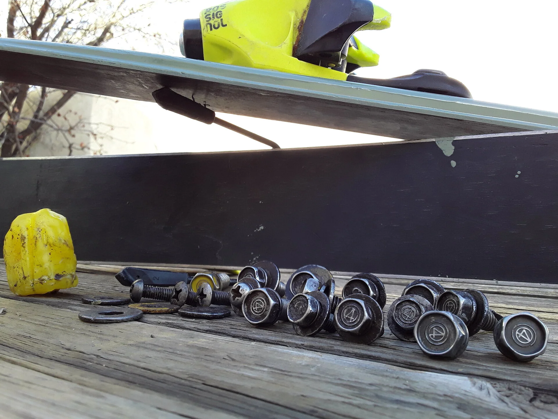

Just like skis. Wax is applied to some hot hardware to prevent further rust, excess is wiped off. Lightly sanding and polishing the heads of the screws brings out the highlights. If you file the cross point screws, you can remove the sharp part left by a screwdriver, making it smoother to touch (like pre-'75 front doors on 40/45). I used a torch, best using an oven for the hardware. I didn't seem to harm the paint, but for anyone concerned about seized hardware due to corrosion or looking to mitigate flash rust, consider hot wax. The hardware pictured is either second choice, or museum wall art. If nothing else, much of the old hardware has lost spring on the lockwashers, so consider replacing. Check the tightness of your hardware when doing this, as it really is changing the surface contact area between threads. This practice should be for vulnerable body stuff, don't experiment with critical engine and drivetrain. It is so you can feel better about freeing a frozen screw and not finding it frozen again. Disolves in Boeshield and gasoline if you want to thin it down (Boeshield in bottle, stay away from the aerosol), or remove it entirely.

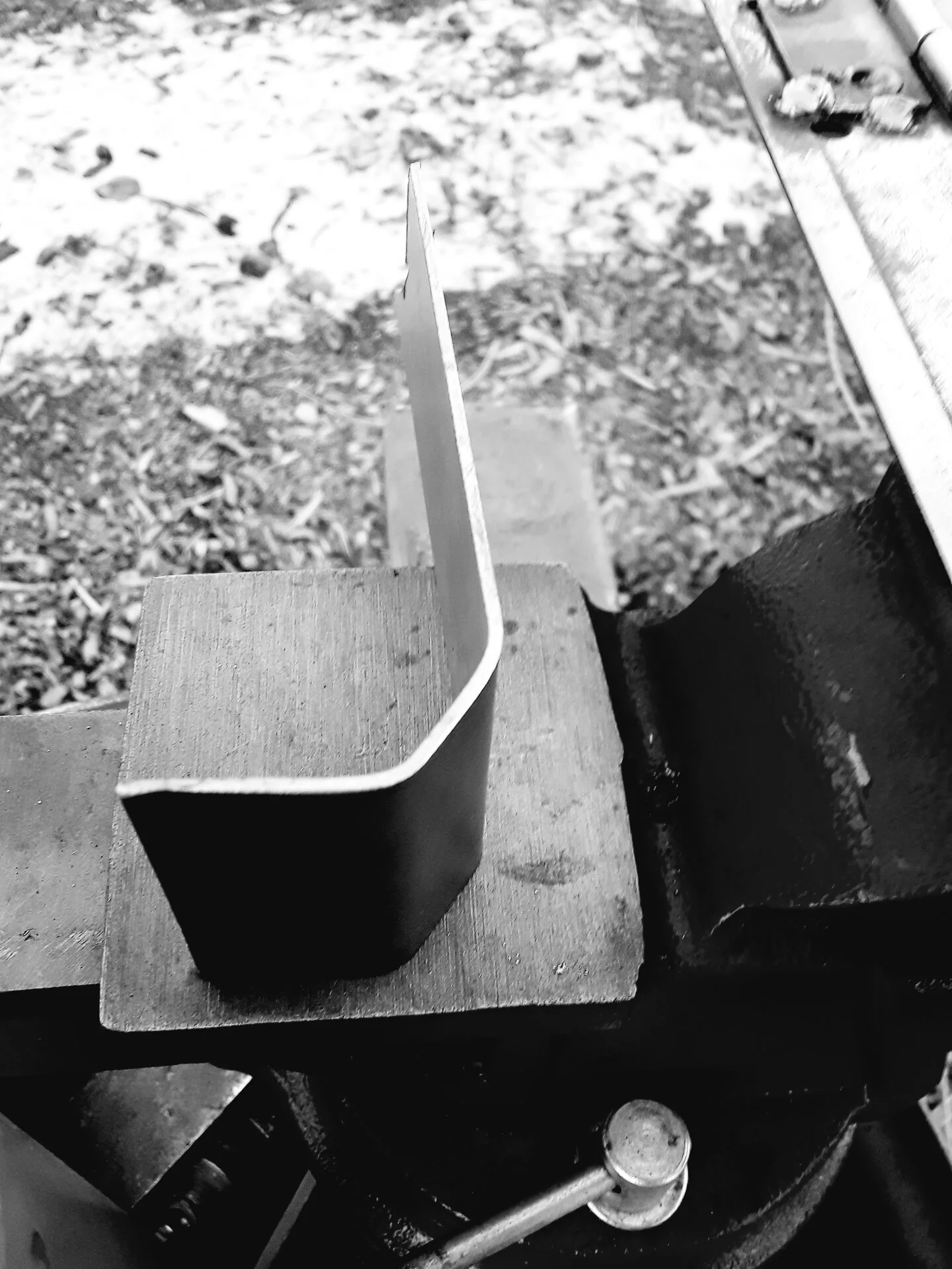

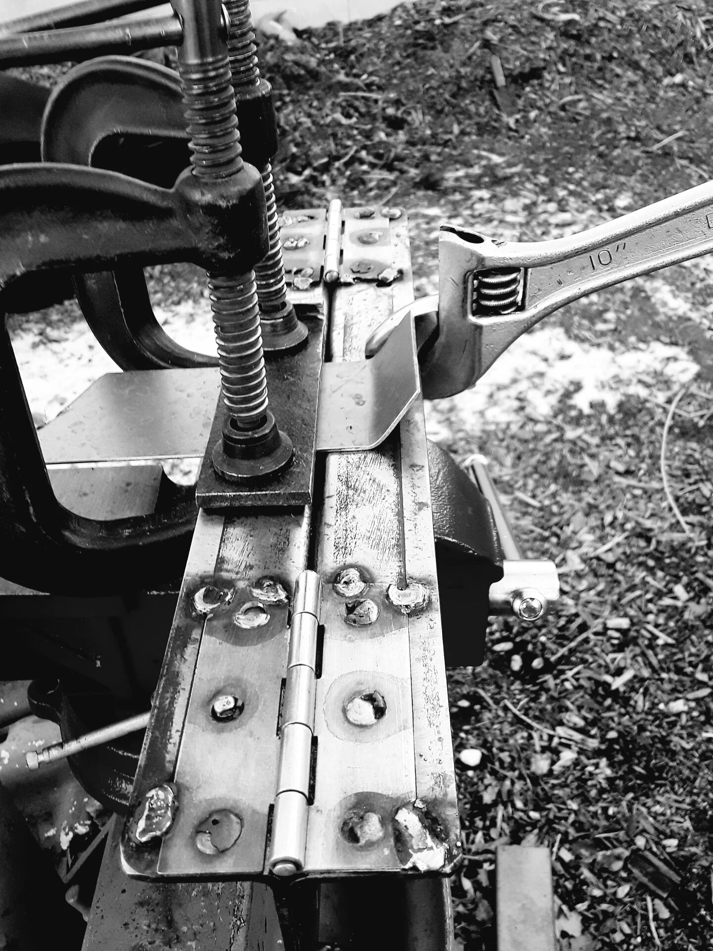

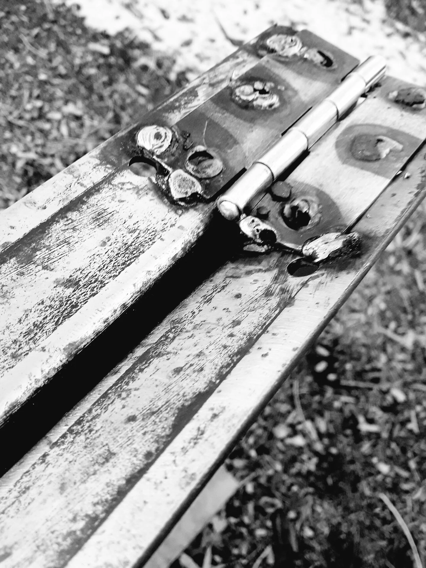

Sheet metal brake, DIY.
The bedframe angle is high carbon steel - failed "spark test." I knew it when it was easier to fracture after a few bends when I notched it for the jaws of the bench vise. I made a repair just to see after the first one broke, but got a new pair of hinges from the home center.
Still, it was capable of easily making a good pair of bends on some "weldable" 16 guage metal. I have some good 1" hot rolled steel (HRS) that I will remake my sheet metal brake with.

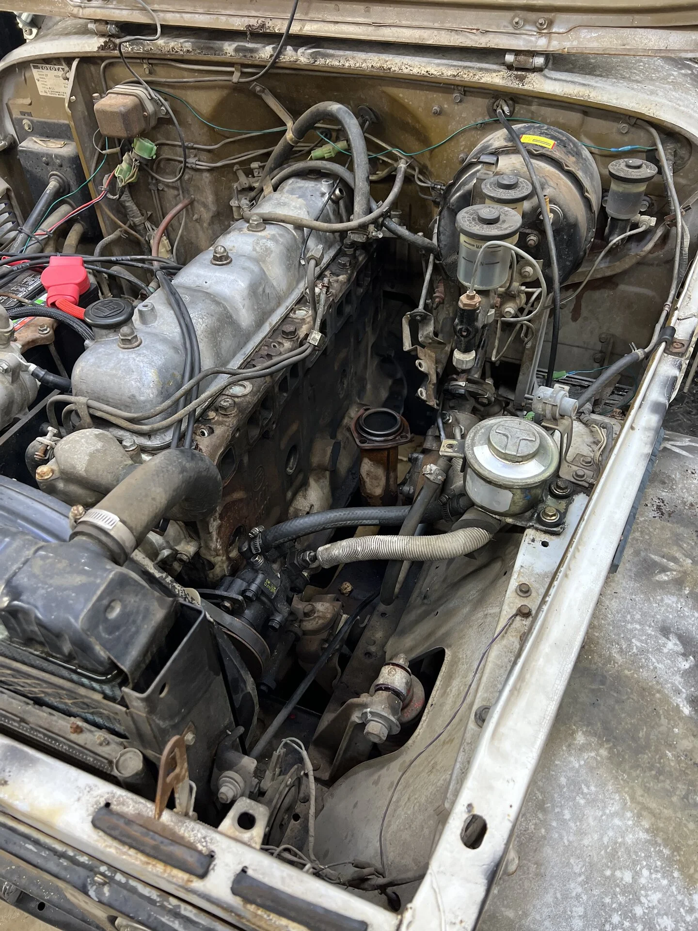

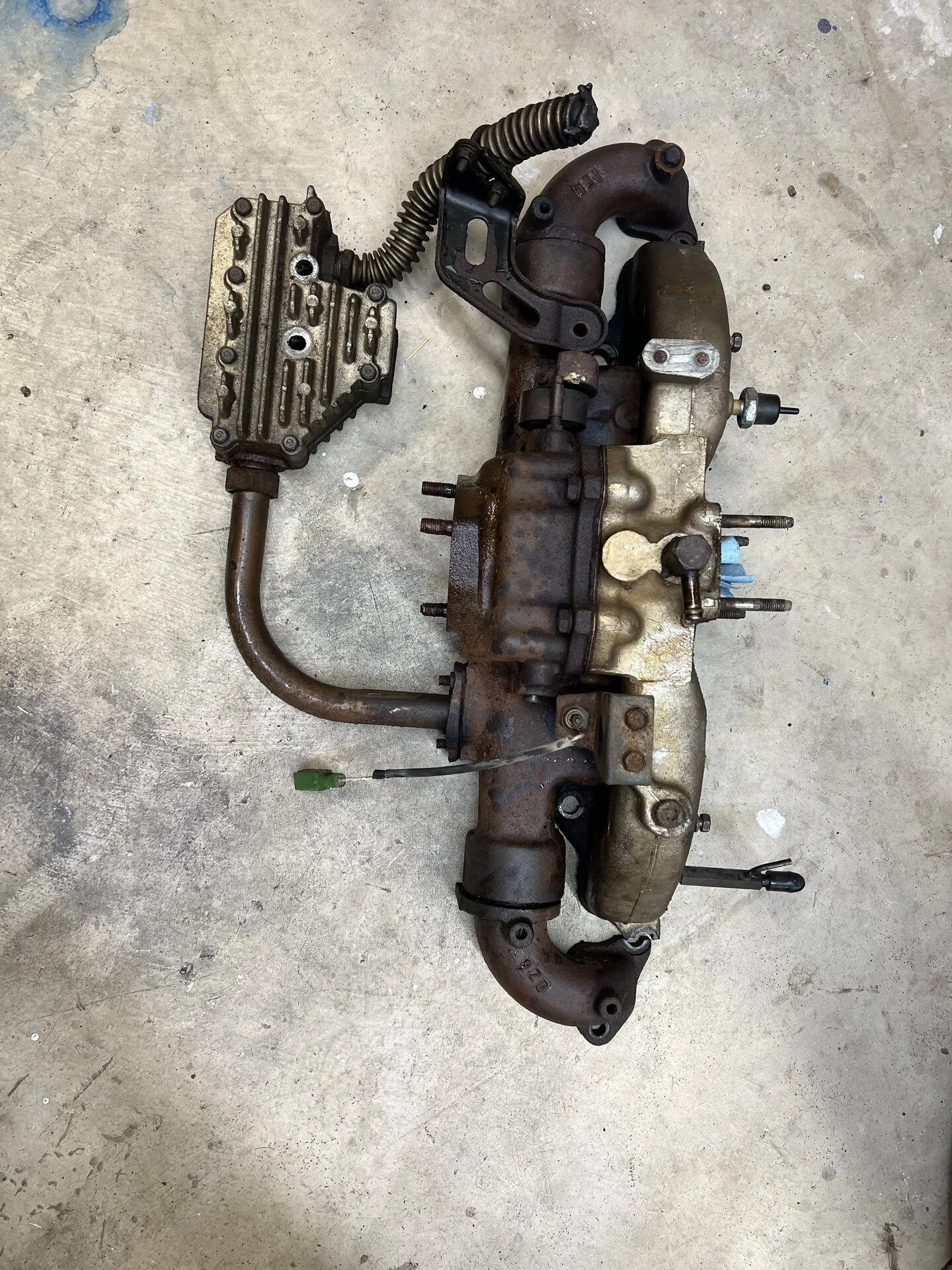

removed the manifolds, ordered new studs and an EGR cooler block off plate and other needed items for a gentle refresh from @FJ40Jim and @ToyotaMatt. Hoping to get this old girl back on the road shortly!

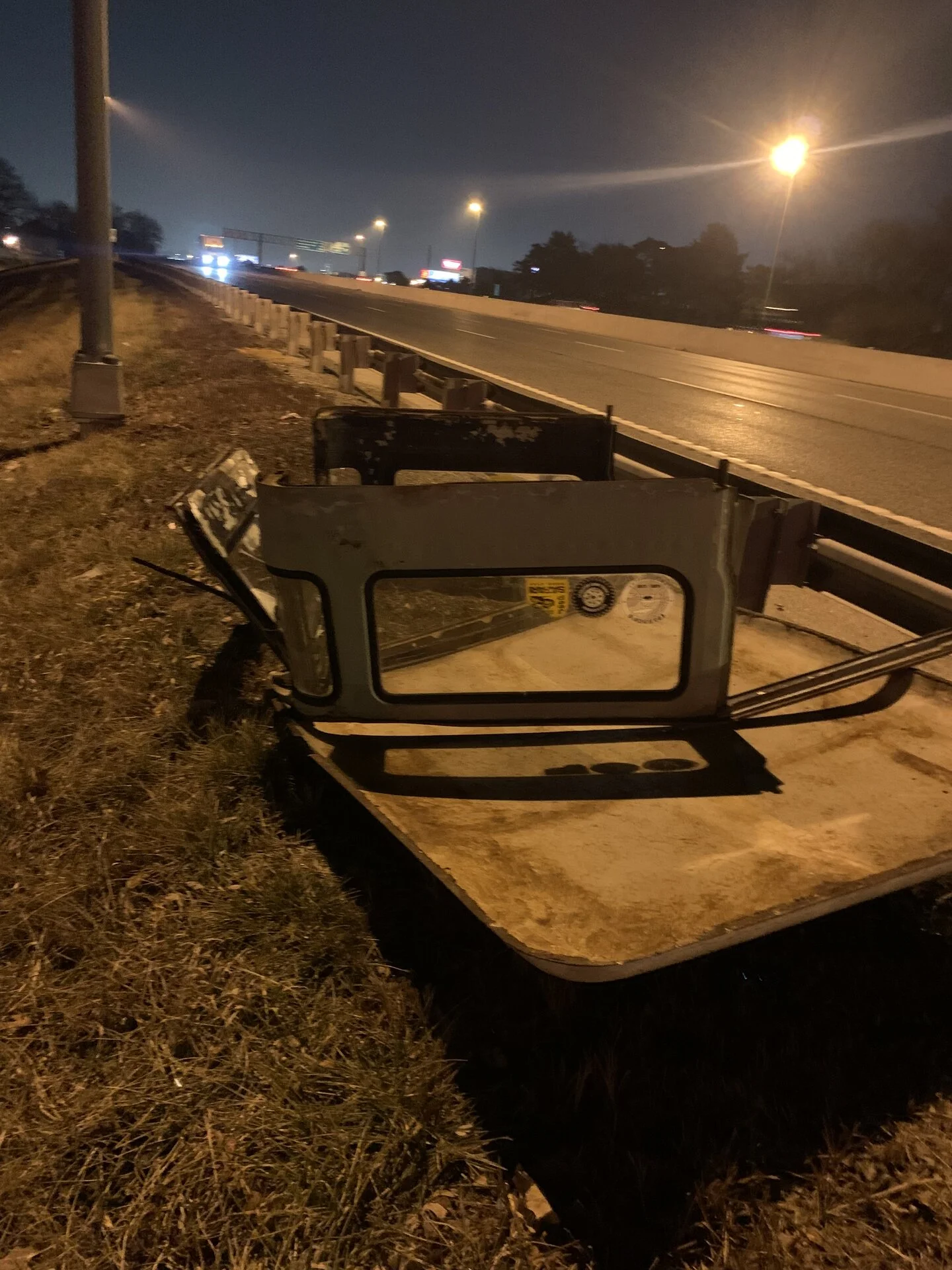

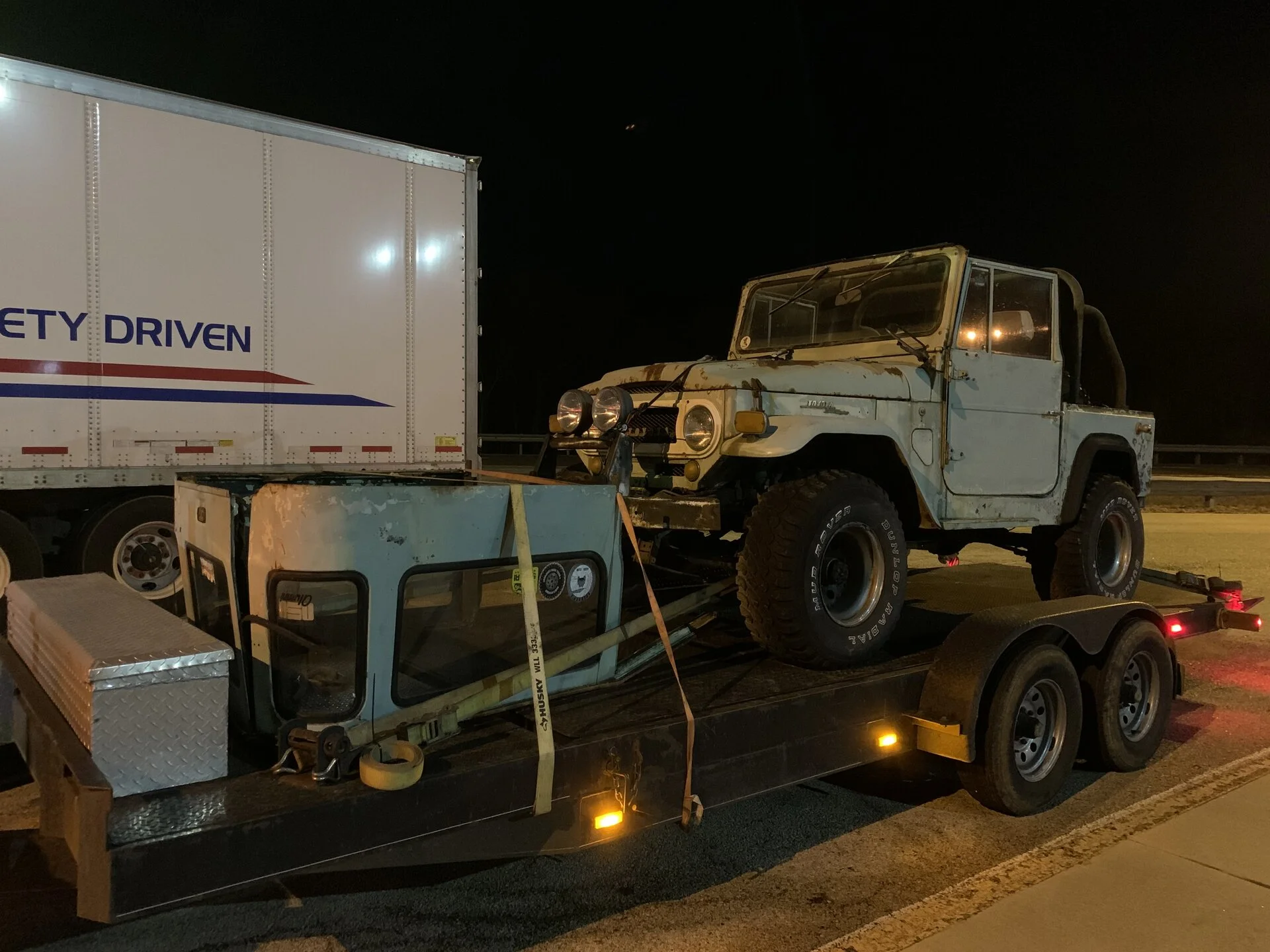

I knew better. Just got in a hurry.. made it up to
65 one time and she went.
Top 85% survived hitting the pavement at 65, no broken glass. Just some scratches and some broken metal.
How did that happen? I'm assuming the bolts to the body weren't installed?
I just bought it. It’s been sitting for years.. best I can see and see it had no bolts to the tub.
I told myself to strap the top before I left because you never know on stuff that’s been sitting.. I got the hood strapped but forgot the top..
Made it approx 10 miles from purchase location, about a mile on the interstate.
At least it survived, no one was hurt, and I got it loaded and Back on the road quichly
Same thing happened to @toomanytoyzz with a 40 he pulled out of the hills of West Virginia.
I’ve seen guys hauling fresh buys with tops strapped.. told myself do that, it’ll be bad if it comes off..
It wasn’t good. But could have been much much worse.
Very thankful I got it recovered before any major problems.
It’s currently strapped on the trailer and truck. Headed 150 miles home.

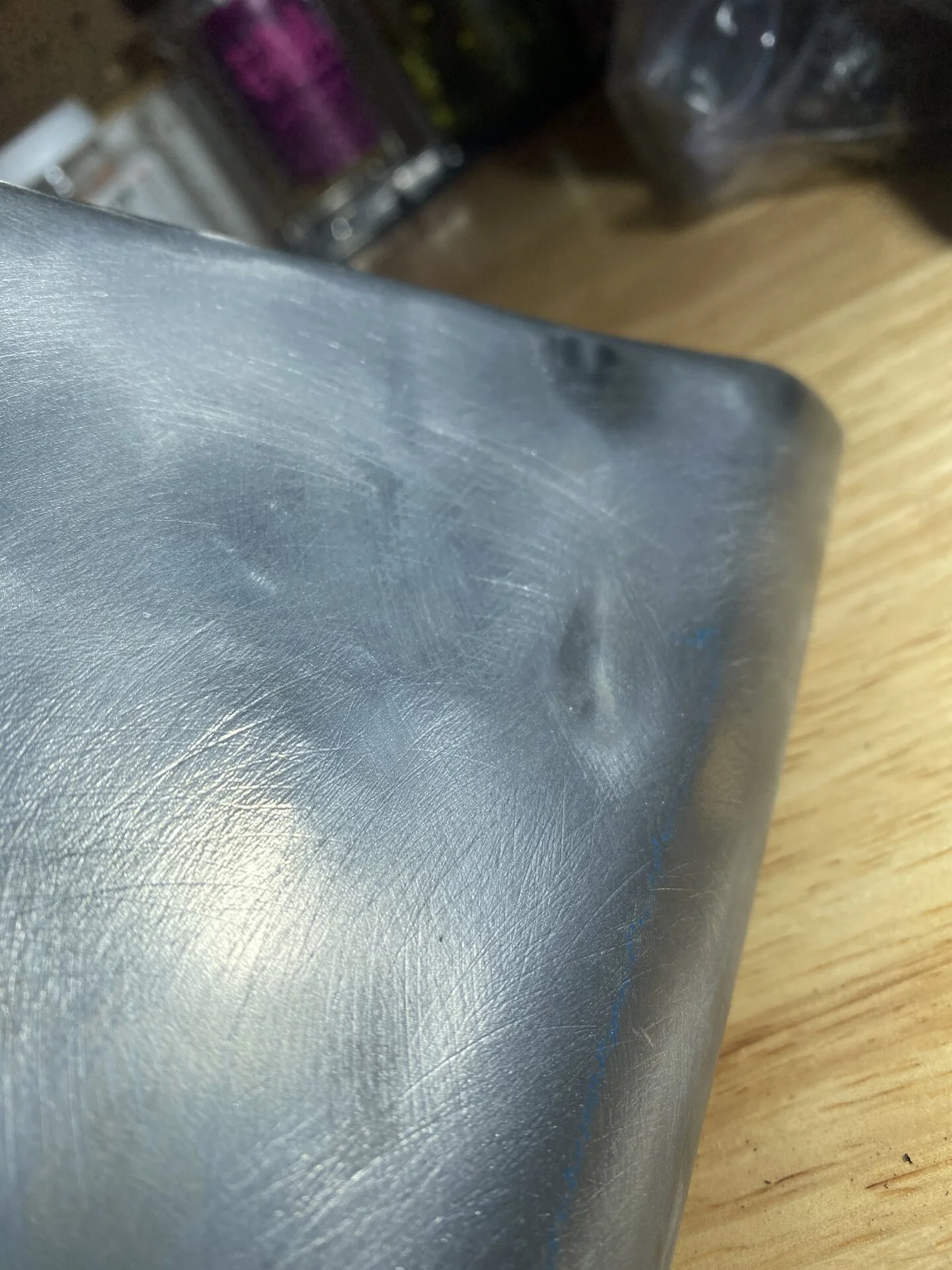

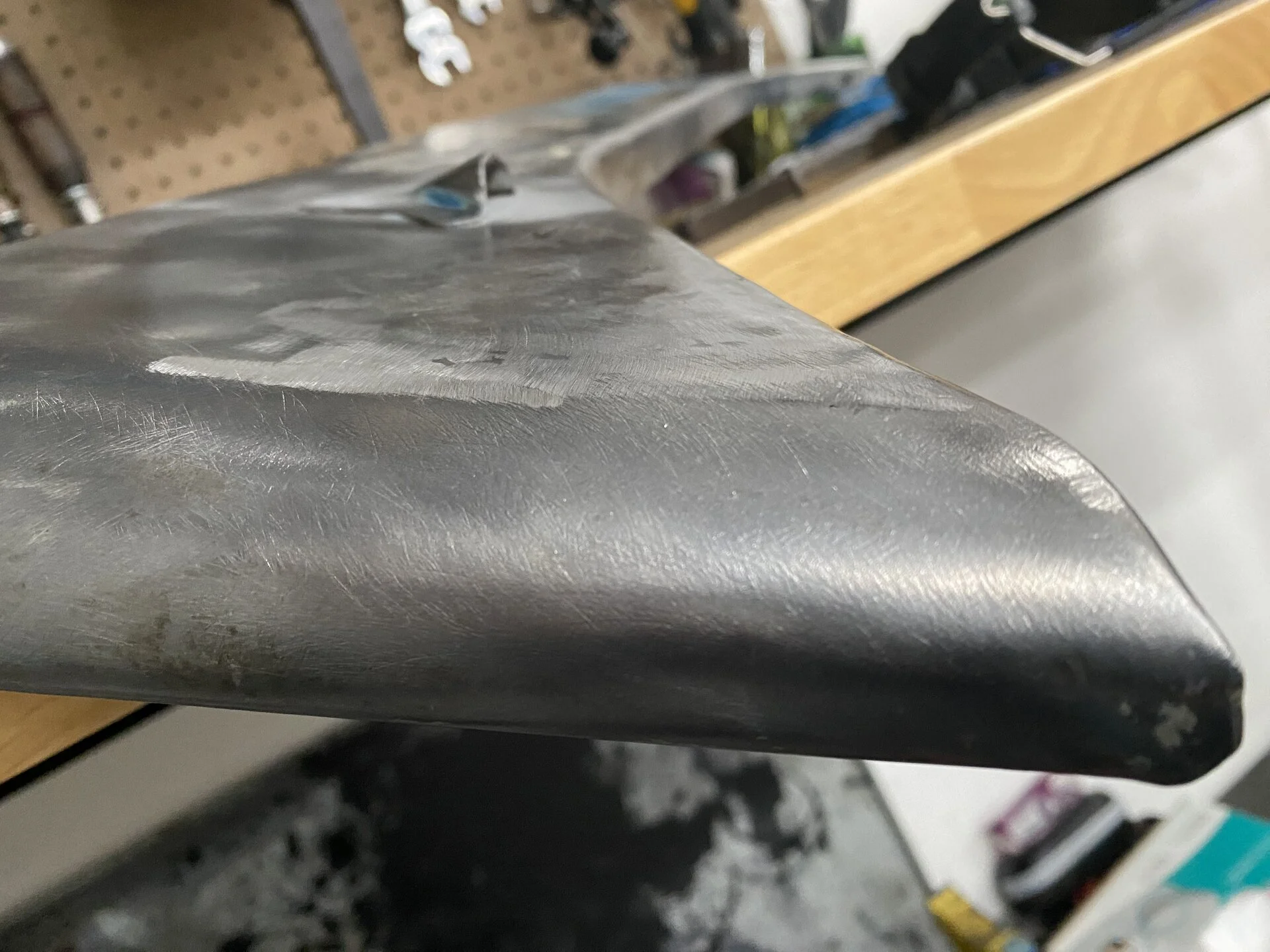

First attempt at real hammer and dolly work. I’m happy with the outcome. Could have used a grinder to smooth it more but I don’t want to thin the metal. The imperfections shouldn’t need anything more than a sandable primer so there’s no point in grinding down the metal. The other side hood apron is horrible. I’ll post that up when I take a run at it.

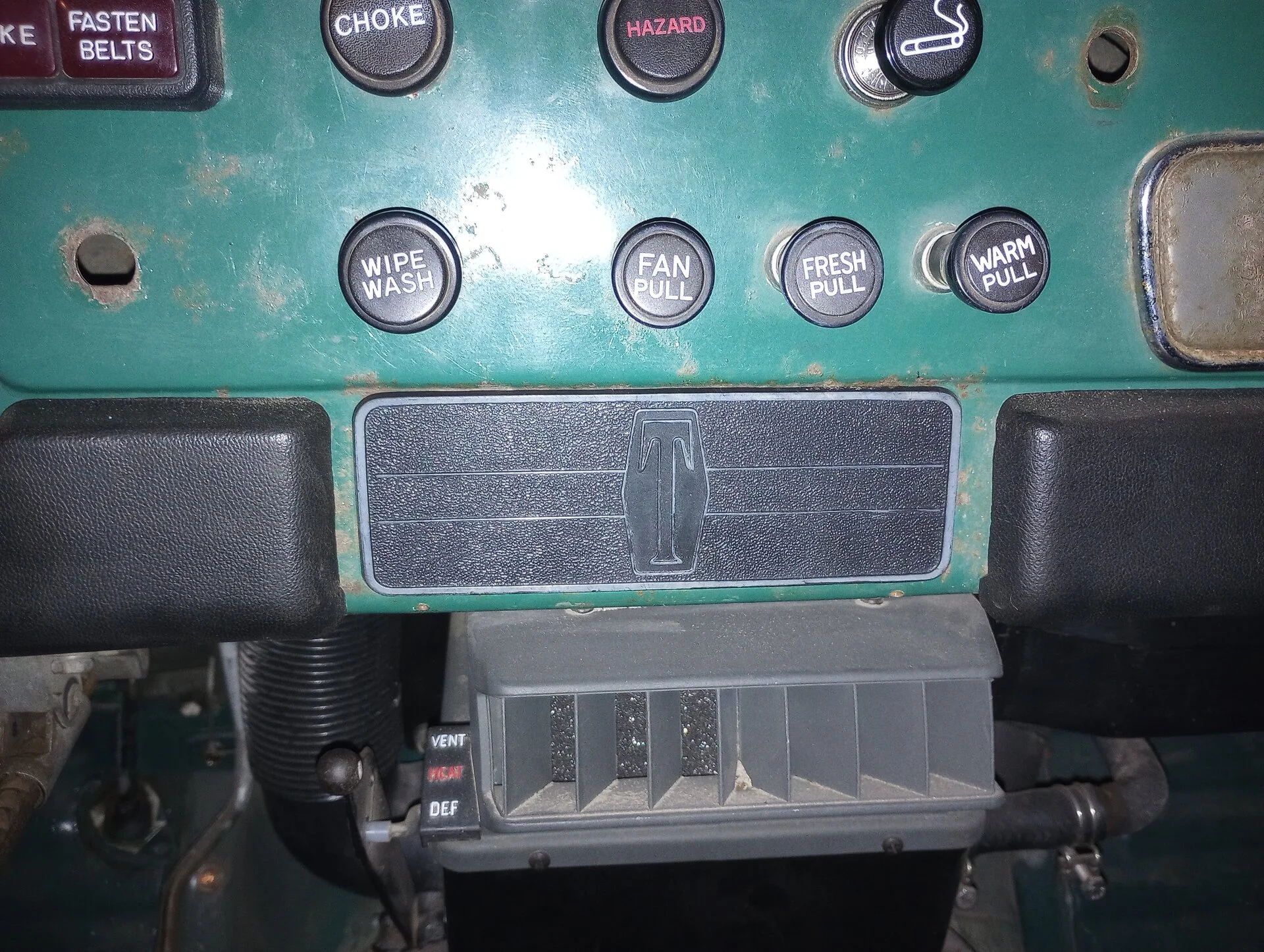

The last several weeks have been filled with all the Christmas and New Years stuff, but in between, I was playing with new FJ40 parts! @baldboy got me the hardlines for the rear heater I bought from him, as well as a center console and some other goodies. Like this gem: The Radio Delete Plate!

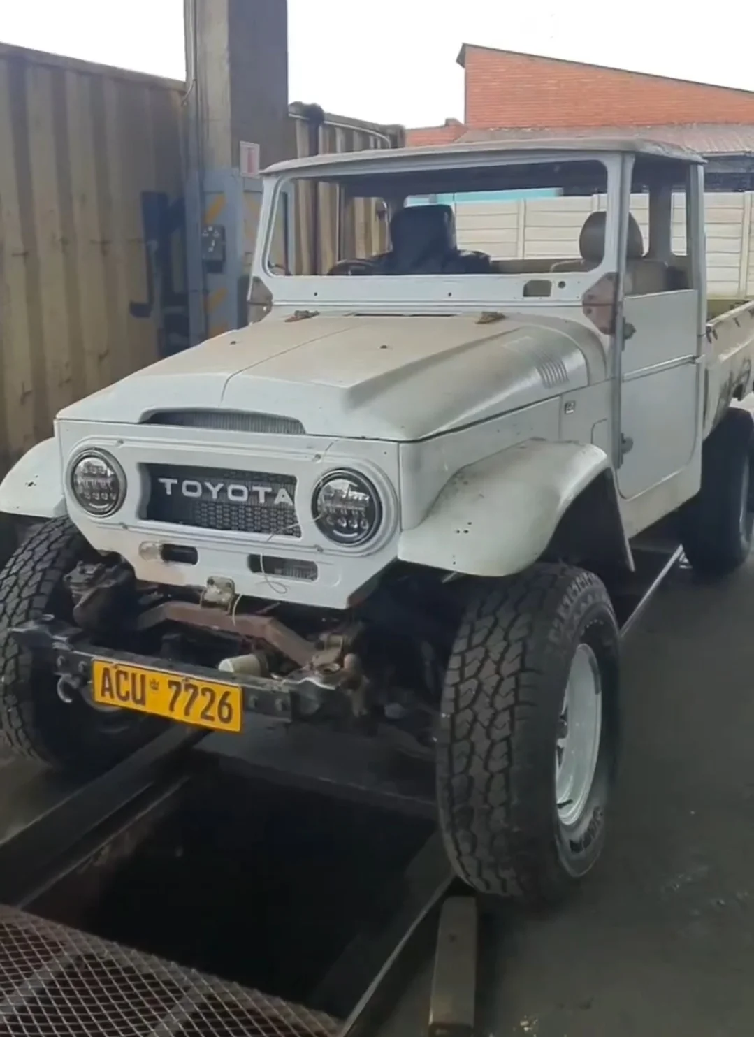

Front grille on
Drove her home too
