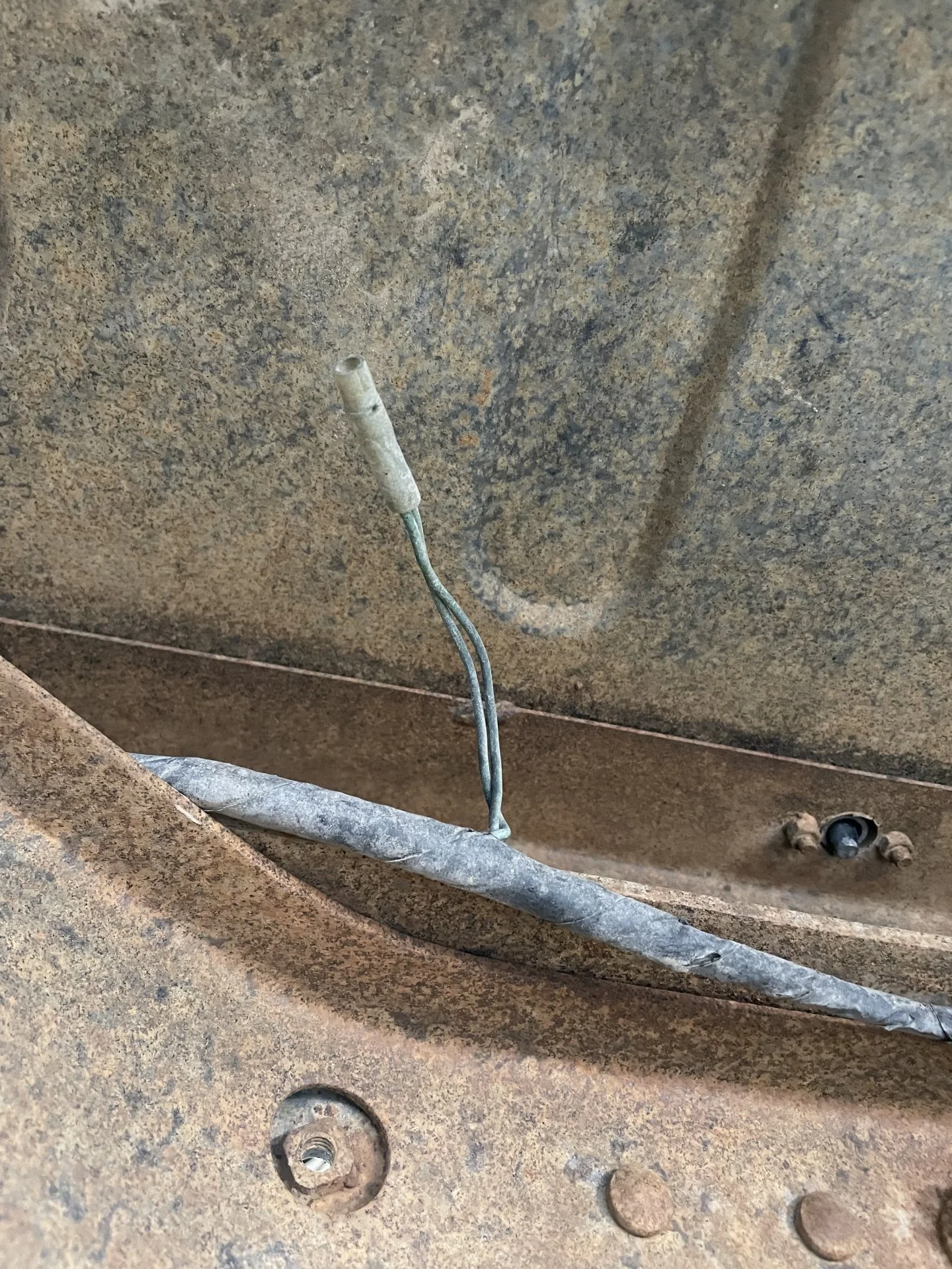

Still trying to figure out my rear brake light problem. This part of the wiring harness is rear passenger just in front of rear bumper. Anyone know what this is supposed to go to?
Go to Coolermans website and you will find schematics for your year truck.

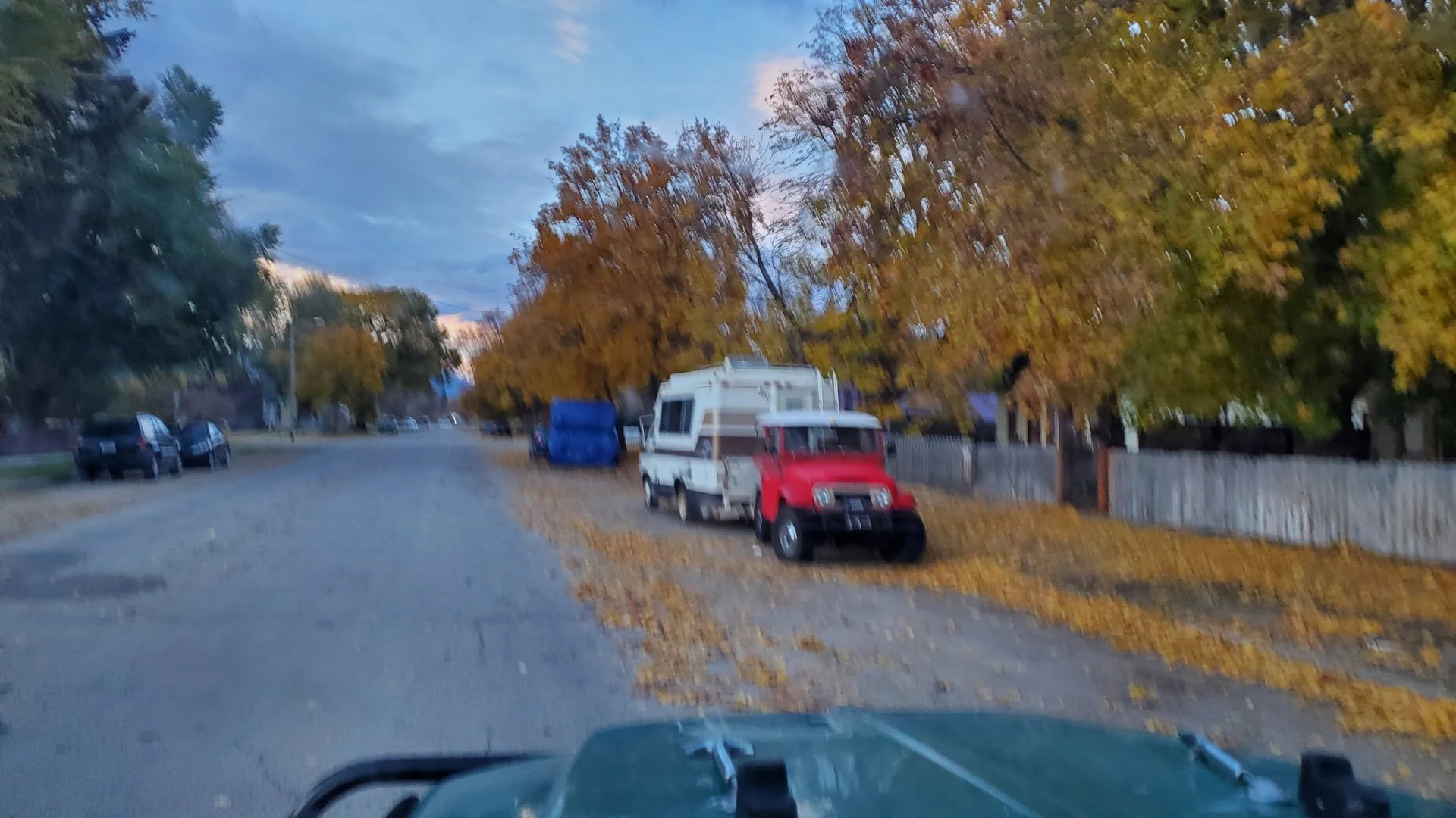

I kow it can't possibly be but that looks like the block I used to live on. What a gut wrench.

5th and Pine area.

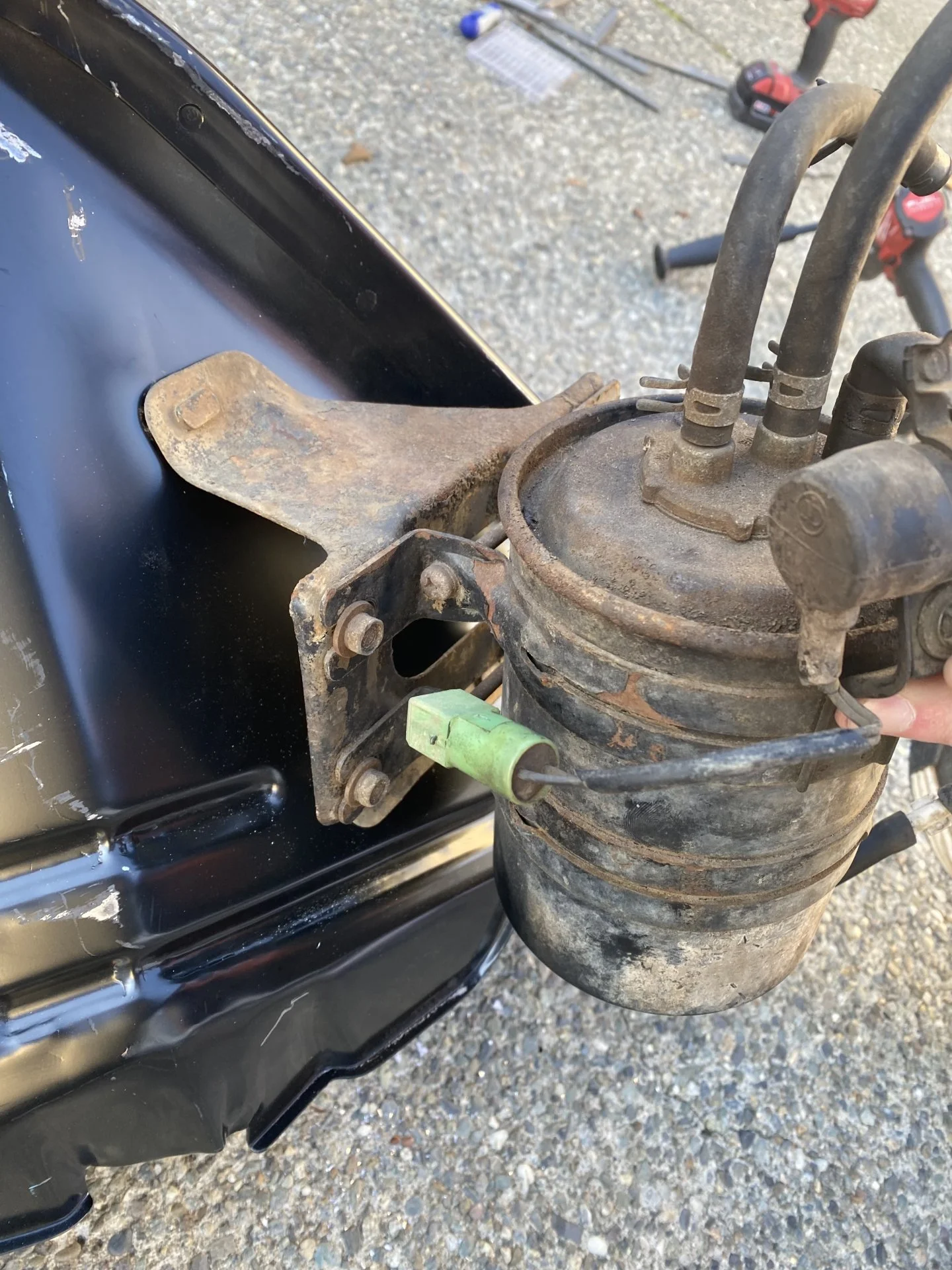

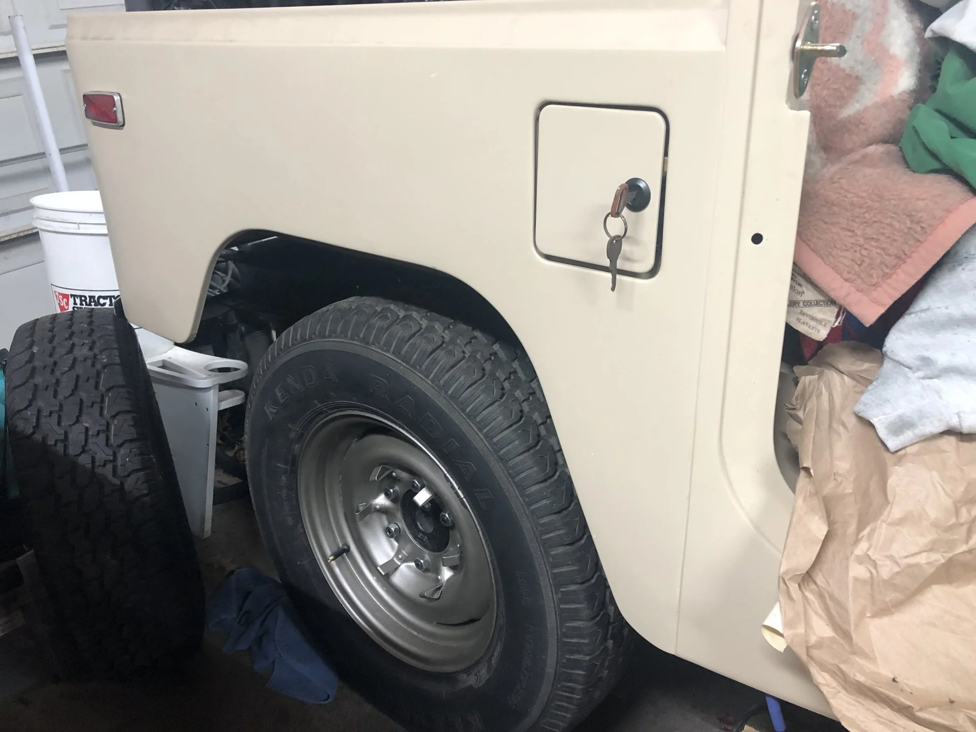

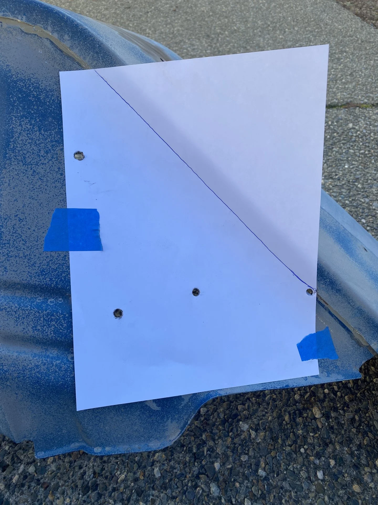

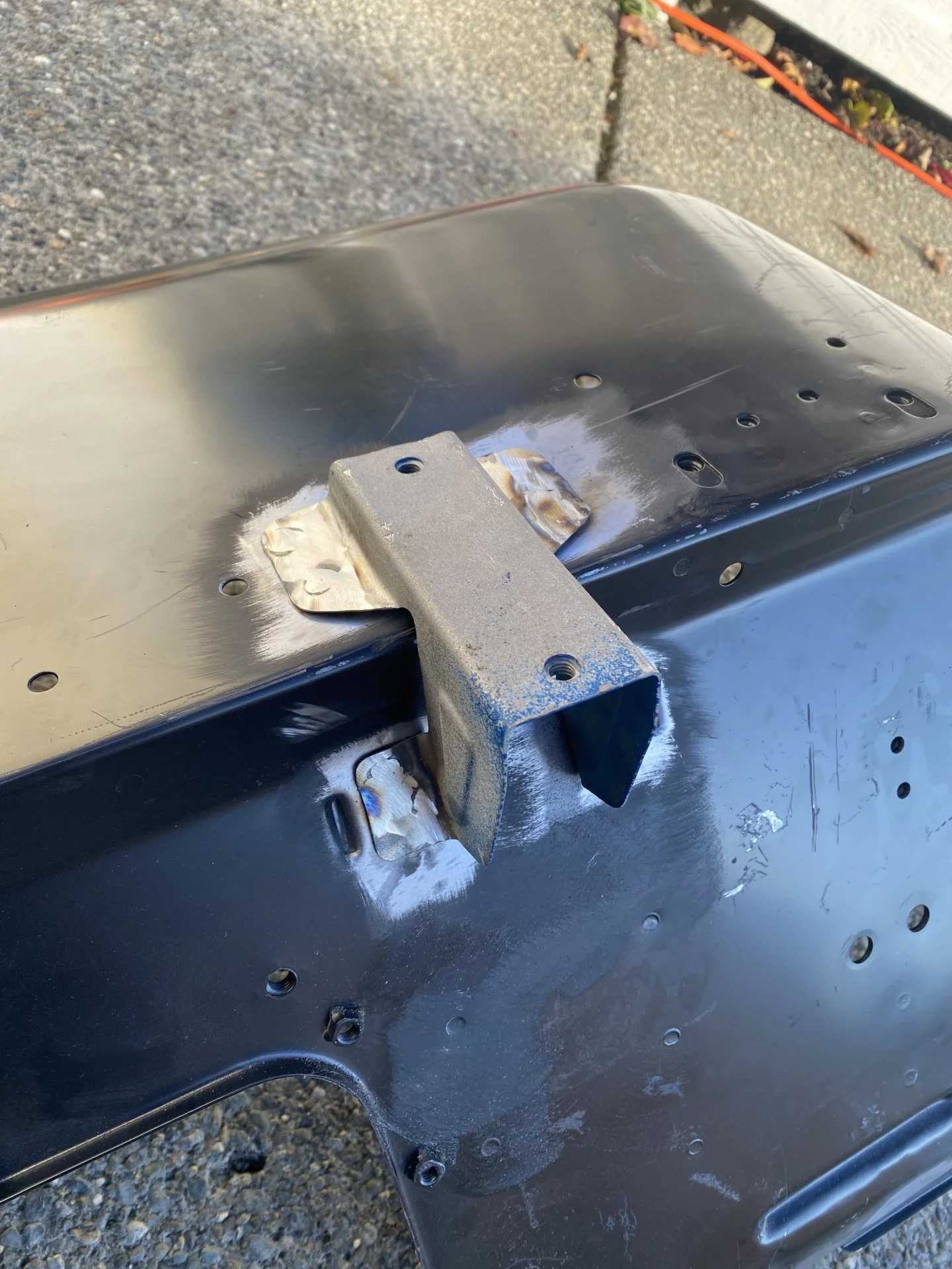

Busy weekend. Scored some new fenders. Would think all the holes are there and in the right place. Not even close. Made a mistake on one and did some extra welding. Came out well. Both sides were missing stuff for the emissions equipment. Also started painting the frame. 4” cabinet rollers are the bomb. They allow you to get in everywhere, they lay the paint down thick and without drips.
On the topic of using rollers vs spraying for the frame. I contemplated this a ton but realized how much gap there is between the two interlocking C channels so I decided to go with a foam roller because it allows you to squish the paint on the inside and have it flow between the sections. You have to flip the frame to allow gravity to do its job. Much better than spraying. You would never get paint into the gaps if you spray it
View attachment 3167355View attachment 3167356View attachment 3167357View attachment 3167359View attachment 3167358
I WAS going to post about the fact (that most people fail to consider) that the replacement fenders are for the 79 and newer. But then I noticed that your frame is ‘79 or newer, so I’m surprised that things like the coil bracket would be missing.🤷🏻‍♂️
