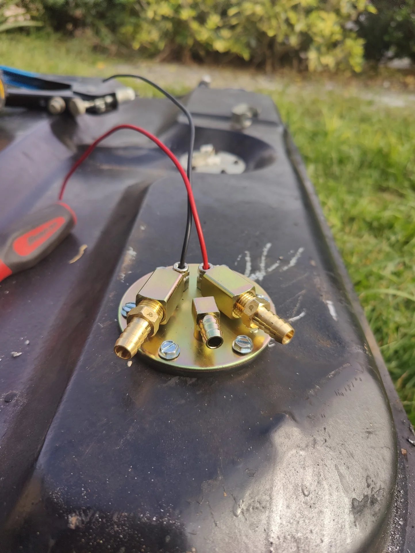

Got the in tank pump figured out (I think) on the 55. Some riv-nuts and sealer should do the trick. I dropped the tank about 1 1/3" on spacers and lengthened bolts to clear the pump hardware. So far so good. Just gotta wire the rest of the sniper up.

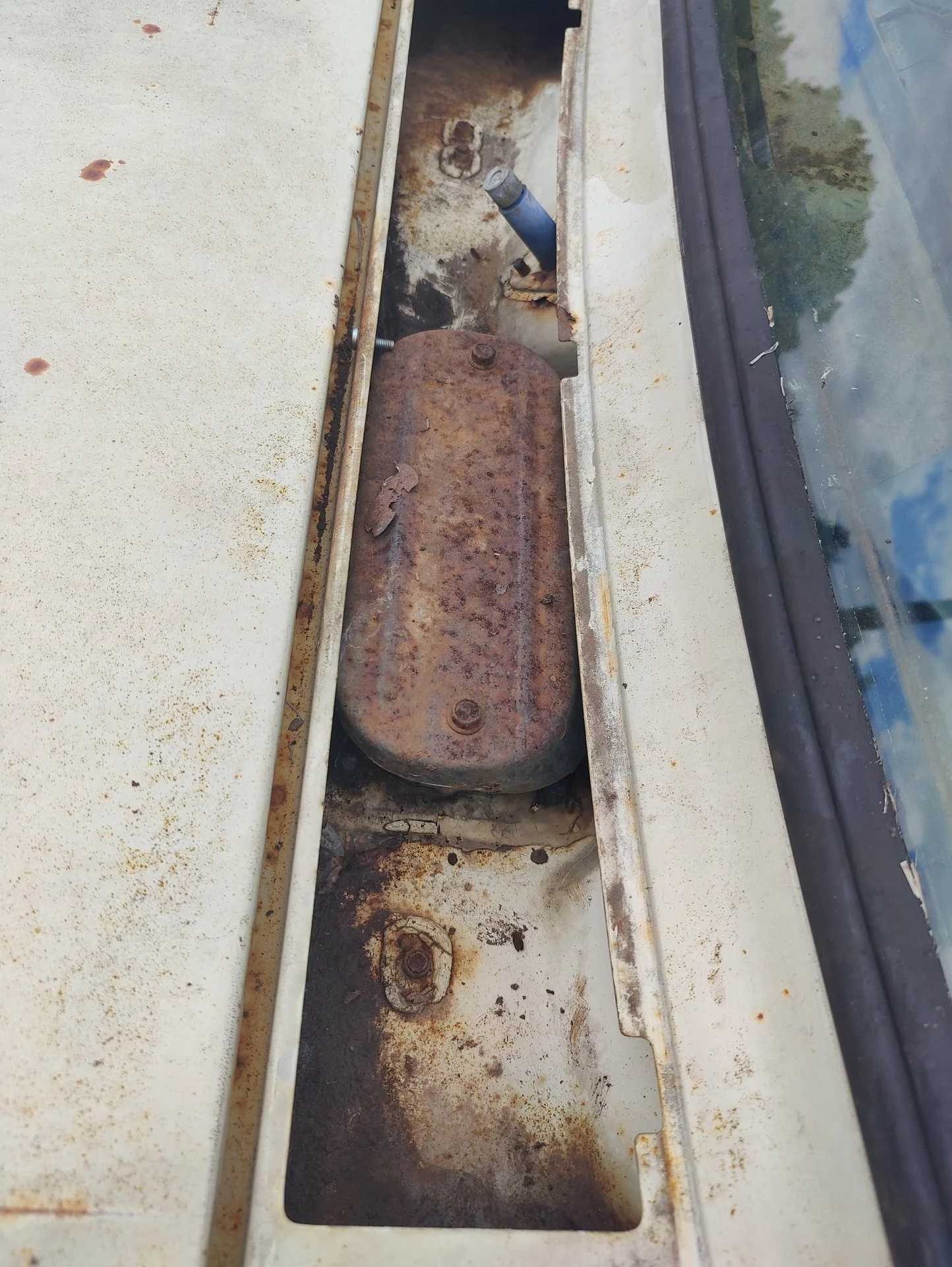

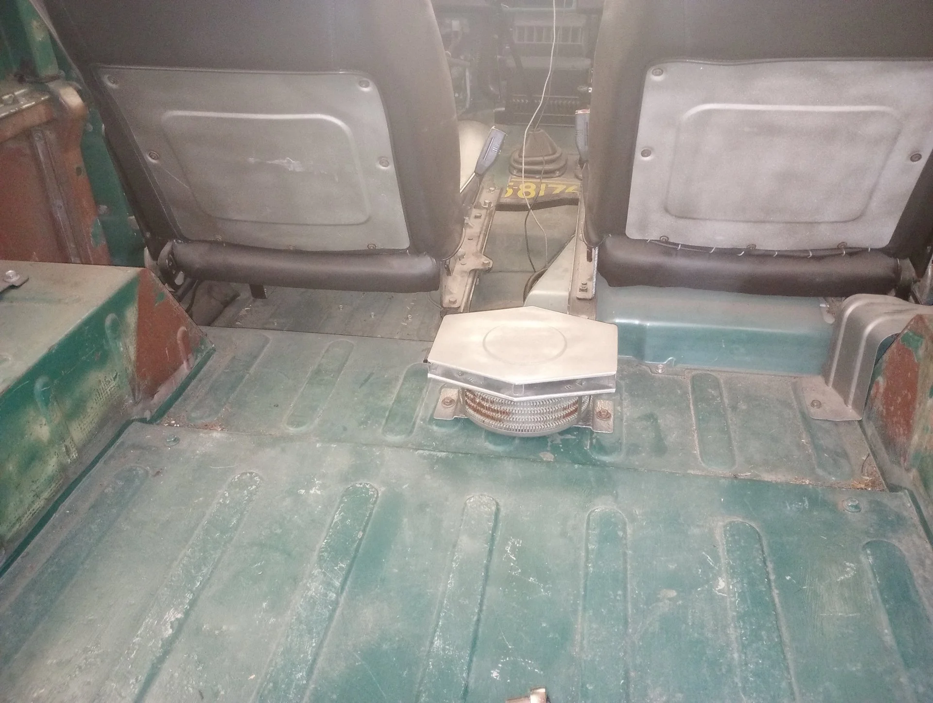

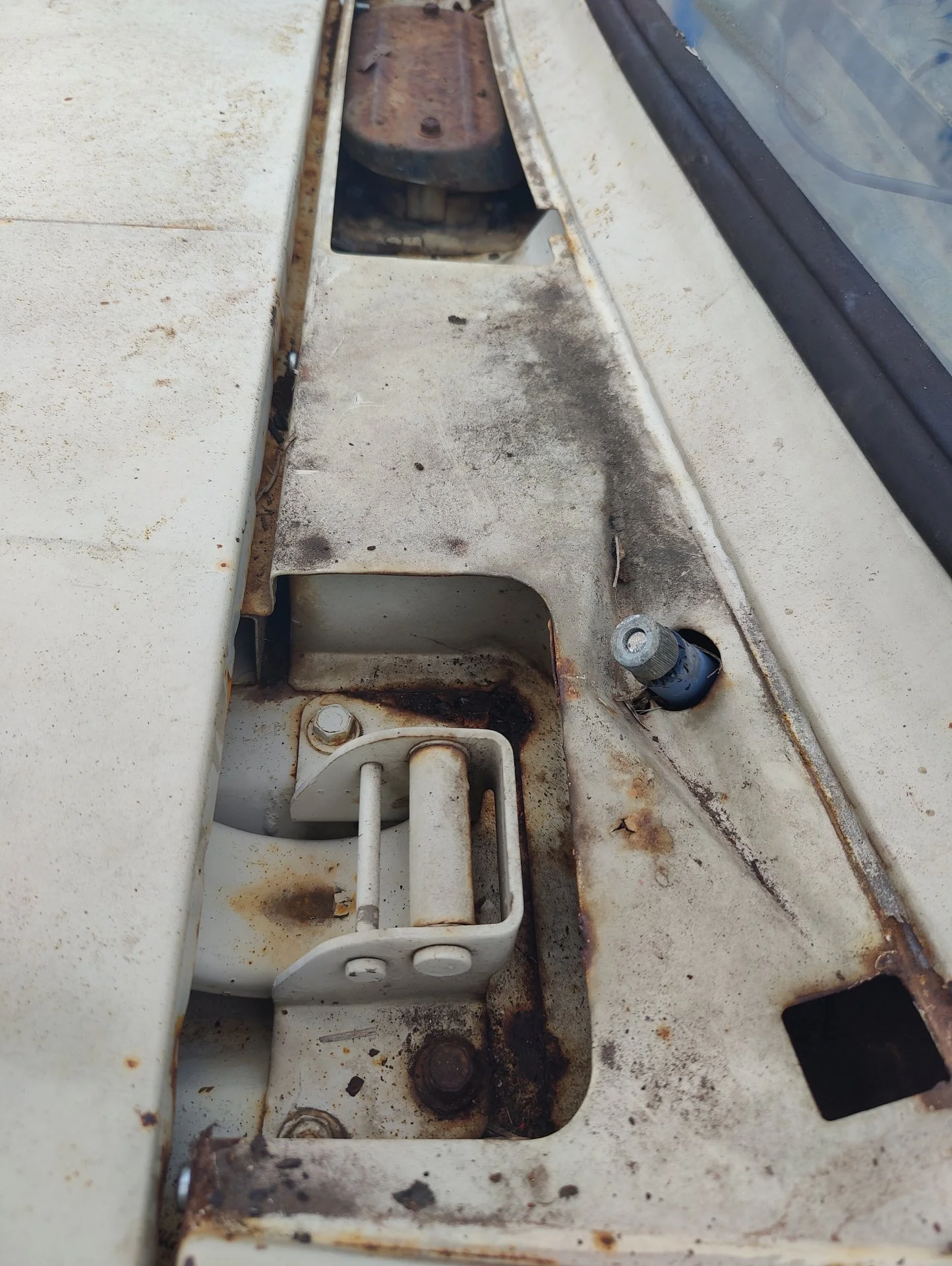

Pulled the cowl to look for leaks/hardware/rust/wildlife. Surprised I didn't find much of any of that.
Do you have a source for that driver extension kit?
Classic Cruisers. I'll say, I found some threads on here that give some pretty detailed DYI projects that accomplish the same thing. If I'd been a little on point, I could have saved some money. Google "FJ40 Seat Extension" and read what's there before you spend the money. If the work is in your wheelhouse, you'll be happy. Good luck.
