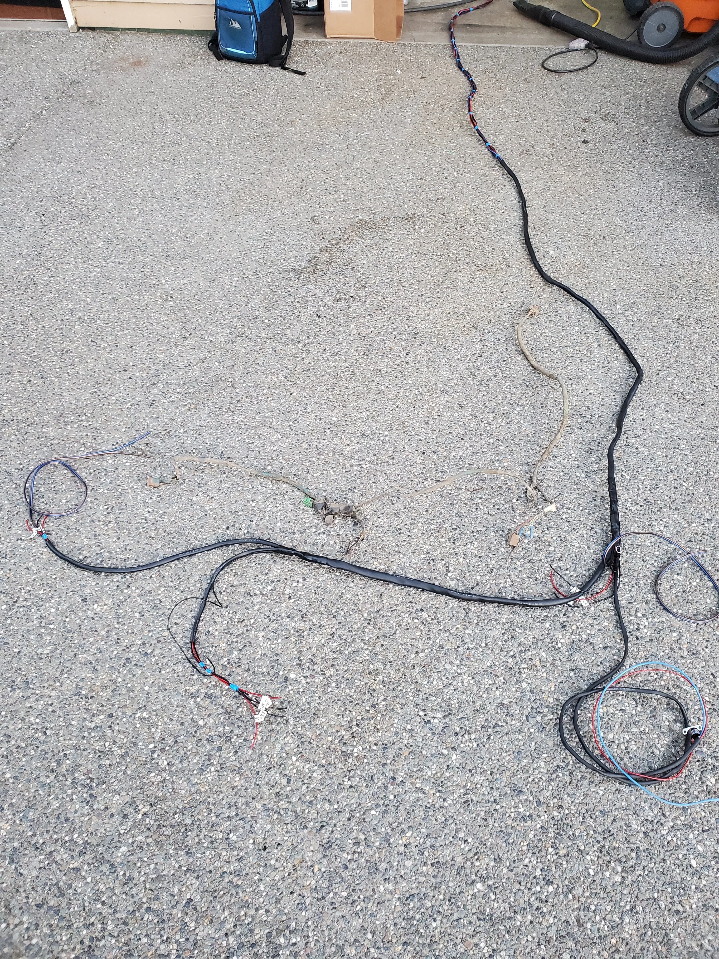

Rewiring my 40. Spent about 8 hours on the rear tail lights. Here's a shot of dad's old harness, and my new one.
I ran out of TLX wire so I have some NAPA spools. The tail lights are a ton of wire. Was going to cheap out with flex mesh wire looms, but had enough Raychem DR-25 and SCM so everything is super sealed and protected.
Was cleaning up my lights and decided to buy some new housing...which 40 had oval lights!?!? Turns out dad plasma'ed ovals and install truck-lite group 60s. I was pretty upset until I found NAPA stocked the lights, marker lights, grommets and connectors for about 70 for everything.
Added a rear facing camera, hot lead for the backup light and license light. Typing this, realize I didn't run ground wires. Hope the 4plus bumper will carry the ground. Also ran 14 gauge speaker wire for a set of JLaudio 6.5 combos. Overall, a long day, but I'm happy with the results and super impressed with the Raychem products.
