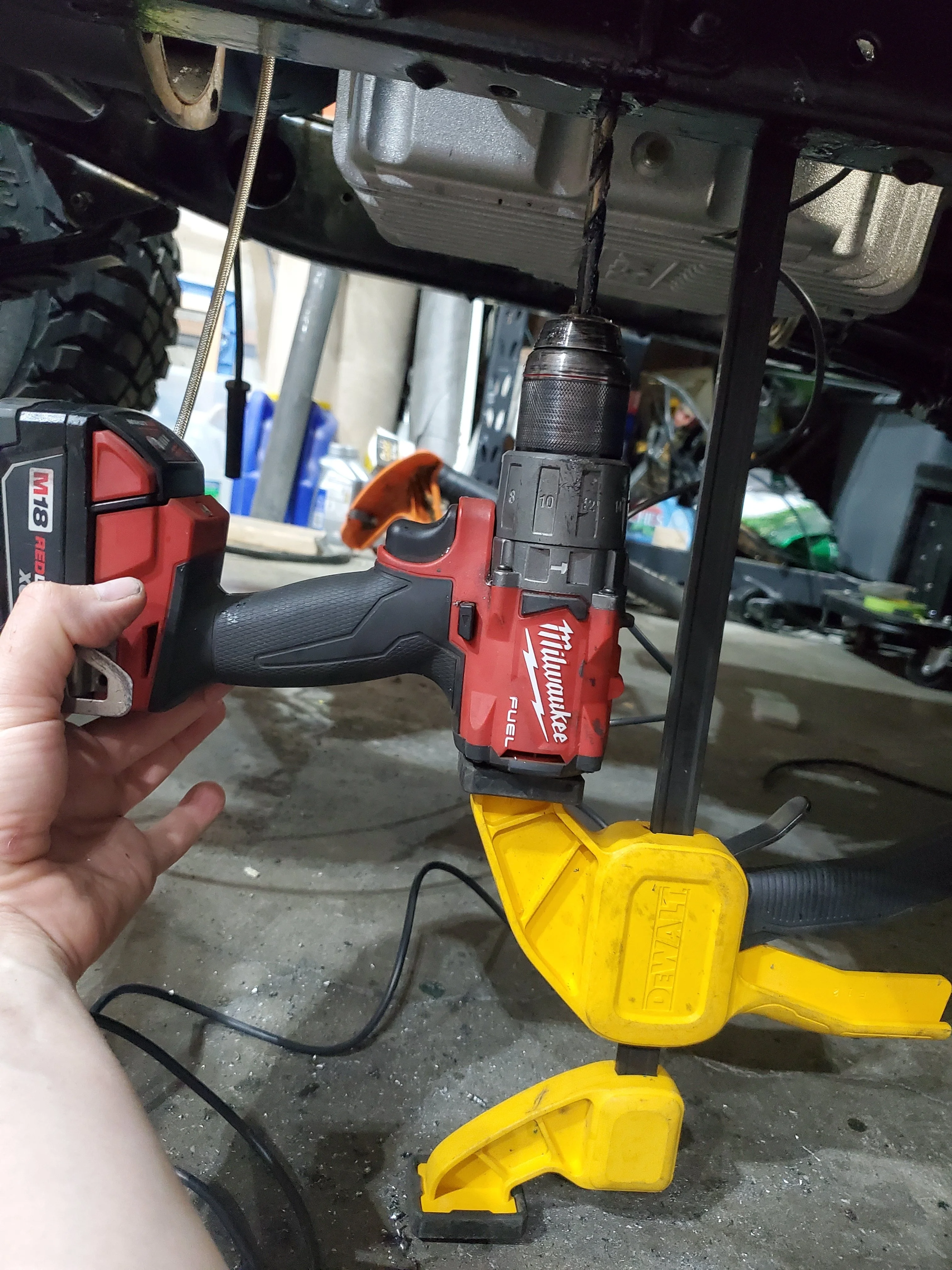

Drilling through the frame rails is a real drag and the first hole took about 10 mins. So I came up with the poor man's mag drill. Next hole only took about 3 mins.
Yeah, drillign the frame rails for the ARB Bumper was a chore, Love that drill idea!
When drilling in heavy steel I always drill it in steps starting with a small bit. I have a cheap HF corded 1/2" slow RPM drill. With a sharp bit it goes thru like butter. If I'm getting little bits of steel verses long curl shavings time for a sharper bit. Found faster RPM does not mean quicker drilling in steel. Also using a punch and small bit have far less problems with the bit walking and stays right where I want it.
Step Drill bit, though do a better quality one than this. Amazon product ASIN B07JKKFD4C
