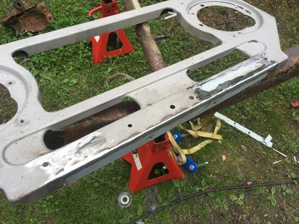

Here’s a good illustration of why people say to strip the paint before you start patching stuff. I knew the over lapping brace had compromised the bottom edge of the bib. It’s a pretty classic spot for rust and this rig is from the north east so...
But take look at the circled area here. You can just start to see some bubbling. Not to bad...
Then you get it back from the blaster
All in all, I can’t complain that was the only spot I saw on my quick inspection that I didn’t already know about already. So far I’m stoked on the dustless blasting. It cost a little more than I hoped. He said it was because he didn’t realize I was going to bring a pile of parts. I guess most people bring the whole car assembled. In the long run though they were able to get 99% of the paint and rust off, largely due to the fact that I cut the rear tub off and you really see in behind the dash. The bright side is it really did show me everything that I had to work on and how good much of really is.
My real dilemma is I have a brand new Gozzard fiberglass bib that never made it on a different rig. This is no car show queen and it would save me a ton of time to simply swap in that unit. Part of me loves the idea of more original body parts, but I left the purist fork in road behind with the Aqualu 3/4 tub. While the passenger fender didn’t have any surprises, it needs some work and once again I have a Gozzard fender skin that never made it on the other project. I’ll sit on these repairs for a bit and think about it while I patch the floorboards and driver fender. On the bright spot the windshield was in great shape and I was worried from all the photos I’ve seen on mud after people having them stripped.

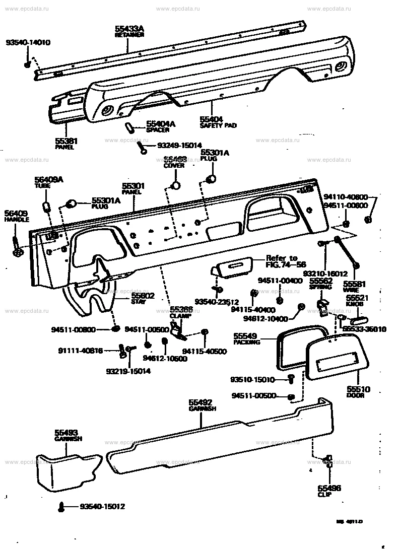

When you say "retainer" are you speaking of the metal piece that lines the interior or the void?
The retainer (# 55449-600100) secures to the windshield side of the back of the pad with bend out tabs. It's attached with small screws to the pad. It's function is to secure the top/back of pad to the length of windshield (with bend out tabs on the "panel #55381 of windshield). The rest of the pad is secured by 5 screws and 2 knobs on the front side. You should not need the spacers as they are formed/built into the safety pad (55404-600110, 55404-90300 & 90301 depending on year) nor the retainer if you had a pad already.

My #55381 is rusted/pitted. The #55433A is good. Thanks.

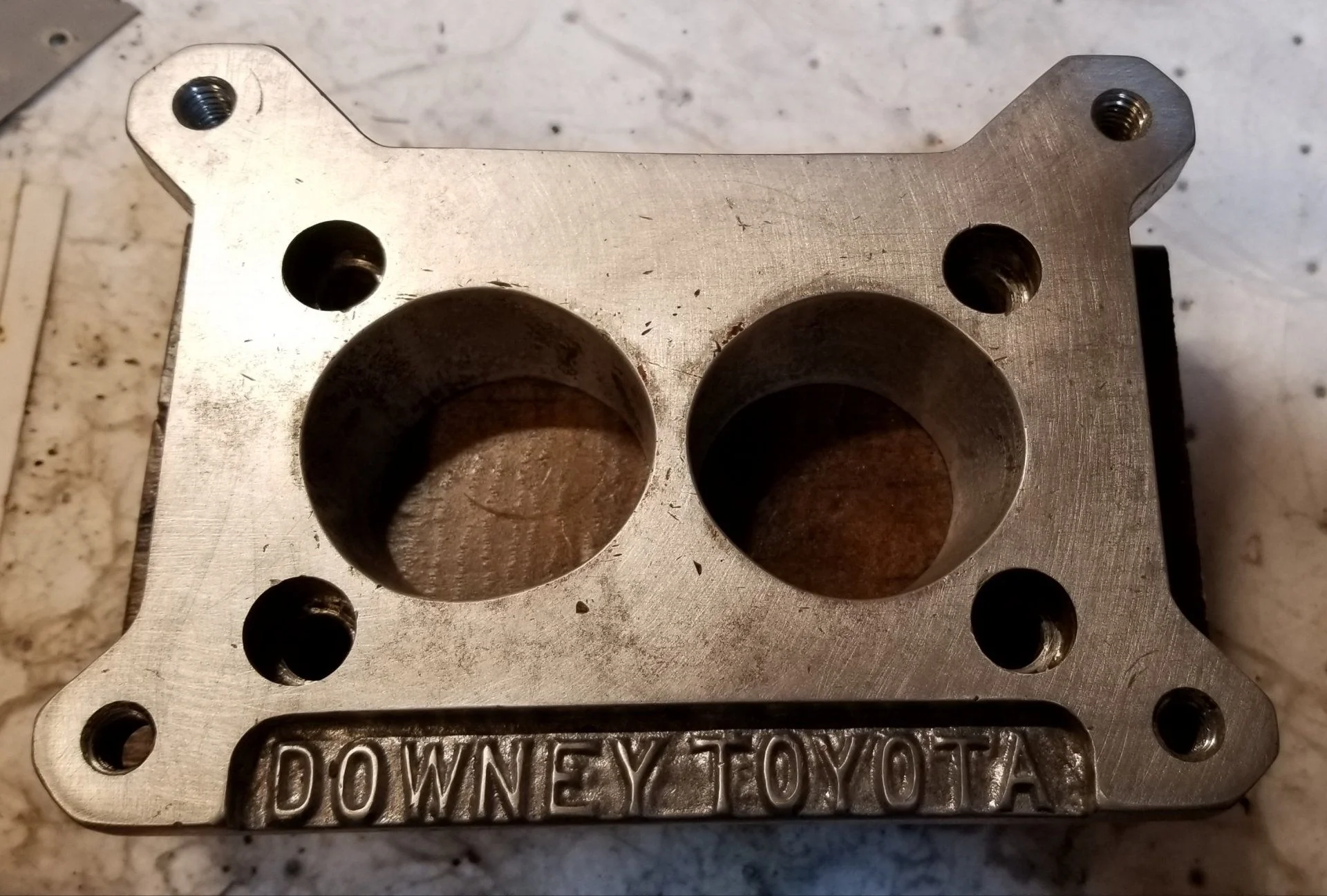

Starting to clean and gather parts for Sniper install. I miss the old days of holding a Downey, Man-a- fre, Desert Rat, ect. Catalog in my hands!

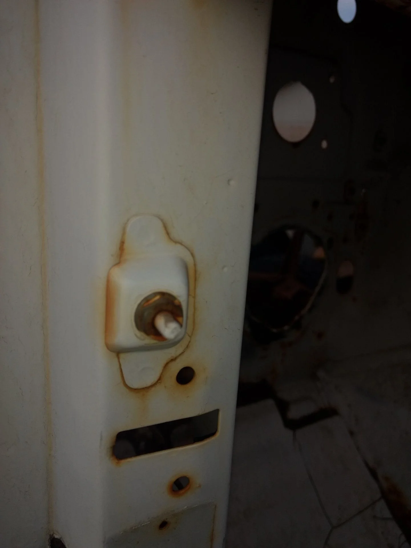

Was that for a complete door or just the shell? See a set of NOS on eBay right now. $3,111.10 plus shipping. Have small dents and surface rust. These would fit 75-81. They are not dimpled from the inside to push the dome light switch in.
10/81 doors with this bump are hard to find in the US. Want wing windows too you looking for doors from another market.
To show how much prices have changed bought these doors for $25 apiece thirty to thirty five years ago. Peeling paint makes them look bad but they are both rust free.View attachment 2461264View attachment 2461266
The hard top and ambulance doors I paid $200 back in 1998. These are rust free as well. I"m sure members who have been into cruisers for years can't believe the prices today. I bought parts for my own use believing they would dry up and become unavailable period. Never expected they become so popular and prices would be thru the roof.
would you mind terribly taking another photo of the yellow door jamb showing the bump/indent for the switch that controls the "B" pillar post light on later models. Thanks

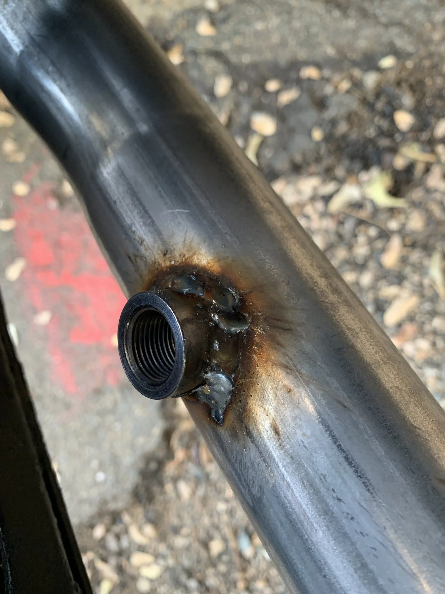

Finally took it in and got an exhaust burned in. Had an O2 bung placed for my Holley Sniper addition. And of course replaced all SAE hardware the hot rod shop used with metric bits
