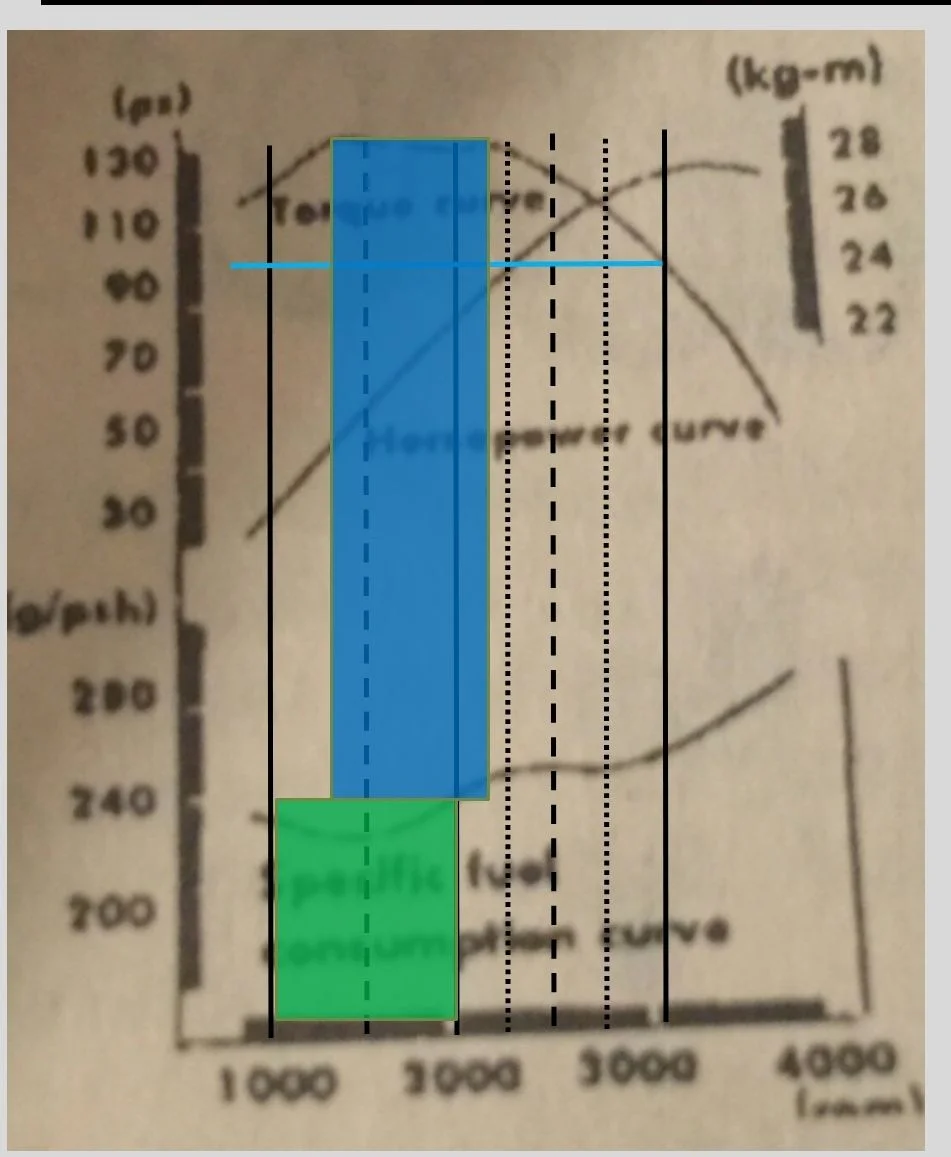

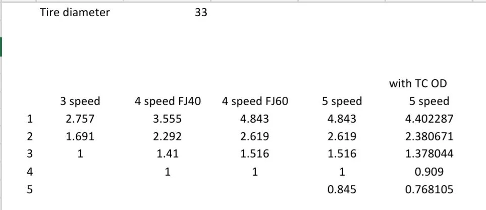

Below is what I am building for my other FJ40
H55F with 3:1 low in the transfercase with 10% over drive high kit. You can get that kit from Crusier Outfitters or Georg at Cruiser Brothers .
Combined with 33s and 3:70s your good for flat stretches of highway given the 210ft*lb torque band. The benefit with the OD is it helps manage the steep 4.85:1 first gear.
With this combo you get the road manners of an old H42 but if you go on the rocks you have 4.85 first with 3:1 in T/C
This is some cool research - how did you figure out the fuel consumption curve?
Curious - is there such a thing as a transfer case overdrive gear (without something like adding a second overdrive case like a Fairey or Ranger).
I’ll be sticking with 4.11 gears at least in the foreseeable future. I think last time I ran it through the gearing calculations I’d be shifting out of 1st around 11mph instead of 15mph which doesn’t sound too insane.
I’m also running a 350 V8 which spoils higher than the 2F so as long as I don’t mind being deaf I’ve got a little more headroom. The old SP2P fuel crisis intake I’m running falls on its face around 4000RPM but so far I actually think it’s a perfect intake for a truck like this. Tiny intake runners make for damn near perfect throttle response and the whole torque curve gets pushed downhill a bit.
The fuel consumption curve is from Toyota from an old sales brochure

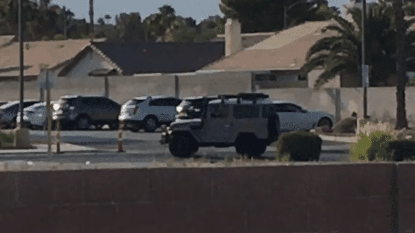

Sold her to a new, much younger Vegas MUDder. She’s in good hands and will have many more opportunities to “live deliberately”, than she would have had with me.
Goodbye 44, thank you for many great adventures and many great memories!!

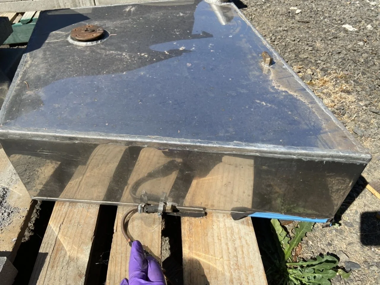

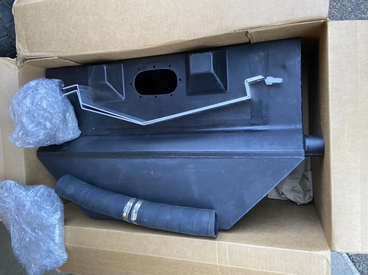

Got my new fuel cell from @65swb45 today in the mail. Now I can ditch the shiny but poorly made tank a PO had put in.

Are you going to cut in a new fuel door towards the rear and delete the stock door? Considering doing this but unsure how I want to route the filler neck?
It’s a sad day my friend. I understand why... because it’s been much too long since I have got off the beaten path.
I hear ya, John!
In my case, I simply don’t see myself being able to get back out in 44. I hope to be able to drive my Tundra and sleep in my 20’ travel trailer and have less painful adventures, going forward.
So, I saw no reason to postpone the inevitable and chance causing my Wife to have deal with selling something as extraordinary as 44.
