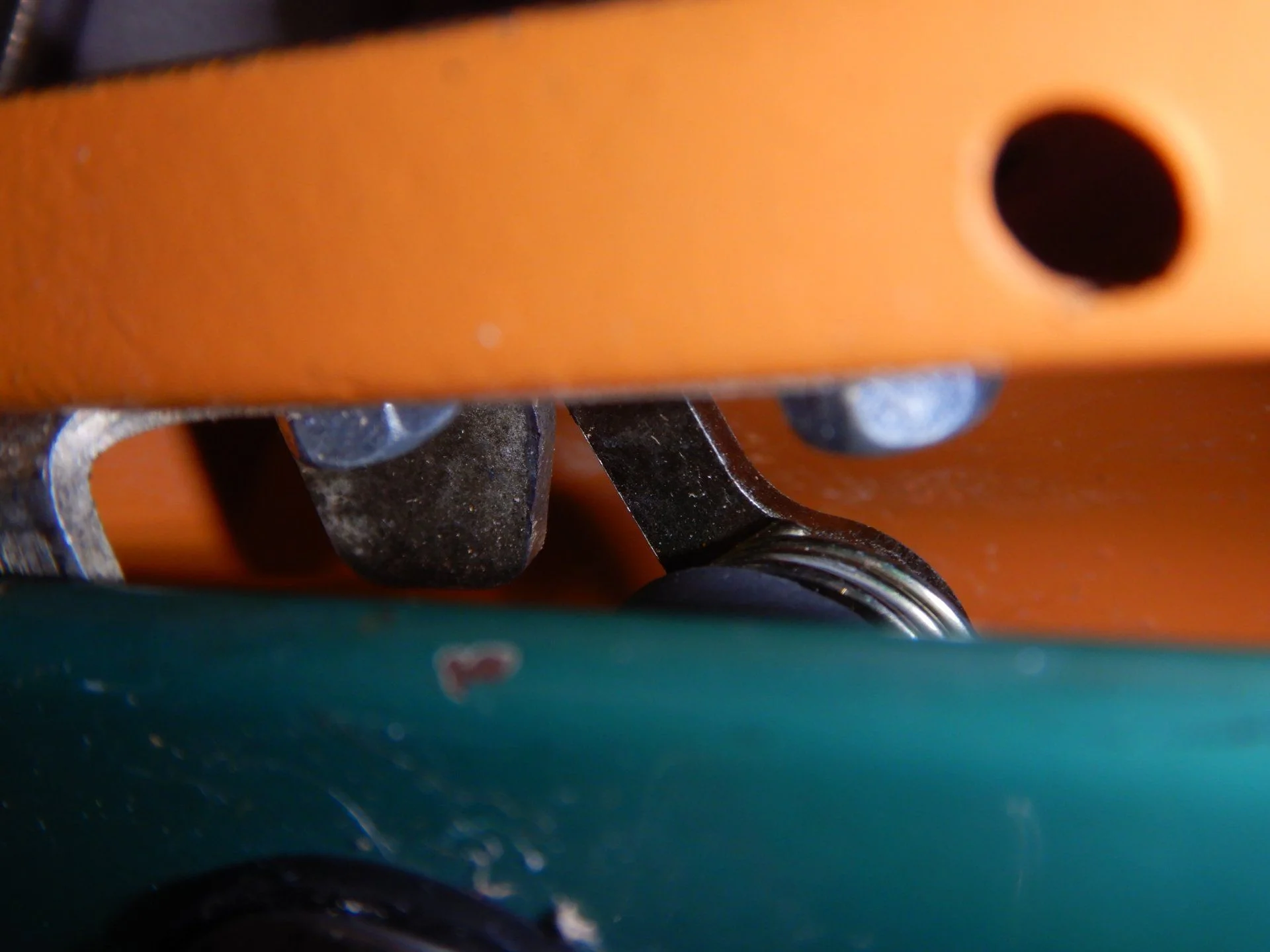

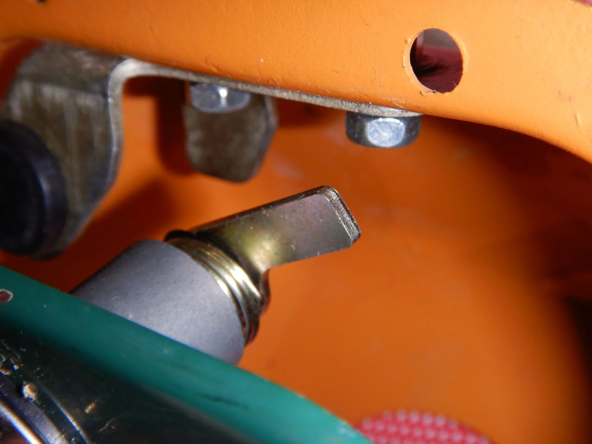

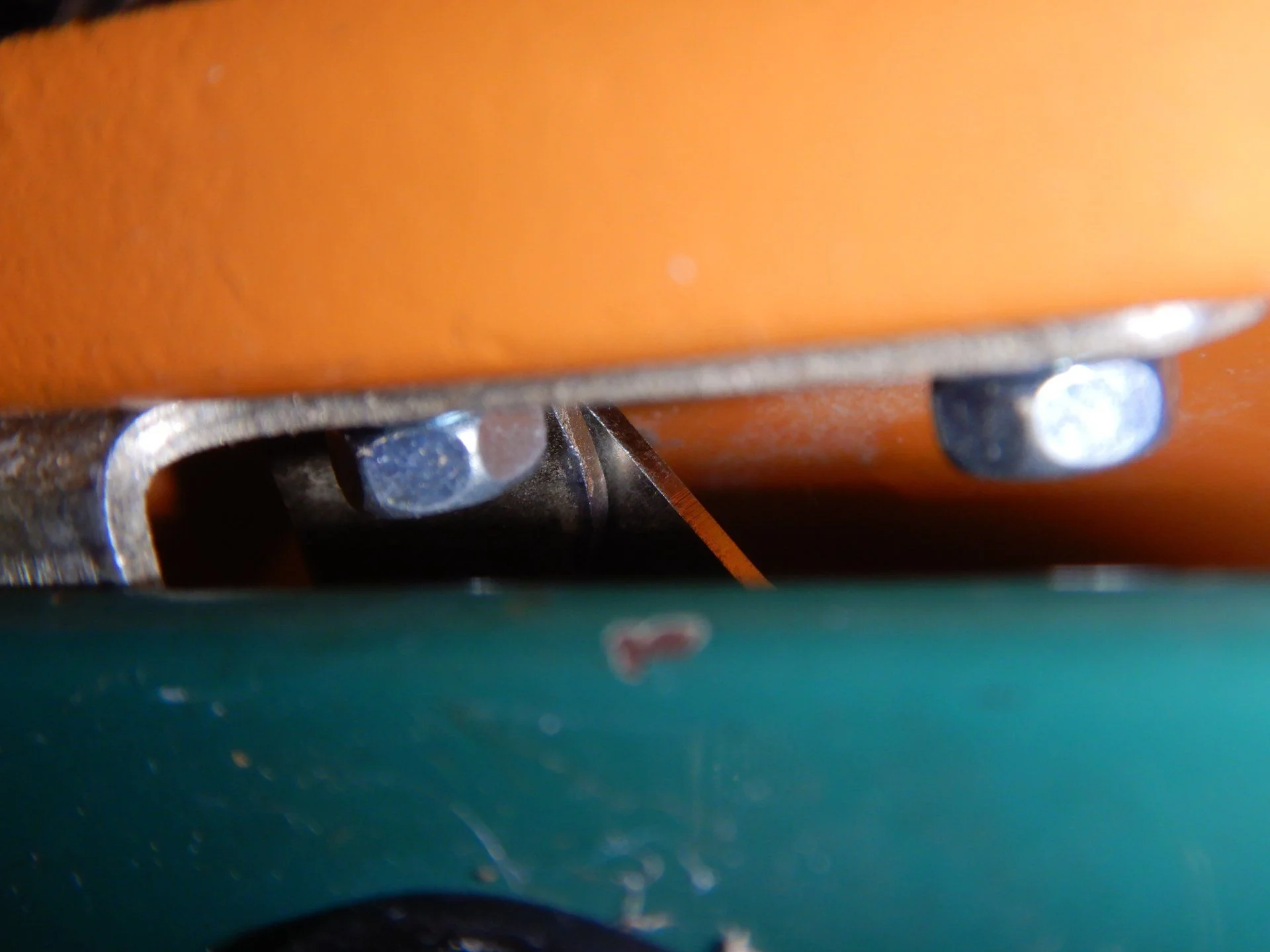

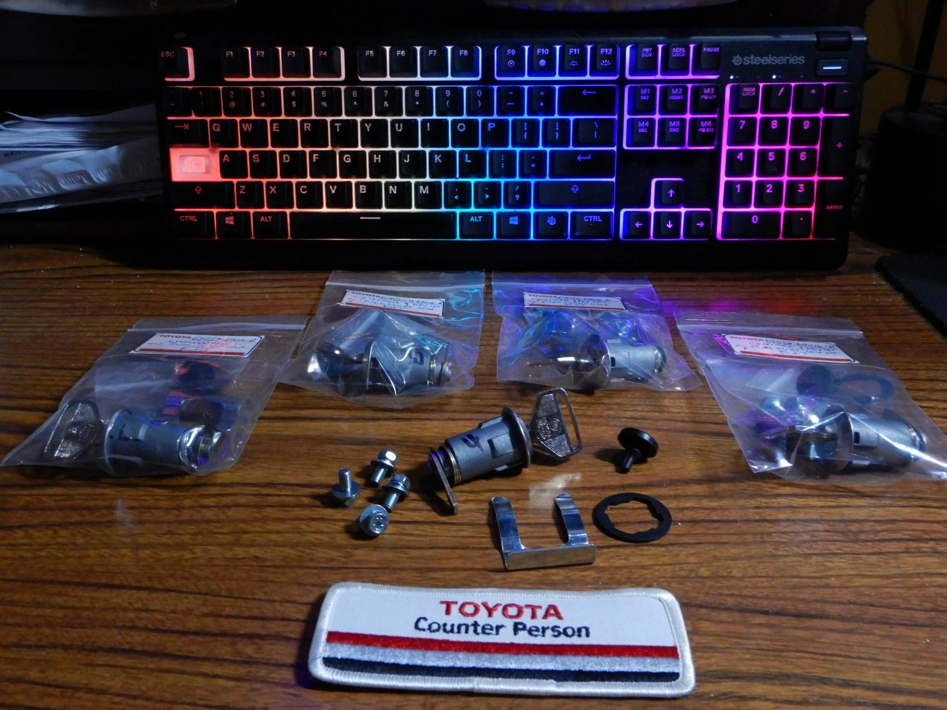

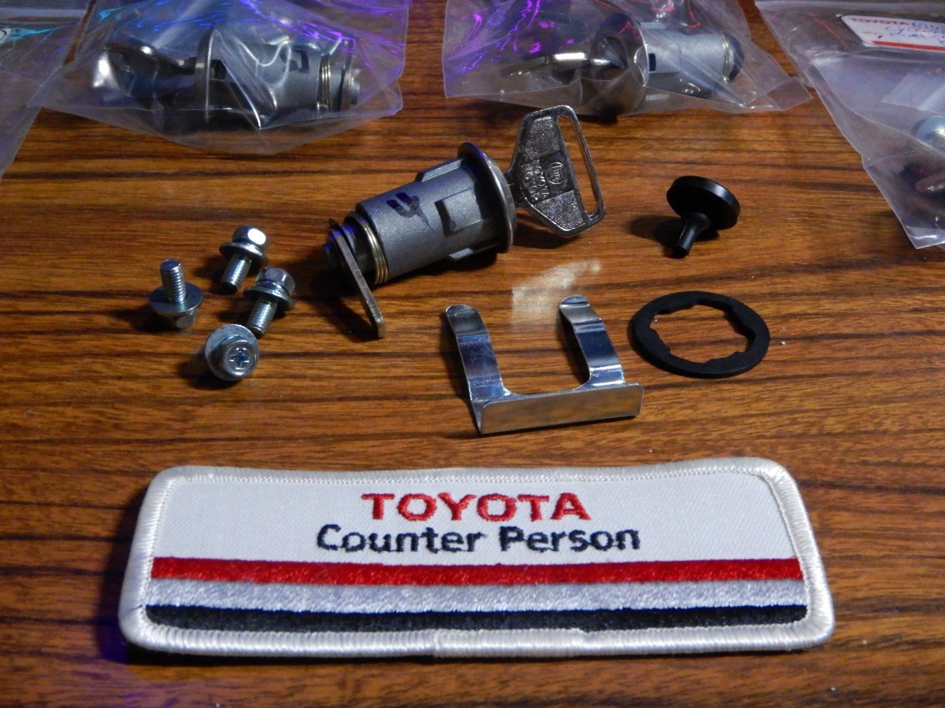

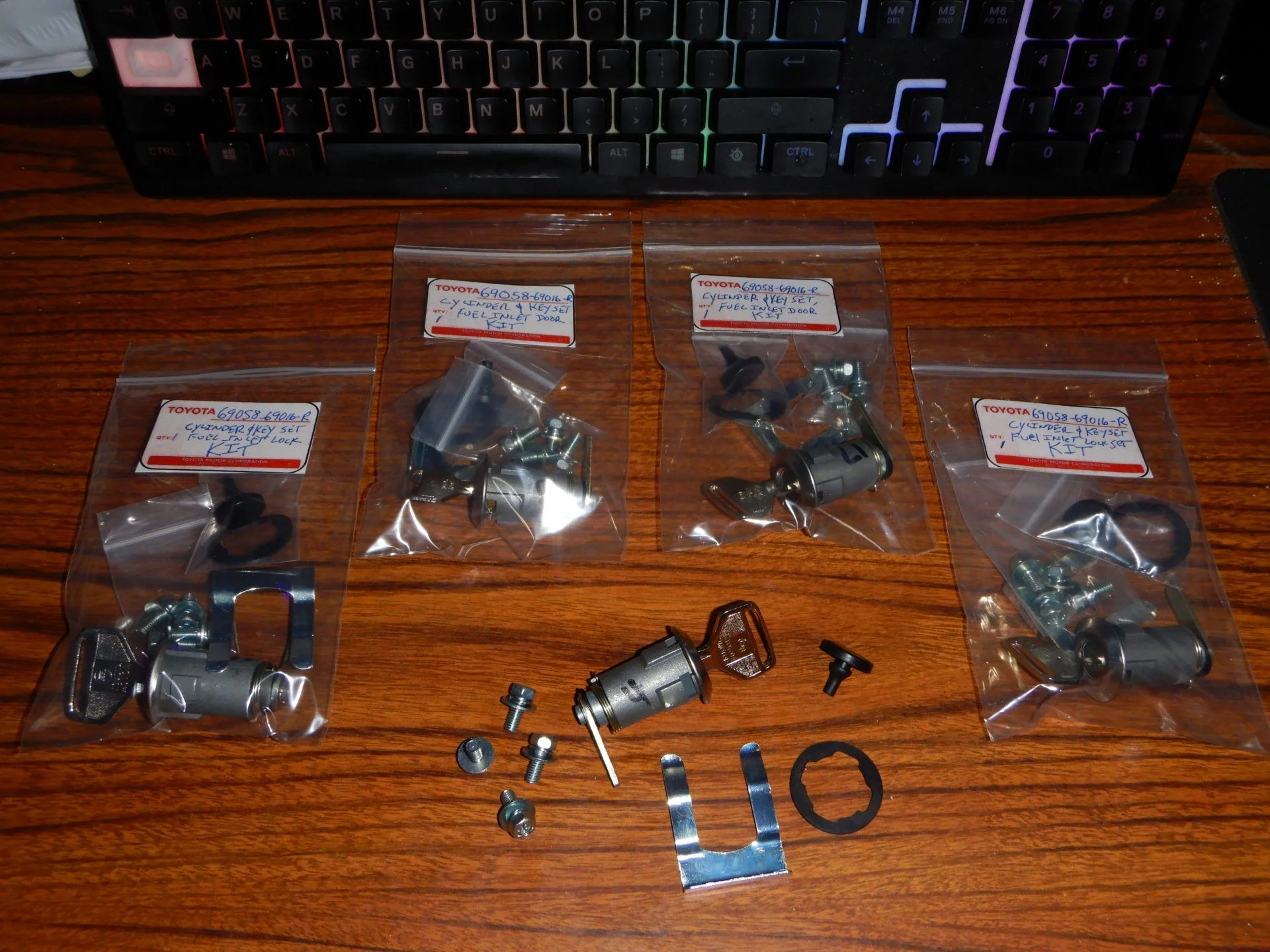

-some news about my adventures with 69058-69016-R CYLINDER & KEY SET, FUEL INLET LOCK ,
i have been putting the final touches on the needed and desired parts kit required to install a New OEM 69058-69016-R Fuel Door Lock Assy .
on / in a 72-12/78 FJ40 . Working with another member in tandem , we did a few dry runs form start to finish indeed hoping to run into
a UN-inticpated step or minor unforeseen issue i had not thought of very deeply on paper , prior to the test fit and prototype riggers phase ...
to our delight we only found one !
it WILL be necessary by some but not all folks to Adjust by hand either there 61802-90300 COVER SUB-ASSEMBLY, FUEL INLET BOX
or " Fuel Door " for short :D
or
there
61824-90301, RETAINER, FUEL INLET CUSHION, so this made it clear to add the four 5mm machine screws that affix both to the
tub and inlet filler box itself .
i had the best possible OEM Toyota fastner needed in my head in seconds and in my hands in moments , my long time trusty
:93385-15012
: SCREW, W / WASHER ....
i have been using these
little bad boy problem solvers since High School and never looked back , Both the Cushion retainer and Cover Hinge itself use, or ..............DO USE NOW ! , the same exact fastener . :D
- Since the only short term Notable wear item can really be the Rubber Cushion itself , i ordered up a Qty x 50 pack that day without giving a 2nd thought .....
- The new OEM Black Rubber Exterior Lock Pad & New OEM Clamp , or Retainer were no-brainers as well and where i had indeed planned in advance to include the black rubber Pad , it only became more then apparent during multiple installs and removals , the Shinny New Silver
JAPAN , Parts Zinc Plating Aided in the easy sliding in and catching of the de-tent spring design of the OEM retainer clamp ......
SCREW Rusty lock cylinder Retainer Clips and old Dry-Rotted Black Rubber Pads as well ! Like Seriously Screw Them 😇
Final-Fit and a
Final Polished Factory-Finish is the idea & concept here and NOW a reality as you will see in my TECH. Photos below ...
i am still not convinced 100% that all 1972-12/78 40 Series came with Factory installed Black rubber lock pad to begin with either ?
may have been a later model update towards 12/78 ?
well ..................🤔
Now they ALL Do ! 😎

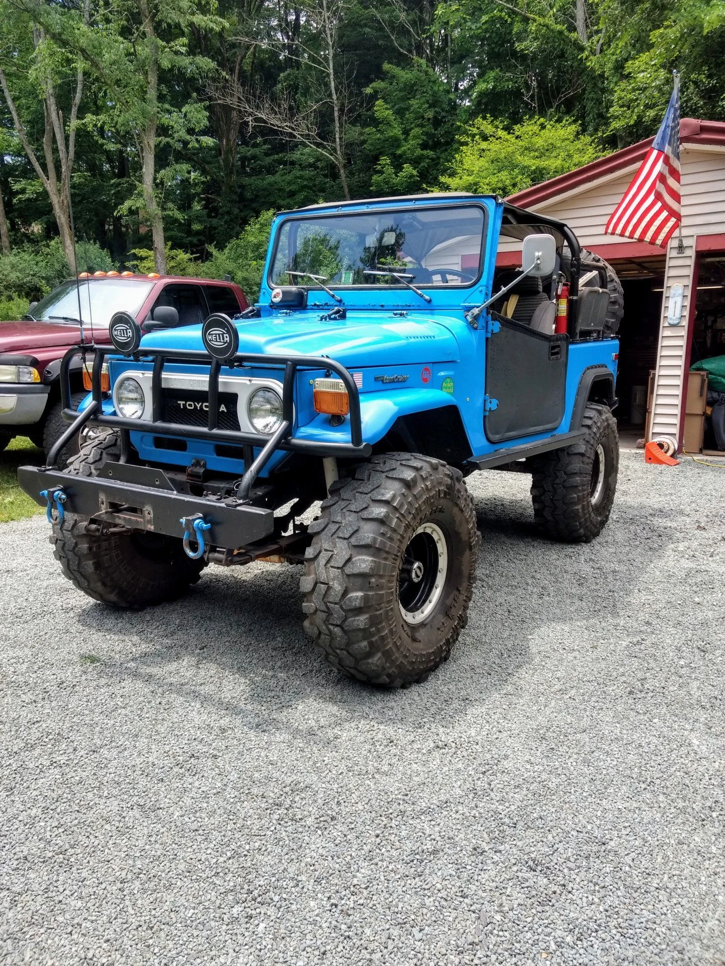

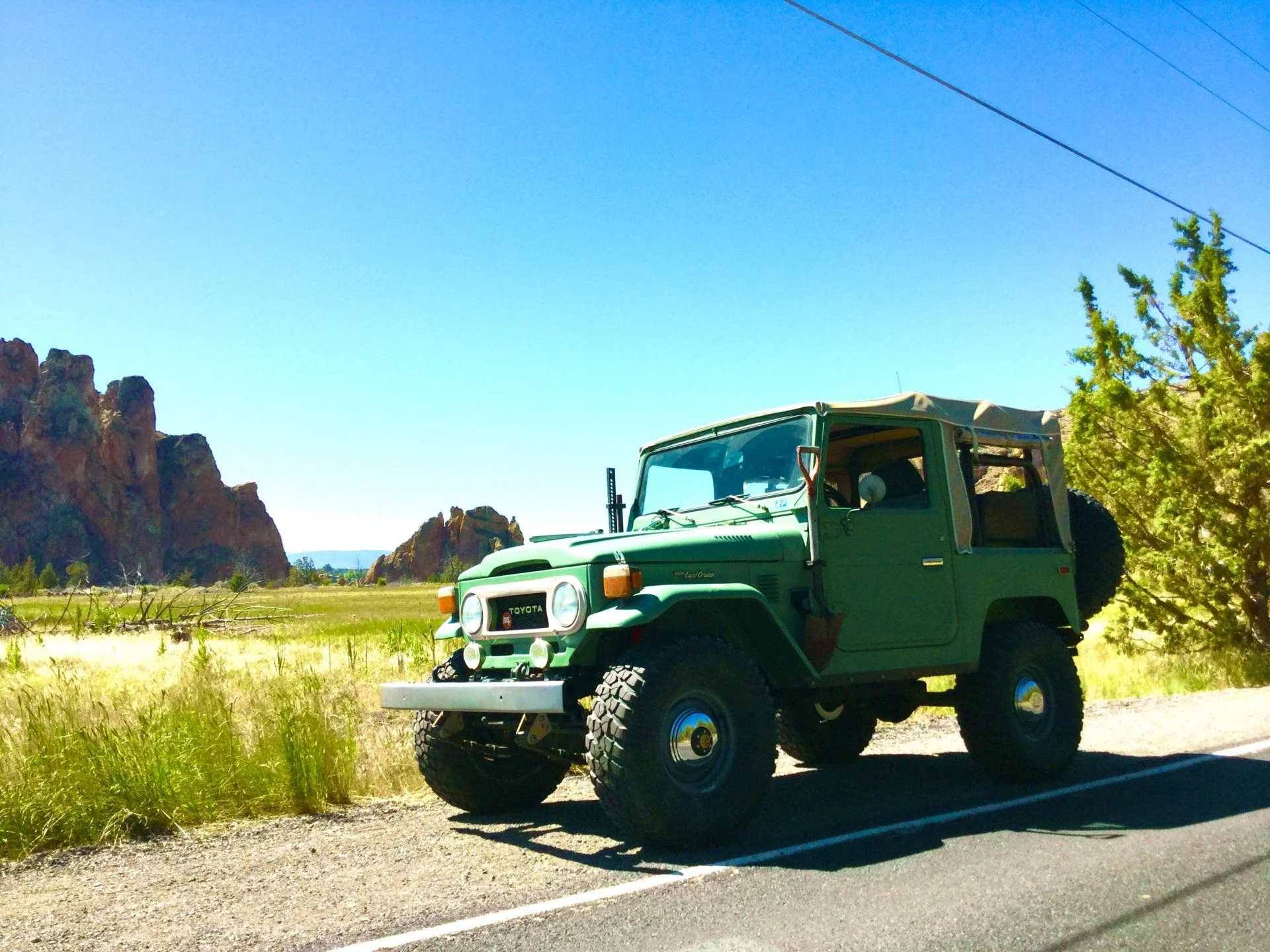

Summer rain shower brought some nice cool temps..... girl hasn’t been out all week so away we go! Stopped by a quiet cove my wife and I like to put our boards in.........
Photo op ;)

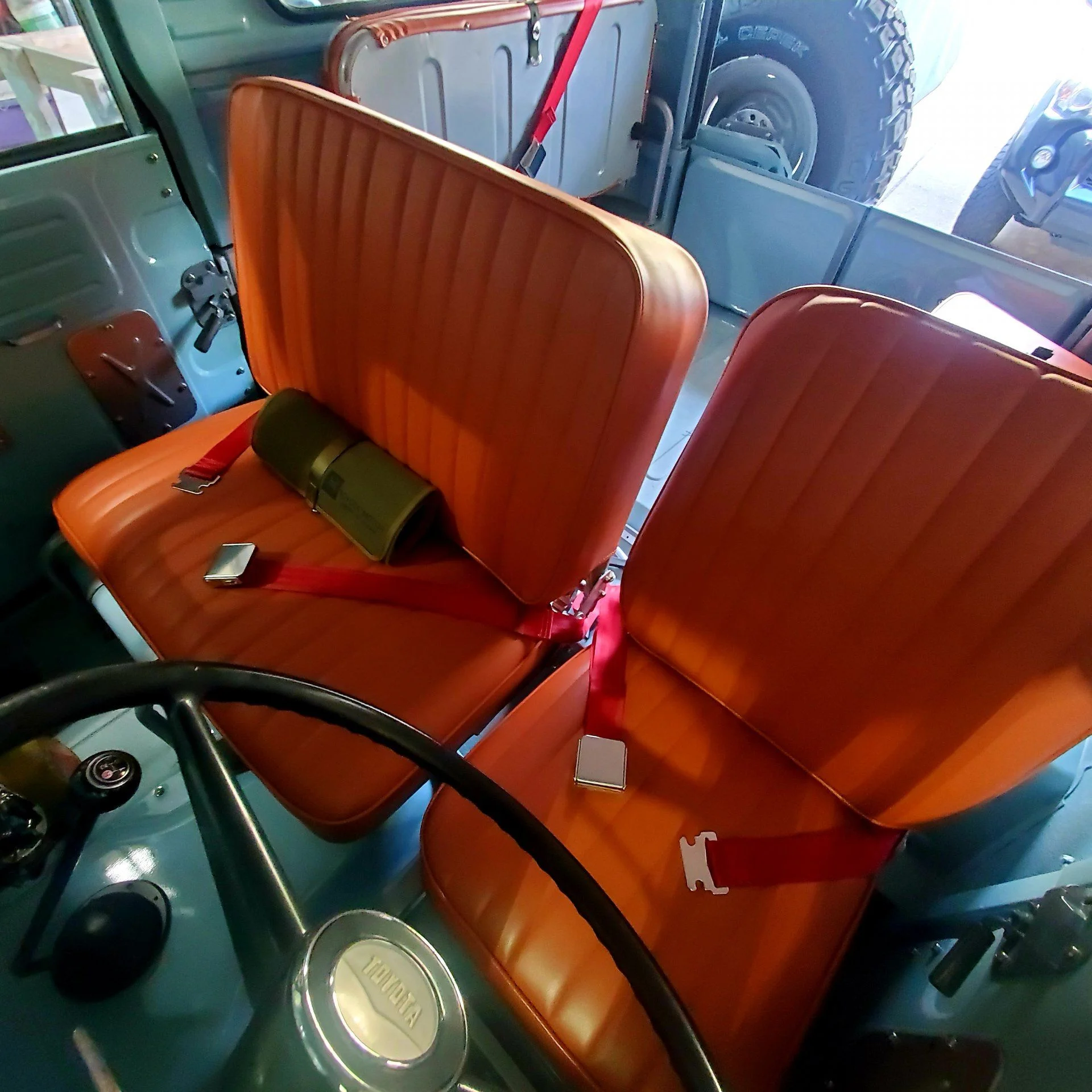

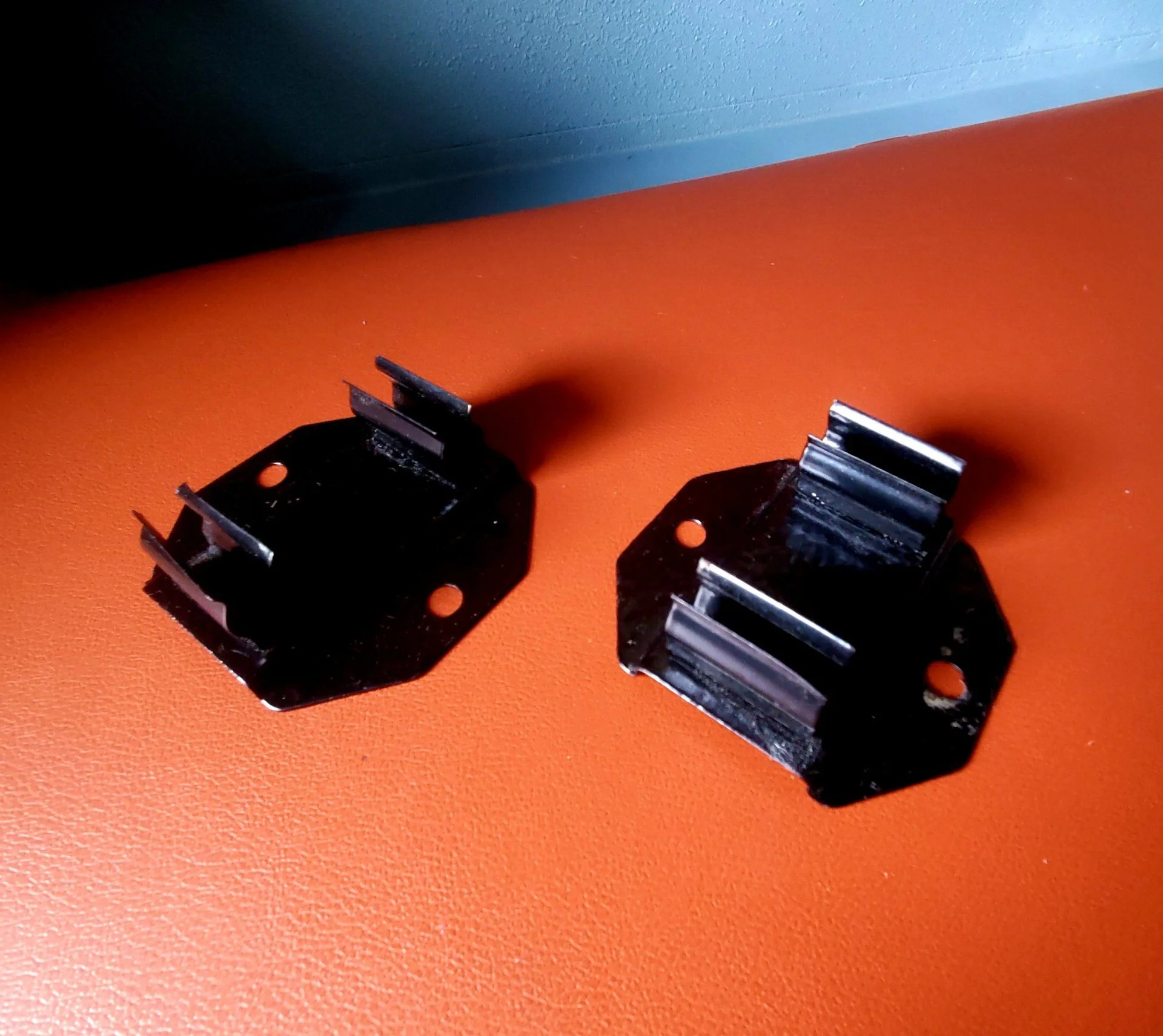

Started buttoning up the interior on the 64.
Wondering if these jack rod holders are stock for my 64?
I have never really seen this type before.
Love the tool roll. Need to buy a couple more if they ever come up for sale again.

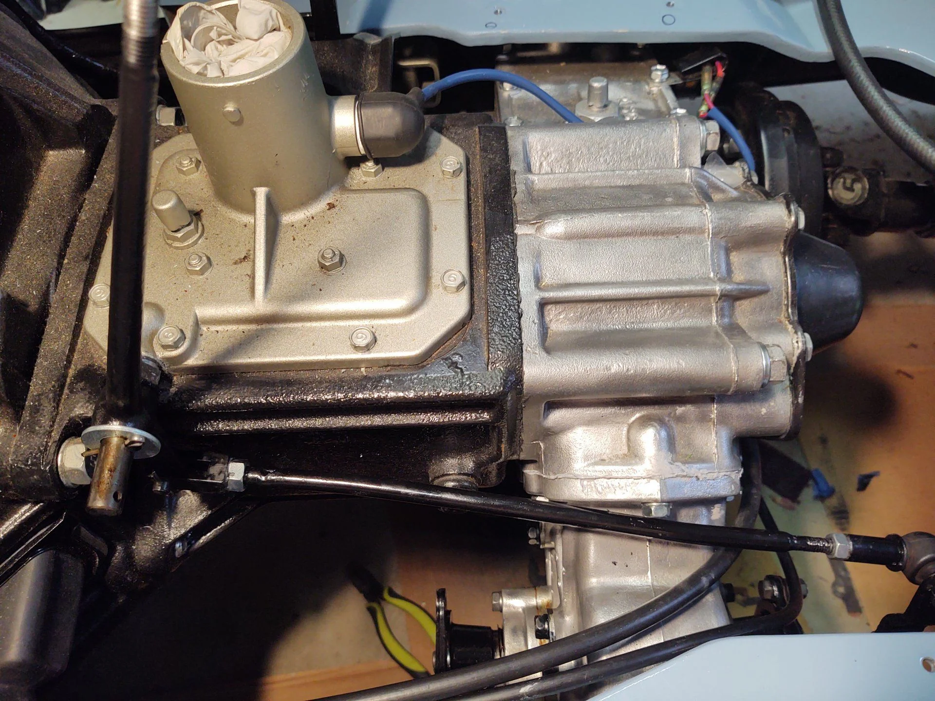

With the PTO gearbox installed, I was able to attach the engagement linkage:

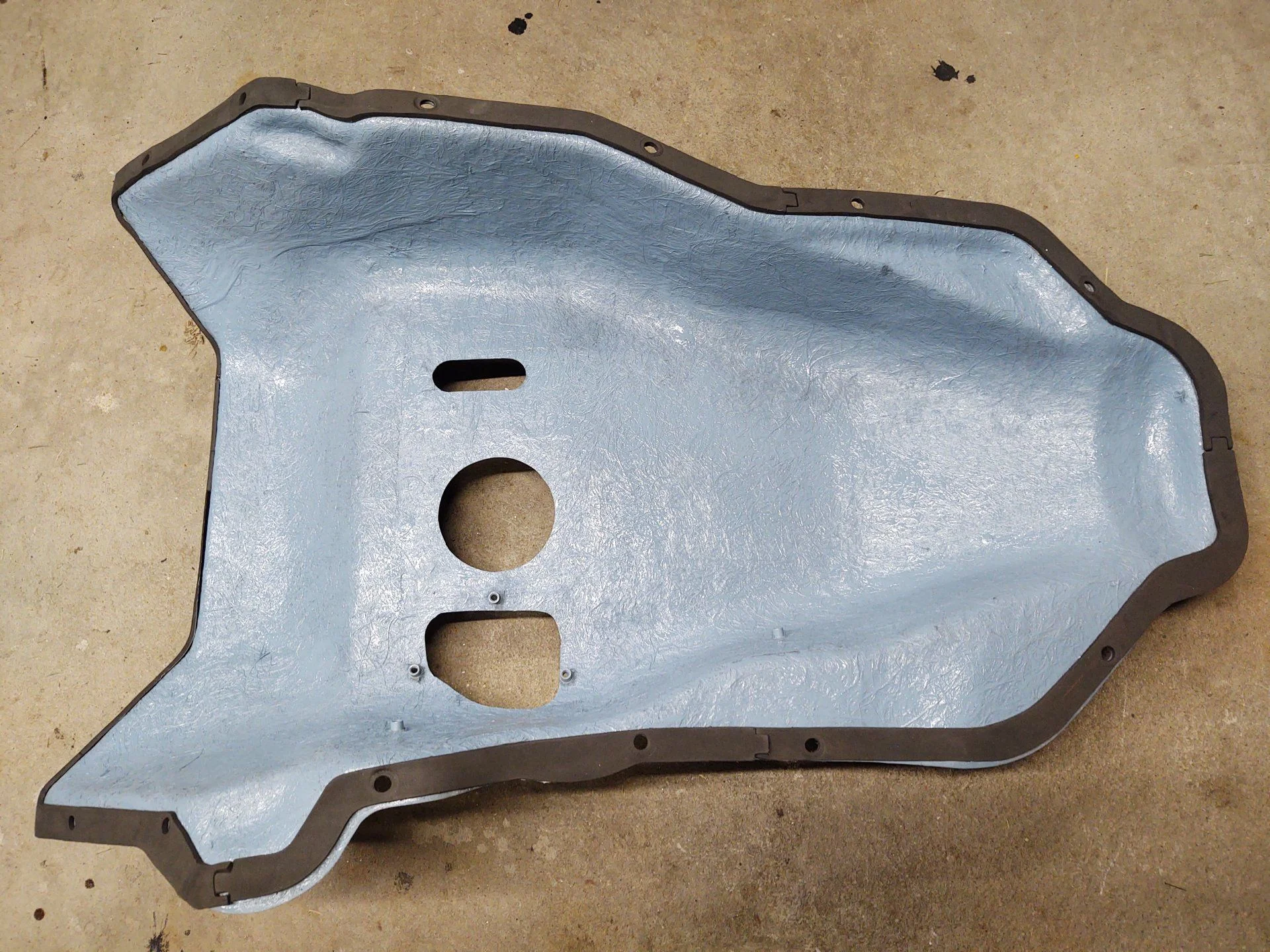

Now to get the tranny tunnel cover ready. SOR fiberglass cover and gasket set:

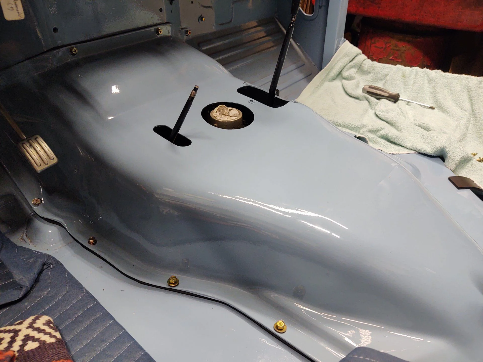

Finally, in place, screwed down. Fairly good fit, but warped a little in the rear. The screws pulled it down pretty well.
I was very happy with my "guessitmates" on locating the transfer case lever and PTO lever cutouts.

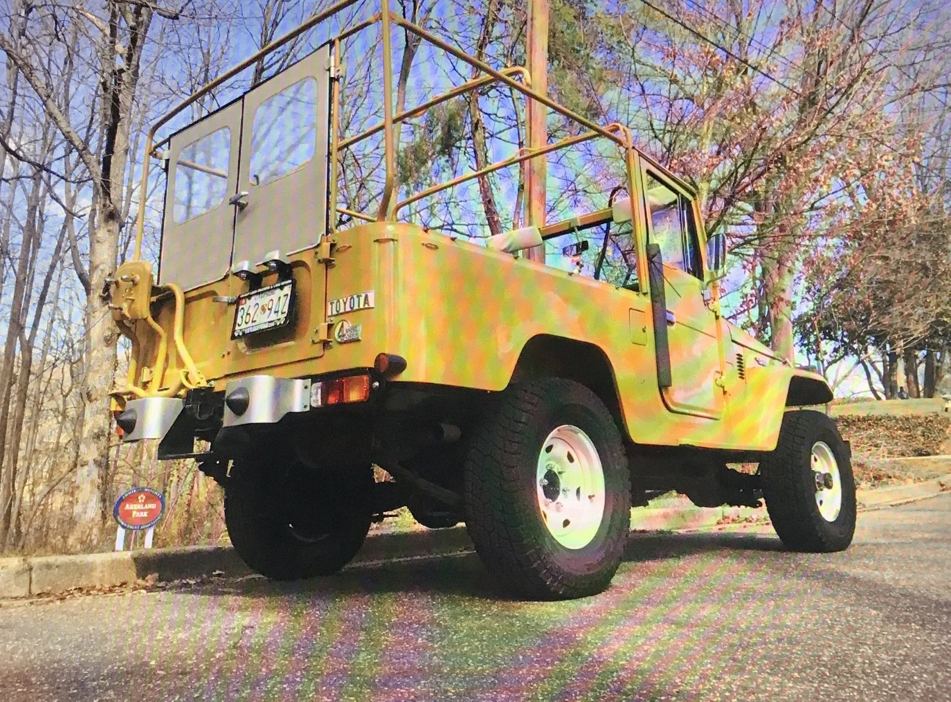

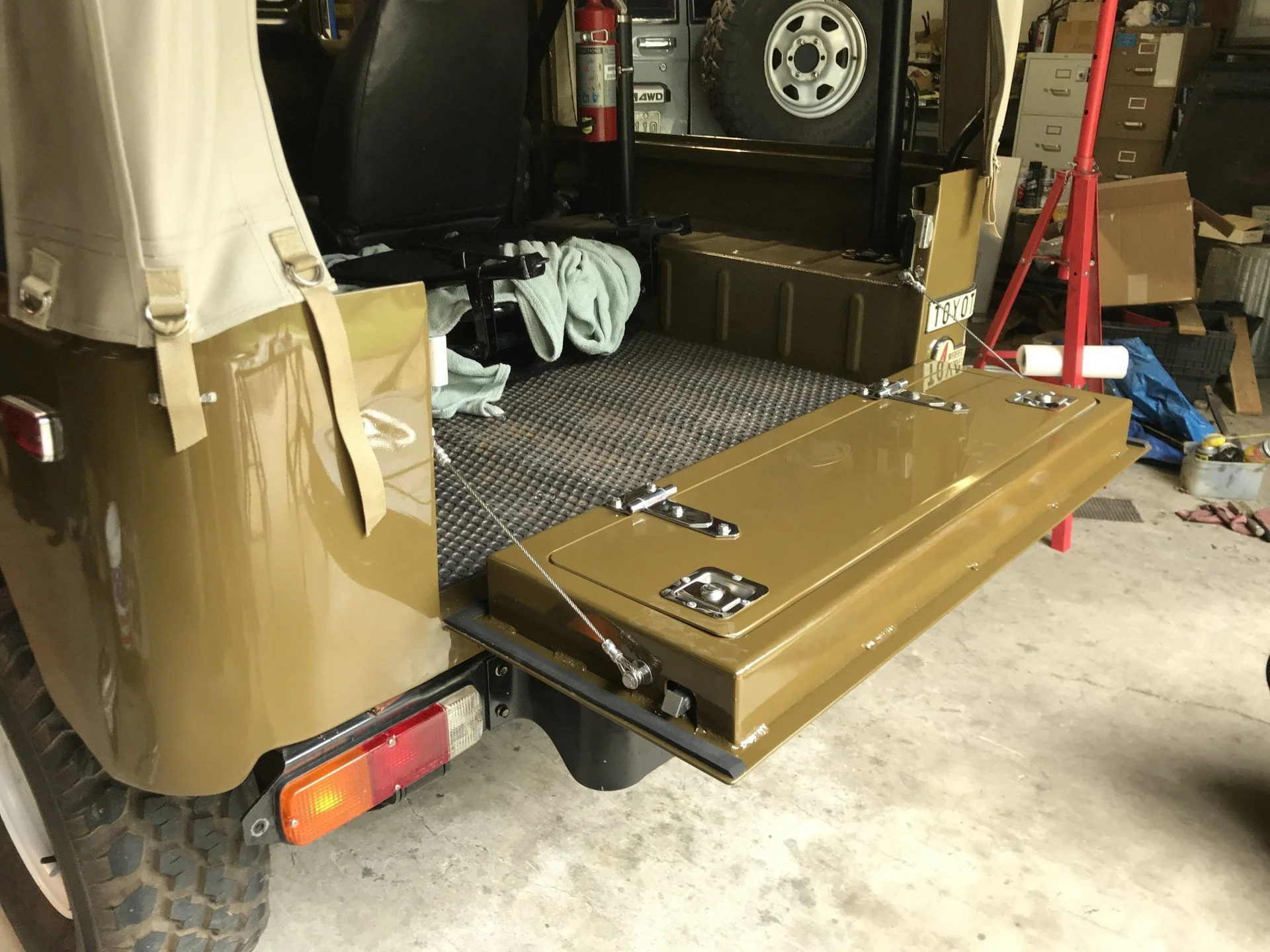

With the help of @LDowney, we got my tailgate mounted this past weekend!
That tail gate looks Sharp ! 😃
please post photo's of of sinched up and closed when you can
i have been looking at something similar for my 1983 FJ43L-KC so i do not have to separate the steel barn door lower / FST upper Combination
set up ?
this has been on my mind hard in the last week ......
i have been forced to sport around for many years with them still in place , and it looks ............:rolleyes:
