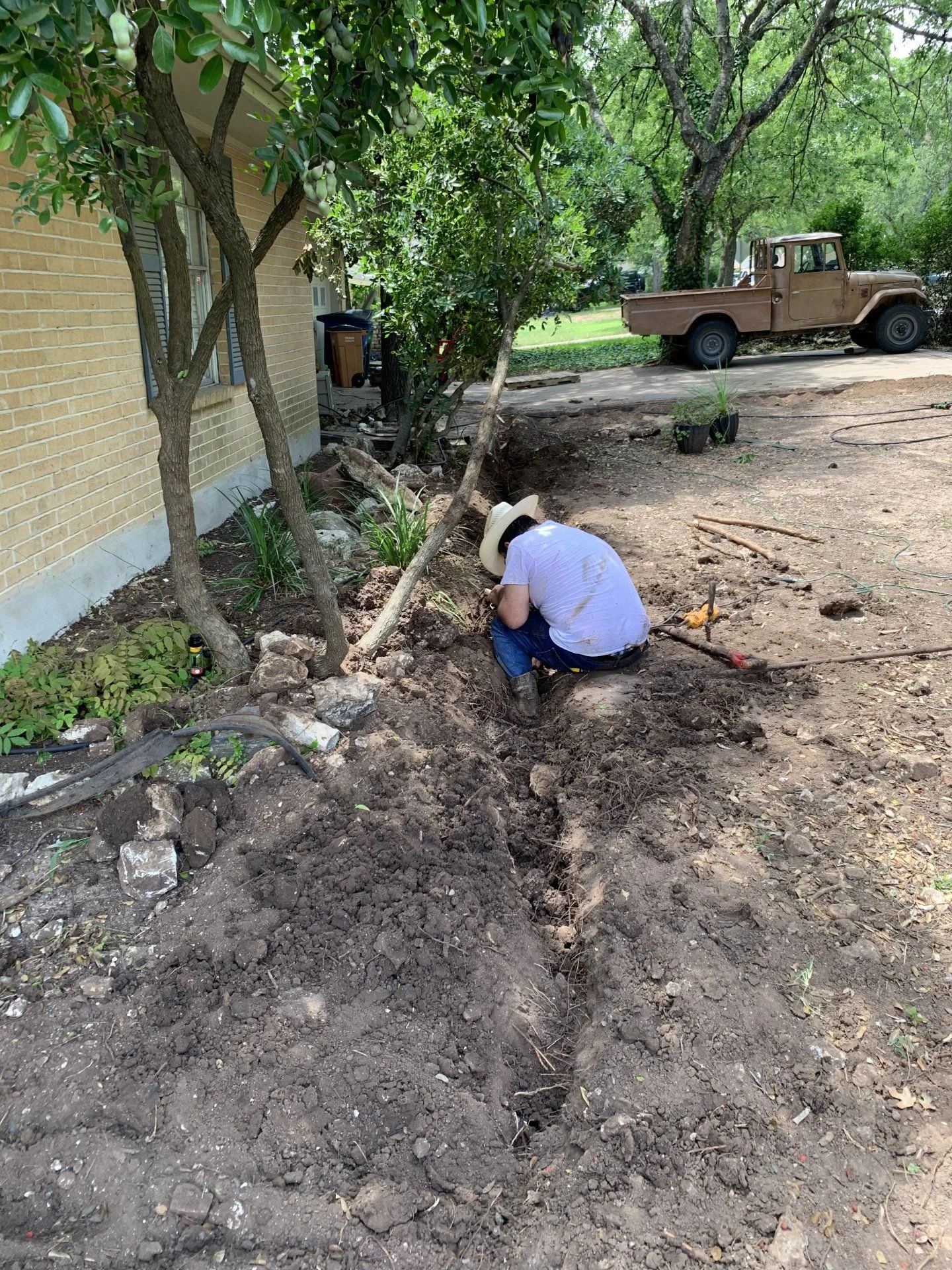

The 45 also supervised my trenching work in the front yard... haha

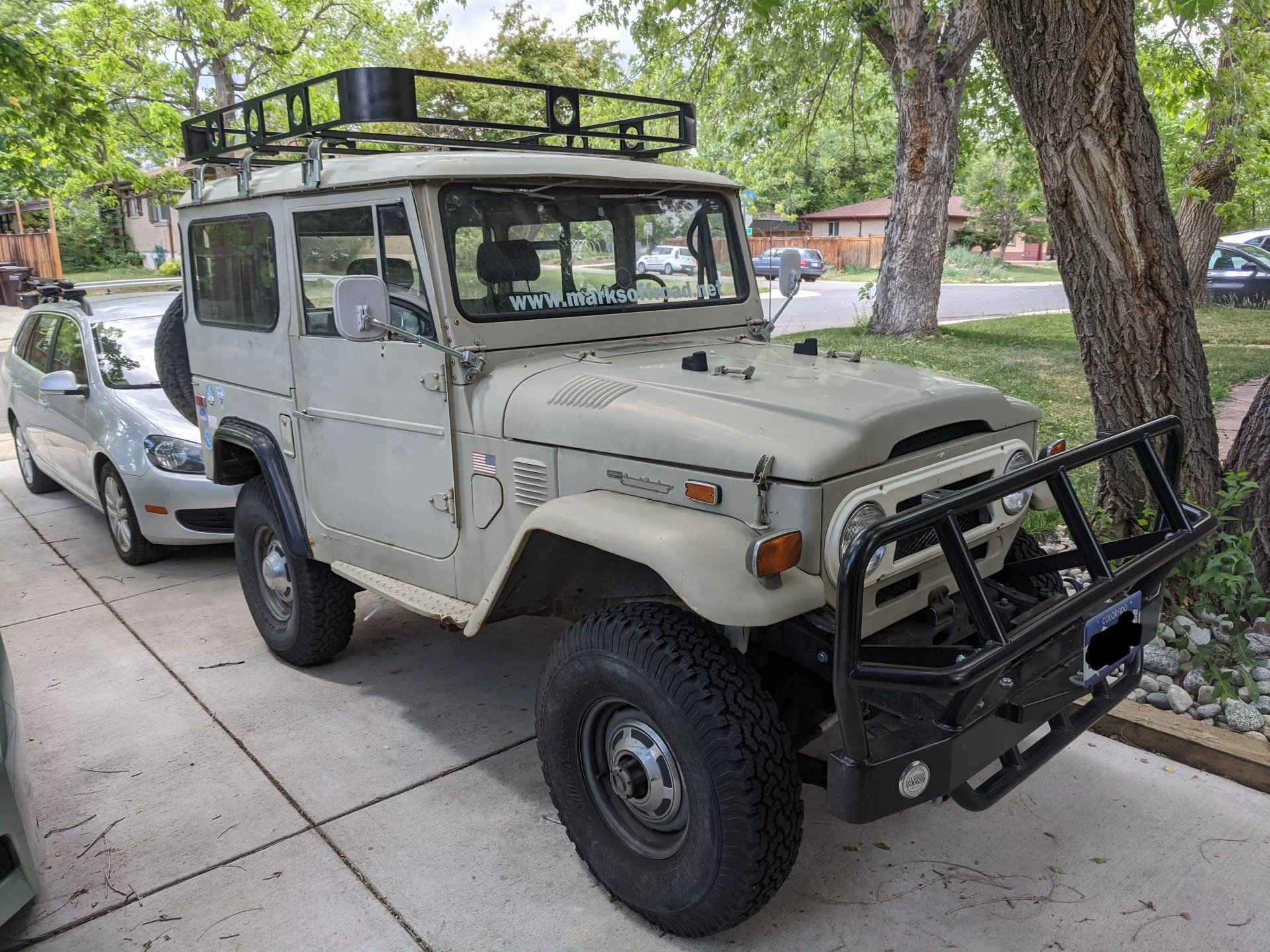

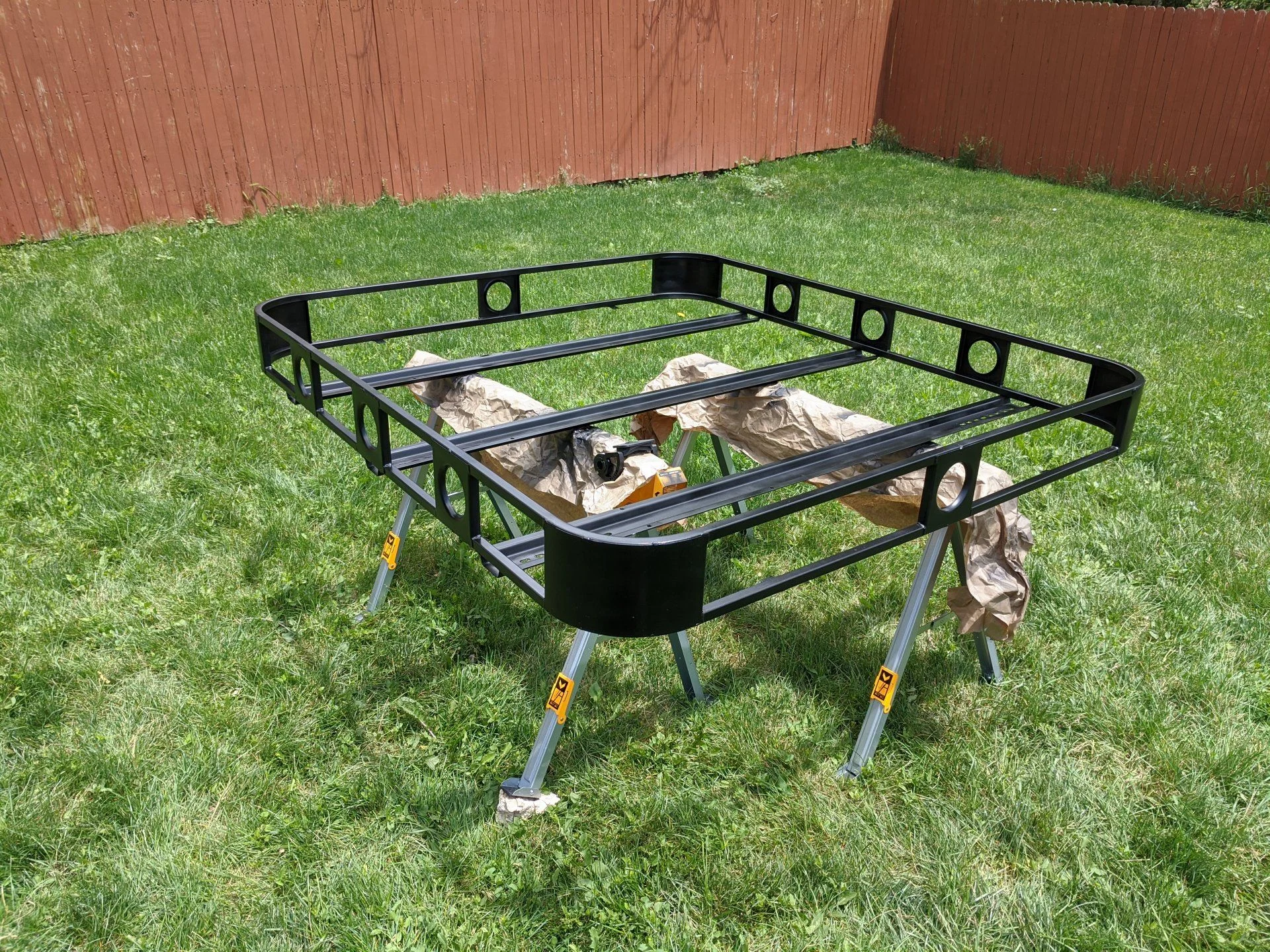

Picked up a Con-Fer basket locally for cheap.
Cleaned up the rust, painted it with rust reformer and semi-gloss enamel and mounted it.
Before
Painted
Installed
I'm going to put the chicken coop flooring in sometime soon.

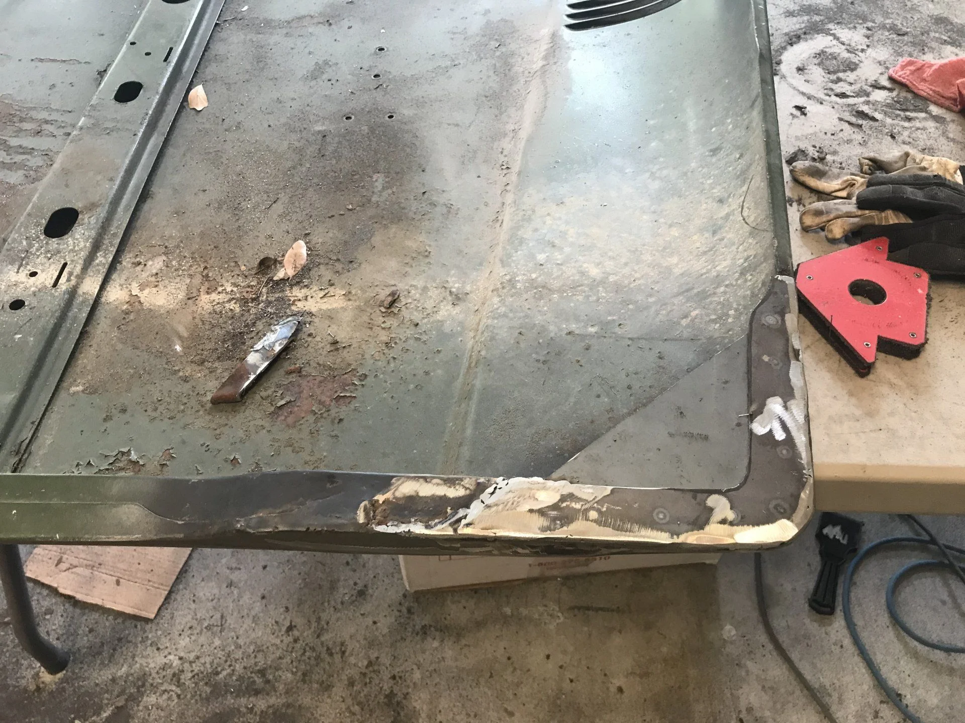

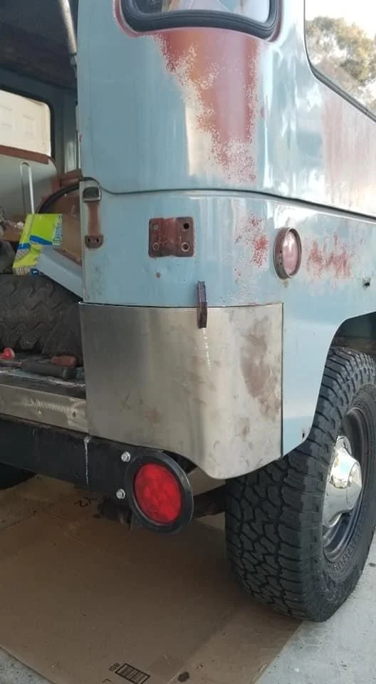

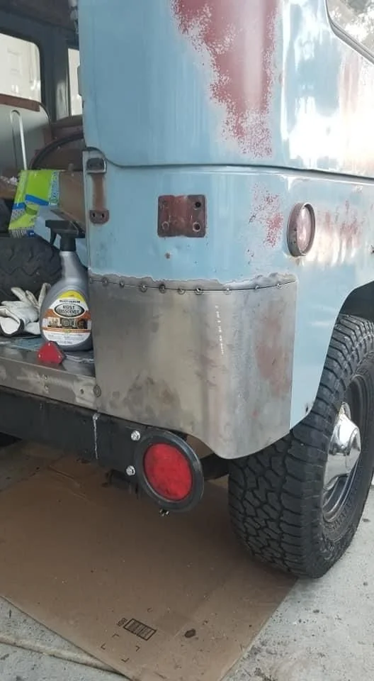

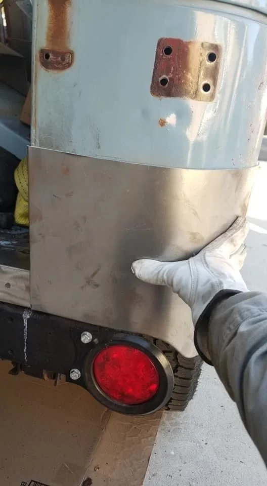

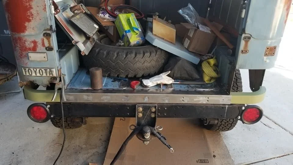

Had to remove the rear sill to put the rear sill brace in, the rear sill brace is fully welded to the rear sill, and the rear sill is tacked back into place. The quarter panel wasn't a direct fit, but it only needed to be massaged (lightly hammered) into place. It's all tacked into place and lined up perfectly, I'll be welding it all completely tomorrow. Truck will be for sale once finished.

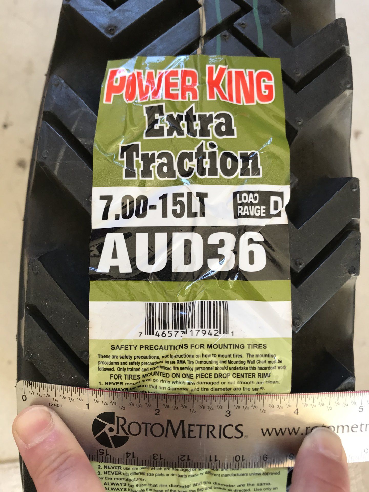

Bought a set of 5-tires; 700-15.
However, they seem extremely narrow compared to images I have seen. They are Power King Extra Traction and measure just under 5" at the tread width.
What did I do wrong! Is there a different model that is closer to 7"
Thanks
Lake
7.00" is the cross section, not the tread width. You're probably gong to have to go with a 9" cross section to get close to a 7" tread width.

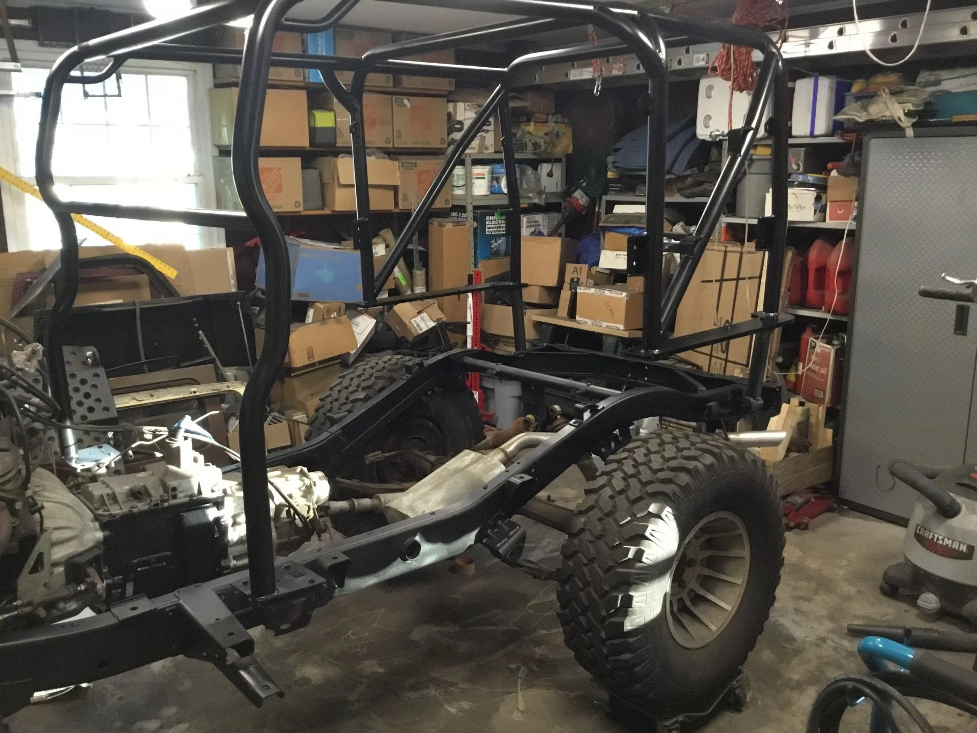

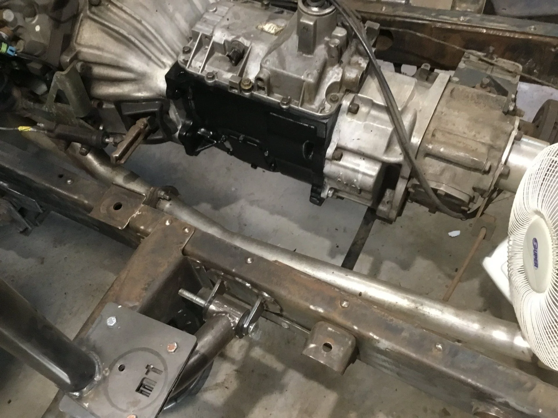

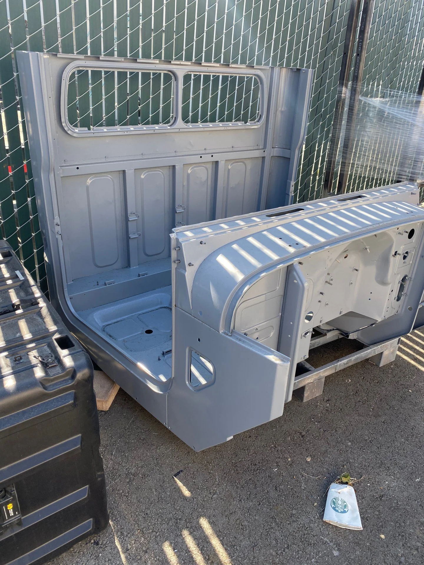

Sharing this...need to get back to it after everything opens back up
are all 45 tops the same? I can use the same top from fixed and removable?
They are not. Fixed top, removable top with latches, and later bolt on 45 tops are all a little different and don't interchange off the shelf. In the event you had one of each on the shelf.
