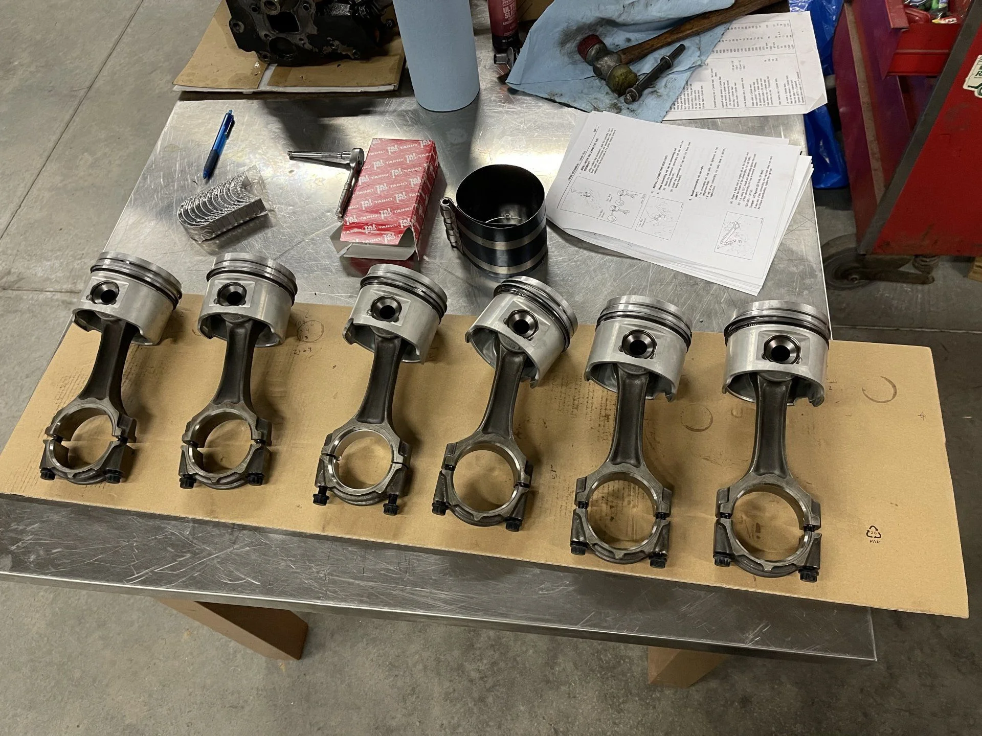

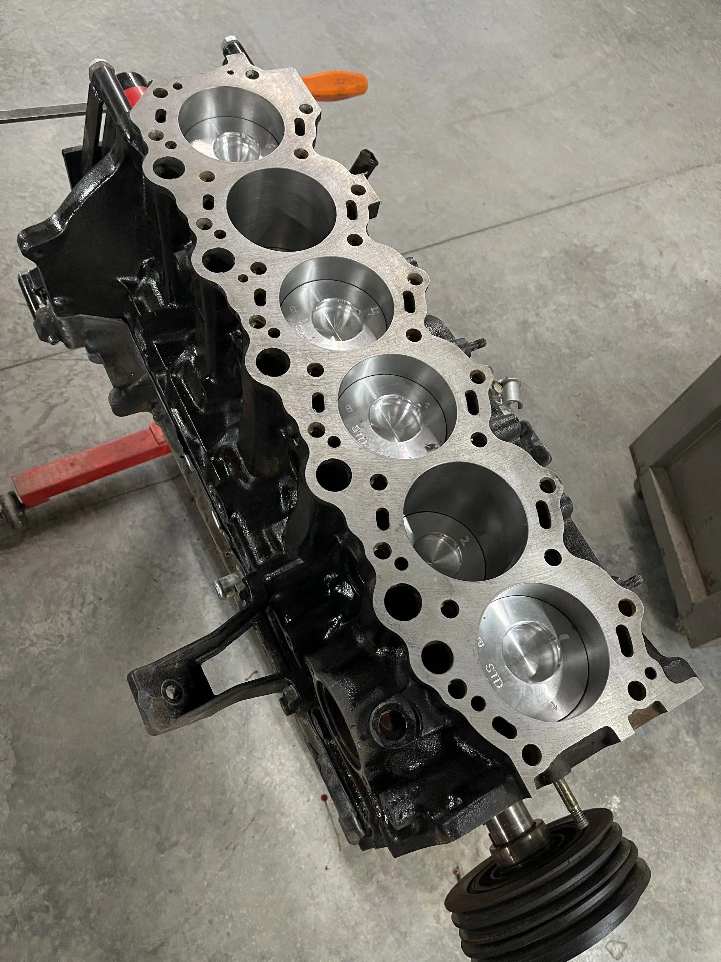

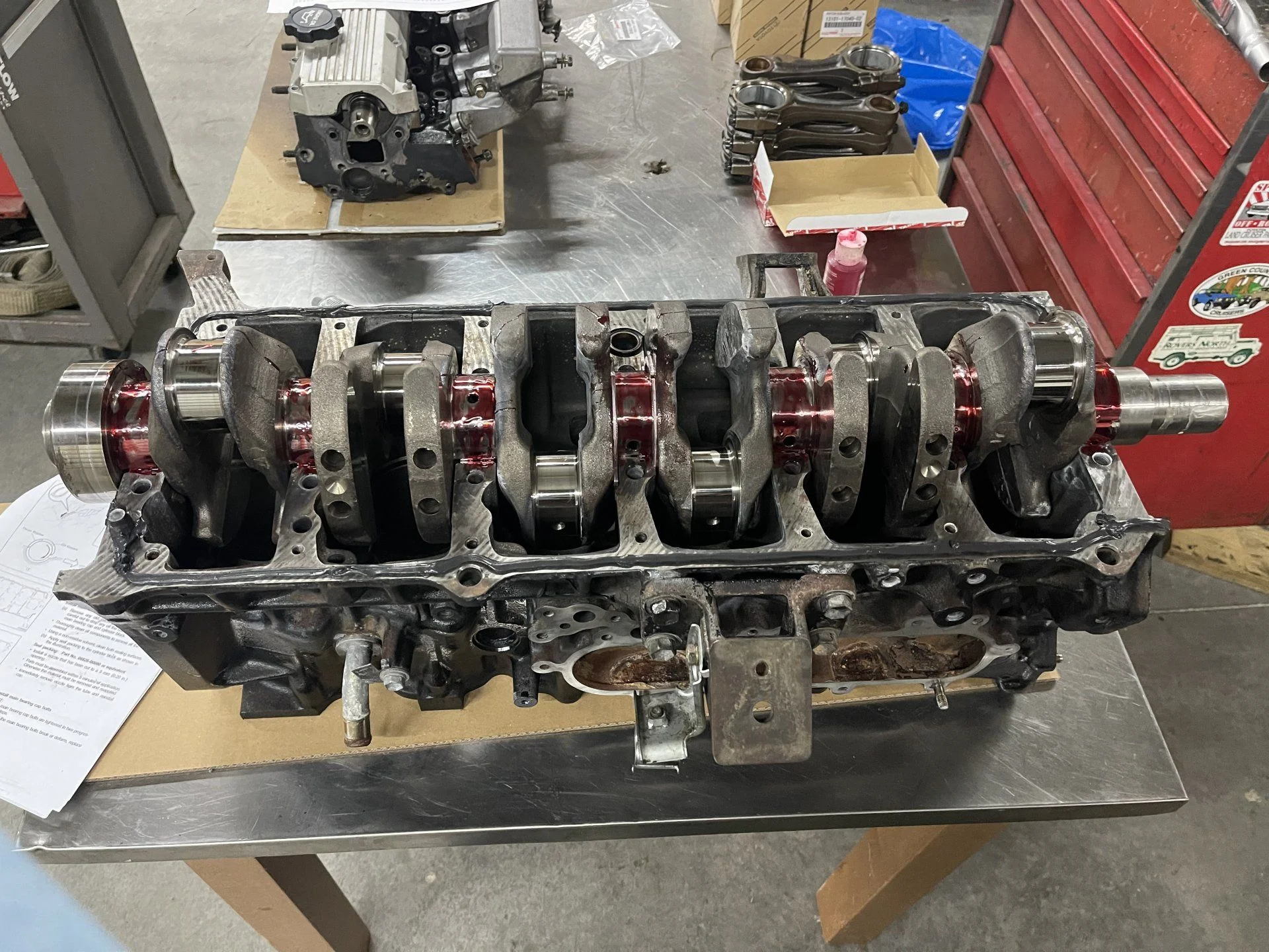

Machinist finally finished the block. Liners installed, bored to Std and polished the crank. That means It’s time to assemble. Cleaned the block up, chased threads, etc. installed new std main bearings, new std thrust bearings, crank and girdle.

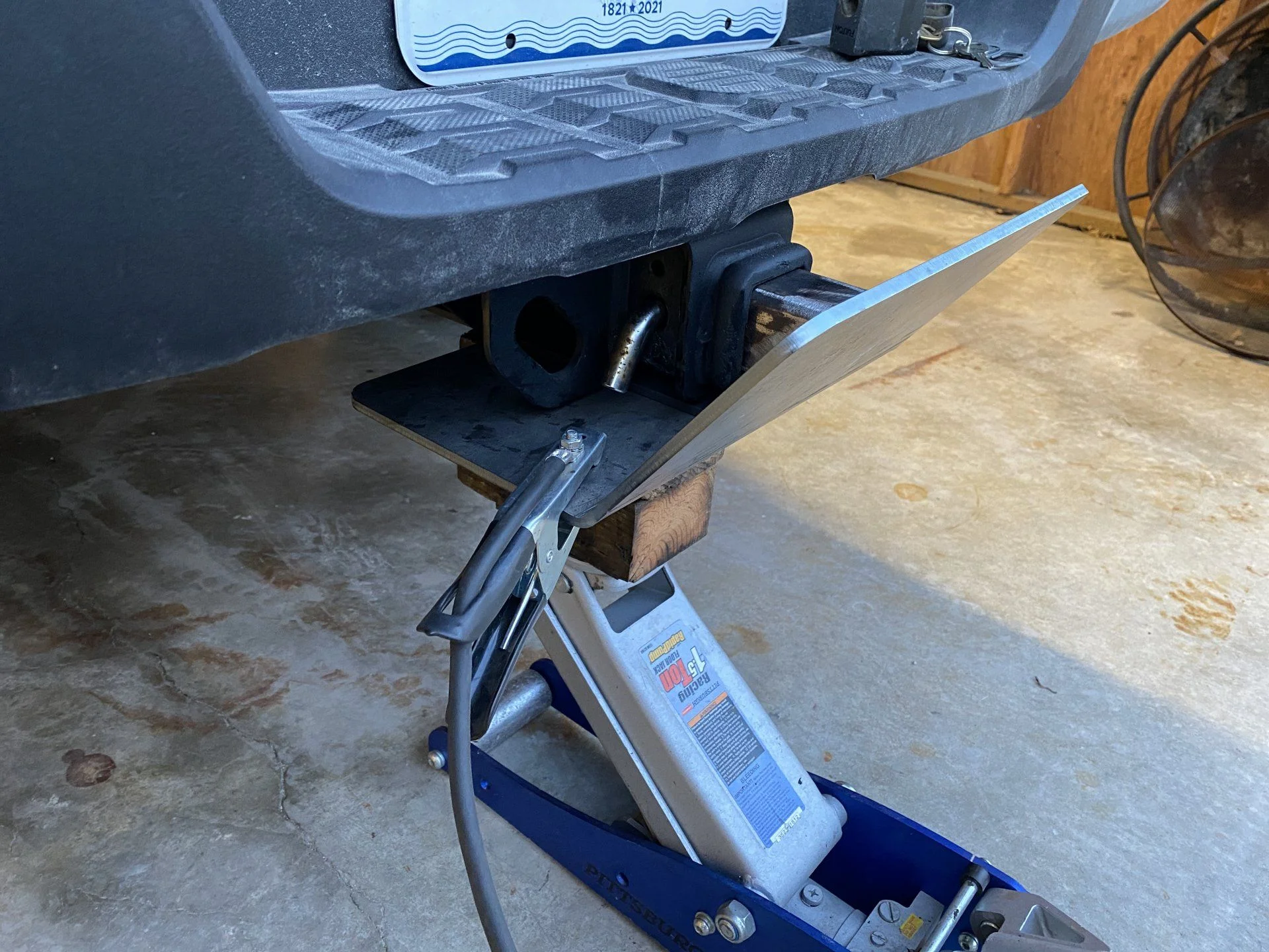

Getting ready for our upcoming trip to Moab and a buddy mentioned that I might think about a hitch skid plate for the Tacoma given the overhang and low lift. I looked online and got some ideas then searched through my scrap pile.
Not my best welds since one of the 120v legs to the shop is currently dead (just another thing to add to the project list). Double passed the hitch to plate welds and with a couple of gussets it should be strong enough for this trip.

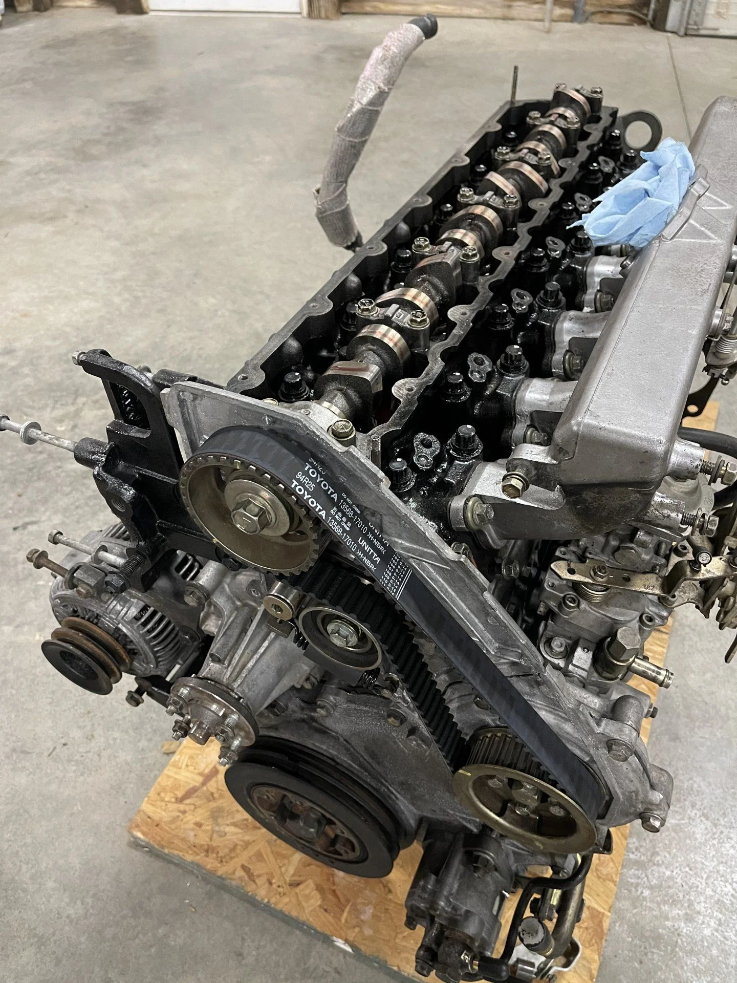

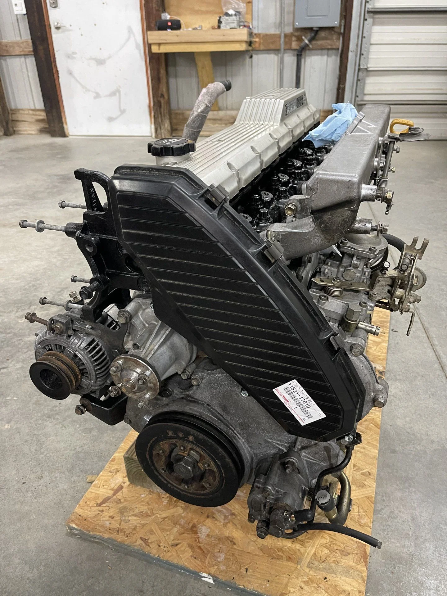

Staying up late.... installed head, camshaft, timing gear set, oil pump, p/s pump, vacuum pump, injection pump, oil cooler, timing belt assembly, new timing belt cover, alternator, and thermostat. New OEM crank, cam, and IP seals, OEM gaskets, etc.
should be able to get it finished up tonight and hopefully installed this weekend.

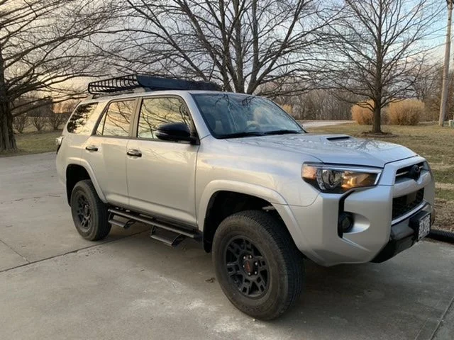

Bought it. Lifted it.

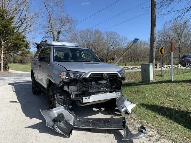

Got hit by a distracted driver about two weeks later. It had 1500 miles on it.
It may be at the body shop longer than I owned it ;—))
Man that sucks - The newness wears off quickly after that. I picked up a screw in my tire in the new Tacoma on the way home from the dealership in November.. had 20 miles on the odo and had to take it to the shop.
