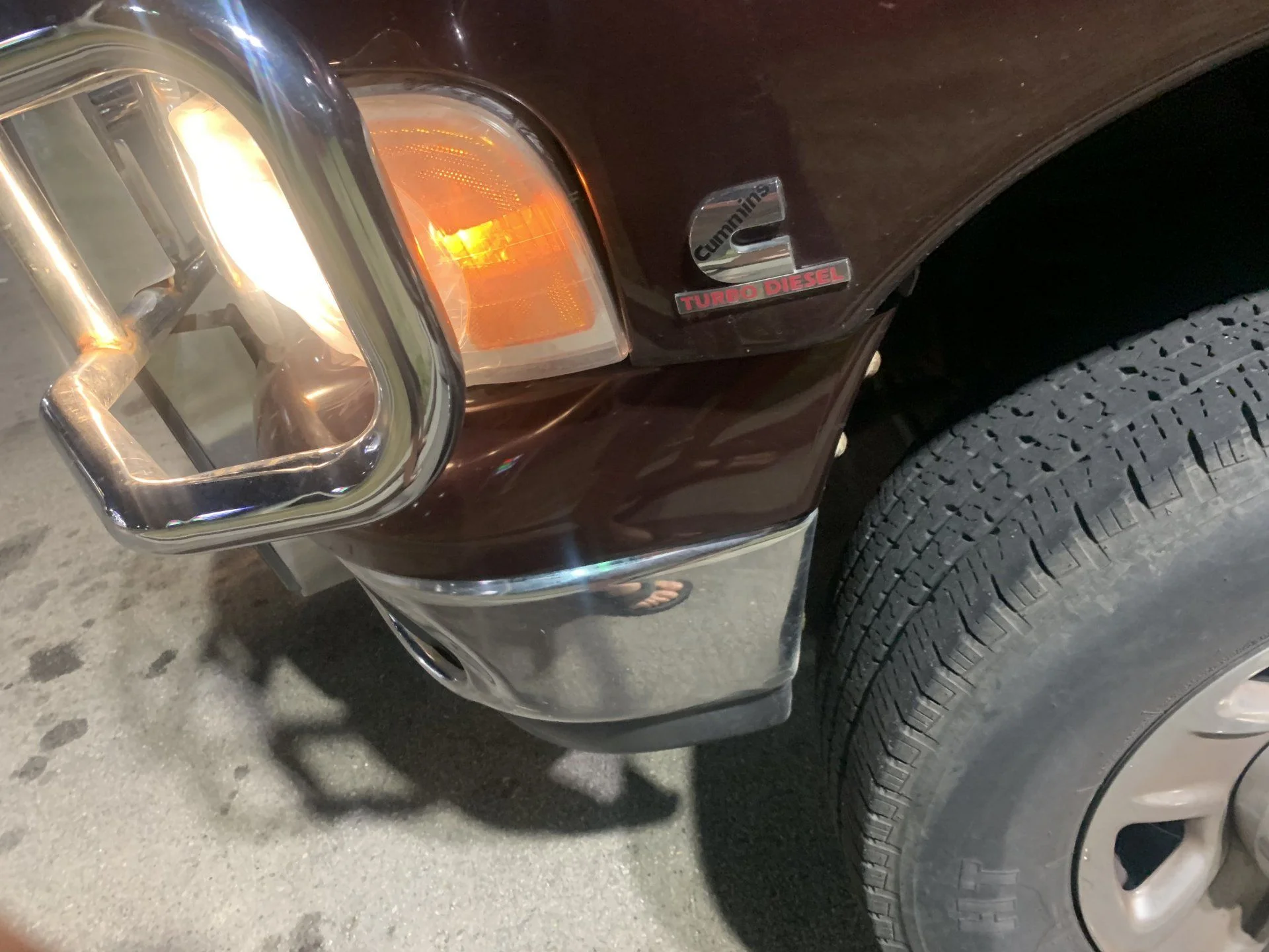

Tested the transmission on the truck out with a quick drive to Virginia. Everything was great until I hit the deer. Hopefully get a new bumper out of that situation.
Oops. How does this keep happening...

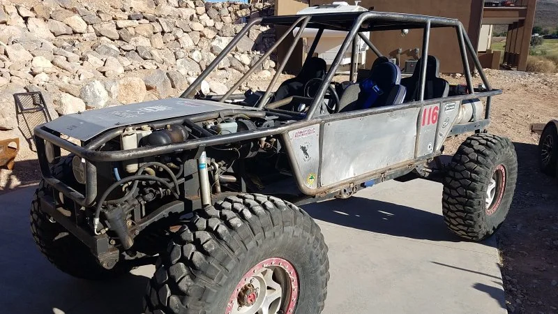

You win. What motor? Old comp buggy? Pretty cool.
84 4runner FTOY #512 Hendrix frame. Stock motor. Been built good and run hard.
It has been passed around an offroading group since it was built about 15 years ago...
I found the original build thread of it.

Before I forget to copy the add, here are the details...
now @CrowleyFJ40 needs to use it for a model to make his.
84 or 85 4 runner frame with Hendrix Motorsports DOM ftoy chassis with doors added.
Boat sides, and full underneath uhmw skidplate
22re with psc hydro assist steering, 5 speed Dual cases with 23 spline 4.7 rear case, twin sticks, chromoly outputs, long travel driveshafts, and intermediate shaft. Front solid axle, high pinion elocker with new wiring, 4.88s, rcv chromo axles and drive flanges, ARP studs, 6 shooters, fj80 tierods,
wheel spacers, trusses, gussets, and line lock Rear ifs width axle, 4.88, arb, Currently with spool, disc brake conversion, trussed, plated,
Winches, front 8k also used for suckdown. 2.5k rear suck down,. All synthetic rope.
Interior 5 points, 10 gallon tank, roll over valves, fire extinguishers, tool box, storage rack, interior light, headlights/brake lights, rock lights, battery disconnect
39 red labels almost full tread. 17x9 aluminum beadlocks.
by the way, truck needs a new bumper, deer did push it back quite a bit...
looking for something like this.. anyone have a suggestion. 2004 dodge 2500.
video of it in action....
you might recognize this rig, and this guy....
Tough country
Ranch hand
Buckstop
Reunel
Fab Four also makes one like the tough country and ranch hand. Spending 4 years in Alabama, I saw plenty of brush guards and bumpers (almost all ranch hand) and they took a hell of a beating.
I had a ranch hand on my powerstroke. Needed a repaint but was a stout bumper. couldn't hurt the thing.
