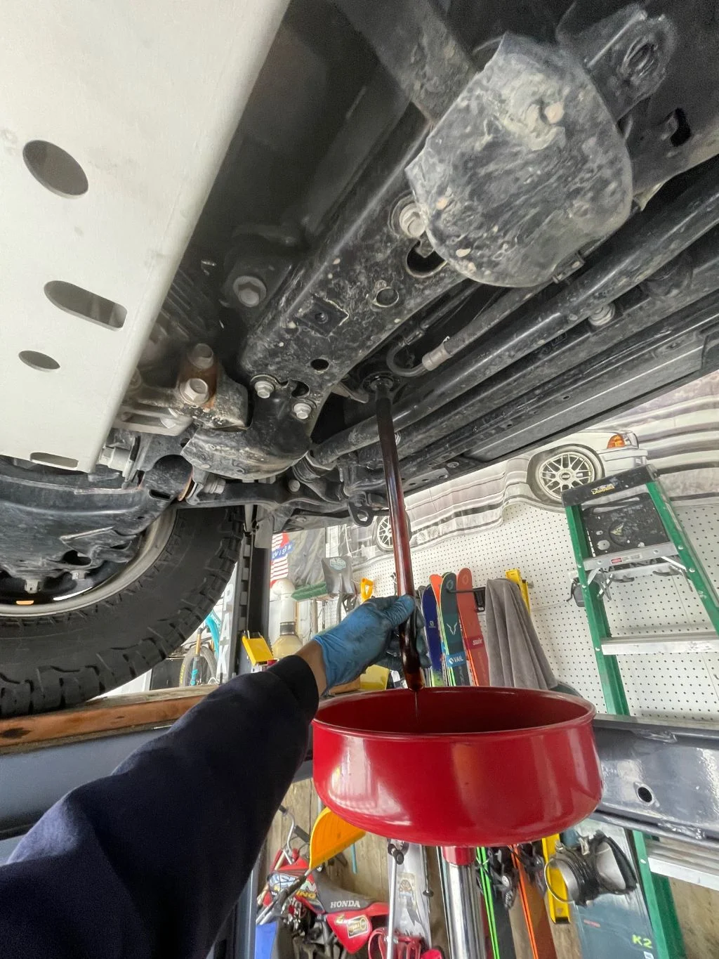

Well, there are some simple things you can do to drain the oil filter housing. I use the plastic snap in tool attached to a piece of surgical tubing. Drains the canister cleanly...

No no no. You dont get to give advice working under some kind of lift buddy. What the hell lol

Wait, you don't have a Bendpak 4 post lift in your garage? WTF man, time to trade in your man card, lol! You're in Texas, I thought everyone there lived on a ranch with barns and every tool under the sun? haha Guess I also shouldn't mention that I've got a Handy motorcycle lift inset into the garage floor in the other bay then. Oh, oopppss... :rofl:
My trick will work even if you're laying on your back under your truck....

On a more serious note, that hose trick is aight... Isnt that in the instructions? Lol
I just hole in 1 that s*** right into the pan.
When youre on the ground, dont need no hose. Thats the Texas way!

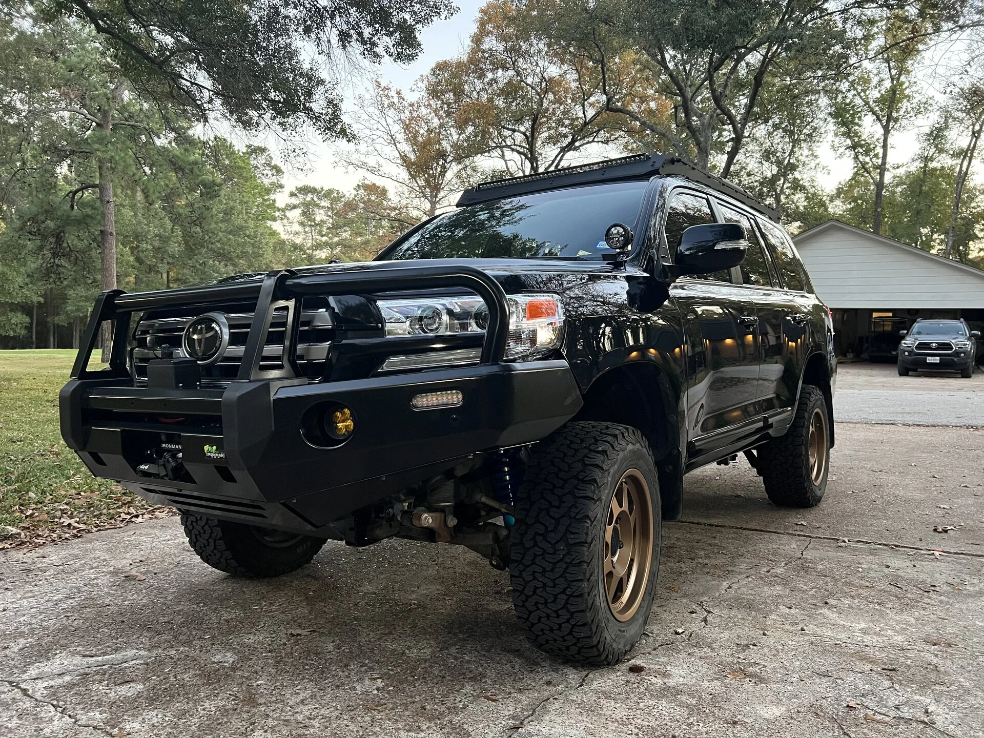

This past week: Kings with SPC UCA and OME rear spring (722), ironman bumper and winch. I’m struggling with the amount of lift at just a bit over 3” all the way around, I’m measuring the cv angle at 15 degrees. It looks a bit strange on the stock size KO2s but drives and rides great, shop seems to have really dialed in the alignment. I’m thinking about taking it back next week and backing off an inch on the preload to ease up on the front axel angle.
How you diggin that bumper, I'm thinking of going with that one.
I run that IM bumper and winch... highly recommend. Bounced off mountain going up Top of the World, pushed over small trees on deer lease, fits well on truck and its never let me down. The cost for what you get is great and looks good as well.

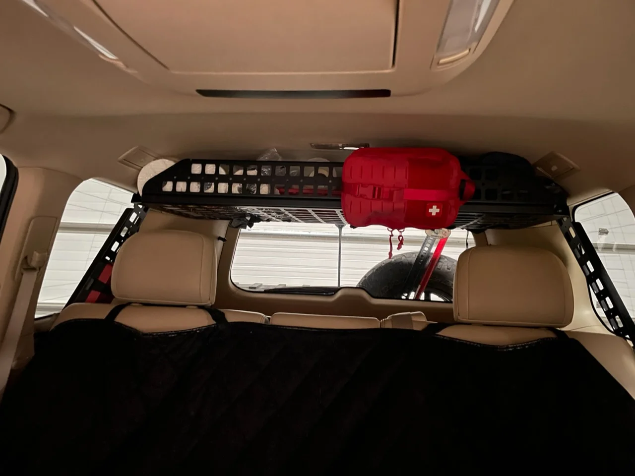

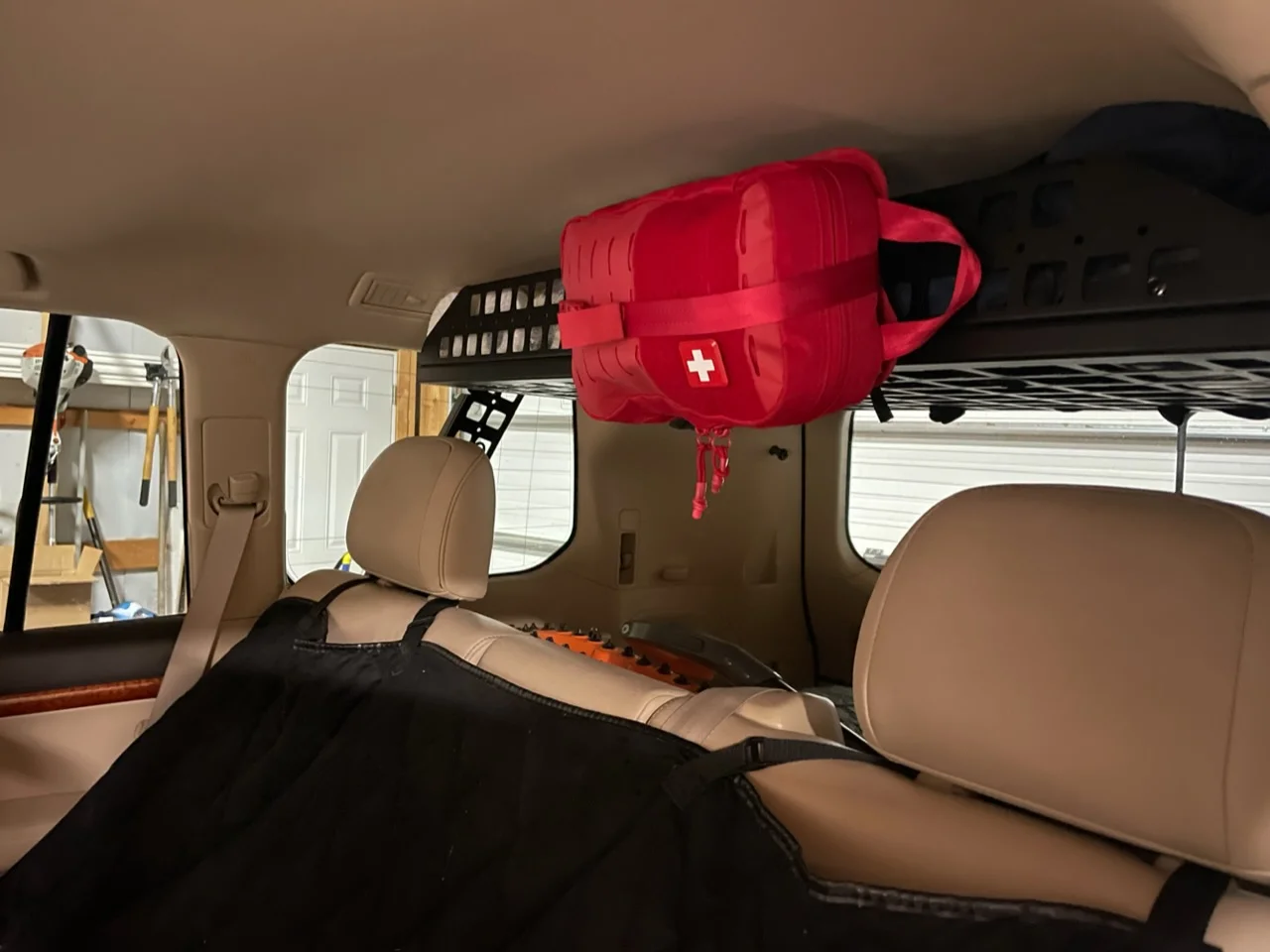

Upgraded my first aid kit to a MYFAK Pro (MyMedic Black Friday deal, still 30% off). Mounted to my Kaon shelf. Easy access from rear driver side door. The kit is attached with Velcro to the molle panel. Doesn’t interfere with rear passenger though in my case the back seat is usually occupied by my dog.
Haven’t had much time to really look at honestly, but initial impressions are great, especially for the price point. This one was a scratch and dent the installer had on hand, it has a 6” scare on top of the center bar from shipping. A little paint and it was too good to pass up. They got my Baja fogs to mount up, just need license plate bracket and recovery points
