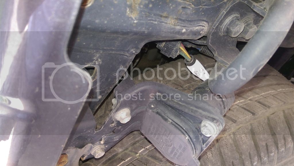

The ARB harness is NOT compatible with US spec cruisers, so I will need to figure out how I want to wire everything up. @JamesC suggested splicing into the tow harness. I didn't think I even had a tow harness?? Does anyone know where to look for it?
@wct49 has been great to work with. I recommend 49 Tire to anyone looking parts and TLC service in the Jackson Metro area. He also got me a killer deal on this bumper, and is probably so cheap, I can't post it here. ;)
First. Badass. Cant wait to see it with the big boy on it.
Second. Tell me more about this ARB wiring harness. I presume that there are wires coming from the ARB bumper that you were supposed to be able to piggy back off of the factory socket harness behind the tail lights.
Is it a matter of the sockets wont plug in, the wiring is not coded correct, etc? Can you take pics of the wiring?
I presume that you want the ARB bumper to have redundancy with the factory lights?
Anyhow, here is the tow harness, I bet we could get the ARB harness to work though once we know what we are looking at.

Ok, I must be missing something; I DO NOT have that above connection on my 200.
Should I, or is the tow package an option?
As to the wiring. It is a matter of the master female adapter for the whole ARB harness is supposed to plug into the male OE harness. That does not exist. There is NO plug to plug the ARB harness anywhere. And yes, I want the ARB lights to work in unison with the factory lights, though I may want the red lights to be running lights and not brake lights.
