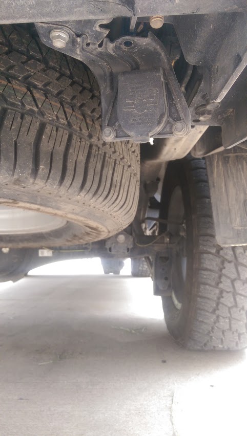

The ARB harness was not usable for more than just spare wire of marginal quality IMO. Our trucks should all be tow-ready to my knowledge. Do you not have this 7-pin plug, right side of spare? If not, root around to see if there is at least a pig tail. I hope there is. If no joy, use the grommet that came with the ARB for the lower right fender through-hull and splice into the passenger side tail light wiring as your best bet.

Just confirmed. I do NOT have a trailer hook up.
Can someone show me where it plugs into the OE harness? I see a few plugs down there.

Very weird. I'm sure you can buy one if the OE harness is there. I would look up under the passenger side rear for a white plug that is capped off behind the bumper.
I only had the white cap plug too. Called toyota a year back and they wanted over $100 for the connecting part. I had a local trailer and hitch place wire up a fix for $30.
