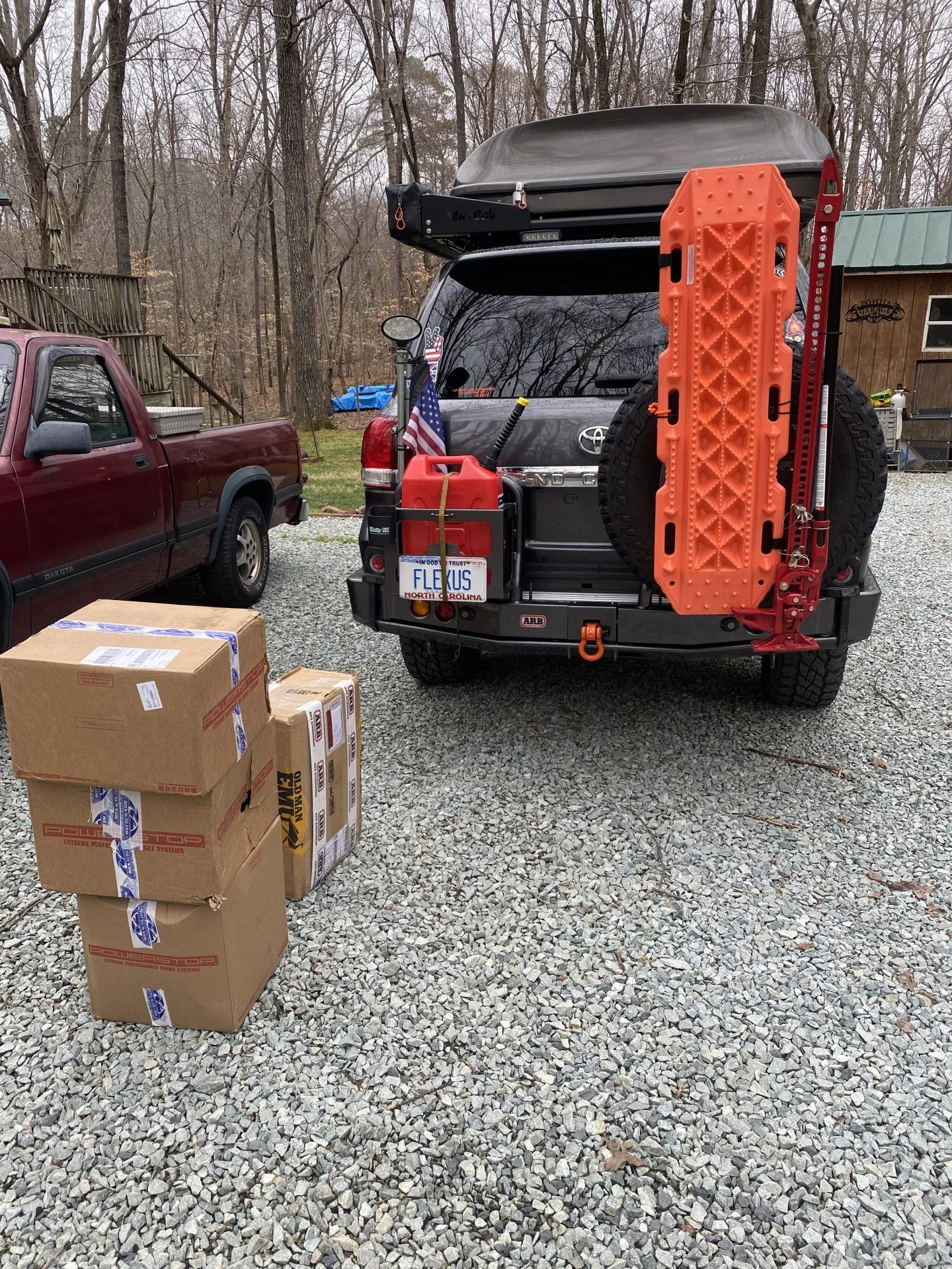

Goods

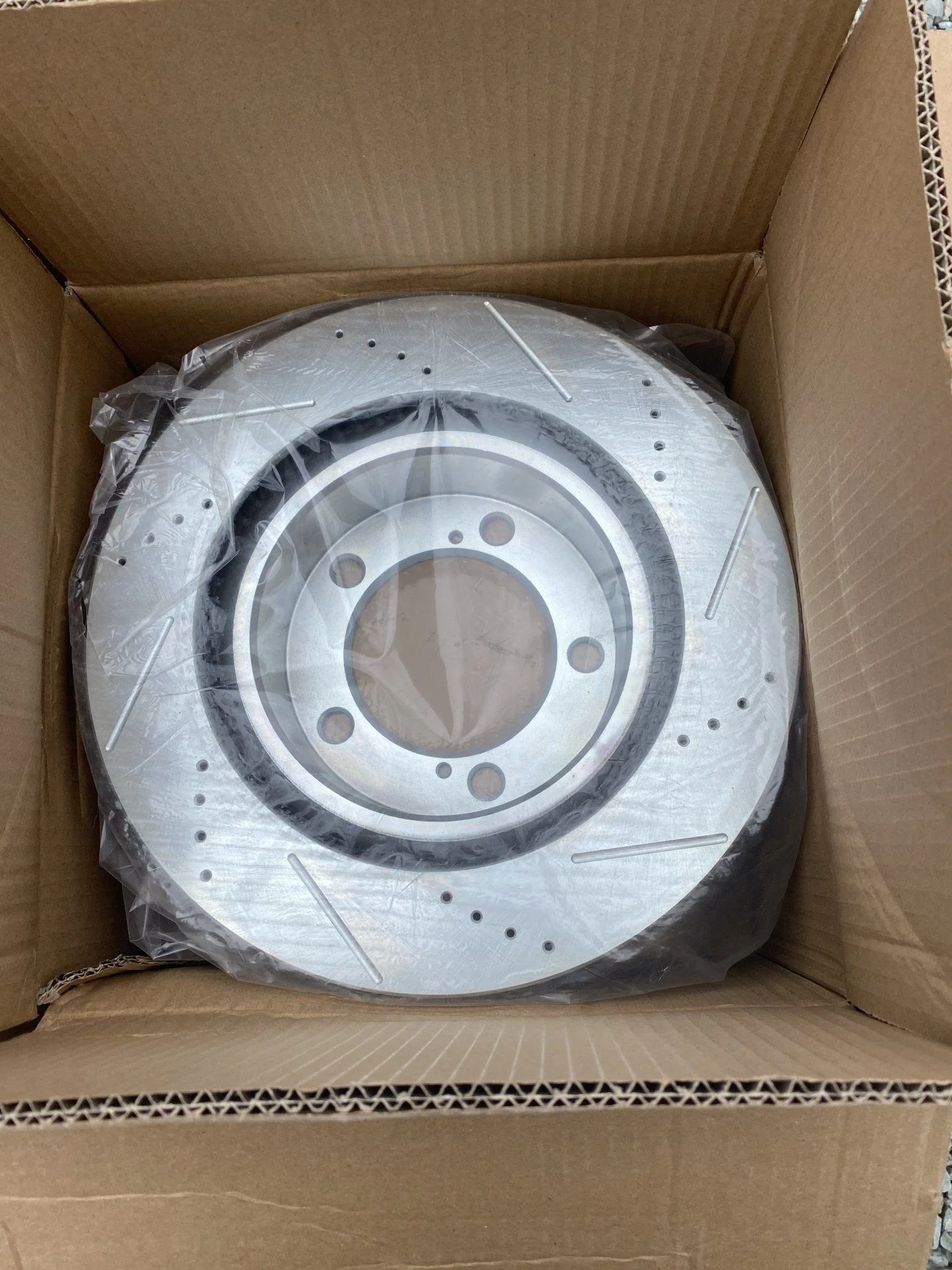

That entire rotor is bare metal. It will rust very quickly. Coated rotors have painted/coated inner and outer hubs and internals to minimize/slow down corrosion and rust.
This is the same kit lots of people have used on here. And they’ve never had any issues…

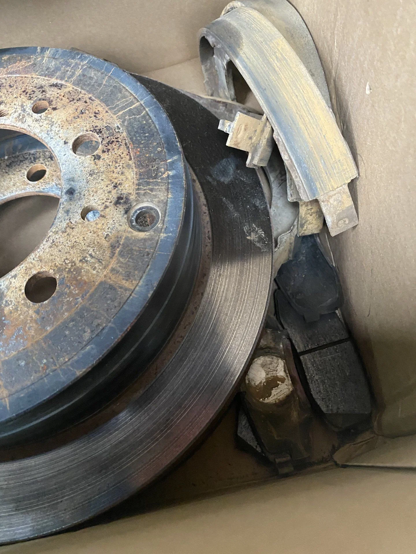

Should I keep these and resurface them. Or just junk pile them? All 4.
Me? I'd get all new - no doubt.
HTH
I replace them all with drilled and slotted rotors. these would be just back up or spares I guess
Junk them. Quality OEM rotors are pretty cheap.
I personally would avoid slotted and drilled as that's actually a liability for stress fractures with most of what you'll find from the aftermarket. Cosmetic drilled rotors versus real deal race rotors which are engineered with them to begin with and use rigorous processes to manufacture them.
I went with the kit people have used on here. So far they have no bad reports.
