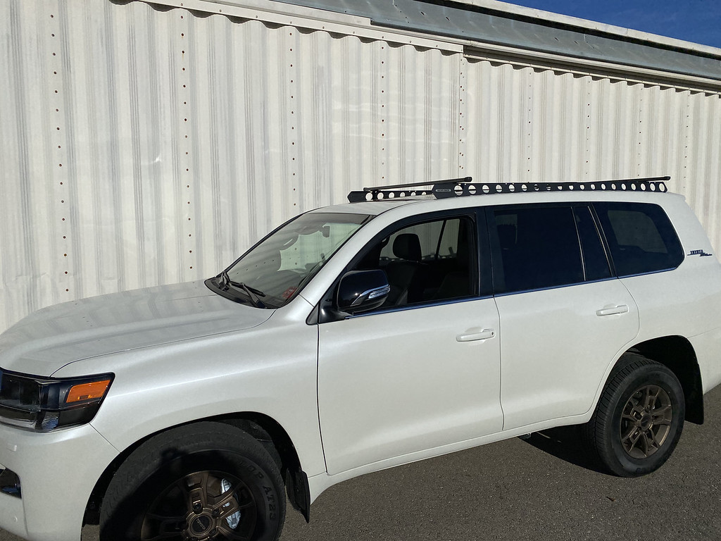

Looks like you don't have a rhino platform on, am I correct? Just crossbars on the backbone rail? If so, can you show/tell me which bars you use and how you attached them? thanks!

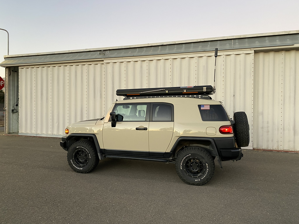

Correct, no platform. I used two of these hardened steel crossbars, and drilled into them to allow for the standard M8 retention bolts that come with the Rhino backbone to be inserted from underneath. Used a magnetic retriever to position the channel nut inside the crossbar and bolted up from underneath the Rhino backbone tabs. It would have been easier (but a little pricier) to use the Rhino HD crossbar- no drilling required as it has the slot for the channel nut built in. I used only two of the crossbar mount points- the Roofnest is very rigid, and doesn't seem to need a third. This is identical to the setup I ran for several thousand miles on an FJ.

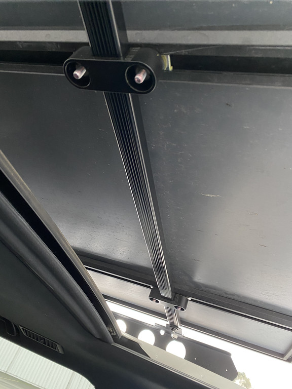

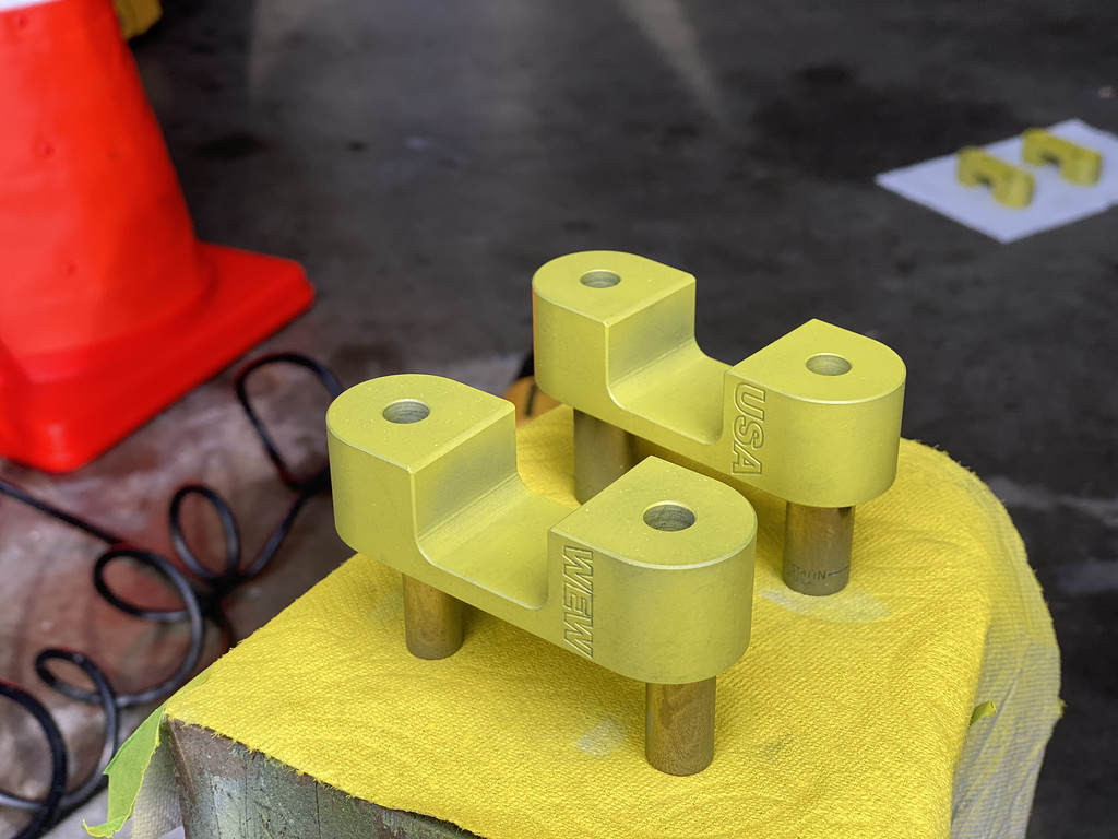

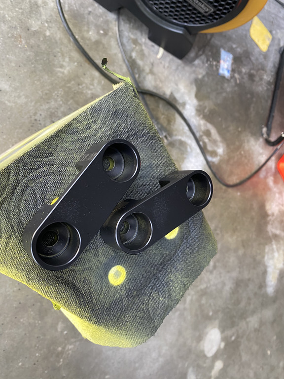

Swapped out the Roofnest mounting brackets for nice billet units from Wheel Every Weekend. They were nice shiny bare aluminum, so naturally I painted them prior to install. Yellow Chromate then SEM Trim Black. Much nicer to look up through the sunroof at.
