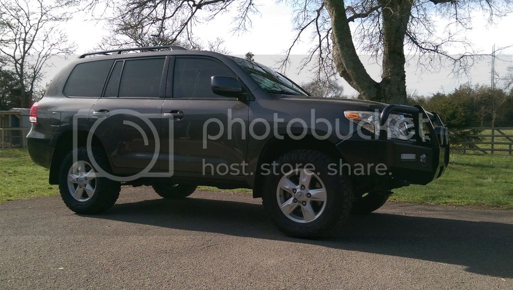

Picked up my 4 new RW at dealer. Going to PC on wed. Going to see If dealer will let me keep 1 of my old ones for the spare. Still have 18" under there.
Dropped off the RW at the PC guy who was at the local BMW dealer. He just finished some wheels for them and they looked great. So felt very comfortable with him. Going with satin black vs flat black which is what my current plastidip RW are.
