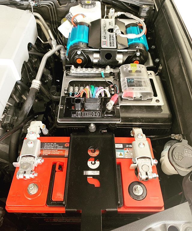

Wow that is not good. I have the Redarc BCDC 1225 in mine. The BCDC will isolate the Aux battery from the start battery when the start battery is below 12.6 or 12.7 volts I think. I also installed one of their SBI12 battery isolators so I can link the them with a momentary switch in the cab to allow me to jump start from the Aux battery.Whatever they did...(not entirely sure)...it was sitting there trying to run AC and any other stuff it does when the engine is running...BUT without the engine actually running.
Both batts automatically link when the engine is running. So if they put it in an ON state...but no engine running the alternator......they both drain.
