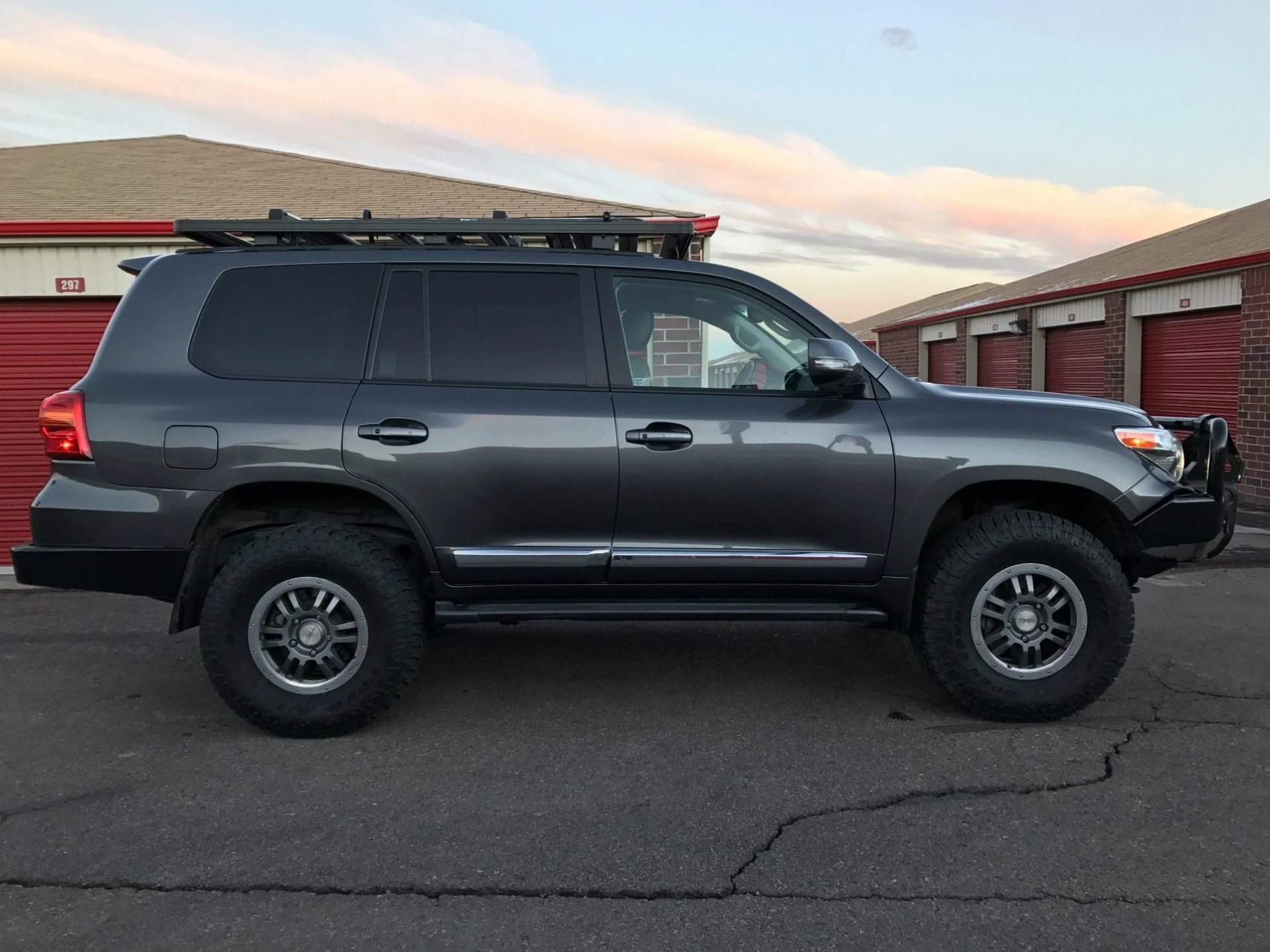

Finally picked this up! Bought her from @Angelo1, and am dang pleased!

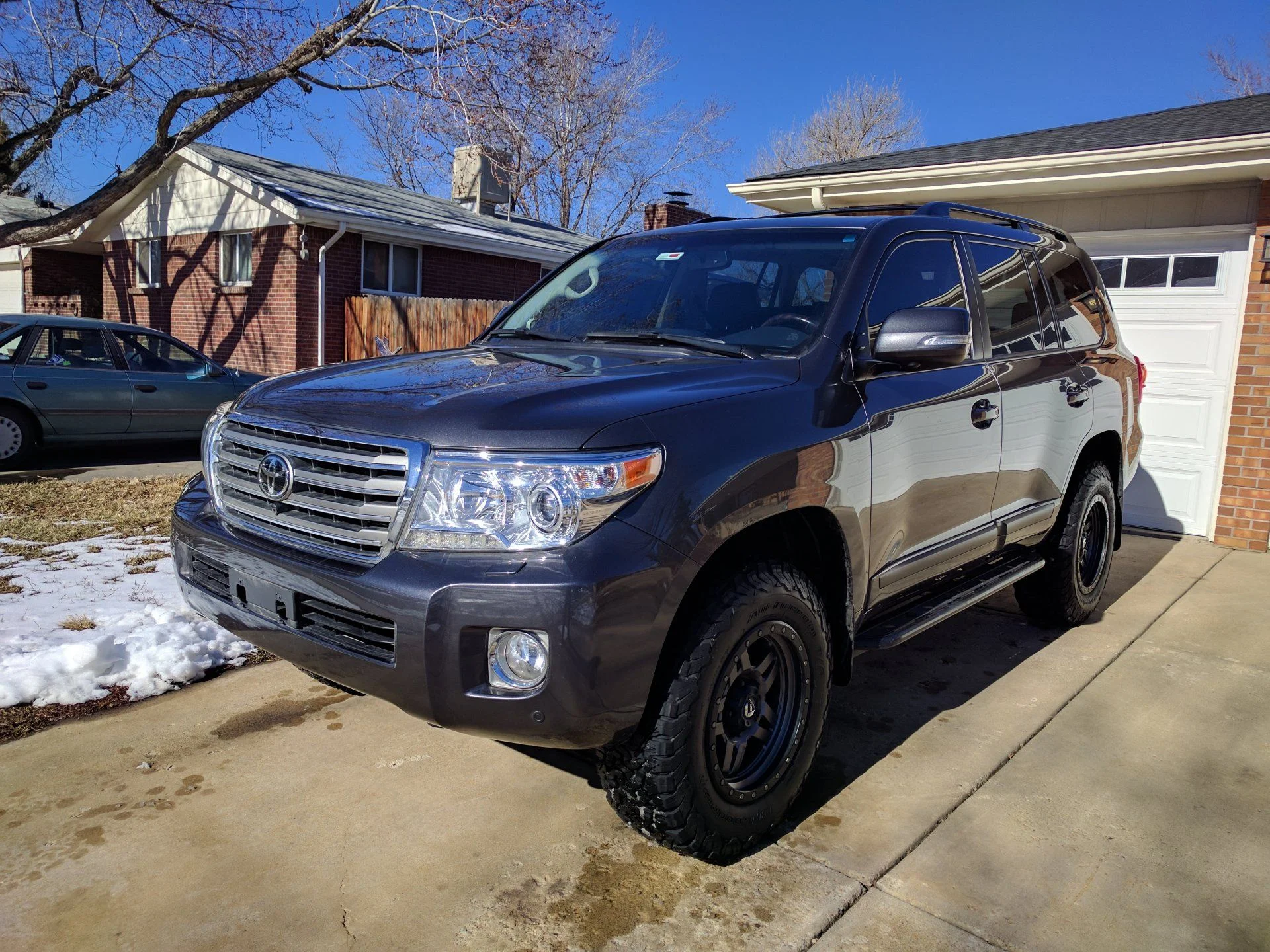

View attachment 1385757 View attachment 1385758 Got the 35s put on today with the Rock Warriors. I really like how it turned out. It's rubbing on the front mud flaps at lock so I'll remove those tonight and trim as necessary.
Looks fantastic!
I'm amazed that you aren't rubbing on a lot more than the front mud flap if those are 35's.
Any chance you could do a mounted tire measurement (see how close they are to 35" left to right?).
Also... Don't forget to move RWs & 35's from your "Coming soon" part of your sig. There have come! ;)
Looks fantastic!
Yep definitely 35s according to the mfg. Of course very few tires measure what the mfg claims, and these are measuring an actual 34.2" mounted on the LC. These are significantly bigger than the mfg claim of 33.4" on the Duratracs they're replacing. That really underscores an important point of what people mean they say what tire size you should or shouldn't run. Some like the BFG 34x10.50x17 run almost 2" short while a Super Swamper runs true to size if not larger than what's printed on the sidewall.
