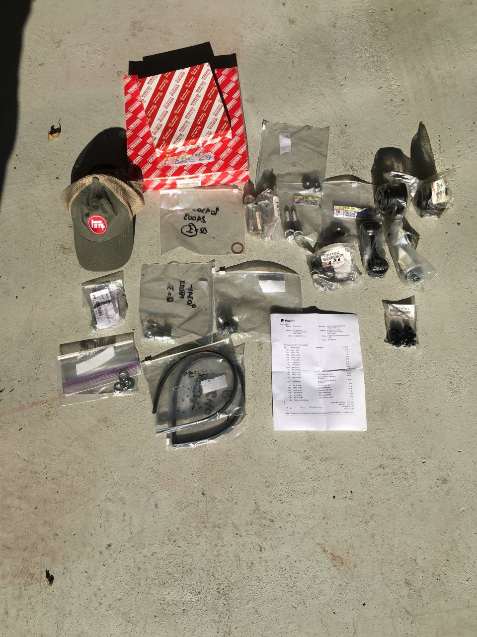

Order arrived from Beno / Onur
Thanks Onur for the Hat and stickers.
Thanks Kevin.
