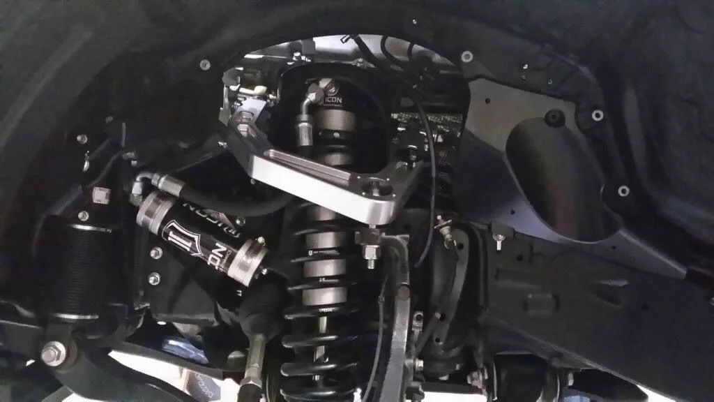

Icon stage 4 has been released (cdcv's all four corners).
Uca's are separate. You're inventing stage 5.....you go pioneer.
It will be sweet
It will be sweet
yeah i know icon has the stage 4 out already, i've spoken to them over the phone and the billet UCA's are due near the holidays so might as well wait.
