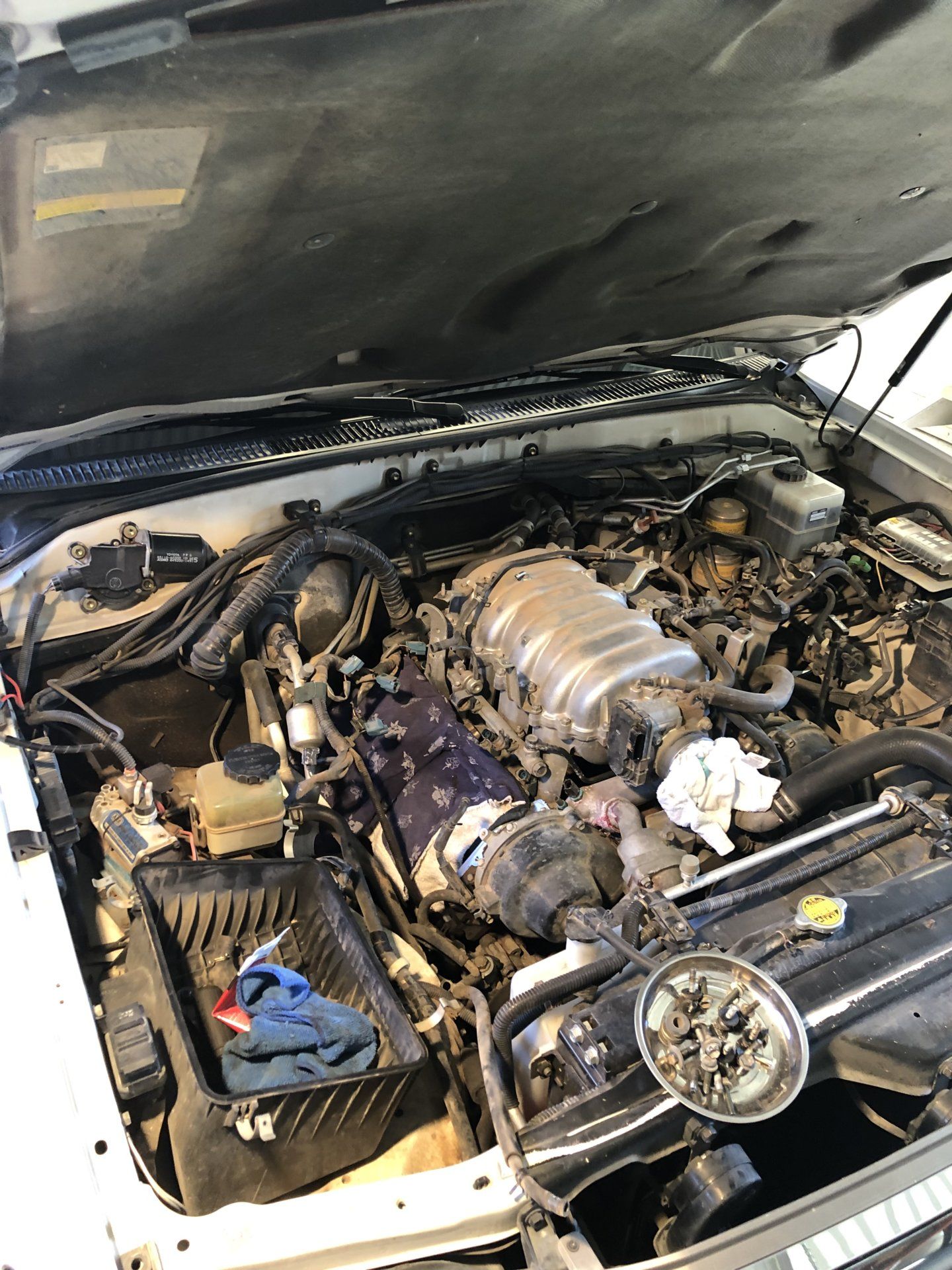

Valve Cover Gasket
Passenger side valve cover gasket had the worst leakage of the two. Only replaced that side and snugged the bolts on the driver side. The only signs of the leaking gasket was low oil pressure at idle and burned oil smell while driving. I noticed it leaking about 10,000 miles ago. It took me about 1 hour per side
Looks like a coolant leak too.

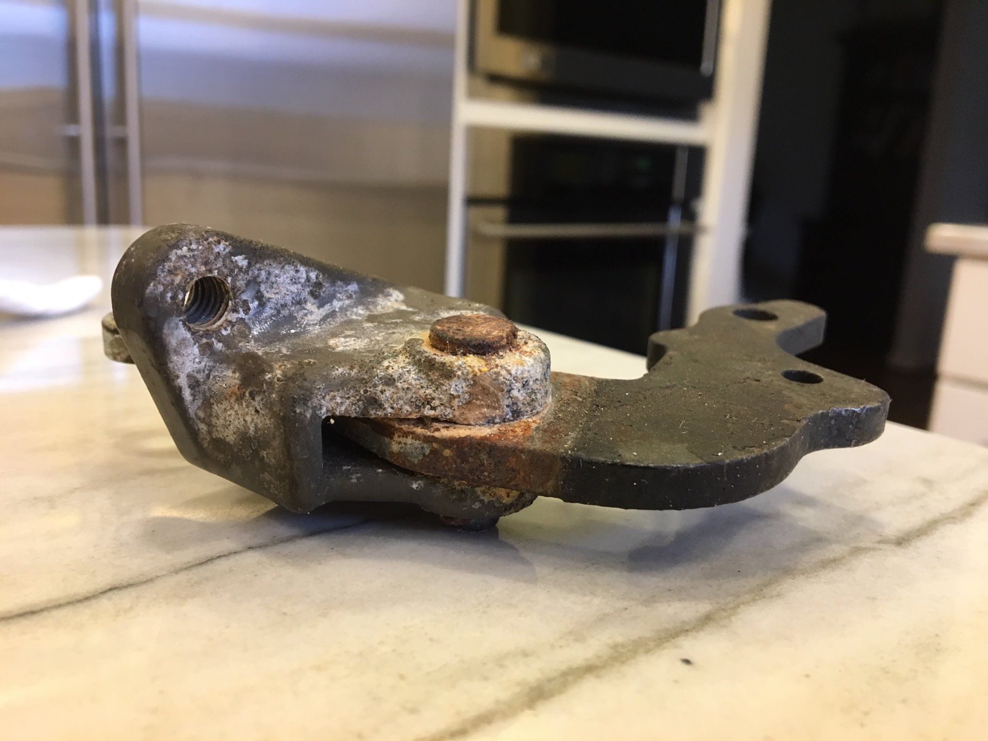

- My parking brake started sticking, so replaced the driver's side bellcrank and bellcrank holder, disassembled the passenger side bellcrank and cleaned and lubed it up.
The seized up driver's side bellcrank.

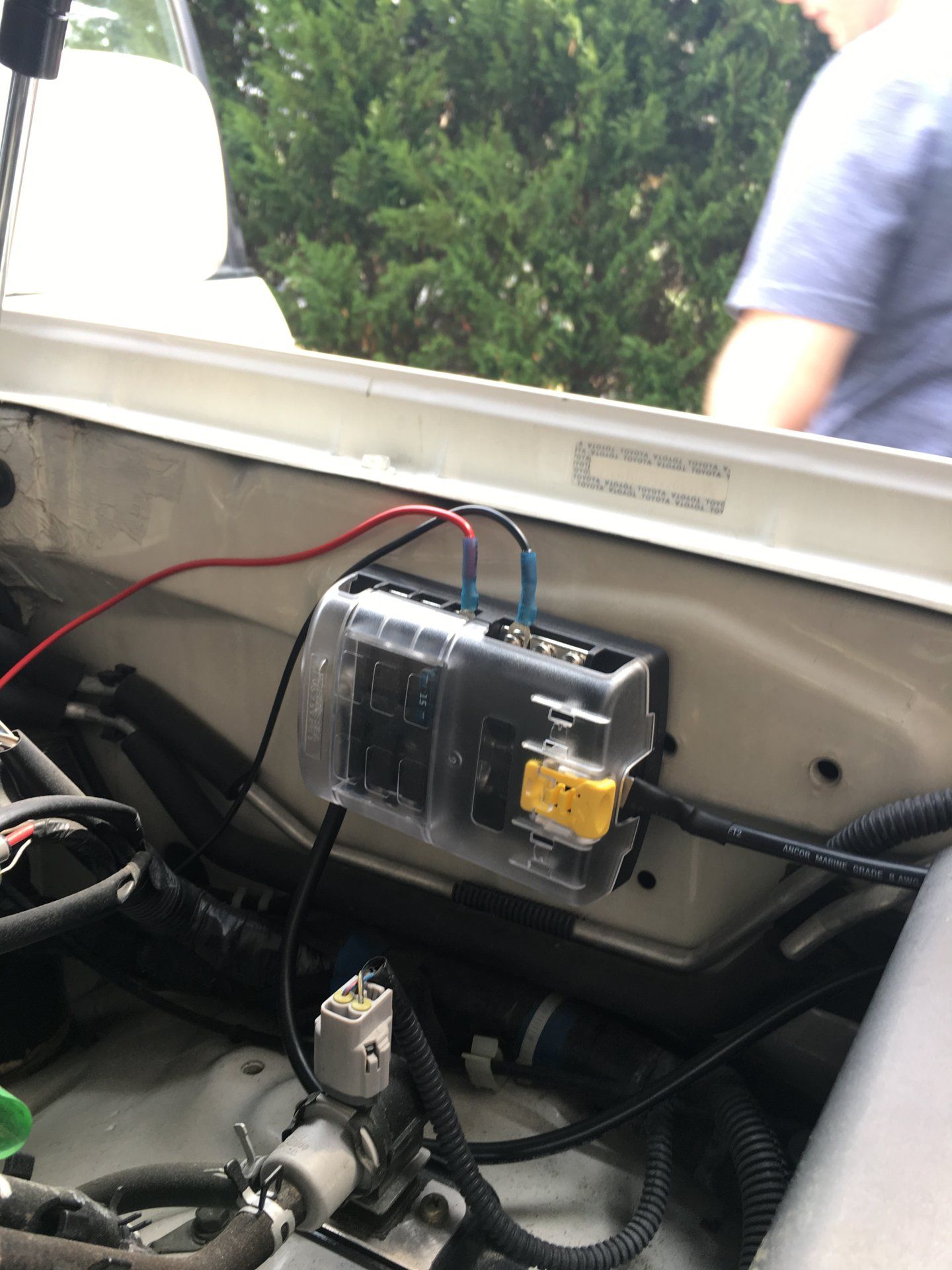

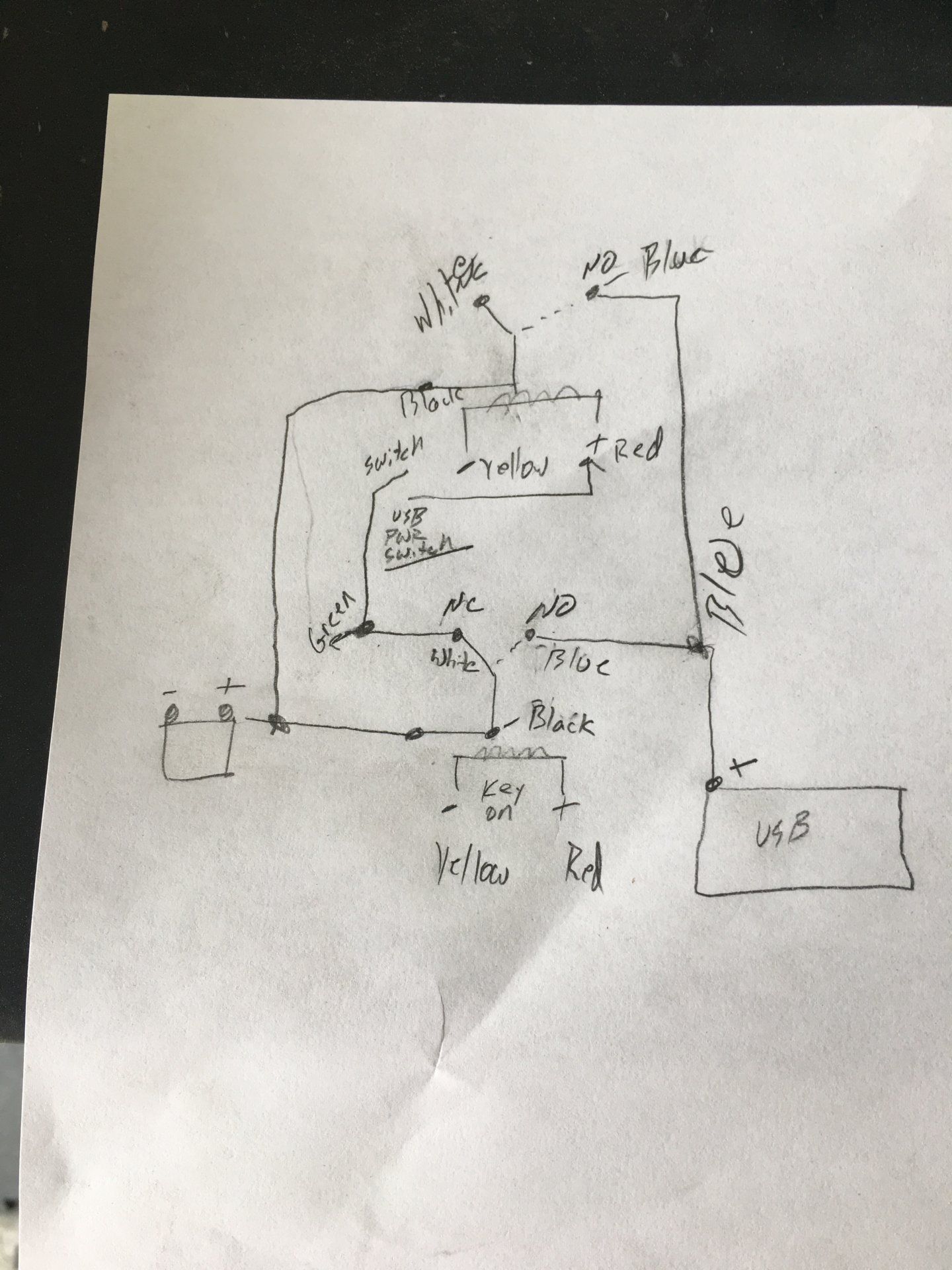

Since my 100 is an 04, the easy accessory relay bypass isn’t an option, so a friend with lots of expertise designed the a slick (possibly over engineered) solution for charging accessories with the ignition off.
Blue sea circuit breaker, blue sea fuse block, two relays, and a ch4x4 switch....
Accessories are on when ignition is on. With ignition off, usb and 12v ports in the dash can be activated by the switch for charging a phone or such while camping without turning in all accessories or idling the truck.
Possibly a complicated answer to a simple question (could’ve just run straight unswitched power to the accessories in the dash from the fuse block) but avoids having the constant parasitic drain of the usb port’s transformer always running....

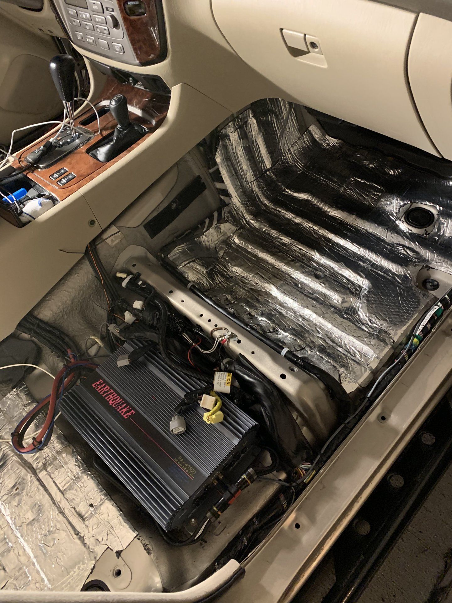

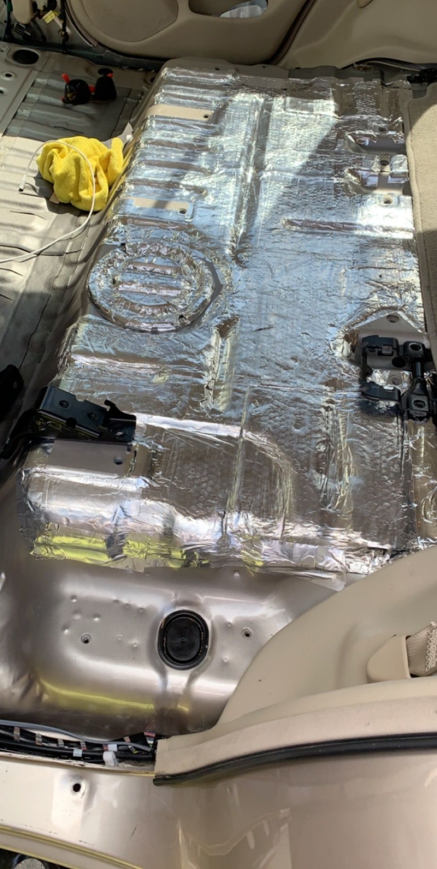

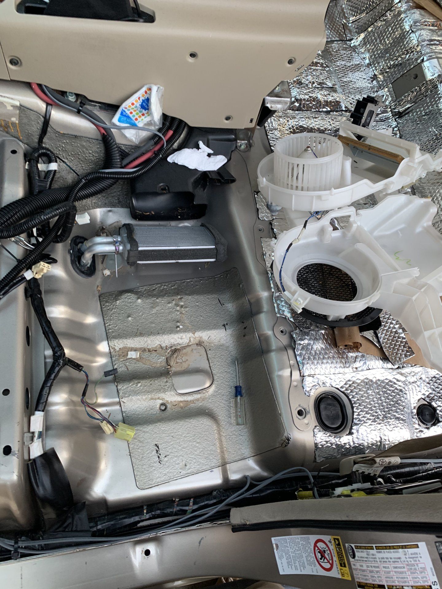

Removed the heater blower under the driver seat and cleaned up, installed sound deadener. The landcruiser has so much of the stuff from the factory, so I’m not sure how big of a difference it will make on the floor.
So did it make any difference in sound? Put some in mine in 3rd row, and door skins and I didn't really think there was a difference. Also heard you don't need 100% coverage and even 50% coverage will do.
Being honest I don’t think it did.
Butyl sheets don’t actually reduce sound, but they change the resonance frequency of the sheet metal of the vehicle by adding mass, so that the metal doesn’t vibrate.
To reduce noise, you need Mass loaded vinyl, which absorbs sound waves. I think if I did a layer of that in the whole truck it would be quieter.
The oem butyl sheets in the vehicle are really thick, thicker than any kind of sheet product you could buy online, so I wasn’t going to see any vast improvement. 50% coverage applies to the thickest butyl tikes you can buy, thicker than the sheet stuff I used. I think some in the doors is going to make the biggest difference.
