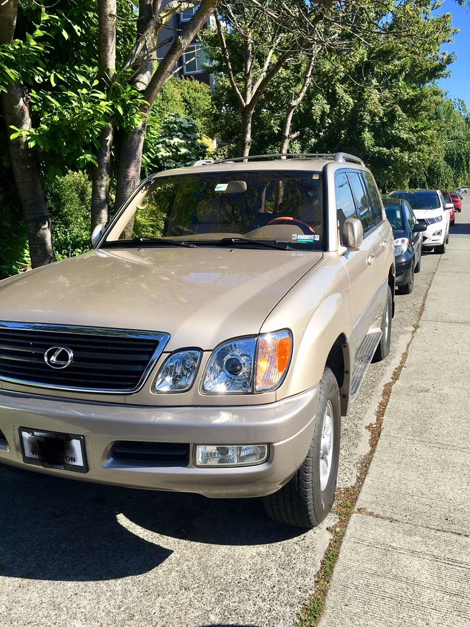

After being on iH8MUD for soo many years, I know that the first thing we're supposed to do is post photos of anything and every Land Cruiser related...so, figured I'd introduce my 'New to Me' 2000 LX470 with 117K on the odometer. Still thinking of a name for the ol'gal, I'm thinking about calling this one, Karma. We'll see as time goes on and what sticks...
It's a new step in LC ownership for me to jump in an LX470 from all the FJ40's and FJ80's I've had over the years.

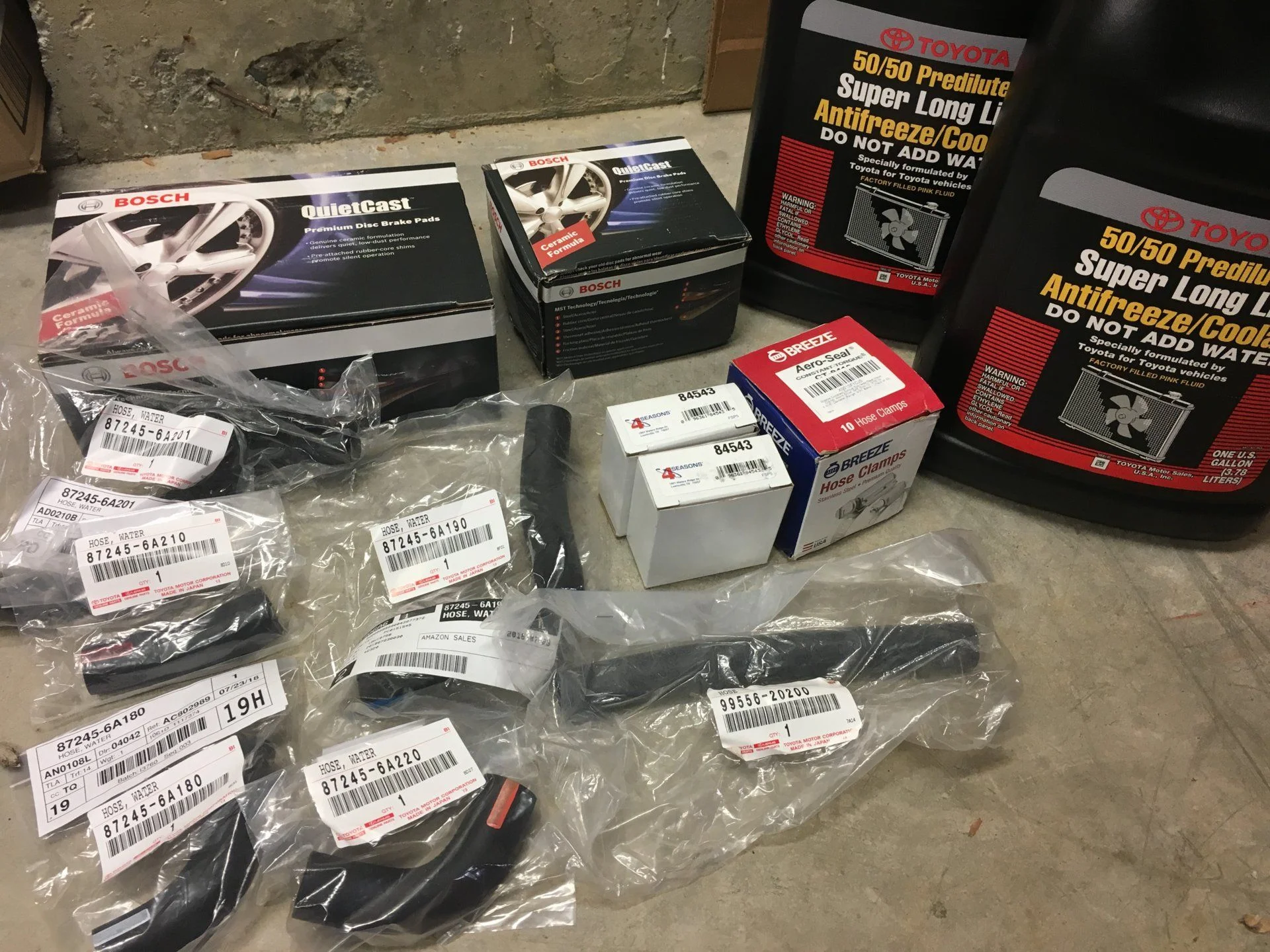

Timing belt & tensioners @ 121K - Done
- Water Pump @ 121K - Done
- Radiator Hoses @ 121K - Done
- Brake Fluid Flush & Bleed @ 121K - Done

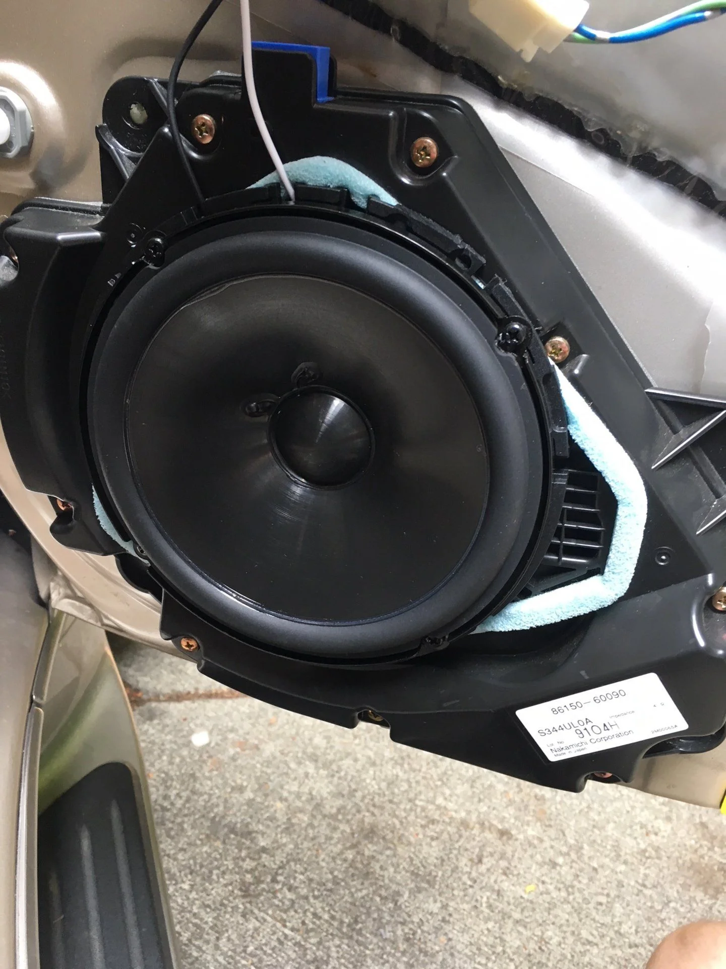

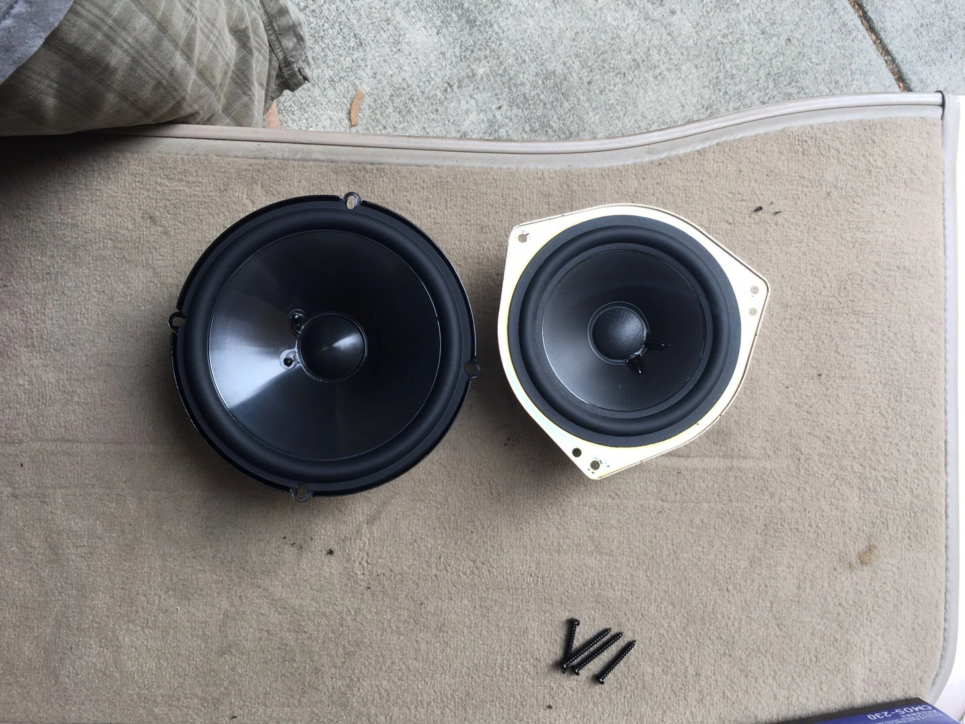

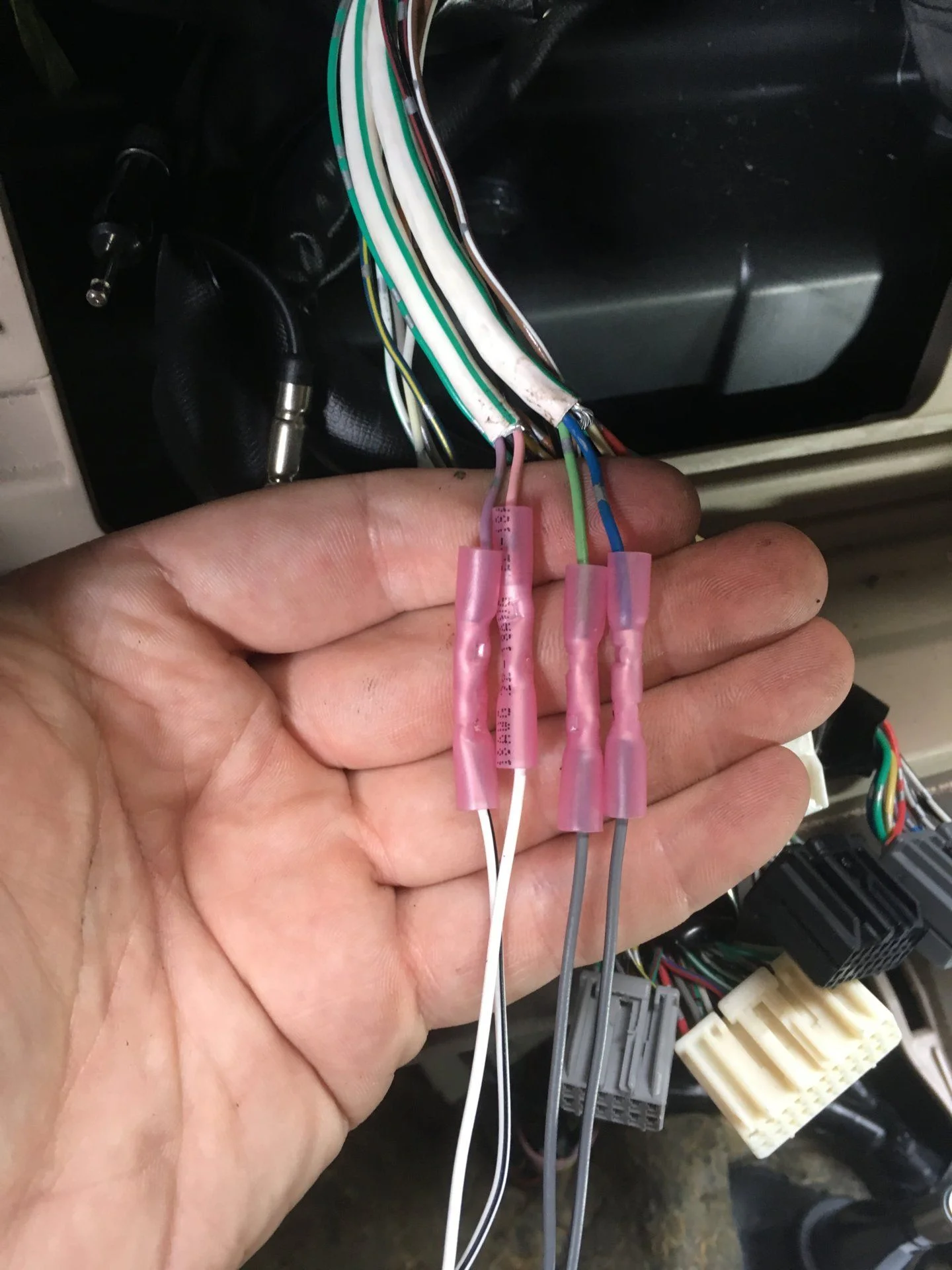

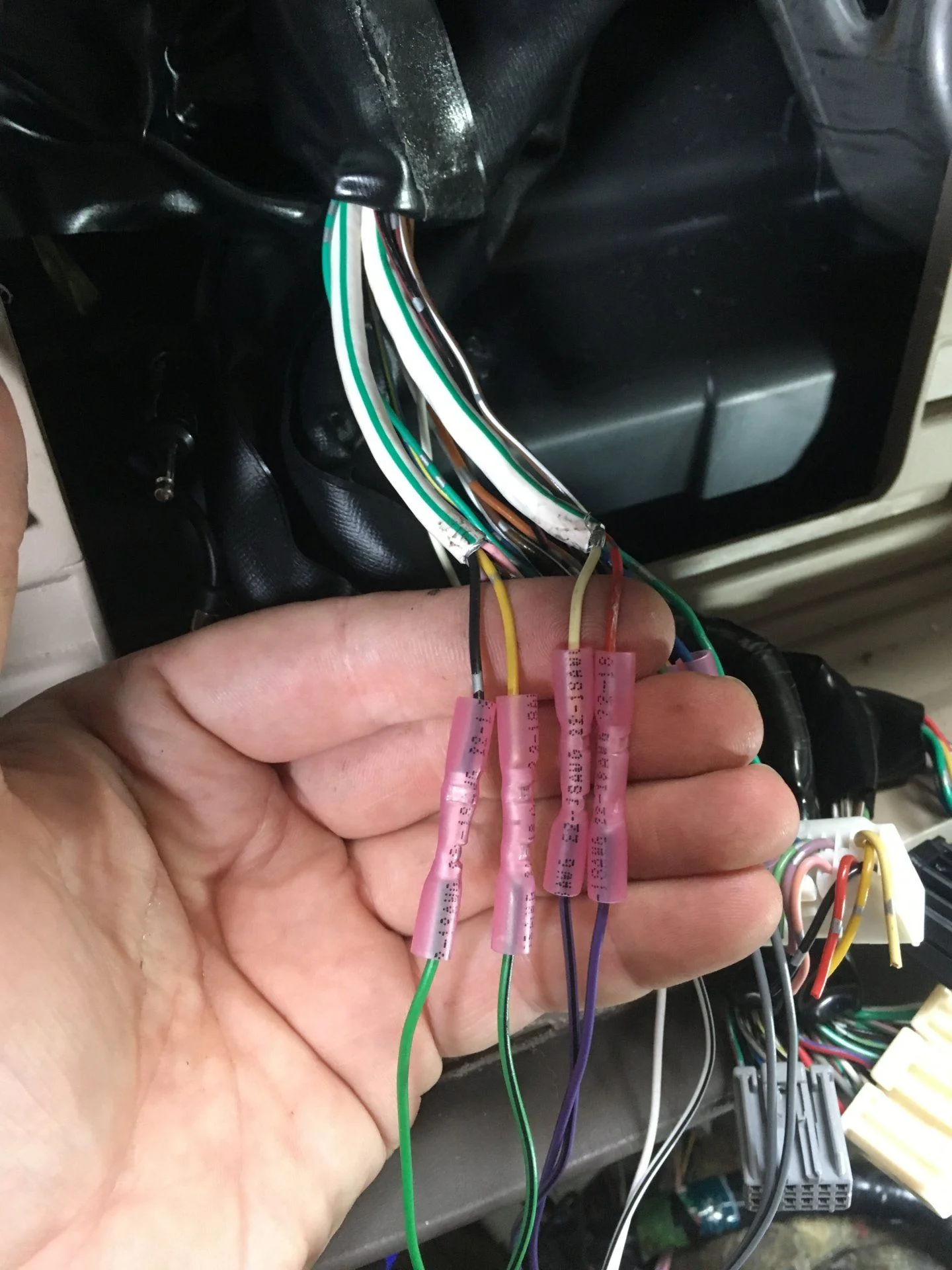

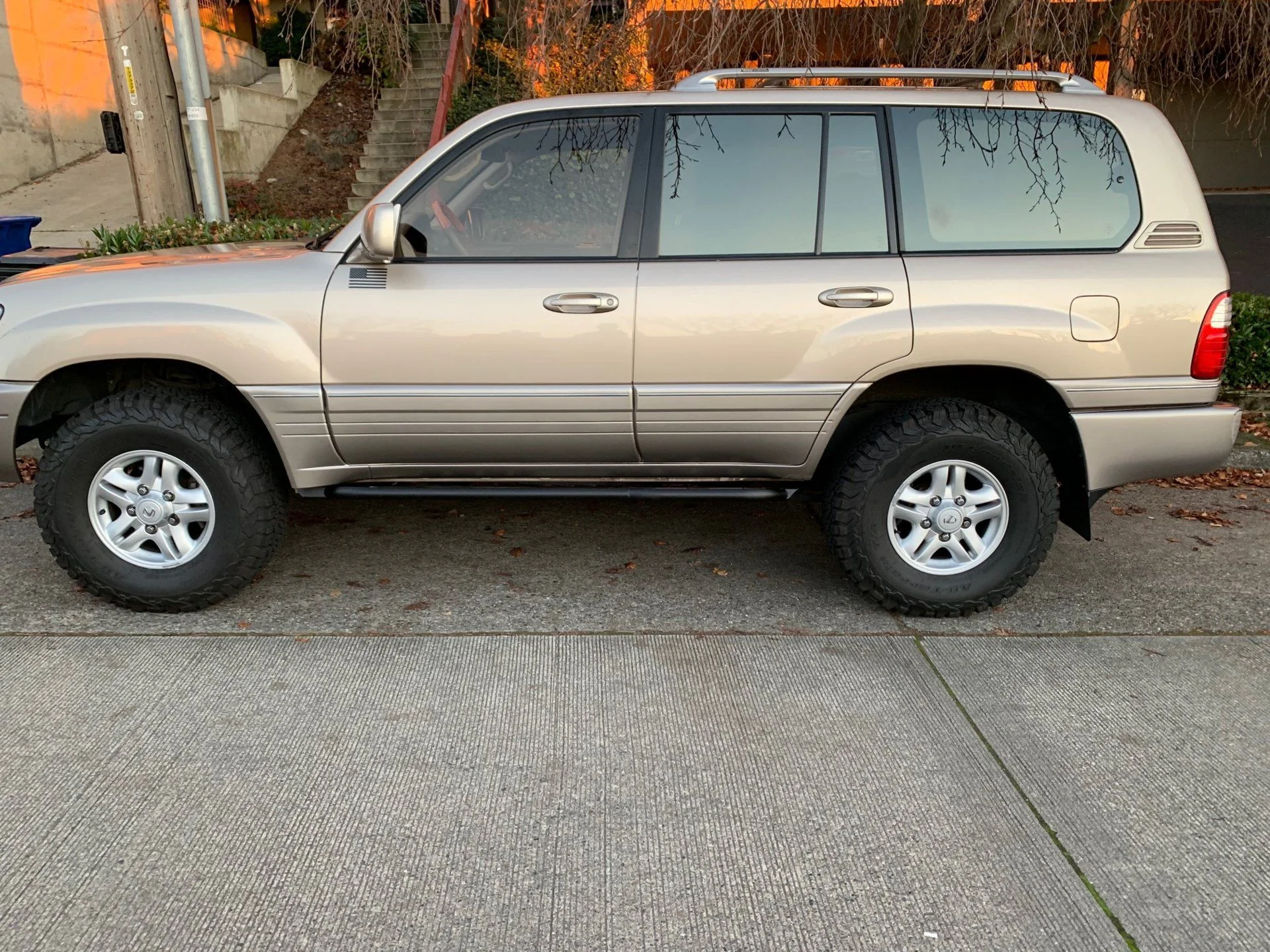

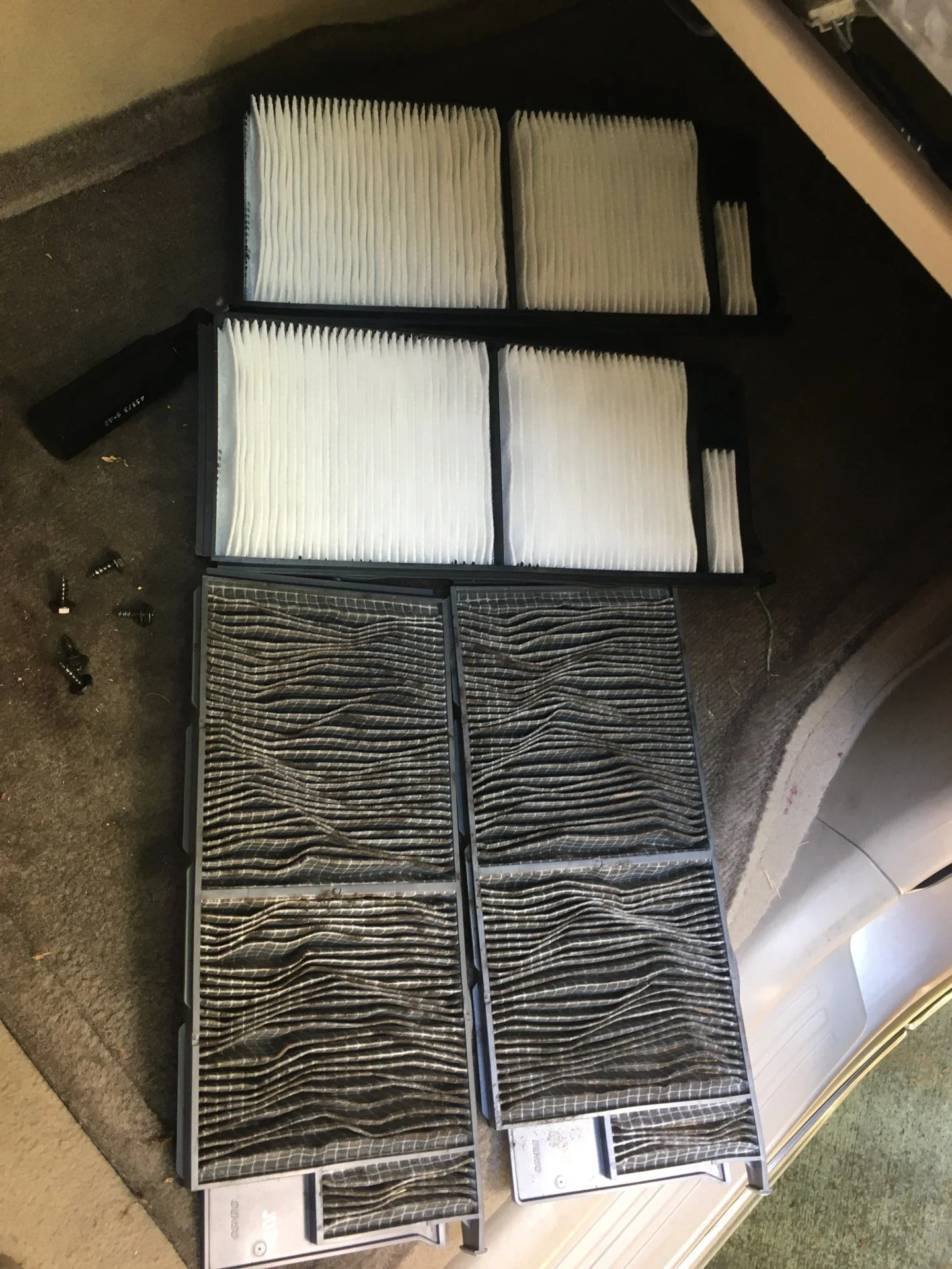

So, I finally made it back State Side and didn't waste any time. Jumped straight in to cabin airfilters and the heater T's and coolant flush. Followed that up with rear brakes, front brakes, greasing all of the u-joints and drivetrain, threw on 5 BFG K02's (285-75-R16), installed a new head unit, and installed 6.5" Infinity's in each of the doors, amp bypass, and now I'm installing the rear backup camera. Here area a few photos...

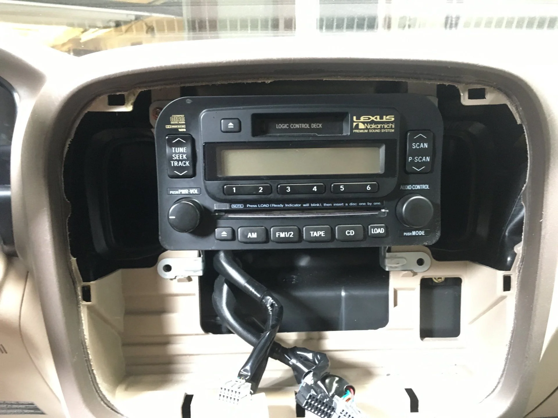

Here's the radio install
Speakers with a side by side to show size difference

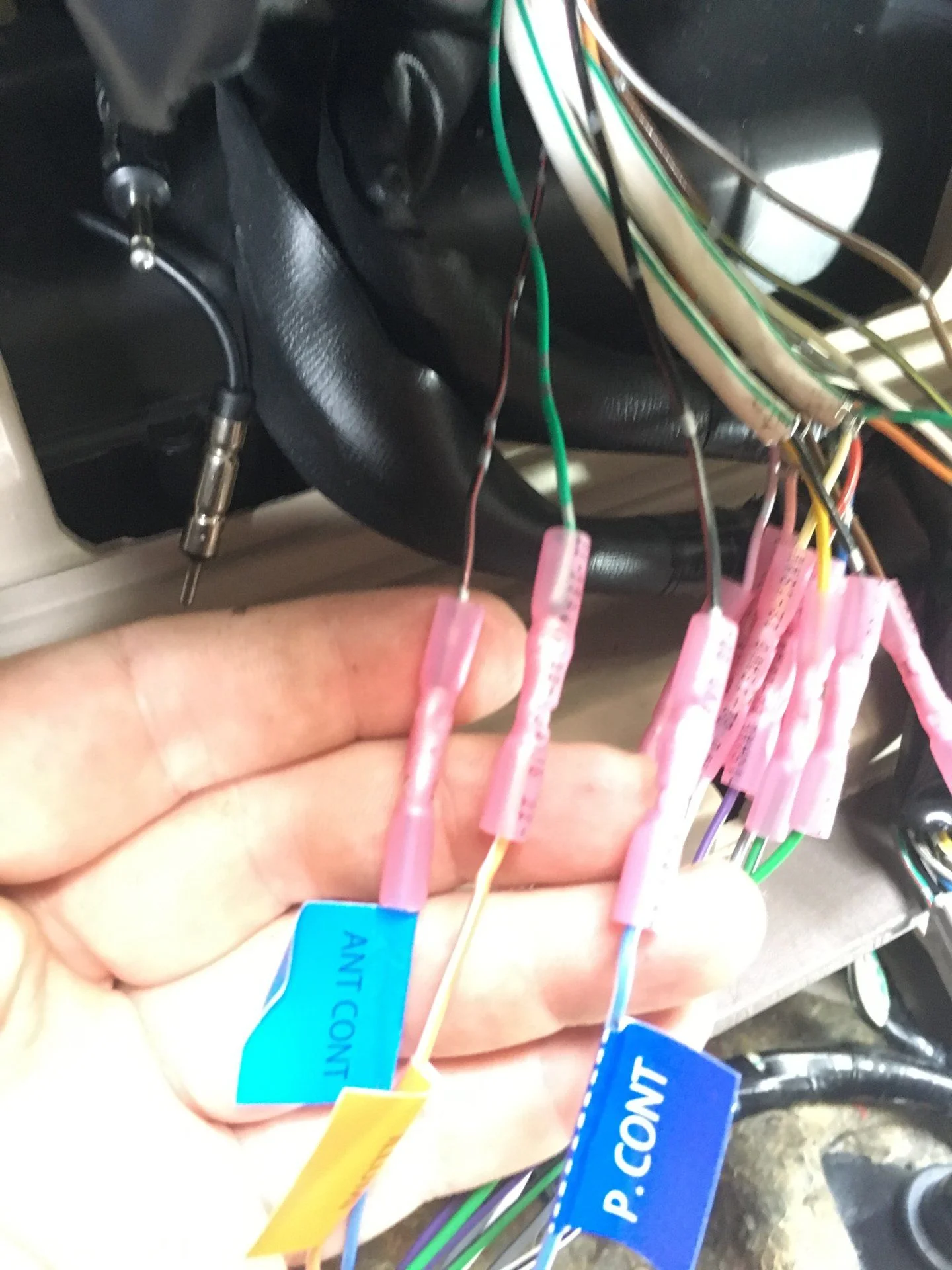

Amp bypass wiring photos

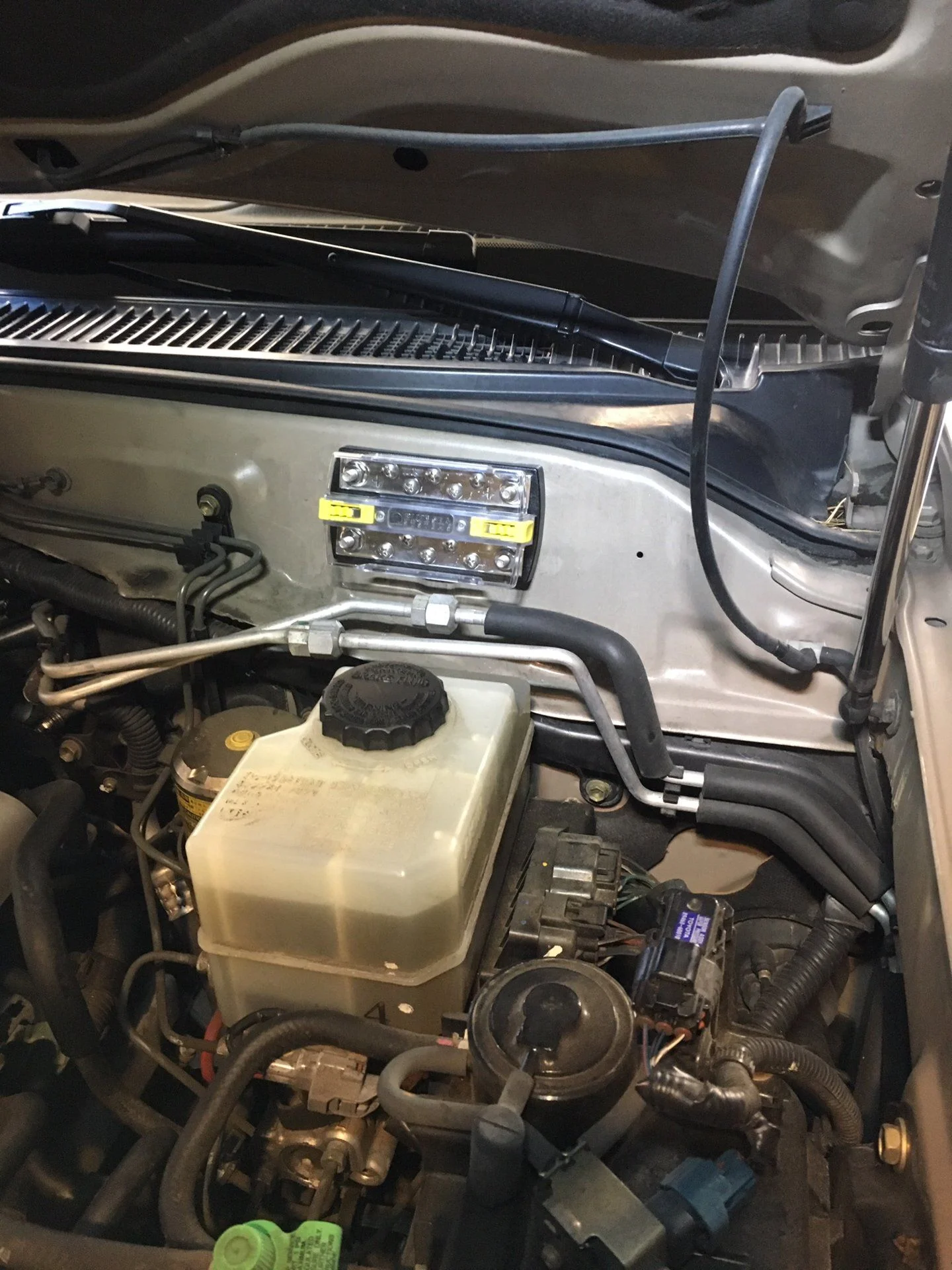

Installed a power block on the firewall

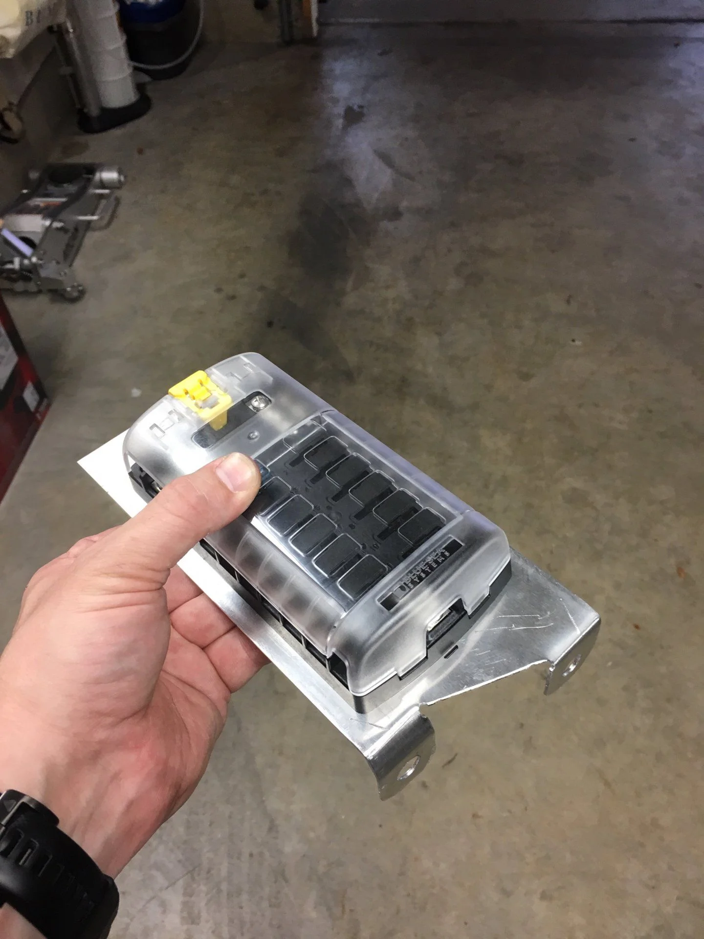

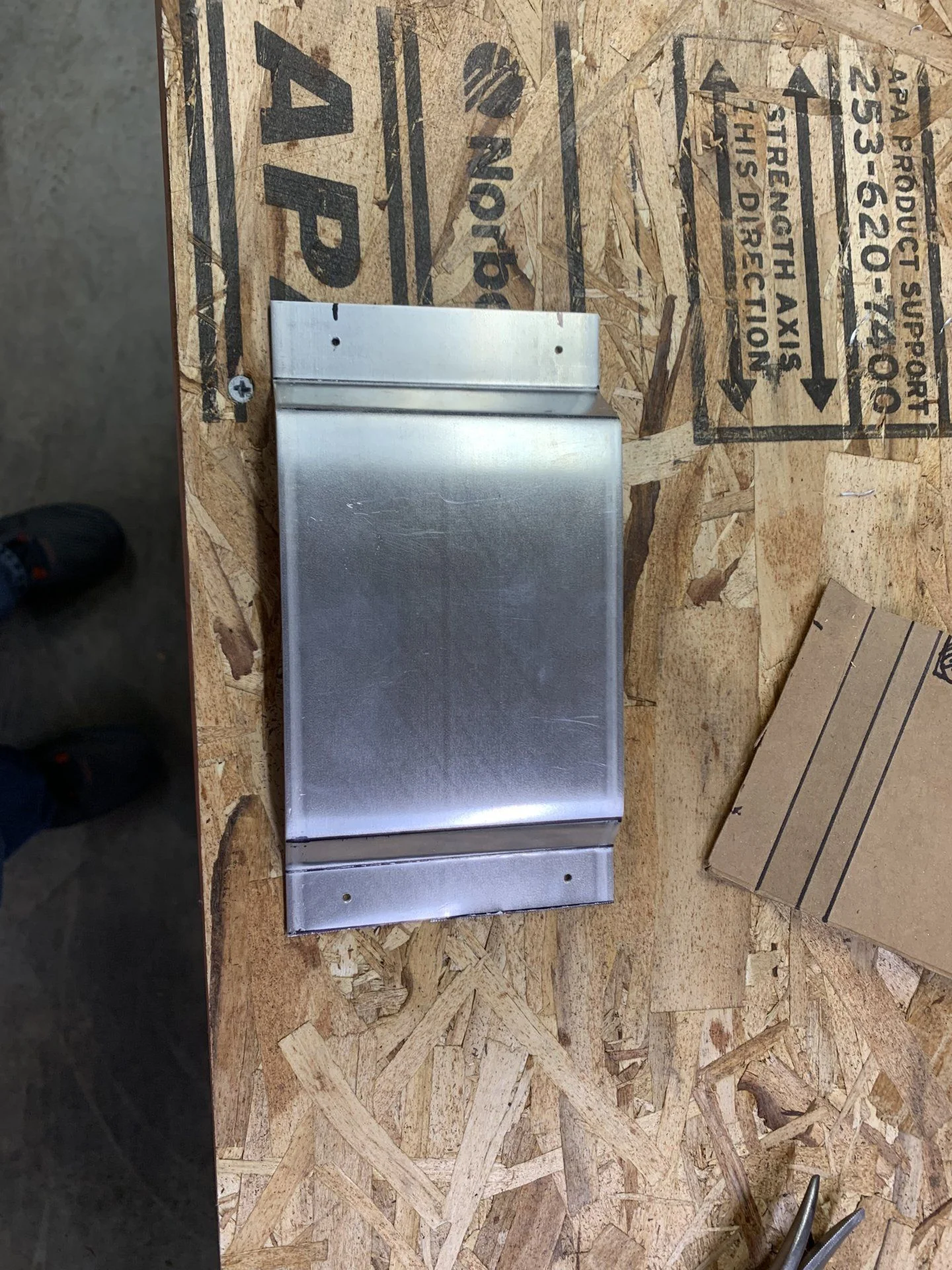

Fabbed up a bracket for my Fuse block next to the battery without limiting access to the factory fuse box. Anxious to get some electrical goodies to start wiring in. think I'll start with under hood lighting.

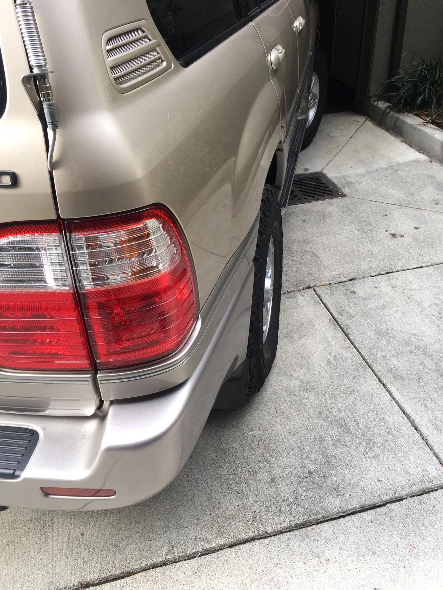

Installed a Cobra 75WXST....trying to find a rear antenna mount was the most difficult part of the whole project. I ended up going to a shop here in Washington that had various brackets, the one I ended up with was meant for a CB to be mounted at the hood on a Chevrolet. With a little tweaking and modification, I made it work.
Ran the coax cable on the passenger side and in to the center console where I cut out a small section of the lower driver side of the console to run the wiring.

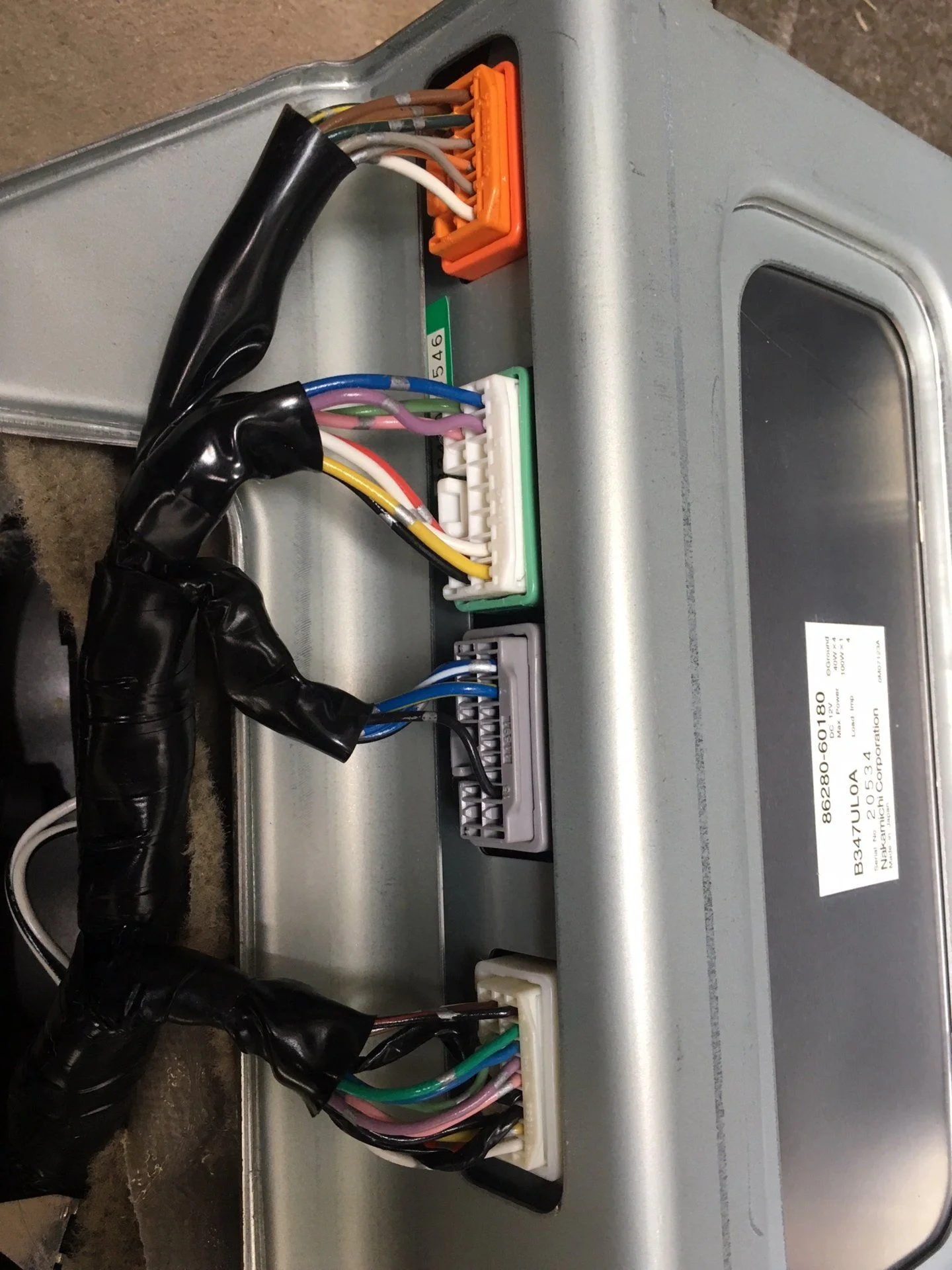

I also ordered the Slee AHC control module, at the same time I decided to install the Slee wheel spacers to widen the stance while it's in 'H' mode.

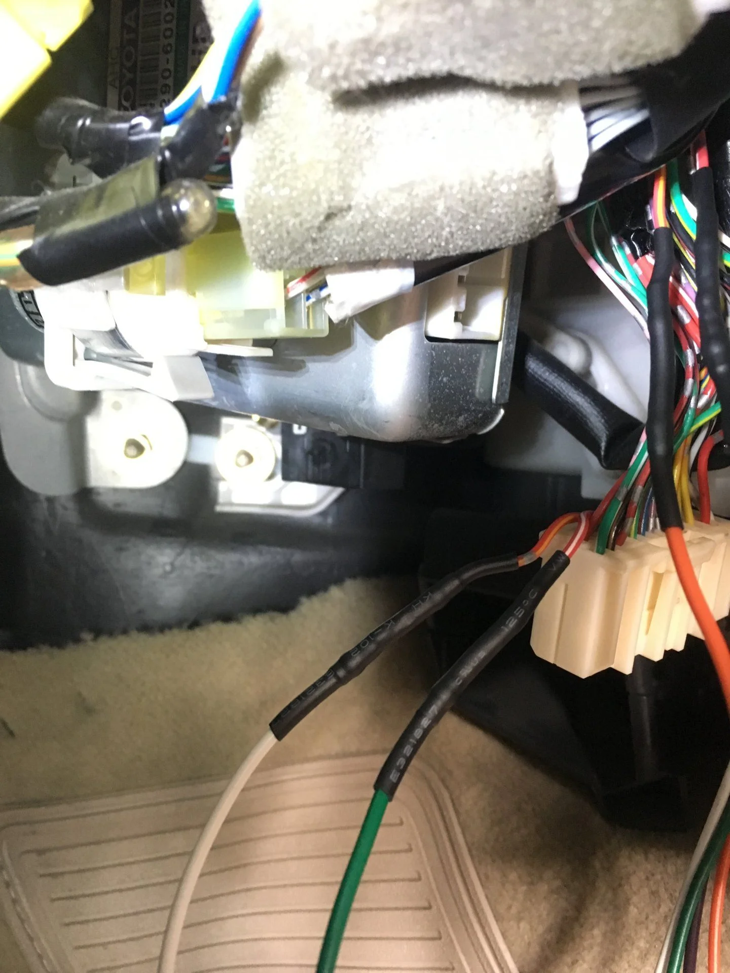

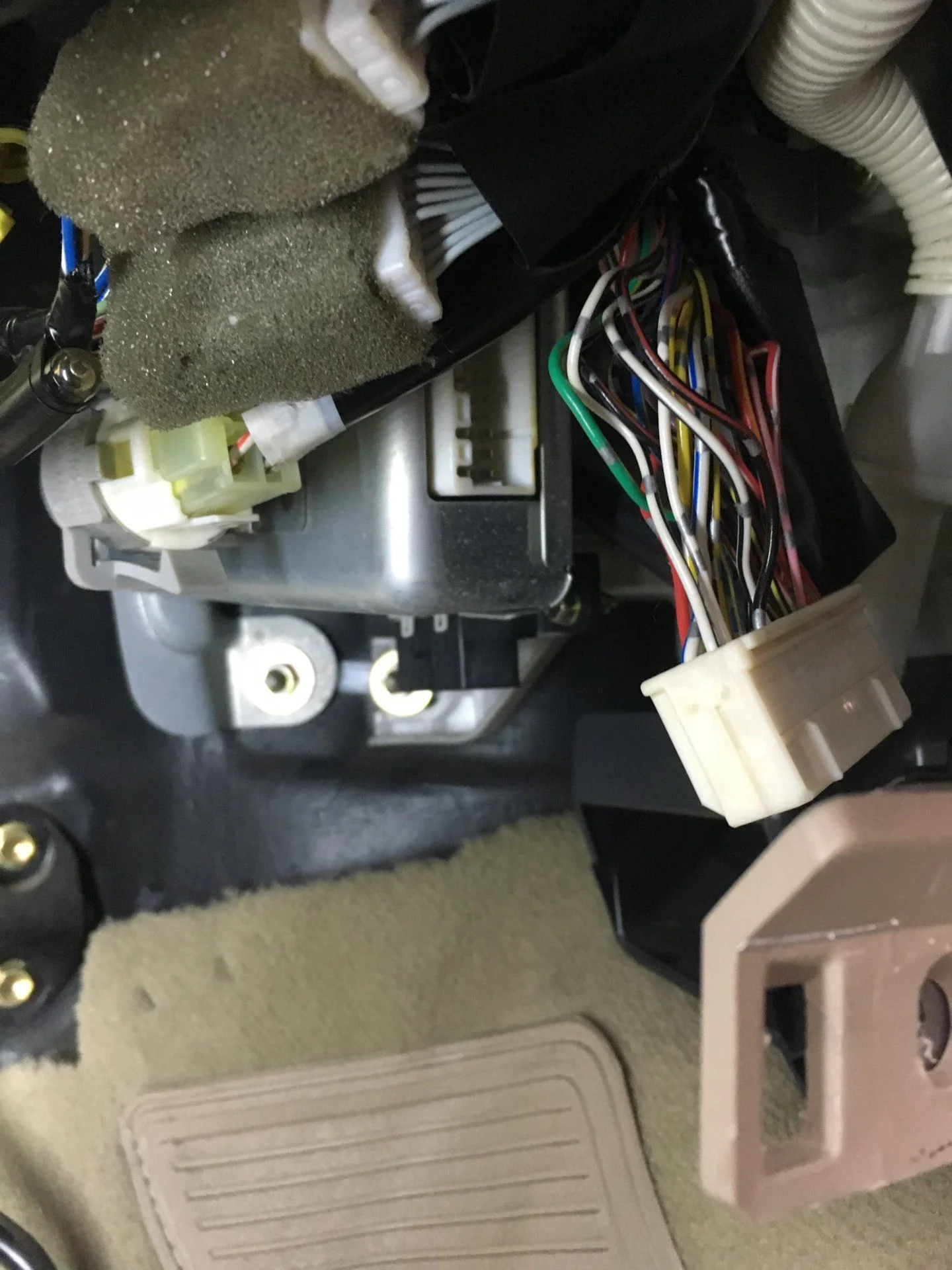

Just installed Slee's AC Controller. I haven't been able to find any wiring photos from previous searches, so I thought I'd go ahead and share.
All in all, it was a pretty straight forward install, but you'll need to practice "Toyota Yoga" to be able to get up underneath the dash to get to the height control module. The LED on the Slee module is pretty bright, so keep that in mind. Also, I may not keep the AHC on my rig, so I installed the switch and LED in a convenient location that wont be an eye sore if/when it makes the change next to the cog lighter justa bove the center console.

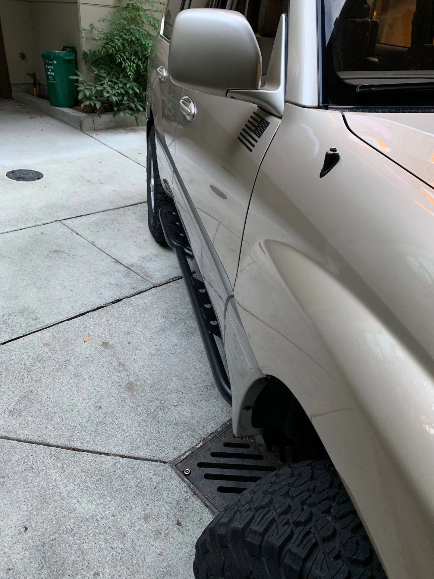

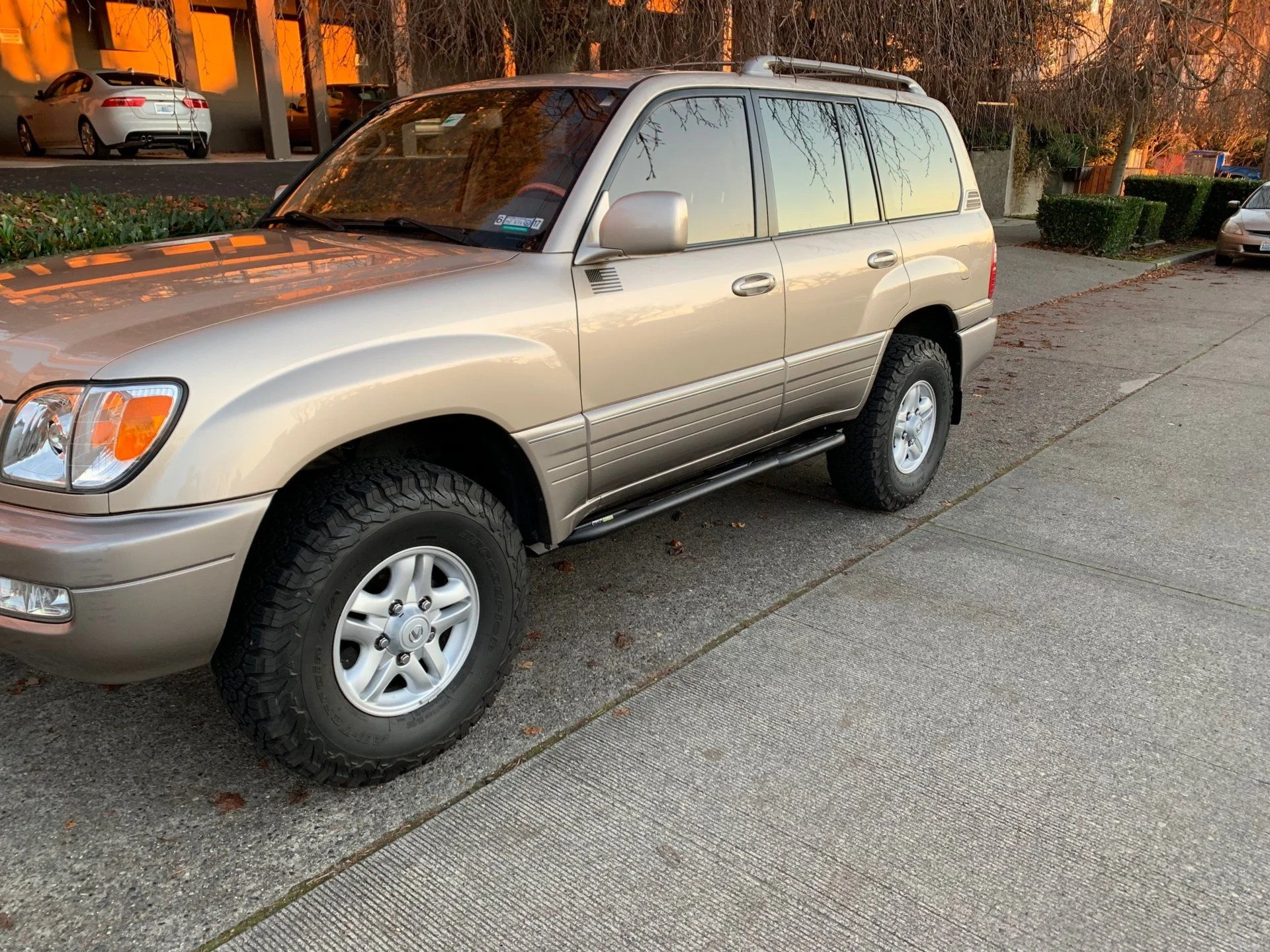

Installed my Metal Tech Sliders. Pretty straight forward as long as you make sure to remove the hardware for the shields on the AHC globes. Very happy with how well these are built.
Took more time threading and tightening the hardware on the u-bolts that go around the frame. I'll definitely be trimming down the excess.

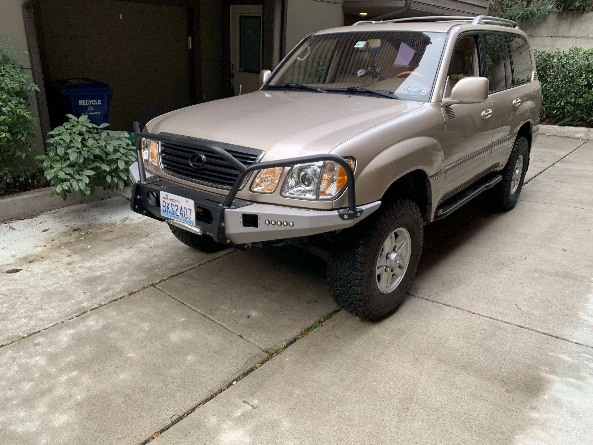

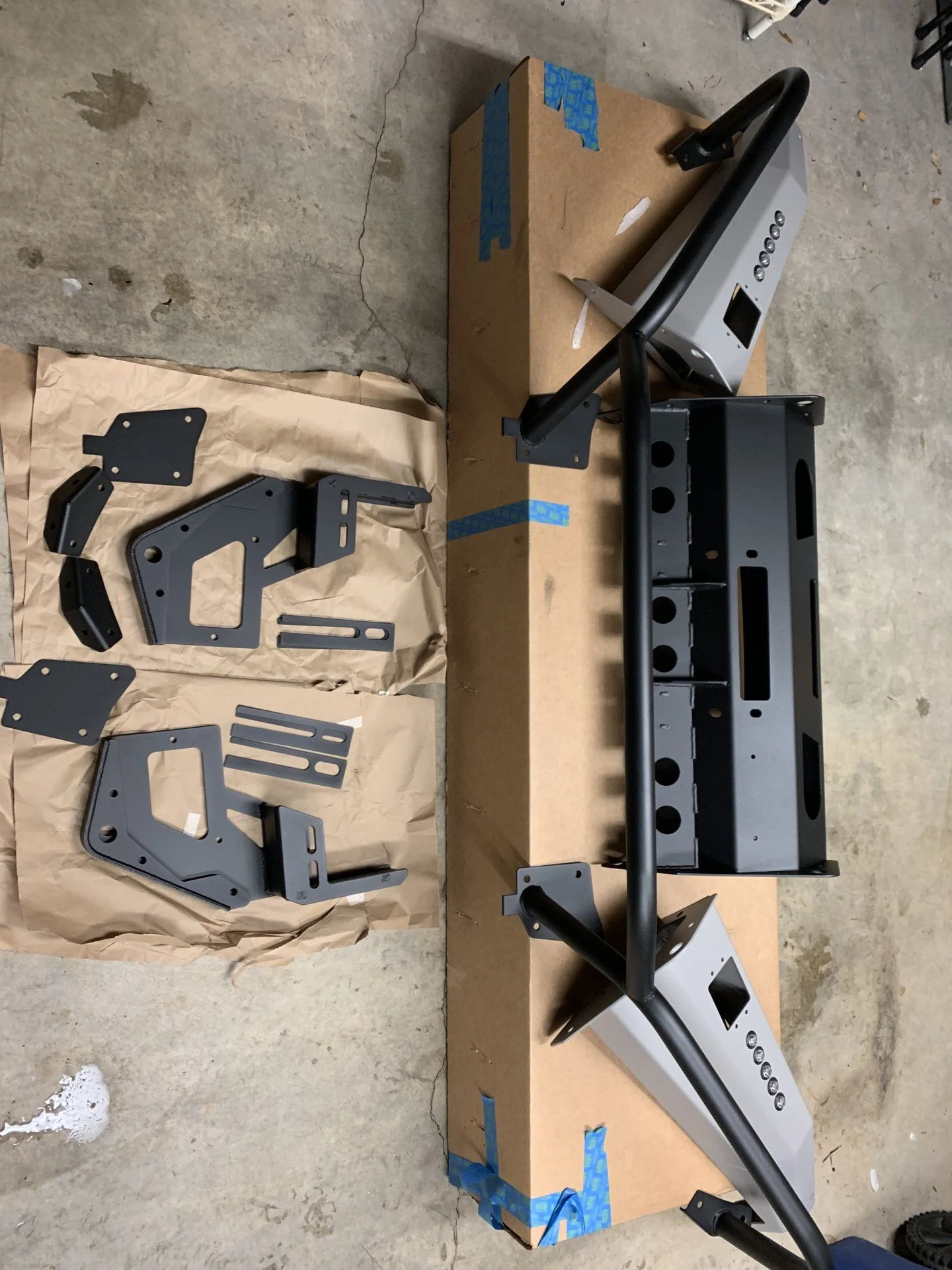

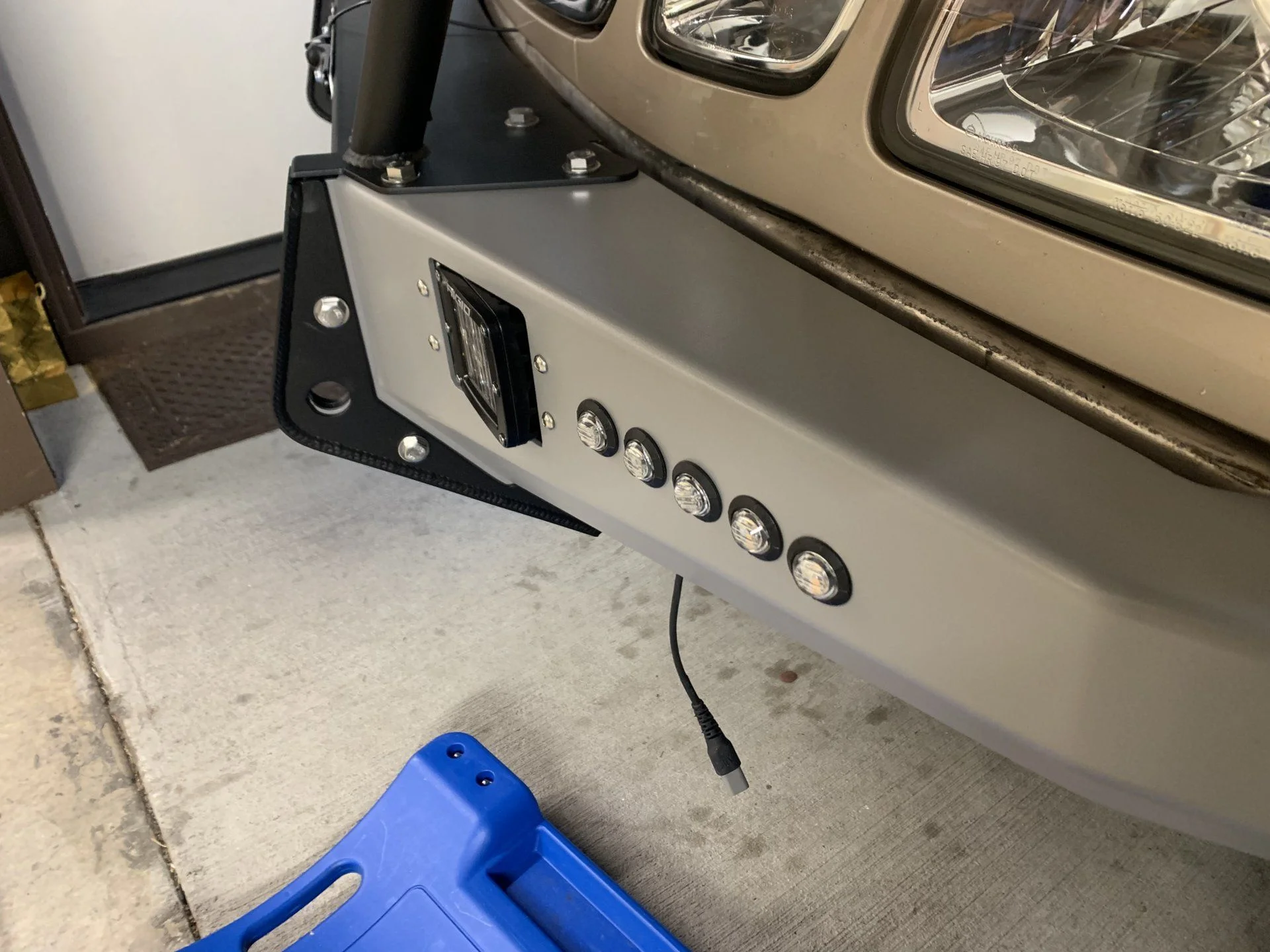

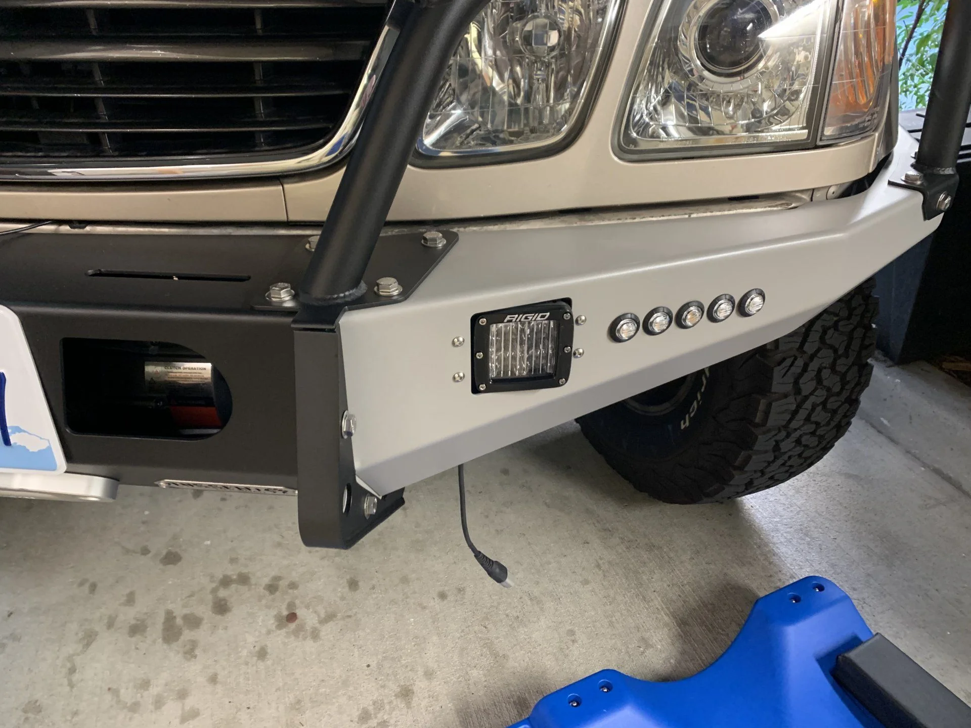

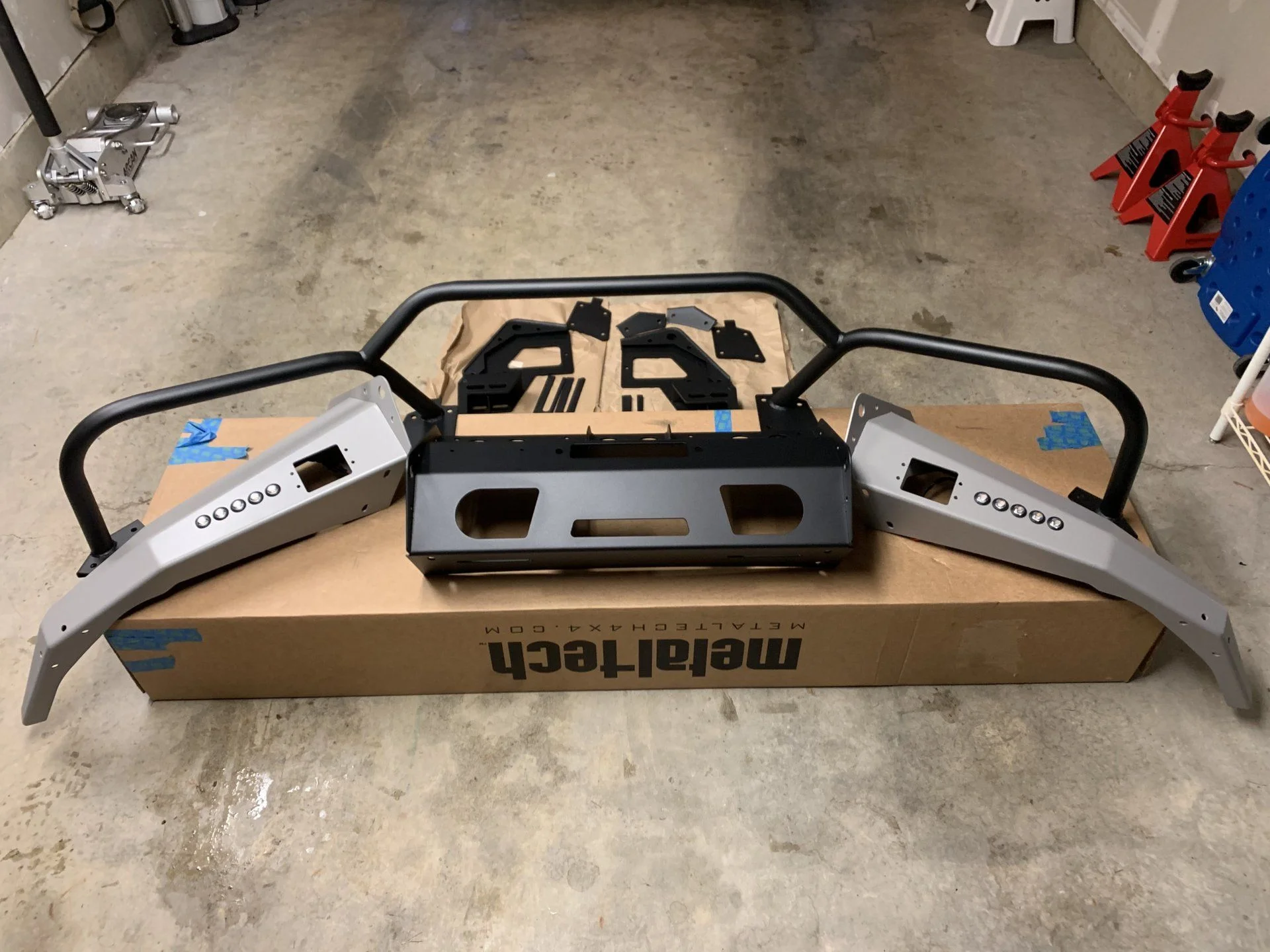

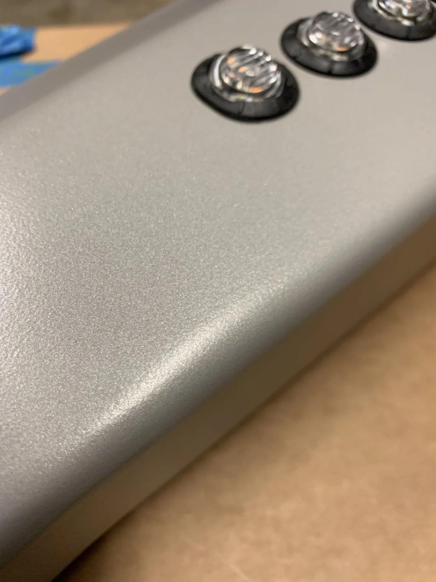

Installed my Dissent front bumper today. Worked with a local powdercoater over several days to find a color that matched my trim. The color wasn't perfect, but that was my own fault. The powdercoater did an excellent job and the turn around was less than a week. It cost about $450.00 after tax for two different colors. The staff were great to work with and very eager to help me decide on colors.
Ben @benc has an amazing product. Its very easy to tell how much effort he put in to designing a great product. A few lessons learned along the way, but great none-the-less.
Made fog light brackets for a true fog light to fit in the Dissent front bumper cutouts.

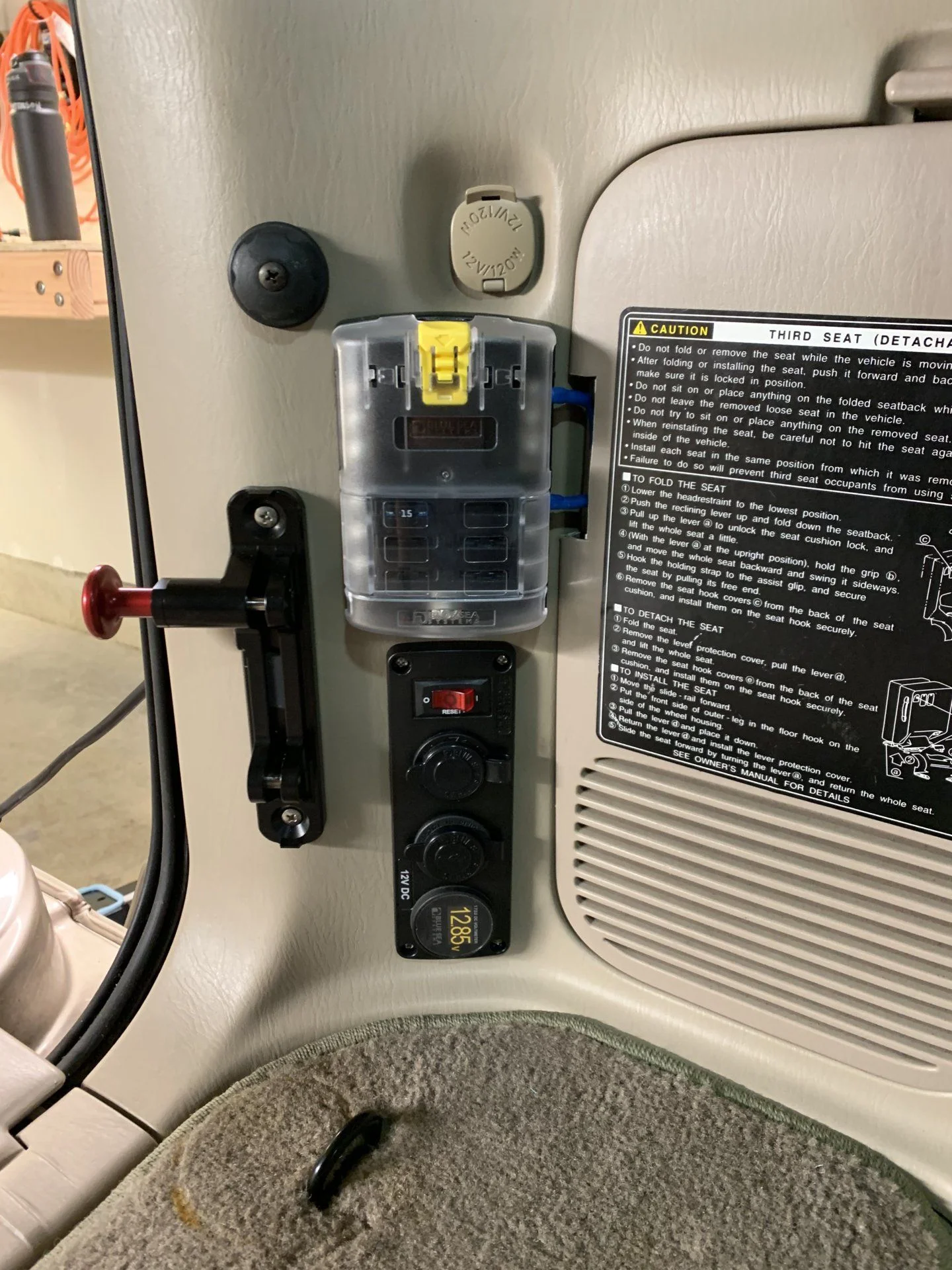

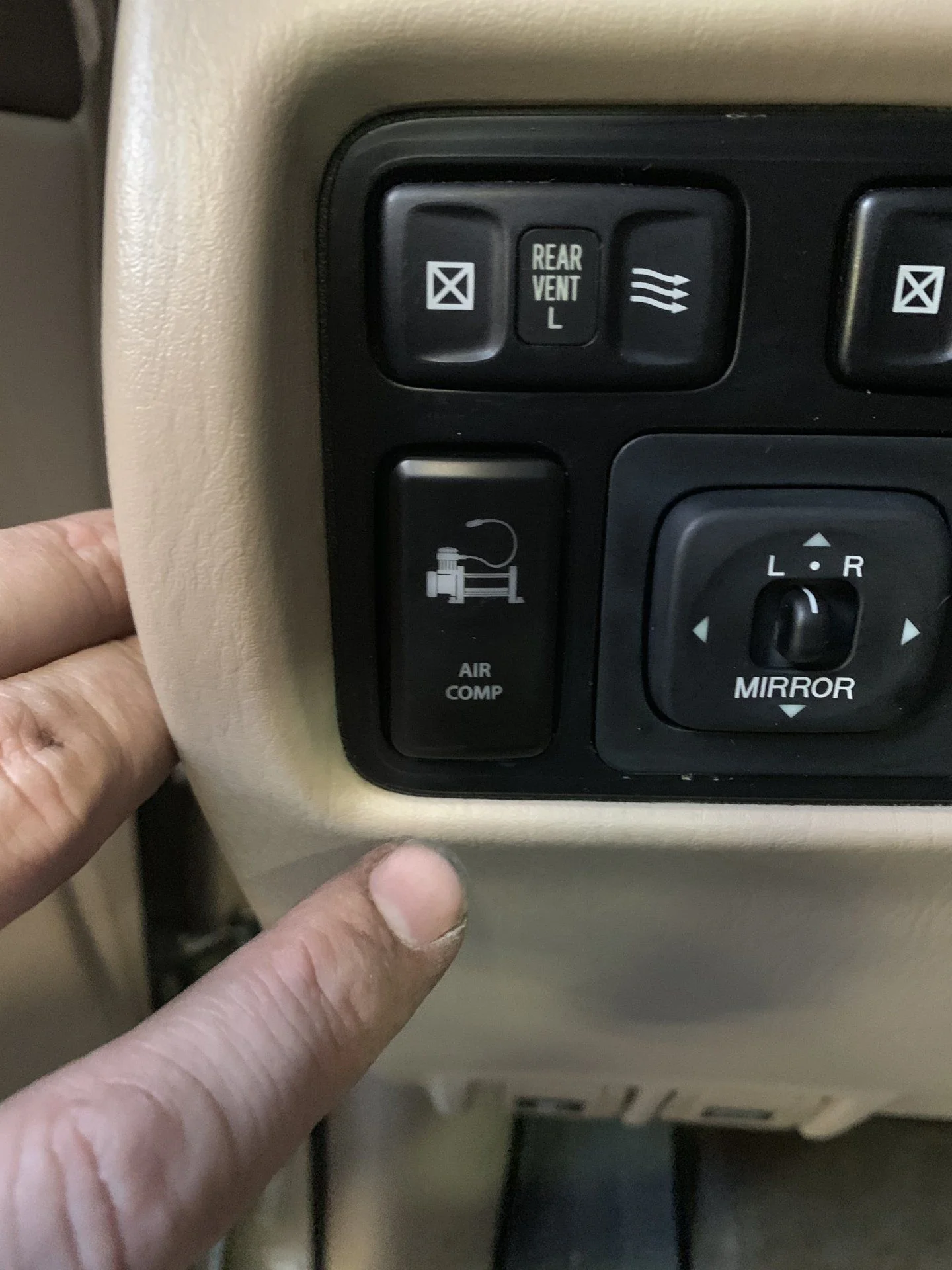

A few things that have been done this week to make it easier to add on some other accessories in the future as well as adding a little sound deadening in the rear quarters. Now I have a dedicated 12v power source in the rear for USB or for a 12v socket with a voltmeter to keep an eye on voltage until I install dual batteries. I have to admit at the big difference the dyna mat material made

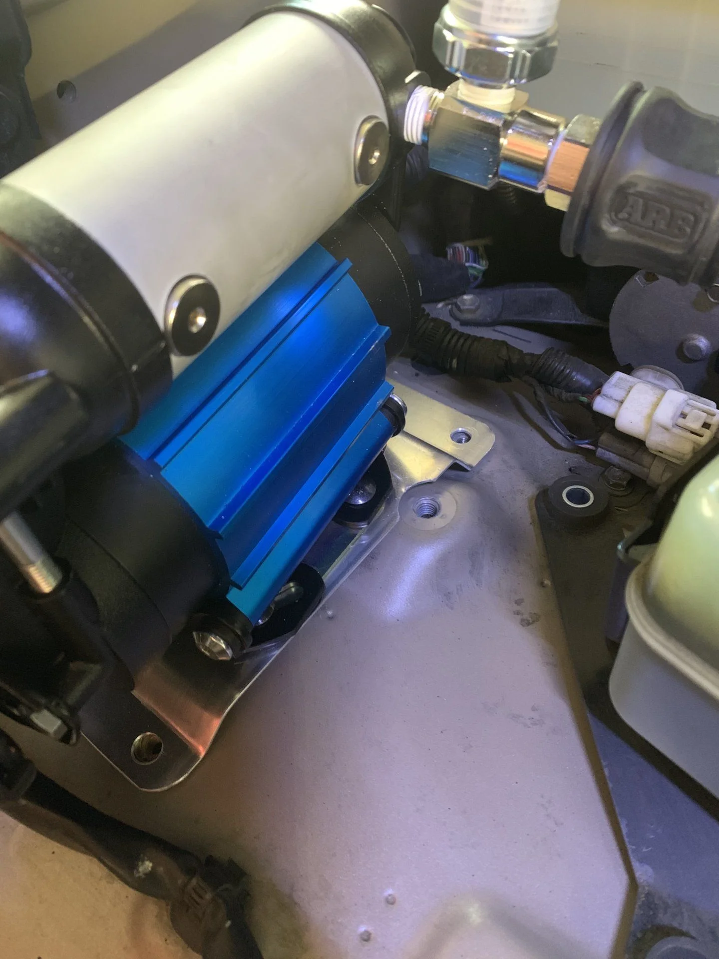

Finally added my ARB compressor. This has been on the 'to-do' list for months. Overall, I'm happy with the install. Made my own bracket to mount it between the airbox, AHC reservoir, and the power steering fluid reservoir. It isn't exactly what I wanted, but I was able to mount the compressor without relocating any of the big stuff.

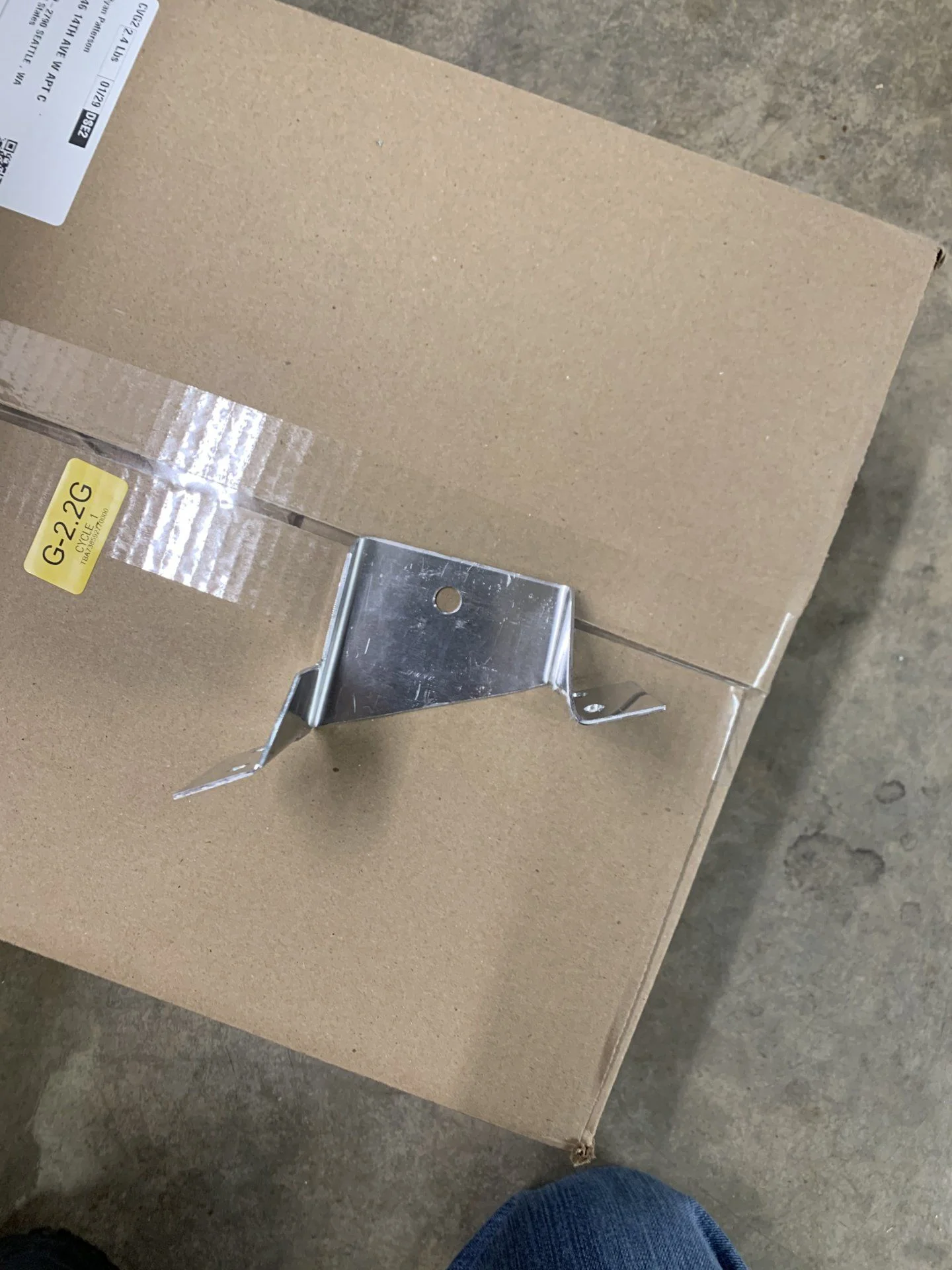

Ordered a @trailtailor front dif. drop and rear antenna mount. I can't believe how fast they shipped. I had everything here within two days of ordering.
The quality was even better than I expected.
