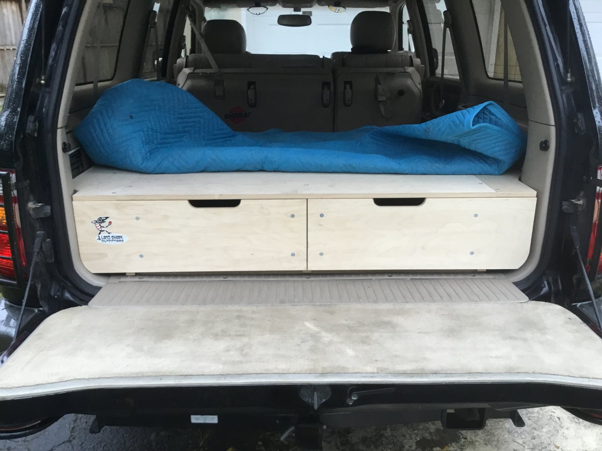

I’ll try to post up a few more. Waiting on piano hinges...
Also thinking about topping them with 24” foam tile squares from Costco.
Nice! That would be easier on your knees if you had to climb around on it. I have the same thing in my hundred and when I put my dog's back there they just slide around so I need to figure out something to give them more grip. The foam squares from Costco seems like a good idea

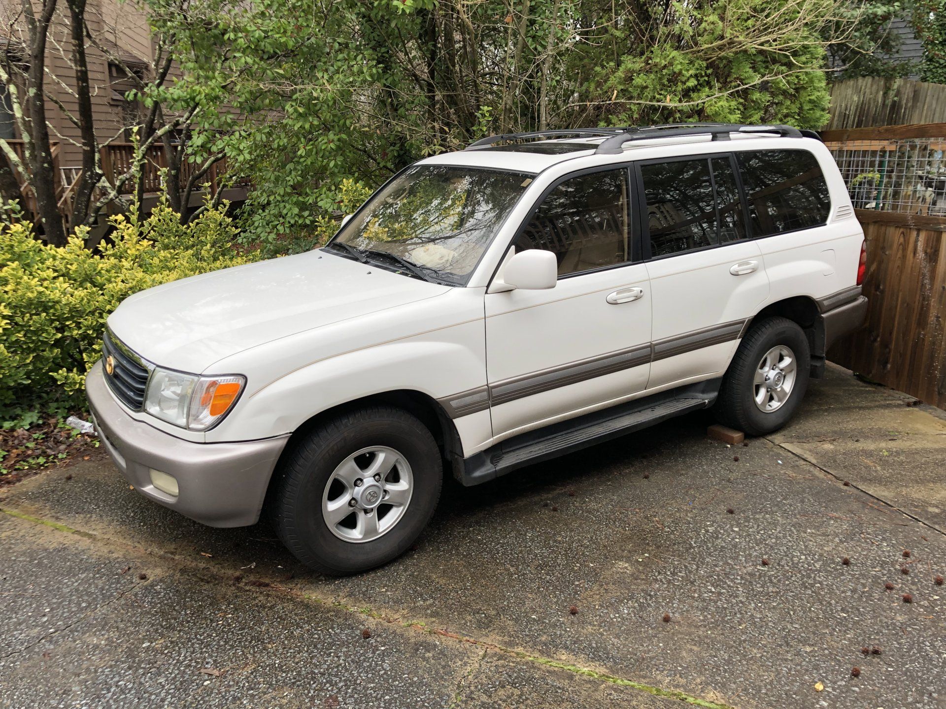

I’m very glad to say that I finally bought another 100 series after I missed my old 1999 black LX 470 , I count myself very lucky to a found a 1998 white Land Cruiser with the optional rear locker and a perfect service history with no deferred maintenance and it’s been in Marietta Georgia it’s whole life and have us never seen salt. I have owned my 200 series for about four years now and love it very much but there’s a special place in my heart that the 100 series just touches I look at it like a nice worn leather glove that fits just so perfect.

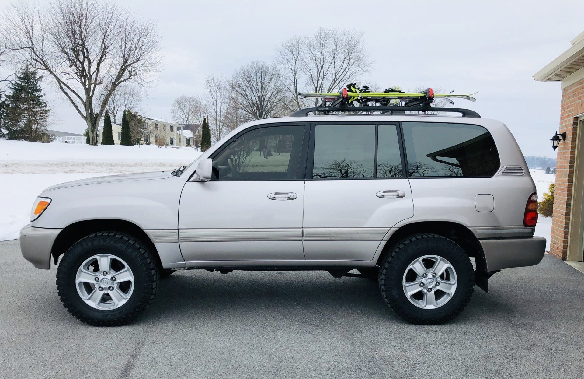

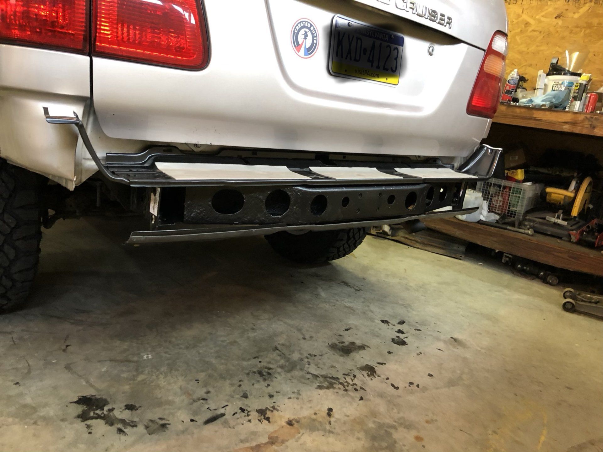

Finally tore into my recently purchased 2000 w/ 179K on the clock. 2 owner PA truck so some as expected rust scale underneath but surprisingly solid overall (wouldn’t have purchased otherwise). The rear bumper reinforcement & impact pad did need attention IMO so I pulled it apart and ordered new Toyota replacements. Applied POR15 to the rear section of the frame while it was accessible. Rig came with an OME 2.5”’ kit installed with Slee dif drop. I swapped out the 860 coils for 865 to level it out & soften the ride a bit. I only haul ski gear, mountain bike & golf clubs! And finally a set of Tundra wheels with 275/70-18 Duratracs. Installed 1”’BORA wheel spacers on the front. Ride drives handles great. Scheduled for a trip from PA to CO in the fall so still some preventive maintenance & baseline work to be done.

Perfect stance!
I miss my 865’s - they had a great ride without the huge tire to fender gap in the rear.
Those tundra wheels look right at home. What are your thoughts on the duratracs ?
Registered the first 50 miles on the tires today. Much better ride over the BFG KM2 that they replaced. Drove home from the slopes in a mix of snow & sleet and they performed well.
