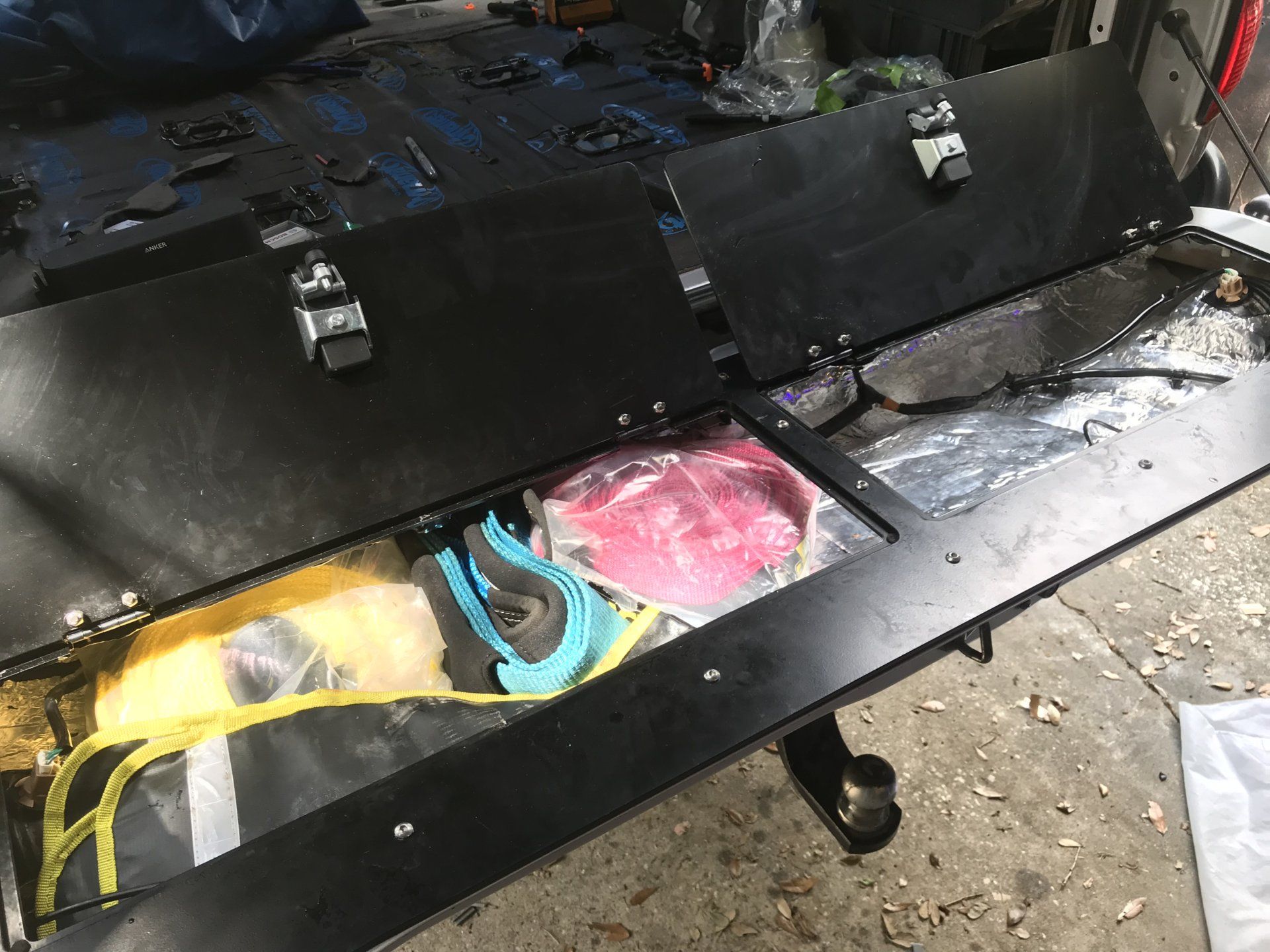

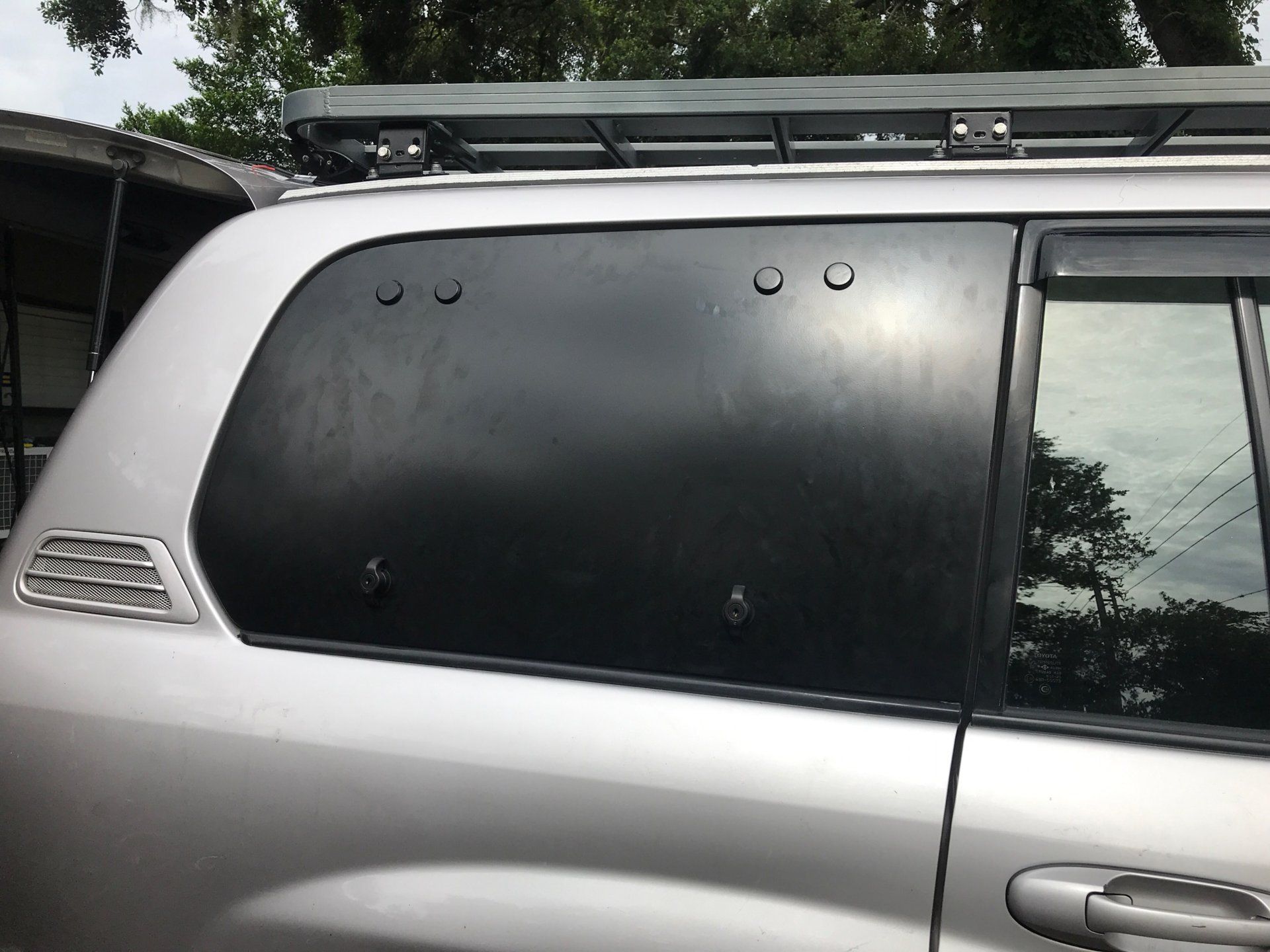

Next, we decided to break out the big power tools and cut up the tailgate. Thanks to Jason at Trail-Tailor we now have tailgate storage for straps and crap. Reaper also likes this since they took up to much of his trunk. :)

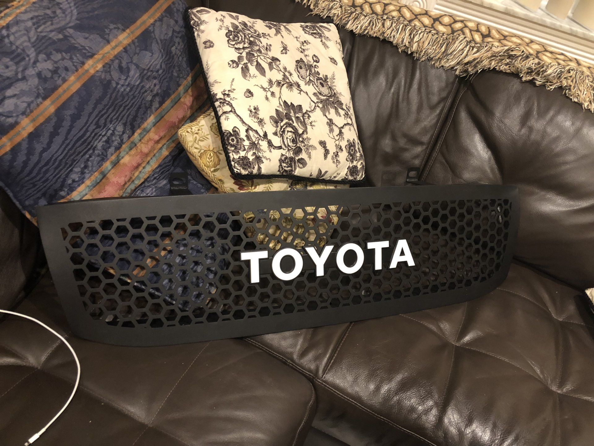

Got my new grill.
100% worth the wait.
@kellysaad.
Real easy to install and very solid. I wouldn’t change a thing.

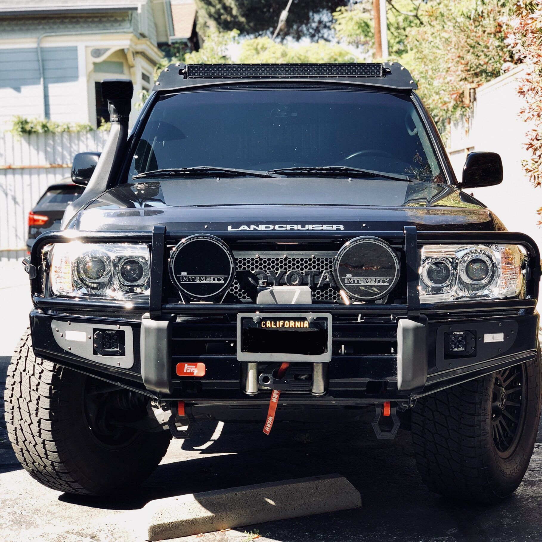

Got my new grill.
@kellysaad.
At least she looks good.
She looks great.
Ill second Kelly's Grills. They are straight up Patagucci Farkle. On e of the coolest things on my rig. Kelly rocks!!!

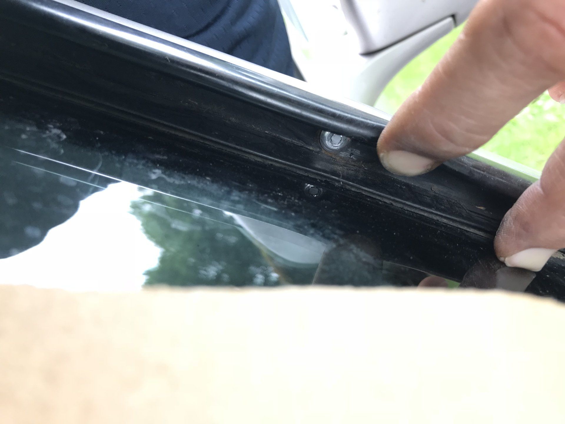

While under the truck I noticed a little water dripping from the plug in the cabin floor on the driver’s side. I’d been having wind noise along the left side of the windshield and thought there might be a leak. Found the previous windshield replacement was done using screws and there was one missing along the driver’s side. (Probably the source of my noise and water.) Now, I have no doubt they’re well crafted, quality screws, but as we know they’re not the best tool for the this job. I replaced the screws with 3/16” rivets and a dab of FIPG. The window job took about an hour, including the time to go out and buy the rivets.

Crap... I forgot, I also put Noico 80 mil sound deadener in my new rear tailgate storage. This is the on,y thing that is easier in The Florida sauna.
