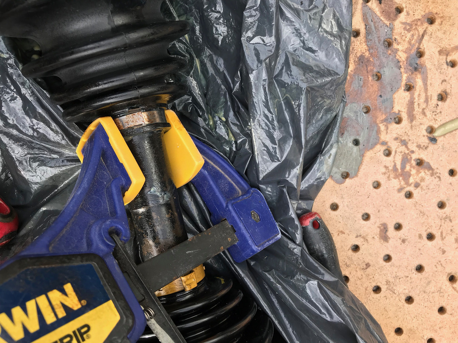

Traumatized! Attempted to reboot my torn CV’s. Sloppy sloppy job. I couldn’t get the freaking fastener straps on tights. Here’s a pic of the aftermath. Does anyone know the proper tool to tighten this style cv boot strap?
LOL holy cow that looks like the Exxon Valdez spill.
As for the clamp tightening, no special tool required, what you do is have it seat nice and snug against the boot and fold it over.
Use something like this to keep the tab from unfolding
Then just tap the wings and fold them down and it'll stay put. I did this method and haven't flung any grease out of the clamps area yet.
Looks like you have the right tool for the pinch type clamp, that's what i used too, but gotta put a lot of back into it to make them close.
new axles looks easier
That’s a pretty damn good idea, thanks!
