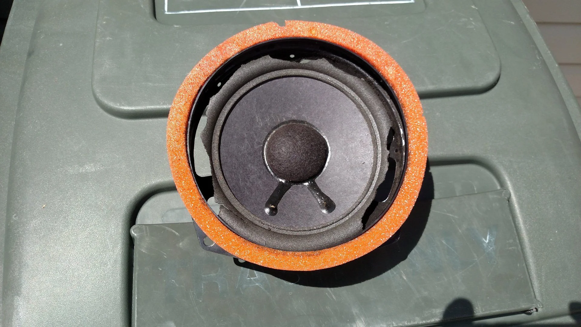

Replaced all four speakers per @brizzle 's vid instructions, painted the grills. Replacement was long overdue:

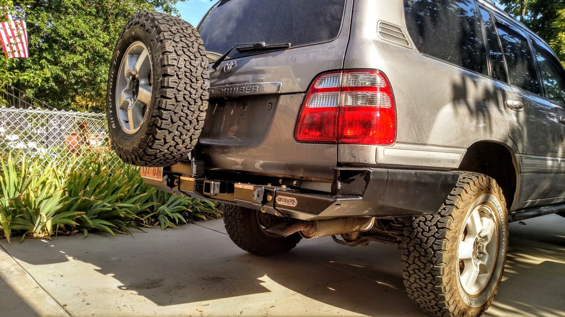

Bolted on WKOR sliders, and installed the new dissent rear from @benc . The bumper is well designed and awesome!
