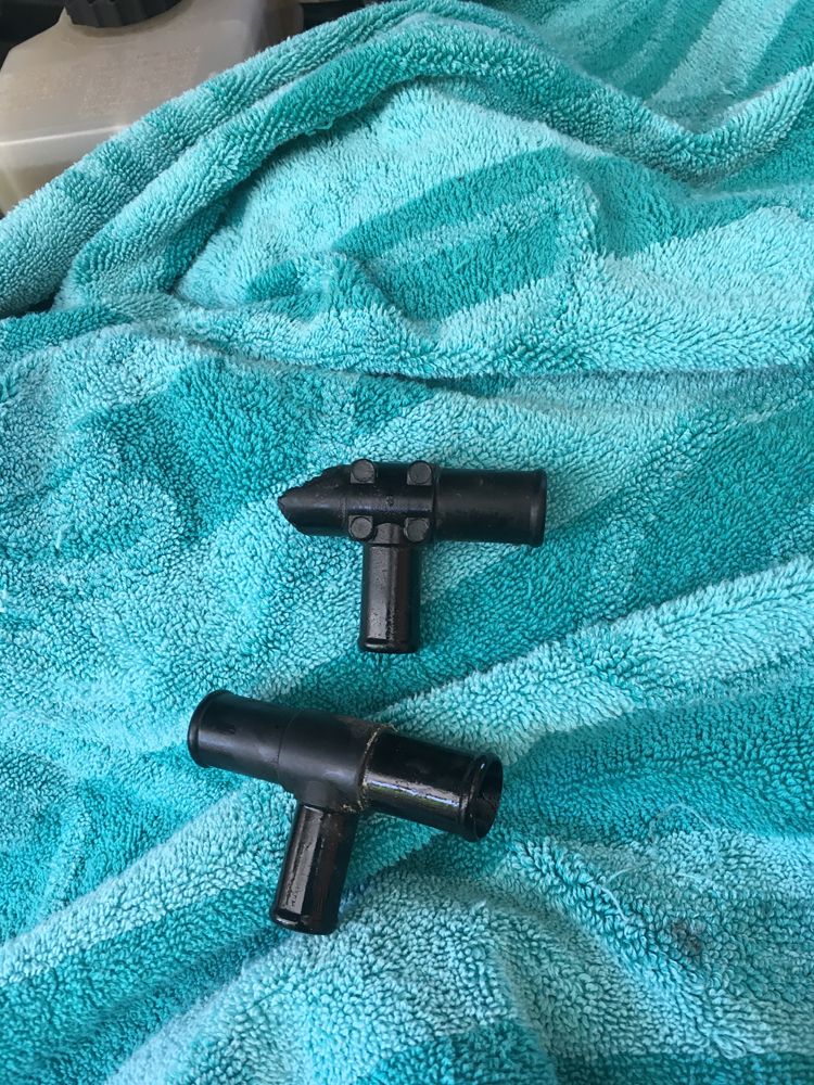

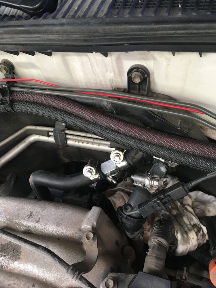

First up, replacing heater tees. Went to pop one out and it broke..... so good thing I changed them out. BTW, my cruiser is a 2001 with 175K on it. Went a bit over the top with the replacements. Stainless Tees and constant torque breeze clamps. Pro tip, get a hose clamp tool and hose hook too. Made everything so much easier. Here are the links to all the parts I used:
- Stainless Heater Tees
- Hose Clamp Pliers
- Breeze Clamps
- Hose hooks

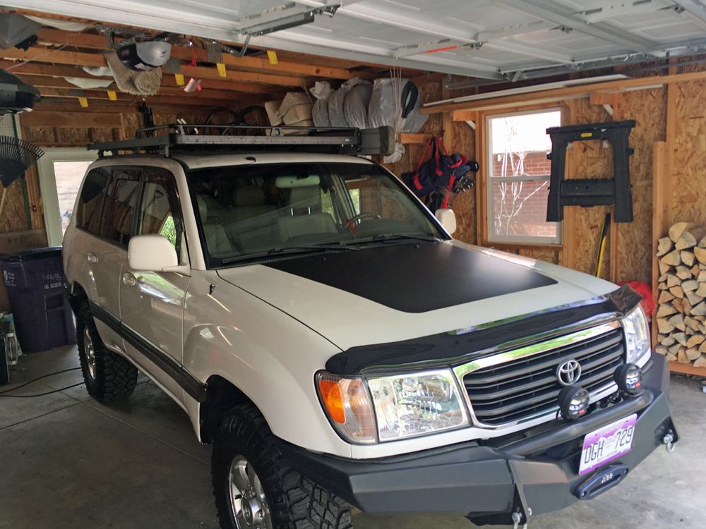

Second, finally put on the hood blackout from the group buy. Was surprised how easy it was to put on. Hardest part was popping off the windshield spray nozzles. Pro tip, use an old credit card to pry up a bit and push in the clips from the top side of the hood.

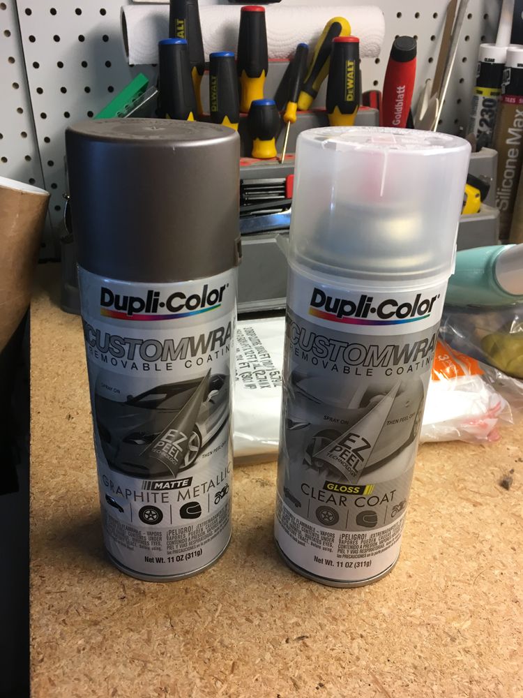

Last item of business was to fix the trim. Mine was flaking bad. Always wanted to give Plasti Dip a try. Figured there was nothing to loose since you can remove it. Went with the Dupli-Color brand since it matched the stock color pretty closely and it was metallic. It is as easy as all the videos show. Tried two masking methods. 1) index cards and precise taping (top of trim). 2) Masking 1" from trim and allowing over spray (bottom of trim). Both methods work, but the over spray method worked perfect and was super easy. After it all dries, just peel away the over spray and it leaves a perfect line. Was actually really impressed with the Plasti Dip. Looks pretty close to stock and the metallic looks like normal paint. I did 5 coats of the metallic and 2 coats of clear coat. We'll see how it holds up.

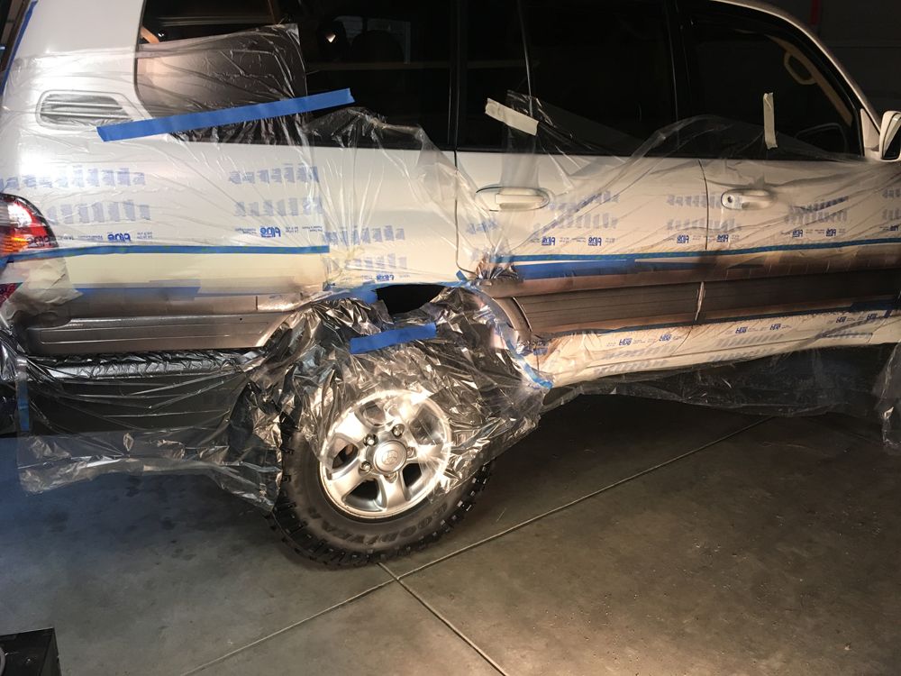

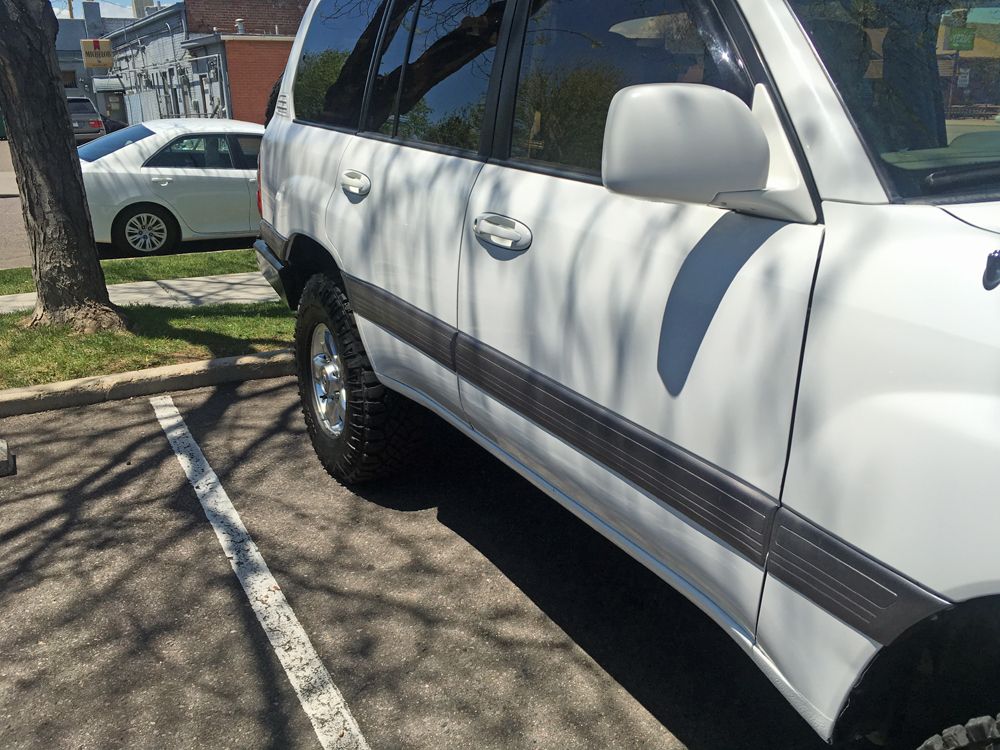

De-chroming.
I went with a gunmetal color, as opposed to the popular black.
Great look - how is the front? How did you de-chrome and what type of paint did you use, or is that plasti-dip?
I haven't gotten to the front yet, I'm building a Satoshi grill for it.
I used plasti dip. Silver metallic over black base.
