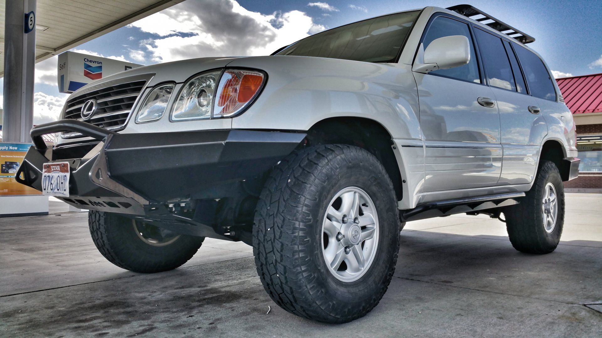

Went and checked out some trails in Oconee National Forest. First time out without AHC and I'm LOVING IT! Found a little mud and even got some atrac action...

pics like this makes me want to keep my AHC...great flex.
Stock AHC is plenty capable and I'm still learning how to be a better driver. There's definitely times where I wish I had a bit more lift, but AHC makes working on the truck easier (lower it for engine work, raise it for working underneath). Plus, I wouldn't have been able to drive through this spot without dropping to N :-p
