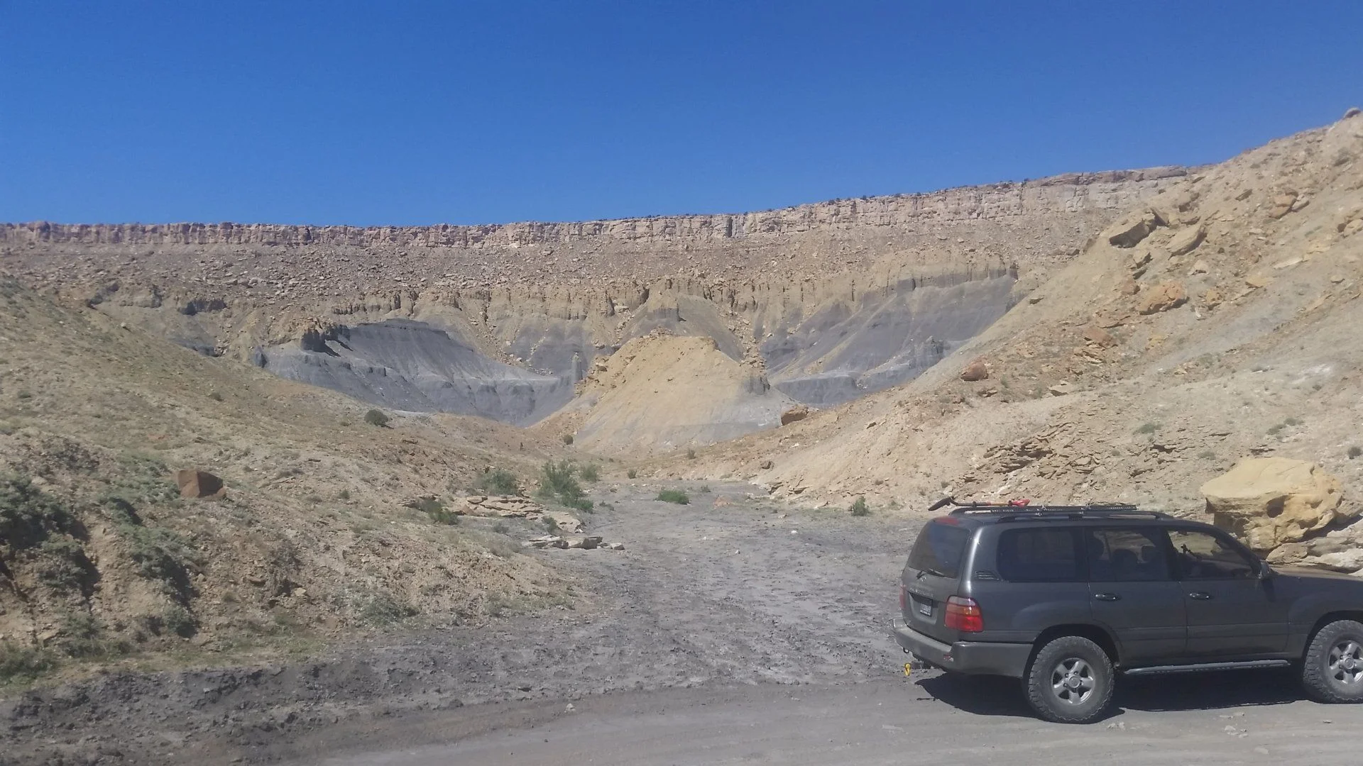

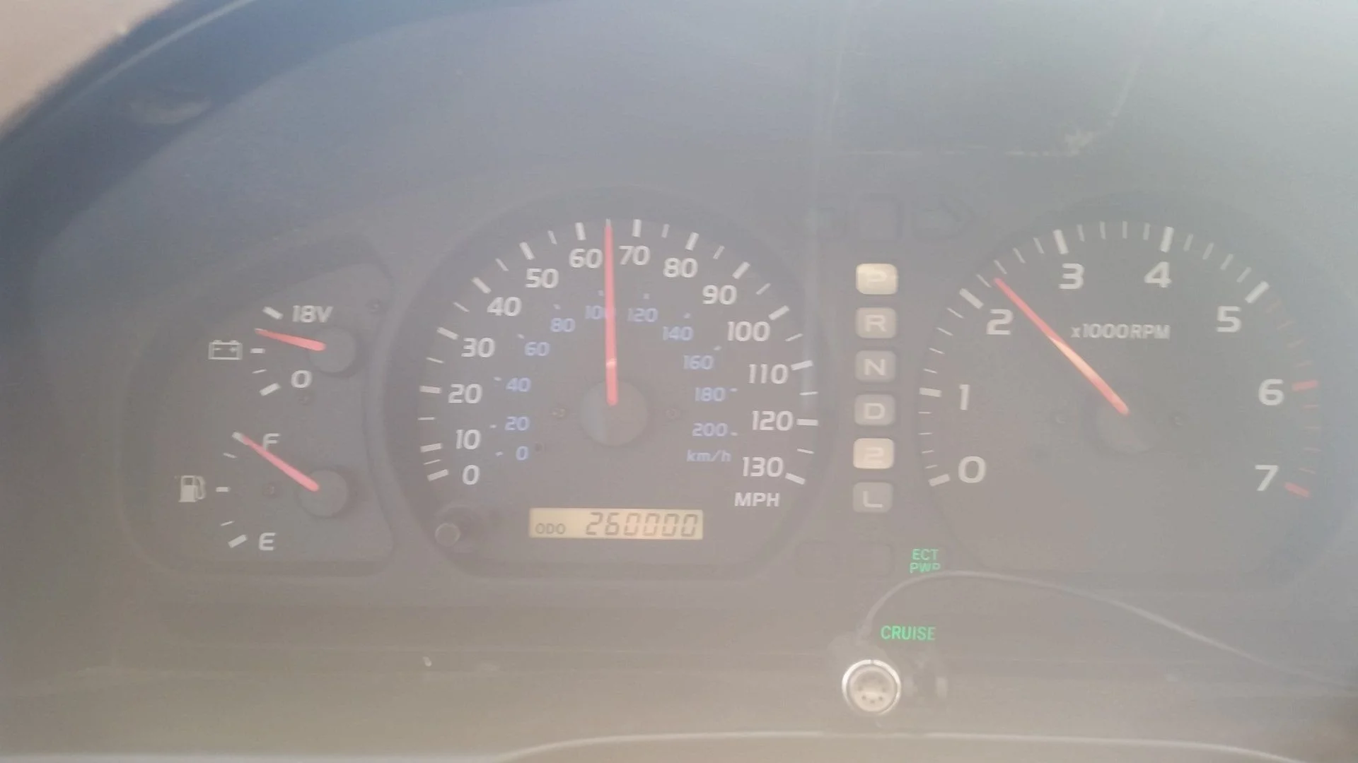

On a return trip from Kansas City I stopped off at a random exit in Utah called 'Miller Canyon' and found some nice wheeling. Around the same time hit a nice round number on the ODO.

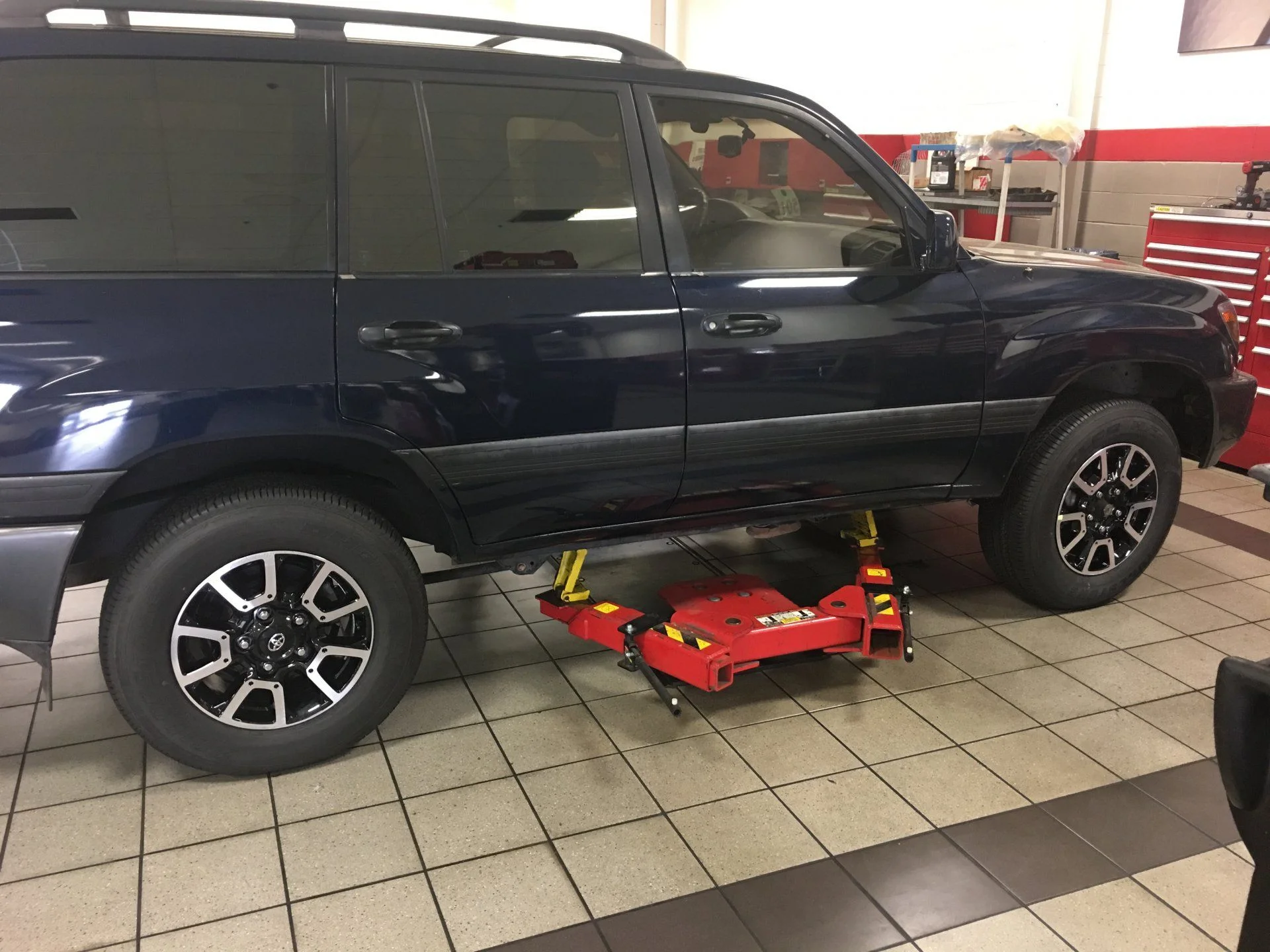

Put these on today. Was going to go with different ones but got a steal of a deal at the Toyota dealer I work at. They were take offs off a brand new Tundra so pulled the trigger on them. I'll get some bigger tires when I do a lift in a few months. Also tinted the windows and installed a back up camera for the wife when she is driving. Slowly but surely.

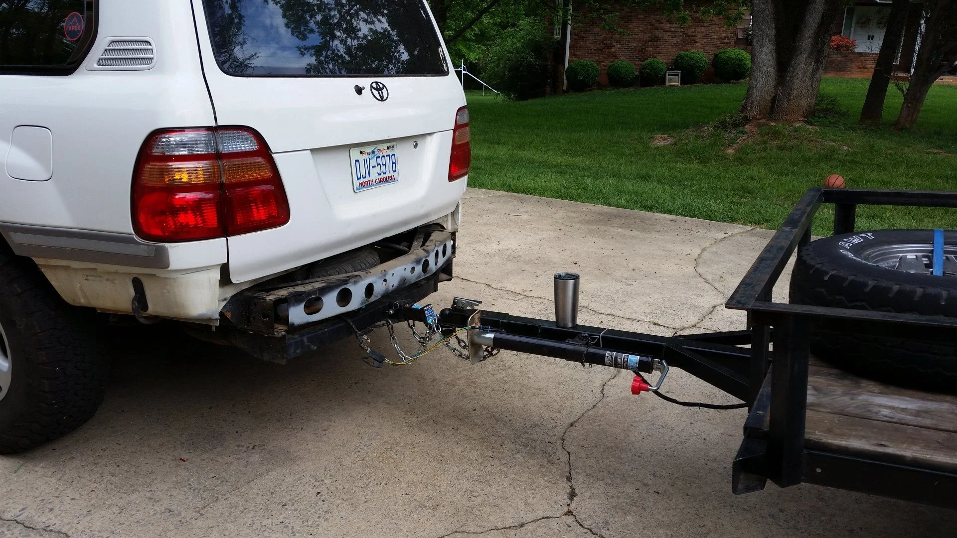

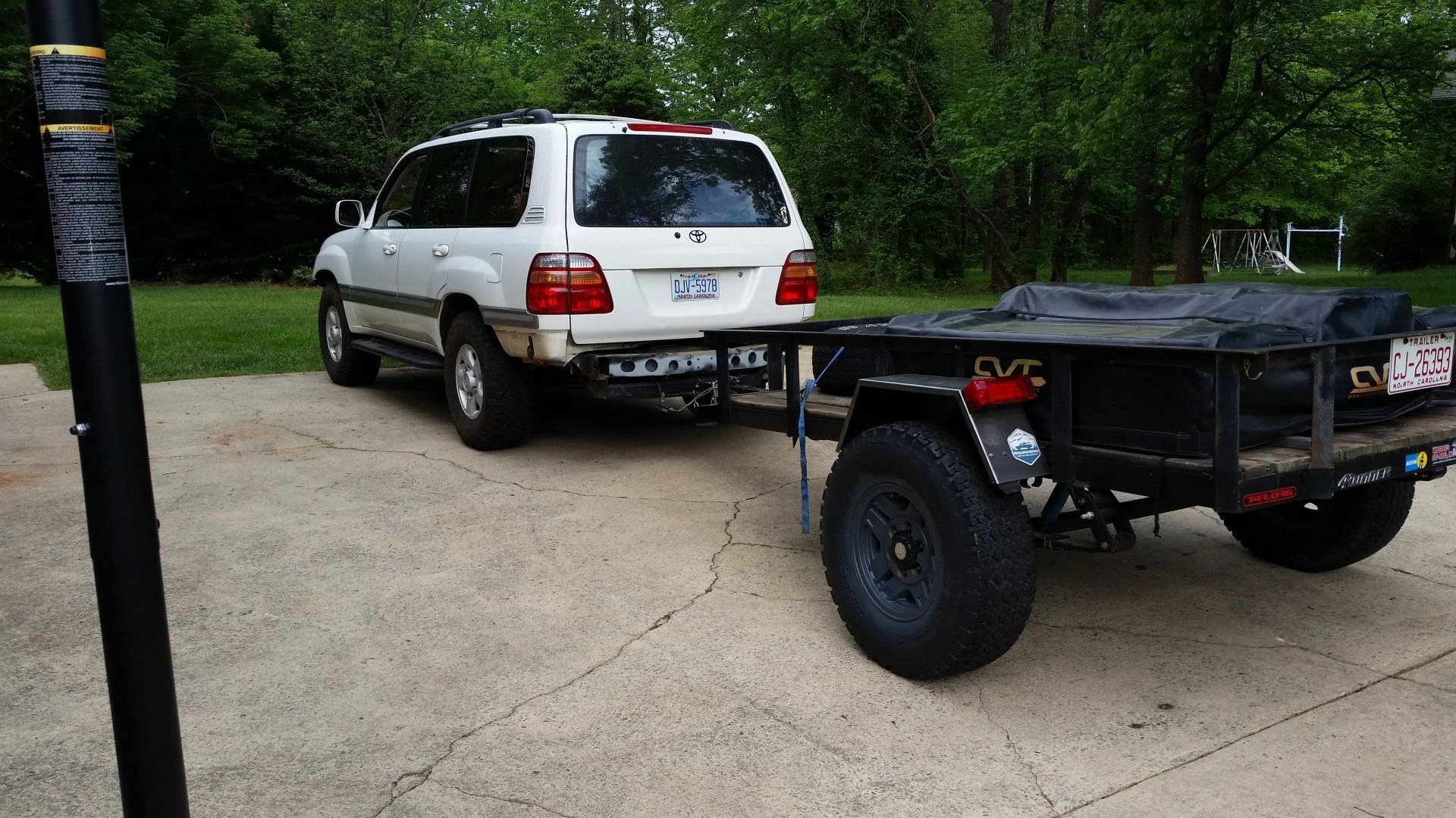

Something is missing! Sold the rear BIOR, had my trailer tongue fixed, now on to the rack and another rear bump!
