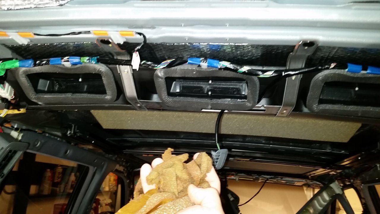

While putting sound deadening on the roof, replaced the foam on the rear AC vents. It was falling appart and sometimes blowing a chunk out into people's eyes.

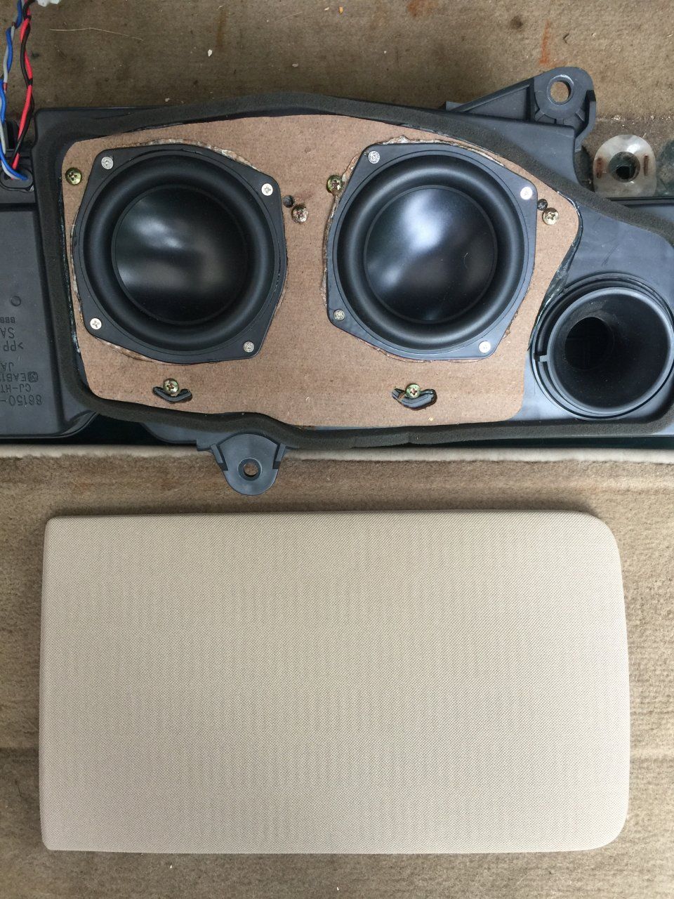

Brought my subwoofer back from the dead with some new fabric and a set of Dayton Audio ND105-4 drivers. Not a plug'n'play fit, but well worth the 15 minutes it took to cut out a hardboard adapter for the factory sub enclosure. For their size, they produce an insane amount of bass (more than I'll ever need) and sound 10x better than the factory ones. A steal at $27 each.
Woofers:
"Dayton Audio ND105-4 4" Aluminum Cone Midbass Driver 4 Ohm" from www.parts-express.com!
Speaker grill fabric:
http://m.ebay.com/itm/171171519252
Thanks for the report on those little drivers. I have been wondering how they perform. Are you still running the factory amplifier?
No. The factory amp was gone when I bought the truck, and a 15-year-old Pioneer is powering them. I did reuse the wiring from in the box to under the PS seat. That part is plug'n'play, and the change from 3-ohm to 4-ohm is negligible. I can't think of any reason why they wouldn't work with the factory amp, and I'd do it if I still had one.

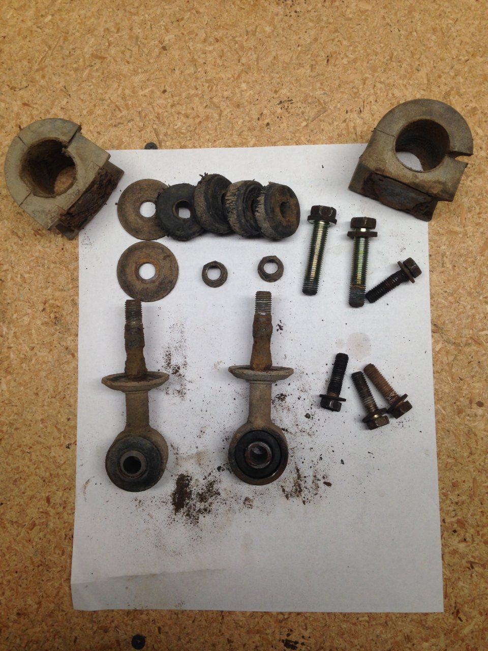

Front sway bar links and bushings refurbish.
Woofers:
Is that the sub box for a 1998-2002? if so, looks good. did you cut out the plastic and use fiberboard as the template?
Yes, for a '98. No need to cut the plastic on the sub. The fiberboard goes right over the plastic to decrease the openings from 4.25" to 3.75".
