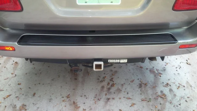

Painted the rear tail gate bumper plastic. Used Rusoleum satin.

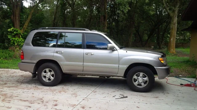

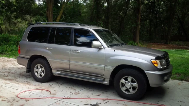

I also had the windows tinted with 3M 50% if i remember correctly. Also removed the running boars. I got an instant 4 inch lift. :rolleyes:

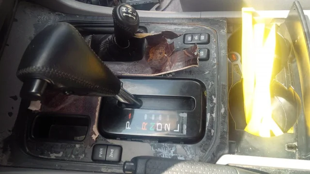

@bucfl do you have pics of the interior trim? Been wanting to do this also.
Here is what it looks like. I soaked the center console overnight to try and soften the glue. The next day i used GooGone and steel wool. I over used the steel wool as i have scratches on the center console. But ill take those over what it looked like before i cleaned it up. And you can buy the plastic trim kit at HF for like $10.
Before:
After: You can see the scratches if you look closely at the pics. But if you don't bear down on the steel wool as much as i did, i think you will get better results. Either way, i don't notice them anymore.

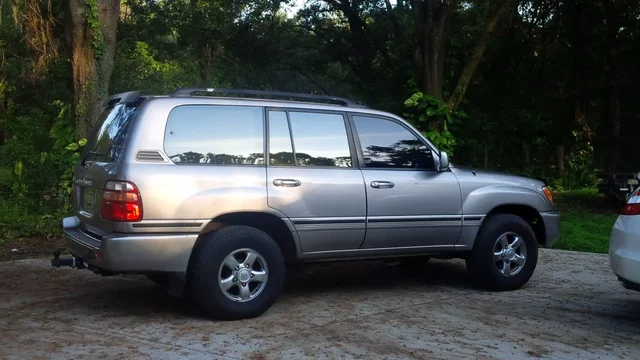

Ordered 30mm spacer for the rear from Metaltech

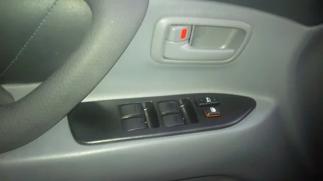

@bucfl great job. Did you do the same thing in the doors? Peal the fake wood off and sand it down?
Thank you. Yes, i used the trim kit from HF to pry the fake wood covers off. Its better if you use steel wool as it wont clog with glue and makes it easier to remove.
