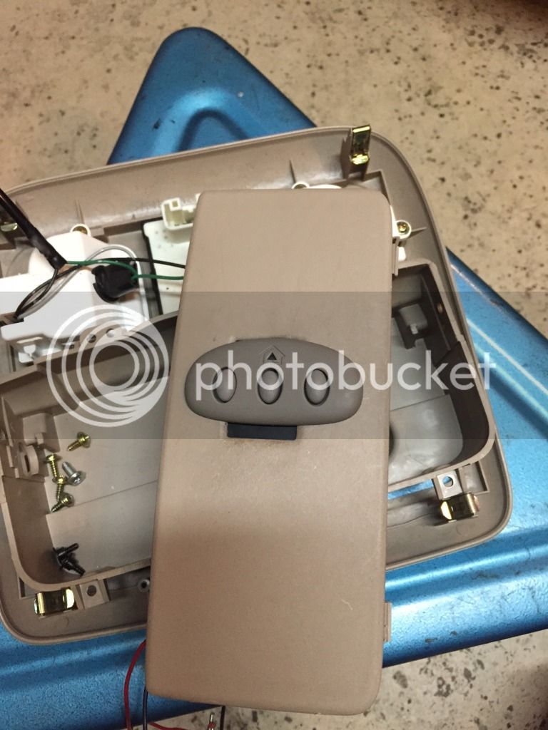

my brother had a homelink unit he got from an IS300 sitting around and looking at it I realized it would fit right in the garage door opener pocket.
took off the button portion
little trimming of the opening and snapped it back togehter
tapped into the power and ground for the reading lights and voila:
will probably figure out a way to cover the gaps on the sides but just put it in to test and all works well and took all of 15 minutes.

You could also just pickup the plate for that from a LX 470. I have the homelink in mine and the button spacing looks the same.

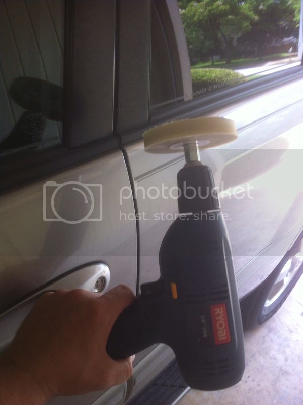

It will only take 1 - mine took less than 1/2 the wheel. My LC has spent its entire life in Texas and I removed the pin stripe when it was around 6-7 years old and the harsh TX sun had done a number on the paint - you can see sections where the stripe used to be. I was left with 3 choices: live with it, paint the sides of the LC or re pin stripe it. I chose to have a pin stripe (sticker but about to replace with one painted on) applied over the area of the original.
I can deal with a "ghost" stripe in case it happens. I'll give it a whirl. Thanks.
