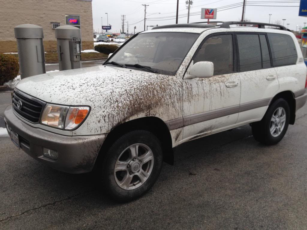

I filled up my LX470 gas tank. It was running on fumes. I used my local grocery stores rewards points and got gas down to 1.33. Filled up the whole tank for 27 dollars. I can imagine that's what people were filling up for back in 2000 when the car was made.
