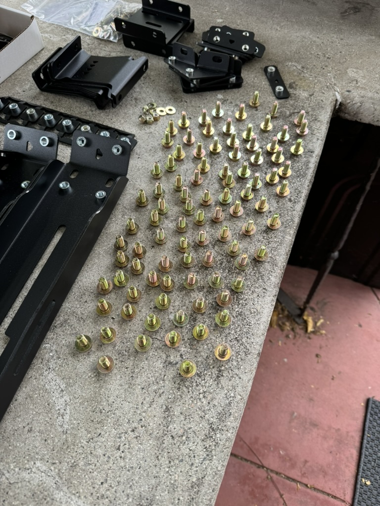

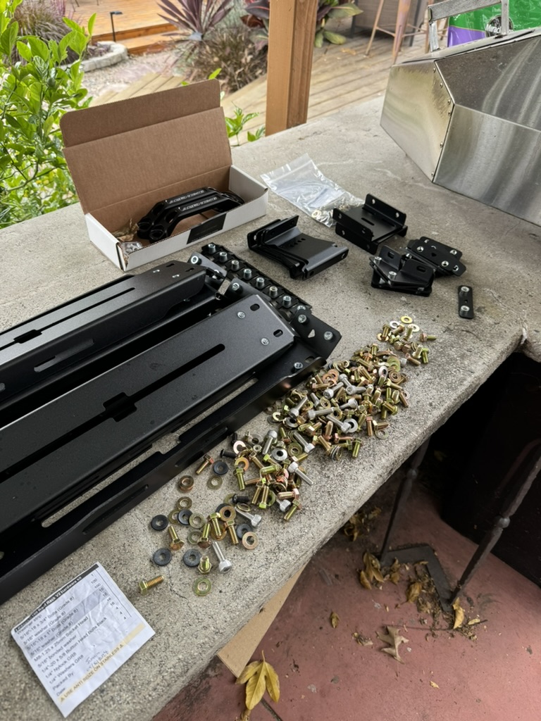

Got the Slee tray and a second battery installed, still need to wire it up before moving on to the other electronics. Winch, lights, radio, and a power panel in the rear are on the short list. Cruisers on the Rockies is serving as great motivation to knock out some long-standing projects.
