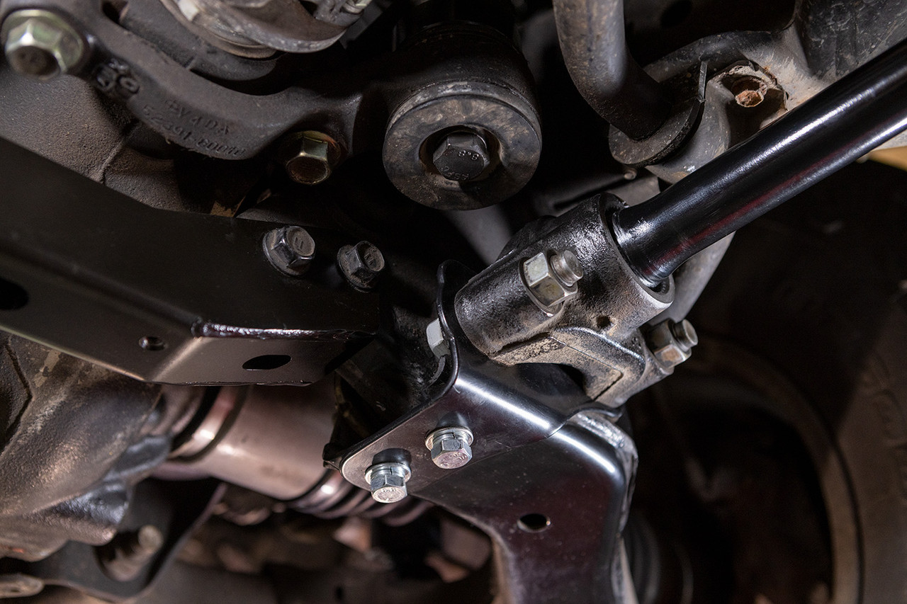

Just a suggestion but you should bolt the torsion bar reinforcement bracket to the bottom of the control arm...
Lower_Control_Arm_Reinforcement_Brackets_Suited_For_Toyota_100_Series_Land_Cruiser_Lexus_LX470...jpg
to my understanding that's the way it works...

It's optional from what I've researched. Yes most people drill the holes. I replaced my LCA with oem new parts, and didn't want to drill into them.
Let me preface this by saying that these observations are from my experience…
Those lower control arm reinforcement brackets provide additional torsional strength to the OEM design lower control arm due to the huge torsional loads at the front torsion bar torque arm mounting point. They need to be firmly mounted onto the lower control arm. The optional mounting for the lower portion is to utilize either high strength fasteners OR welding in place.
Without having the lower portion of the reinforcement bracket firmly fastened to the lower control arm, you effectively have installed a spacer between the lower control arm and the front torsion bar torque arm. There would be no torsional strength benefit without the reinforcement bracket being firmly fastened on the bottom.
Easy fix.

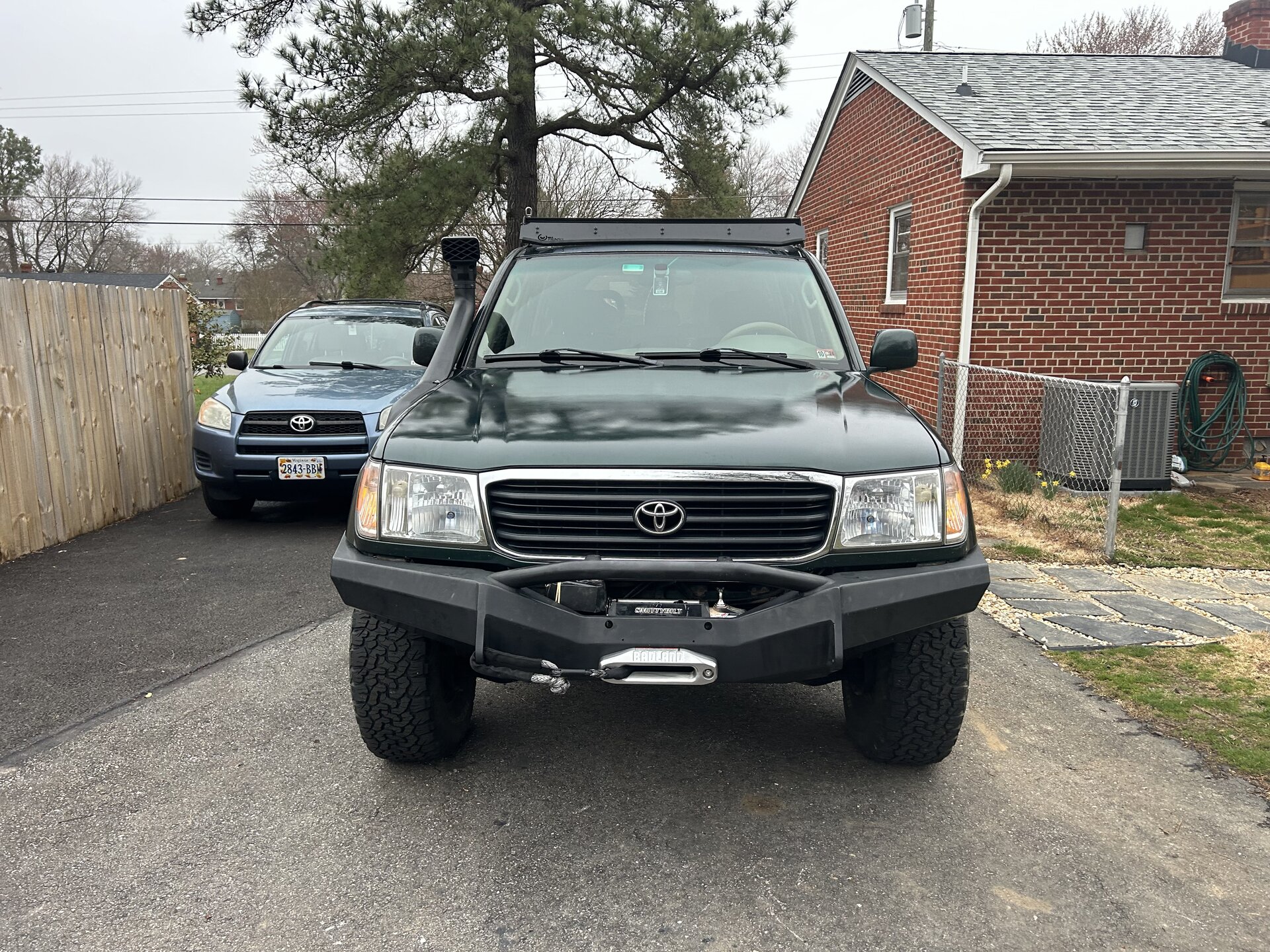

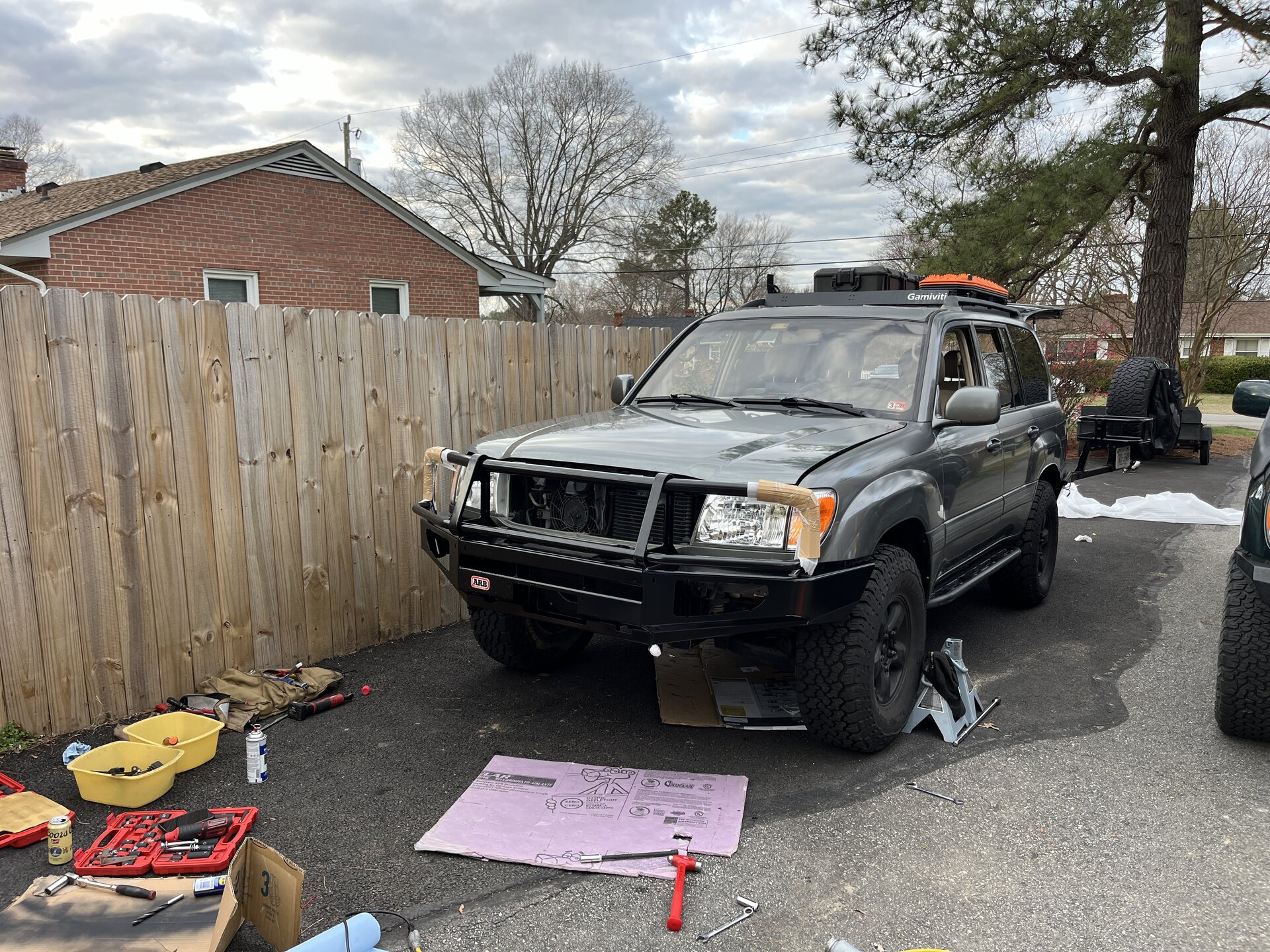

Been dreaming of front and rear bumpers since the day I picked it up. Thanks so much @Land Shark for making it possible by passing on your bumper (he went ARB) and also for the help and good times spent Saturday in the beautiful weather. Really look forward to putting this to the test at relic run. new synthetic line to reduce the overall weight gain. Steering is a little heavier but the dobinson ims shocks are holding off the body roll.
Easy fix.
There should be some improvement due to material strength of the bracket. But you’re 100% right that the optimal condition is bolted on the bottom as well. This will allow the bracket to change the assembly’s ‘polar moment’, which is enginerd talk for strength against bending.
Been dreaming of front and rear bumpers since the day I picked it up. Thanks so much @Land Shark for making it possible by passing on your bumper (he went ARB) and also for the help and good times spent Saturday in the beautiful weather. Really look forward to putting this to the test at relic run. new synthetic line to reduce the overall weight gain. Steering is a little heavier but the dobinson ims shocks are holding off the body roll.View attachment 3575266View attachment 3575267
Not sure why anyone would trade out the Slee for an ARB. That Slee is just about the best looking best built bumper for a 100 series. Just my opinion
You are not wrong that Slee is baddass built and good looking bumper. I wanted some more protection higher up and have always loved the look of the ARB's.
