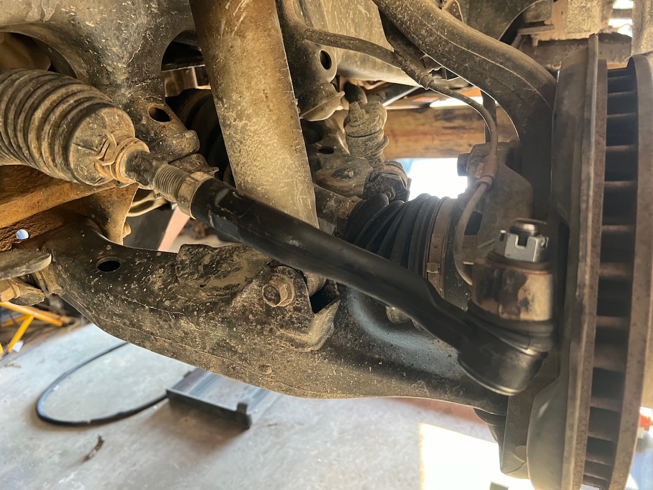

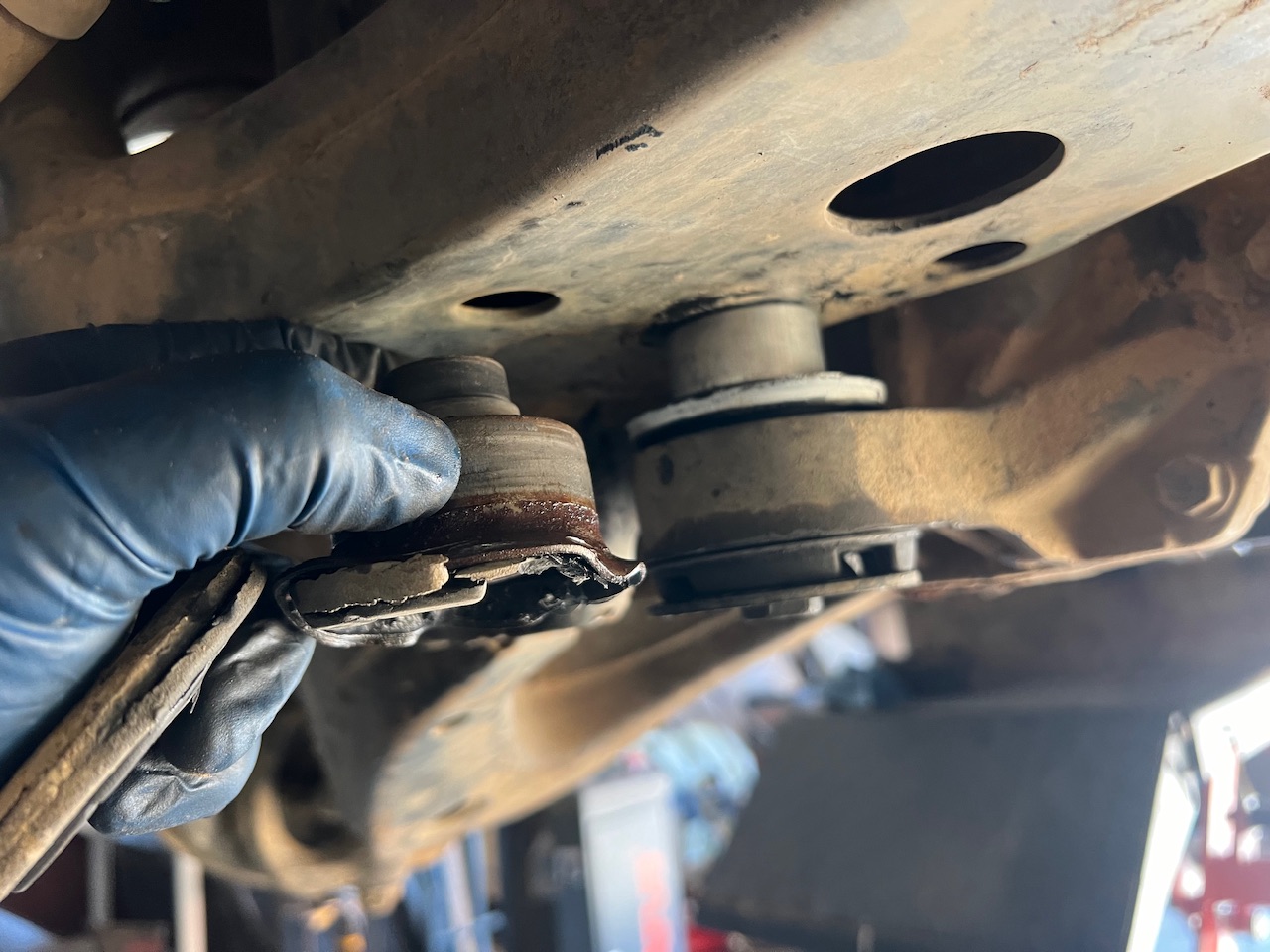

2000 LC, 313k mile. Changed oil and filter, new rear brake pads, Trail Tailor Diff drop, front diff front bushing, and new left outer tie rod (555).
I think that front diff bushing has a four letter word spec that must be met before it will press in straight. 😬
I also can’t tell you how many different ways I’ve measured outer tie rods over the years to try to avoid a new front end alignment, but a crooked steering wheel is always the final result.

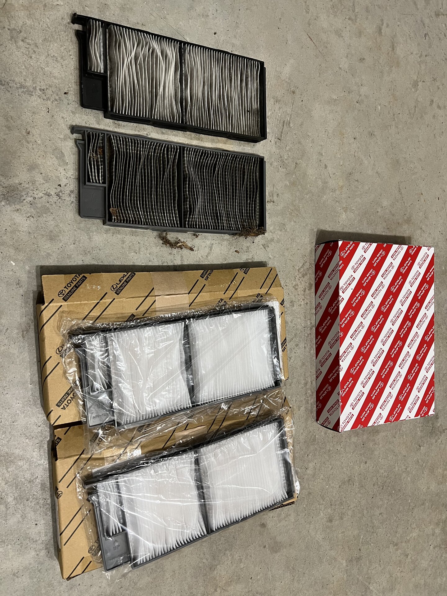

Replaced the engine air filter and cabin air filters. Surprised that the Lexus dealership didn’t recommend replacing the cabin air filters as the PO approved anything and everything the dealership recommended.

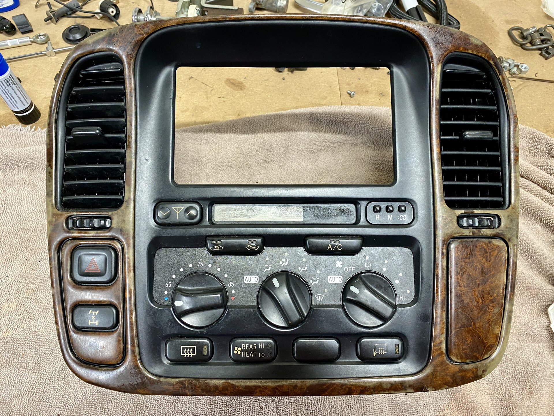

Started on my woodgrain veneer removal. The key is using a heat gun to soften the paneling and glue. It comes off leaving almost no residue. Clean up what is left with Goof-Off and a hand held steam cleaner. Resist the urge to pry with tools and your pieces will come out scratch free.
I was overjoyed when I learned that was all removable. The interior looks so much nicer without it.

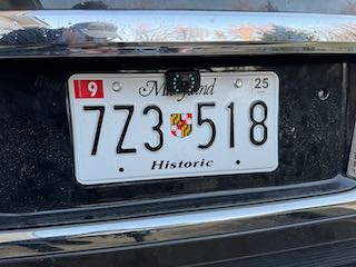

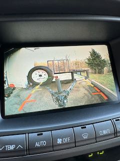

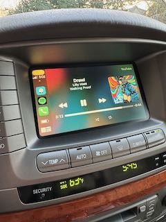

Installed a backup camera, which runs through a Grom VLine VL2. My only complaints are that the camera does not show the bumper even after bending the license plate mount to the maximum angle--I may end up trying a custom mounting method--and that it takes a few seconds for the camera image to come up when I put the car in reverse.
The camera is rated at 720p, and the screen is OEM.

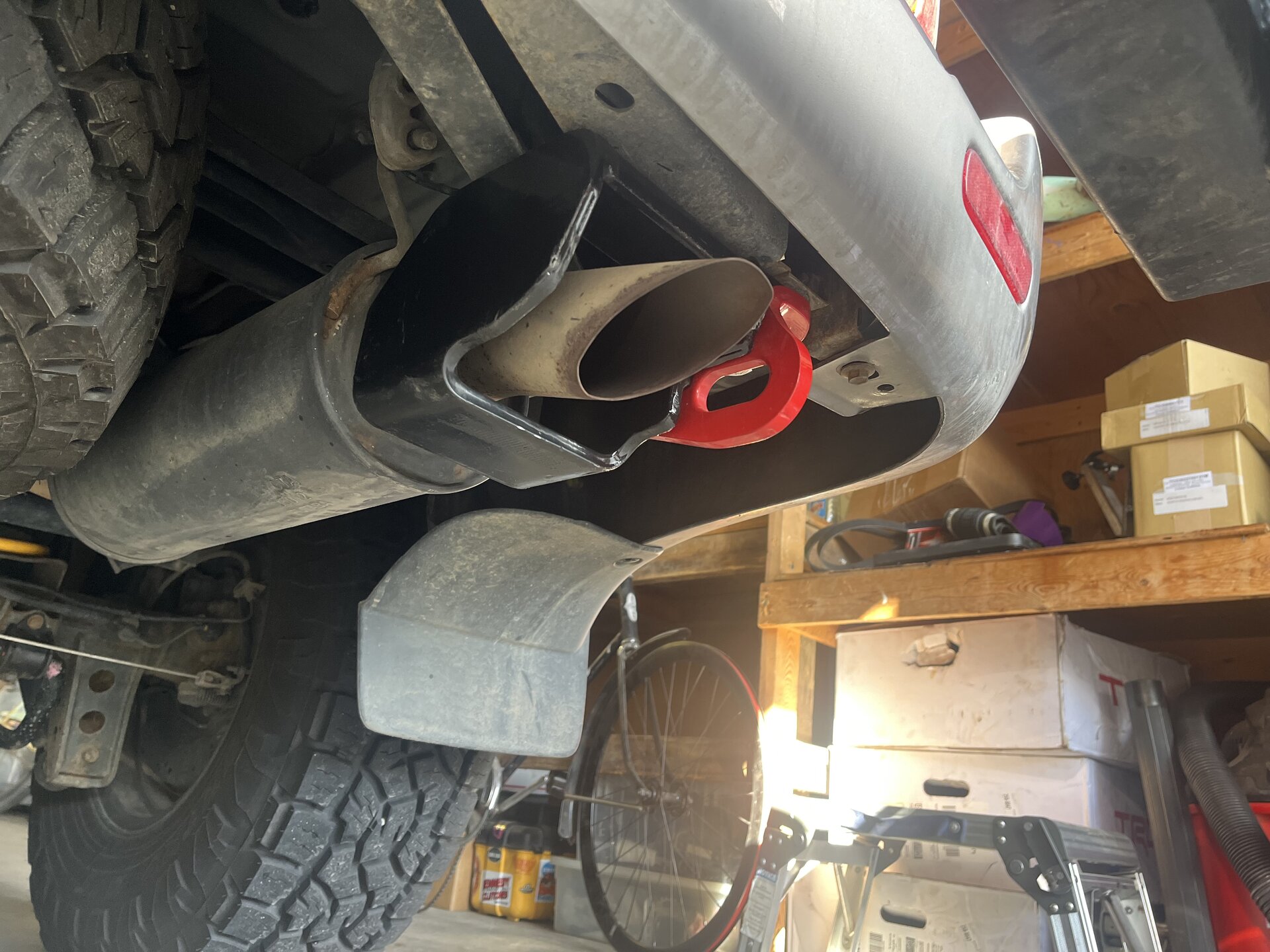

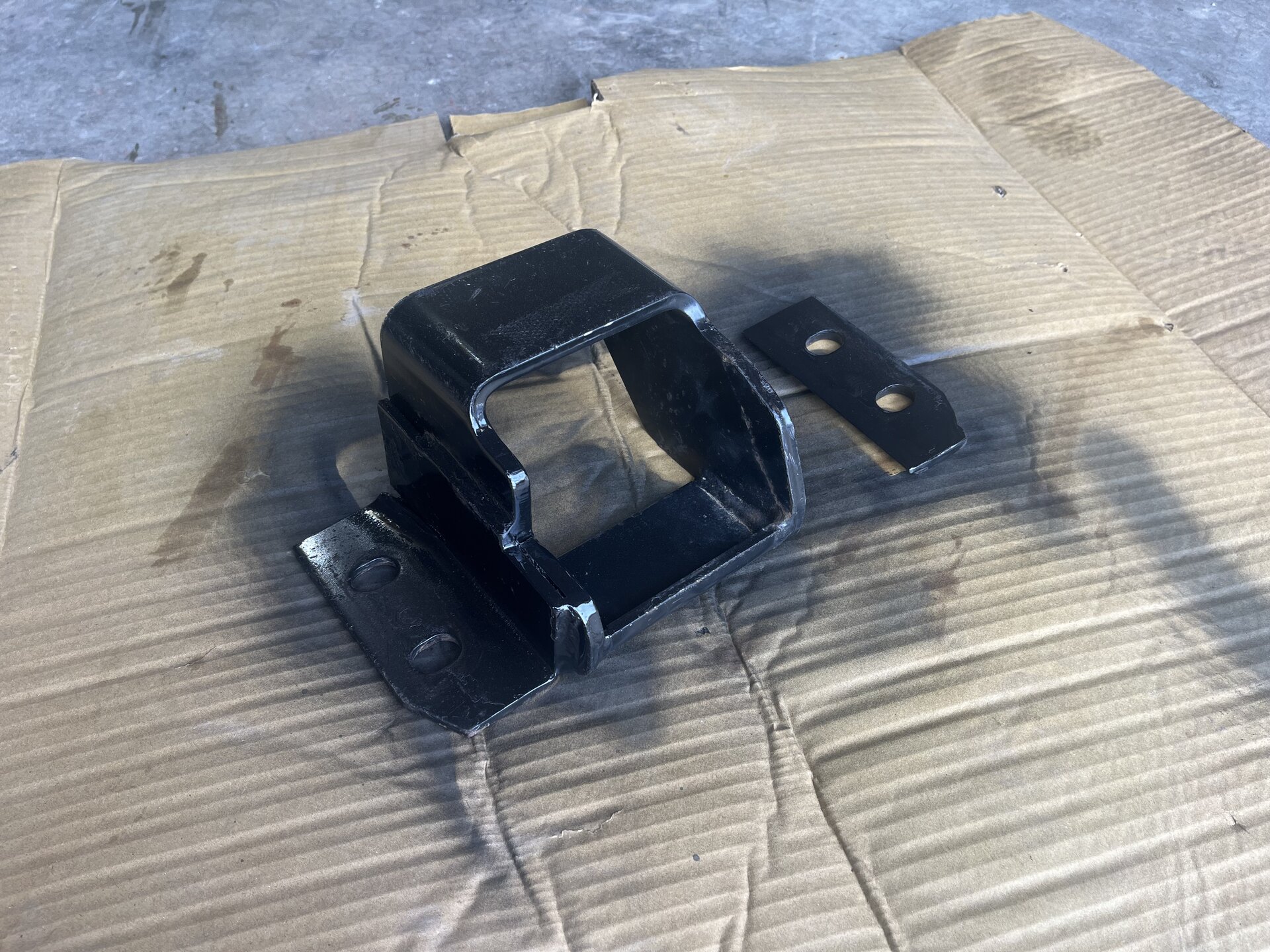

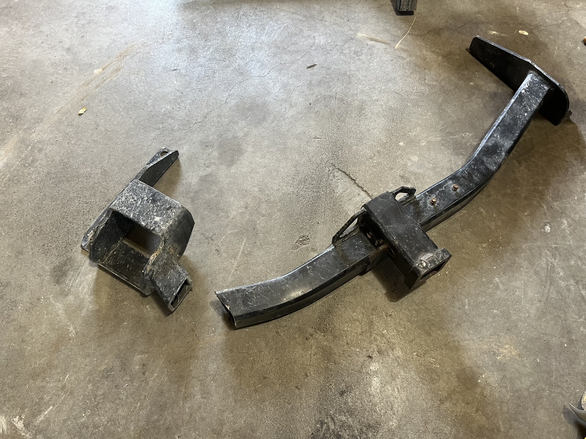

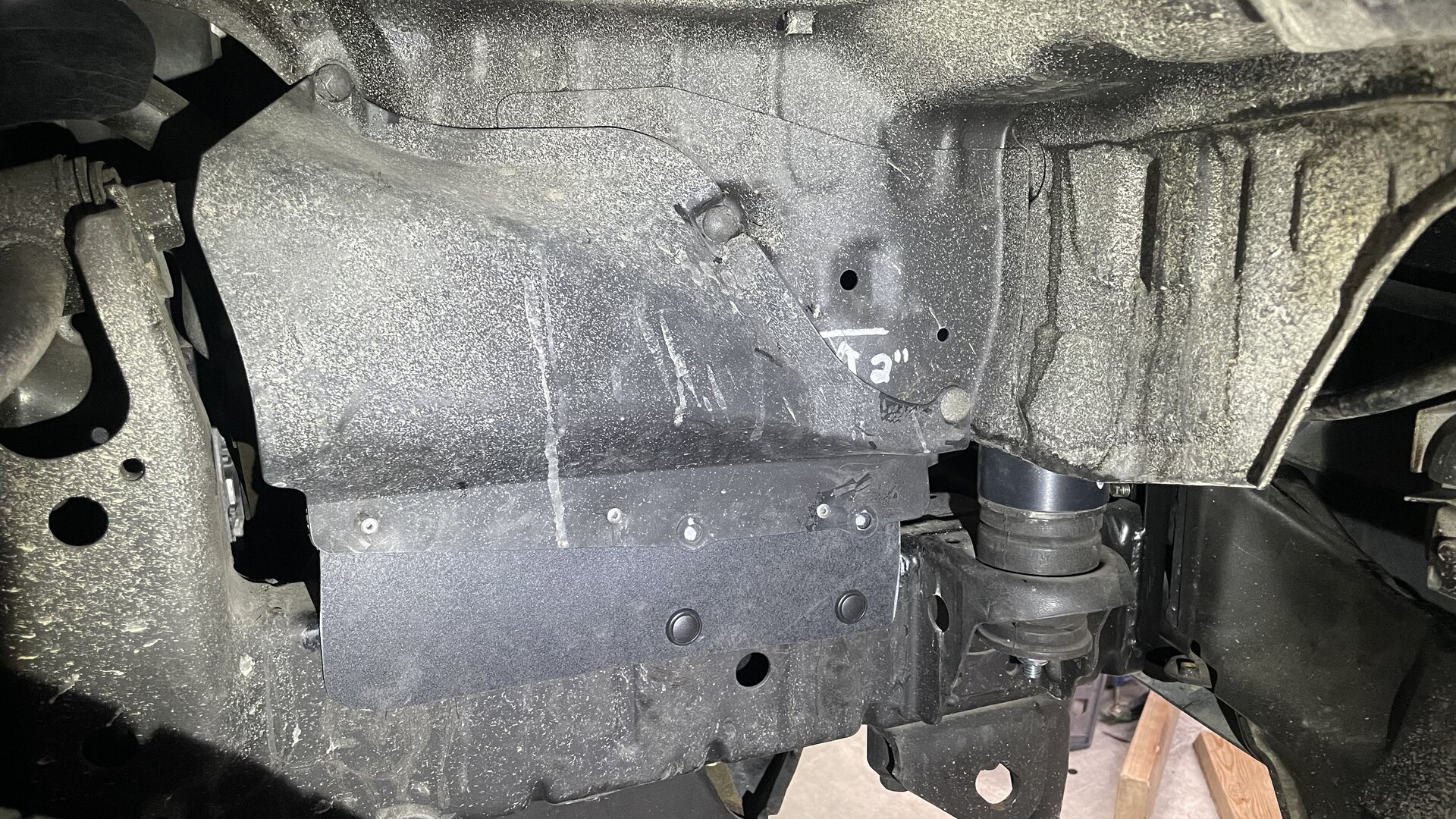

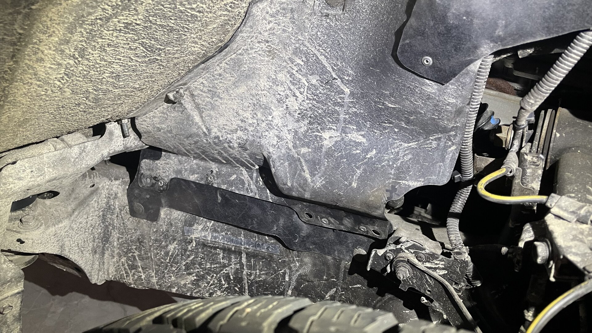

Today I chopped up my old receiver hitch. It had to go so I could fit a 35” spare but I missed the lack of exhaust protection. So I cut it off, made clearance for the Ironman recovery point, a recovery point spacer for the port side and trimmed away the fat.
Hey! Would you have an install guide on this mod? I like the simplicity of the stock look, was it challenging? Where'd you buy the from and what version? Thanks!
I bought the Vline VL2 directly from Grom. Here's a link.
The install was easy. Just watch a Youtube video about removing the factory head unit/screen, unplug the wiring harnesses, plug the VL2 into the head unit, plug the factor harnesses into the VL2 harnesses, and run the wiring behind the air vents and into the glove box where the VL2 will sit. I'm not the handiest or very tech savvy, and it was easy and quick.
Here's the camera I used.
I had to drill one hole in the metal panel behind the license plate (there is already a hole in the same spot in the plastic panel behind the license plate) to install it. You tap into the reverse light for power, ground it under the nut that holds the rear hatch lock cylinder, and run the wire under the trim from the cargo area to the glove box. As I mentioned, there is a delay between putting the trans in reverse and getting the image on the screen. Could be the camera, or could be the VL2.
