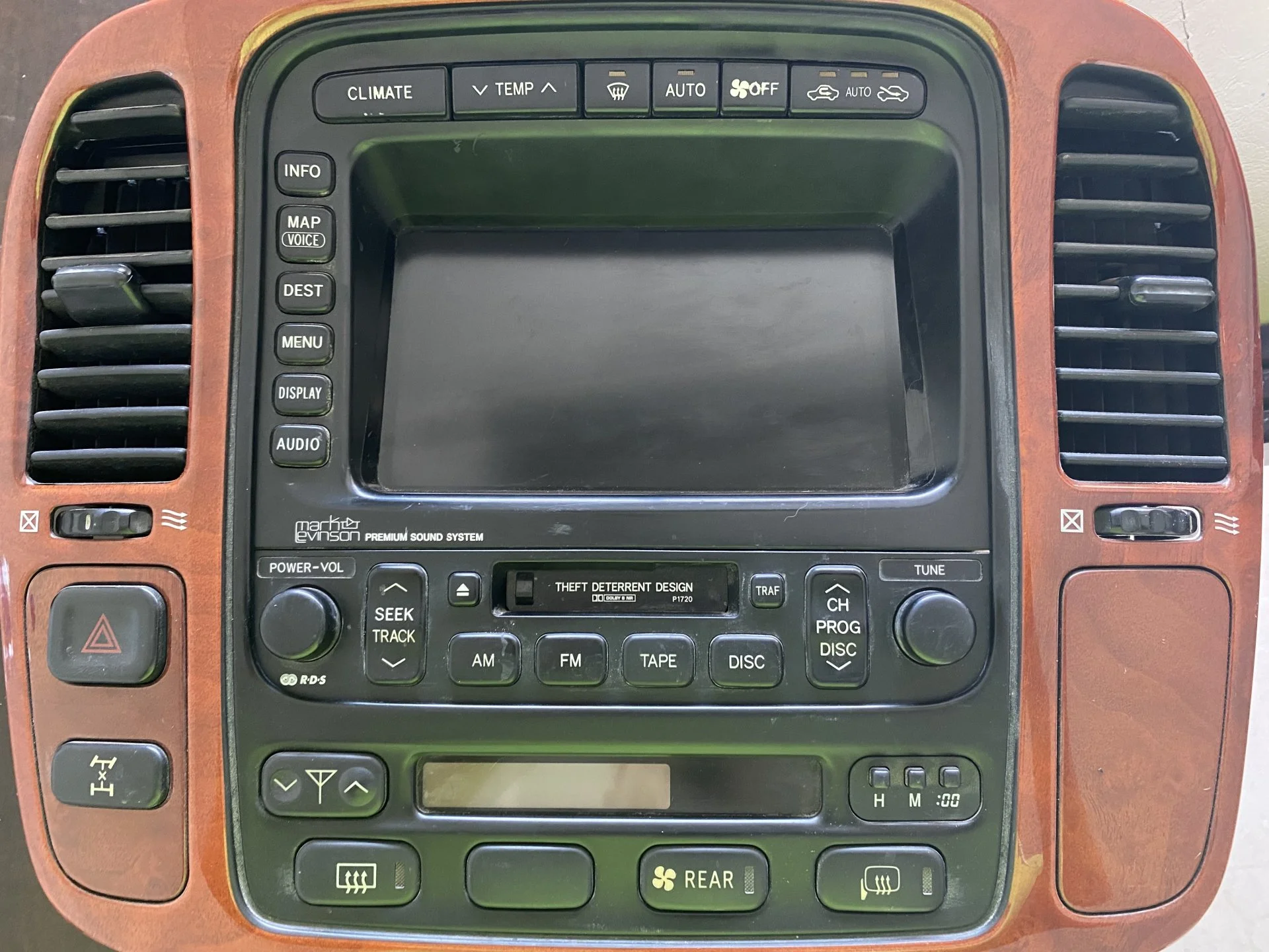

Well, this was unexpected, but I managed to find the coveted head unit with NAV for my 2002 in a small town north of Dubai. It looks to be correct, but came out of a GCC specification cruiser so I will have to wait and see. Picture attached.
How did you find it? Is there like a car-part for UAE?

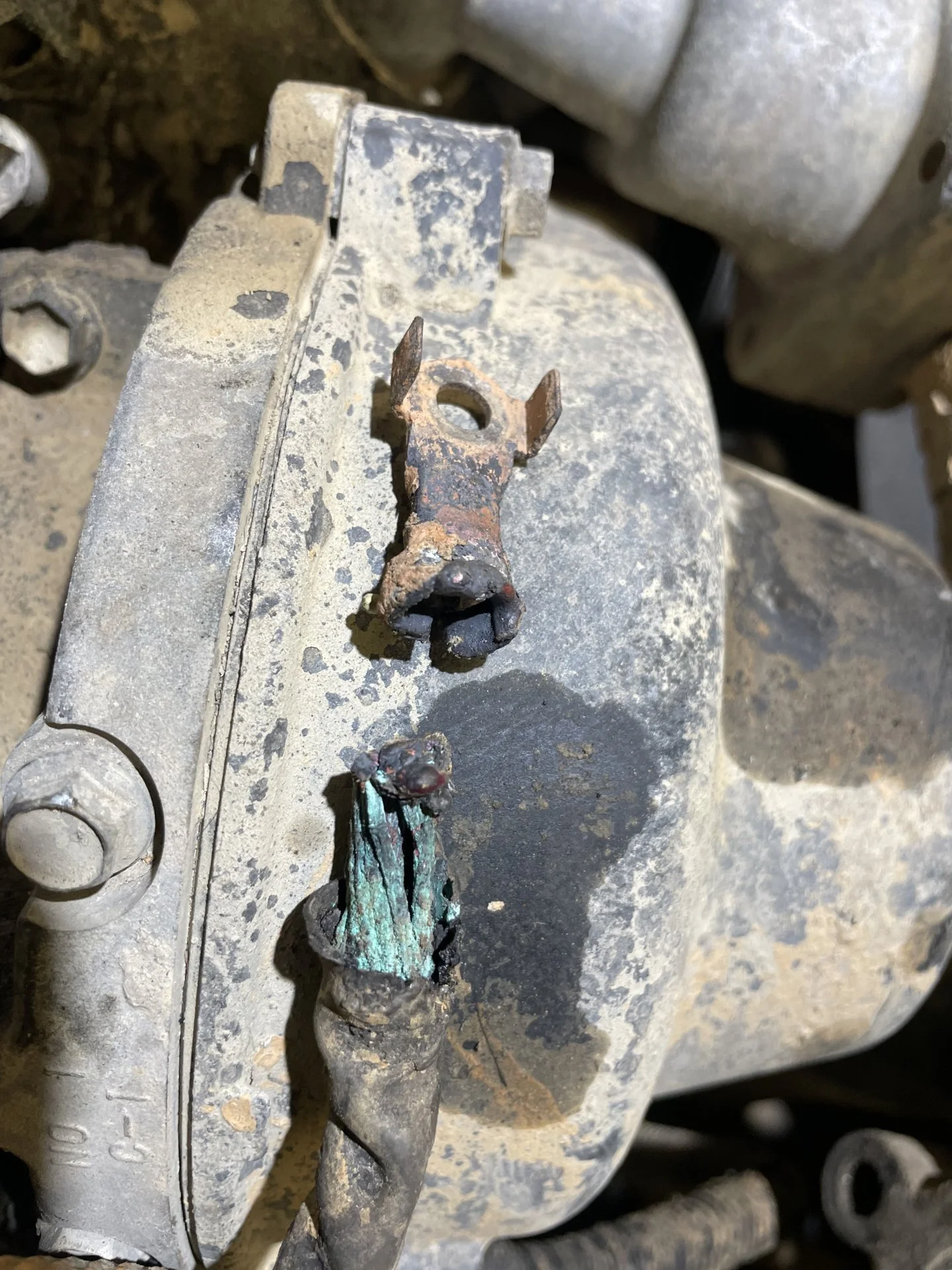

Welllll... got new wheels and tires mounted up last Friday and the ol boy broke down on me THE NEXT DAY. I guess it was his way of telling me he needed a little love on some less-visible parts too, and gently reminding me that money-pit stuff like bumpers and lights and winches aint worth a nickel if the car doesn't run. Electrical system wasn't loving life, is the end story. The positive terminal on the battery itself I knew needed replacing, so I had one of those in the car. What I did not know was this:
The alternator end of the positive battery cable was in just terrible shape too. Had to trim back 3-4" to get to good orange copper. I suspect that having leaky power steering lines puking onto the old alternator is what killed it, and after replacing alternator and fixing that leak last year, it never occurred to me to look at this cable end. SO. Yeah. I think it might have been just arcing internally there along the crappy corroded end until it just... couldn't any more. Important to know, it's a miracle the thing was running in any way, as I had a vise grip on the positive terminal holding battery cable on, and apparently the alternator side was barely attached either. And while it was in the shop (hat tip to OTM Cruisers- thanks Cole/ @Bama4door), wired my winch and lightbar up nice and neat, so those are done, and found a couple of other maintenance items to bear in mind for next time (rear transfer case output seal weeping a little, steering rack leaking slowly, my aforementioned rear trailing arms of custom banana shape).

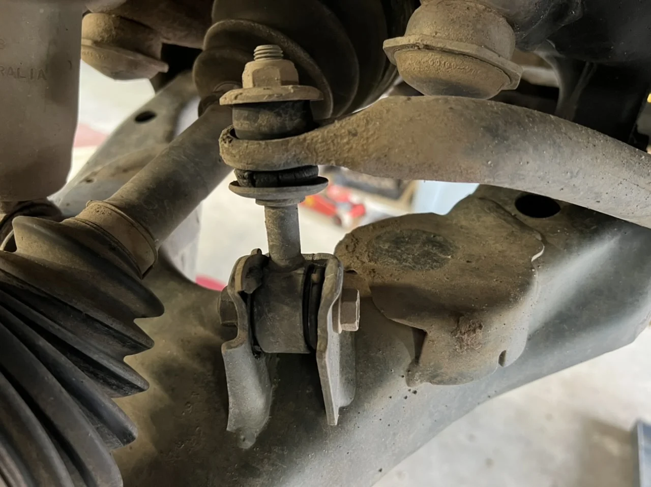

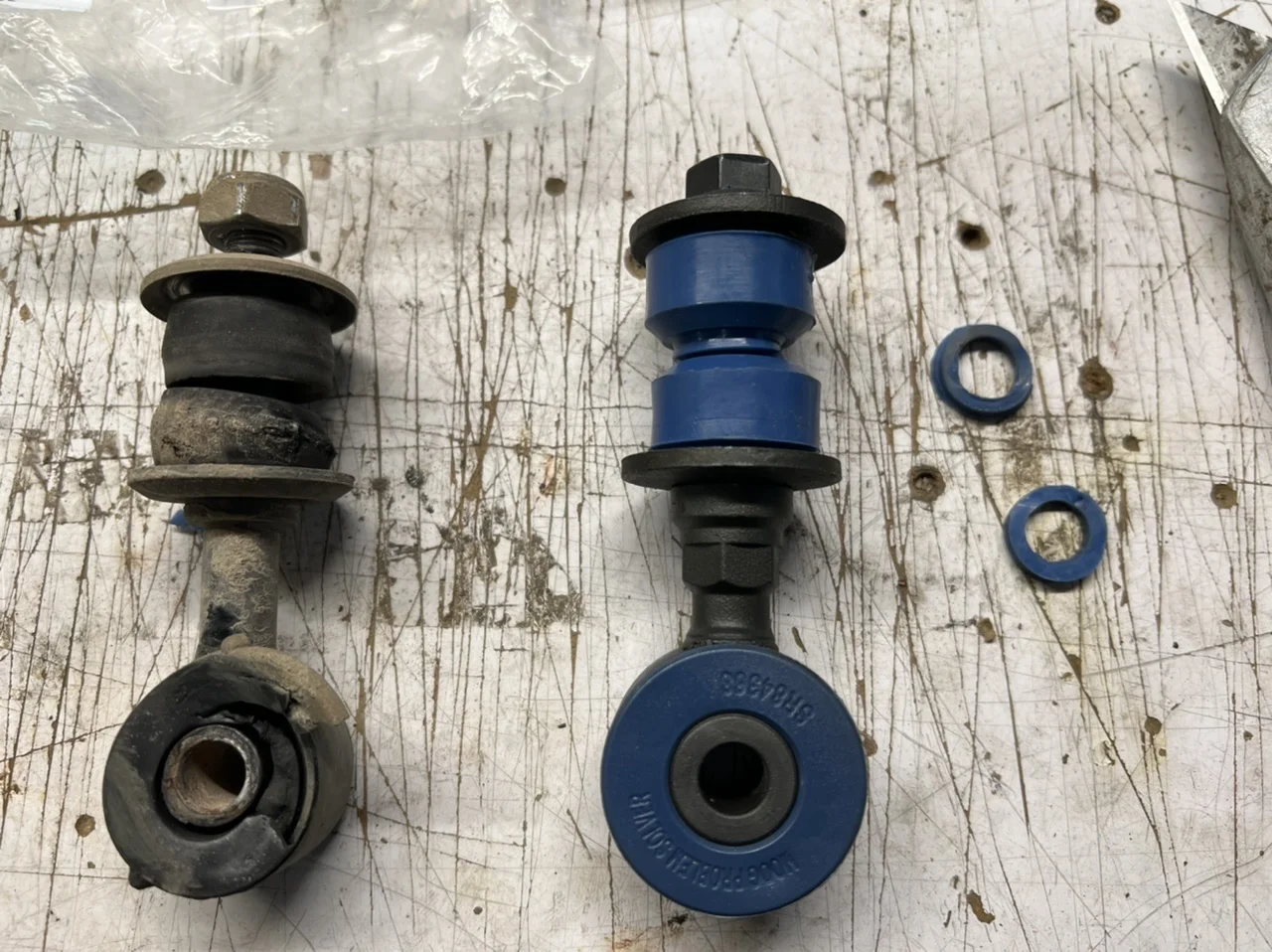

I replaced the front sway bar links with Moog. Very beefy, and apparently poly bushings. The old ones were only a couple years old and already falling apart. If you get these the bushings have a lip you need to cut off so you can get the nut started.
I bought these like 2yrs ago and couldn't get em on! Now i know howww.. Lol i coulda/woulda put ratchet straps on the SwayBar n frame to squeeze but they would hellla deform so i didn't. Definitely trying this🖖
