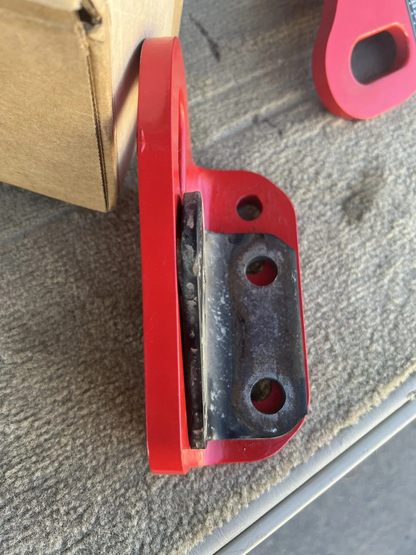

I drilled the holes for the bolts on Monday and installed the bolts. It was a major PITA because I had to remove my front skidplate to get at it. The brackets had been on for over a year so yeah I procrastinated a little. :)
Did you use a 3/8 drill bit?
Honestly didn't look at the size. I took a small drill bit like a 1/8 and drilled a pilot hole in each one and then grabbed whichever one fit the hole and drilled them out the rest of the way.
Thanks. Aussie instructions say 10mm which is 3/8 equivalent basically.

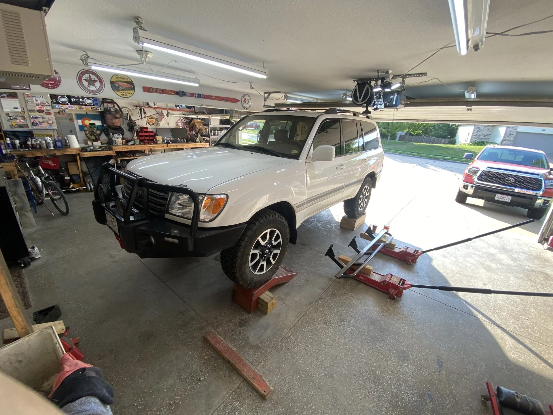

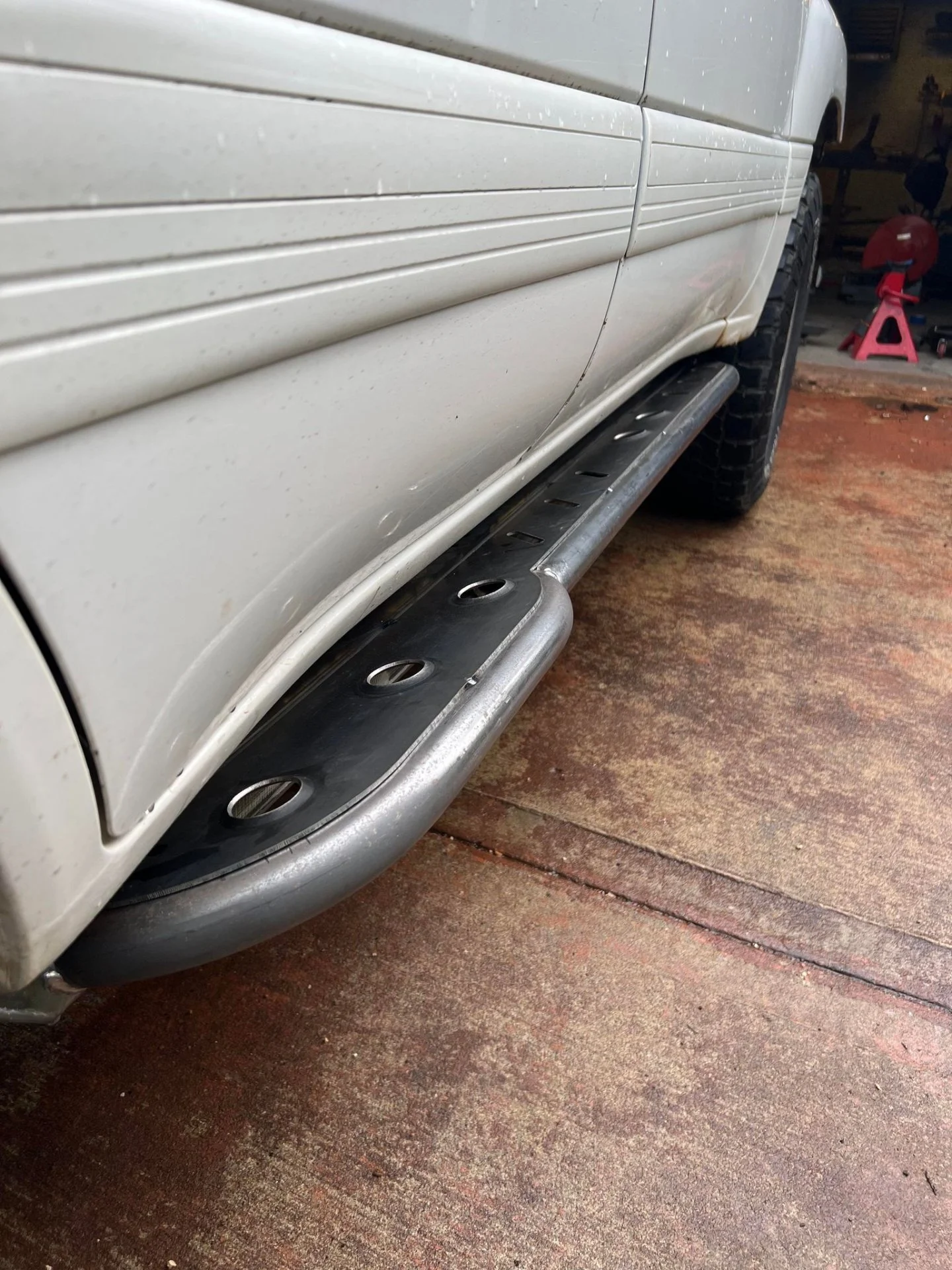

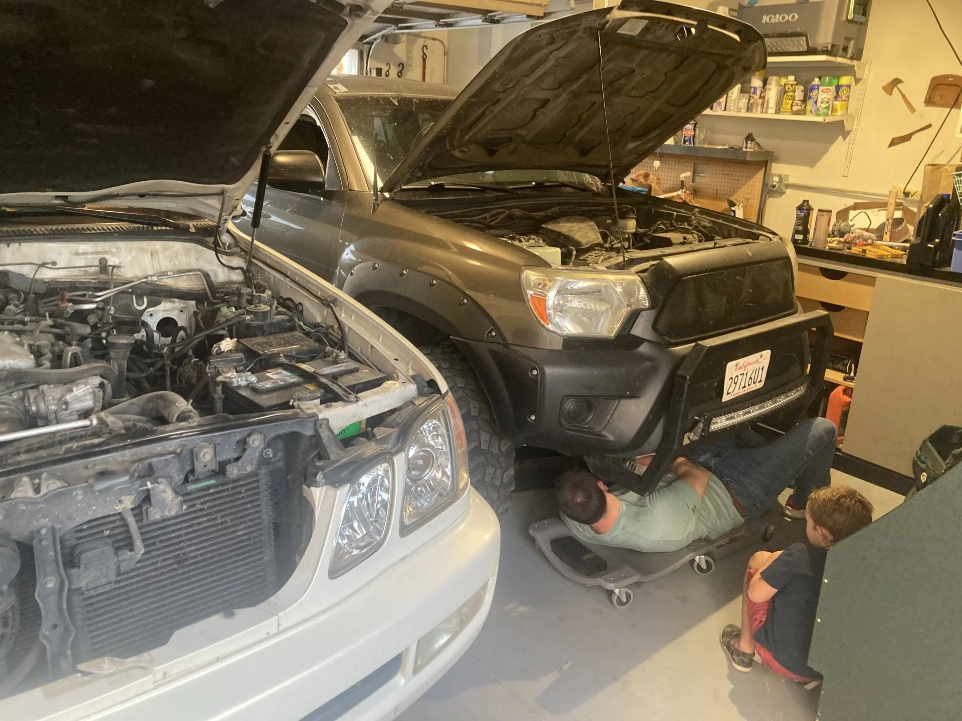

Installed my Valley Tech Fabrication sliders to go along with my Valley Tech rear bumper.
2 sweet rides AND a garage that does not look like E.O.D. detonated some surplus ordinance? I see you, sir. 👀 Living all kinds of right and stuff.
P.S. Are those sliders able to be ordered with a step cover?
LOL. Yep, Garret does them with step covers. Let me try to find a pic.

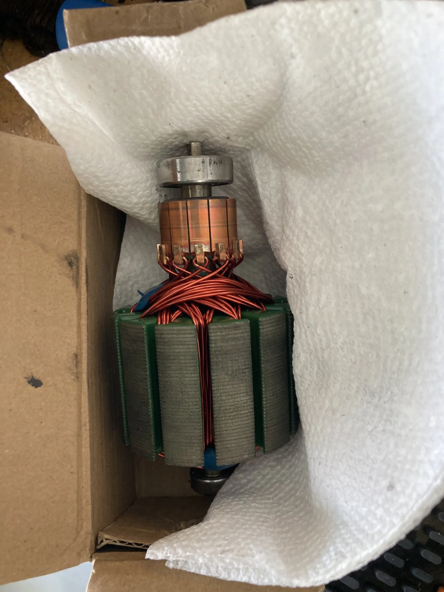

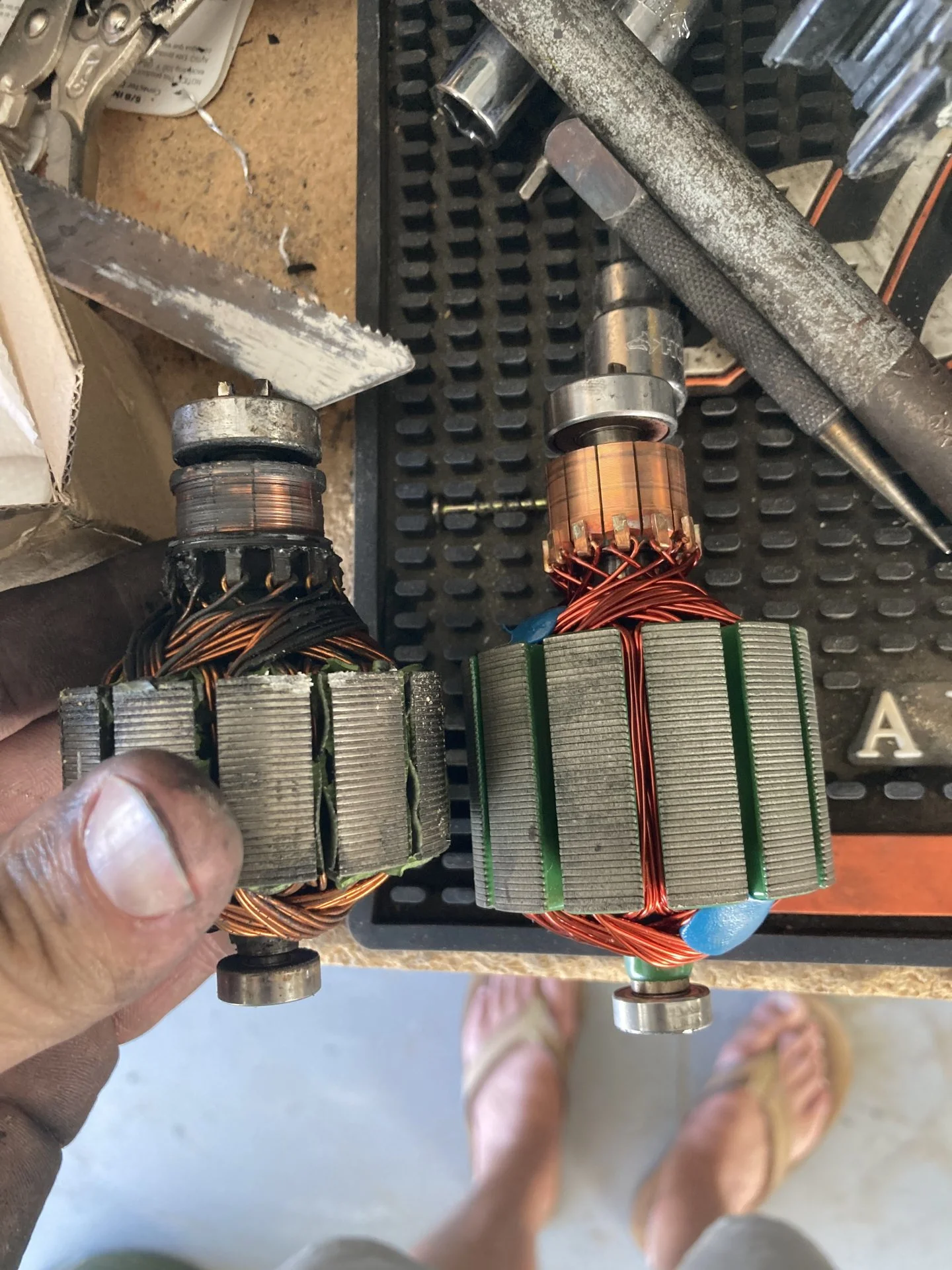

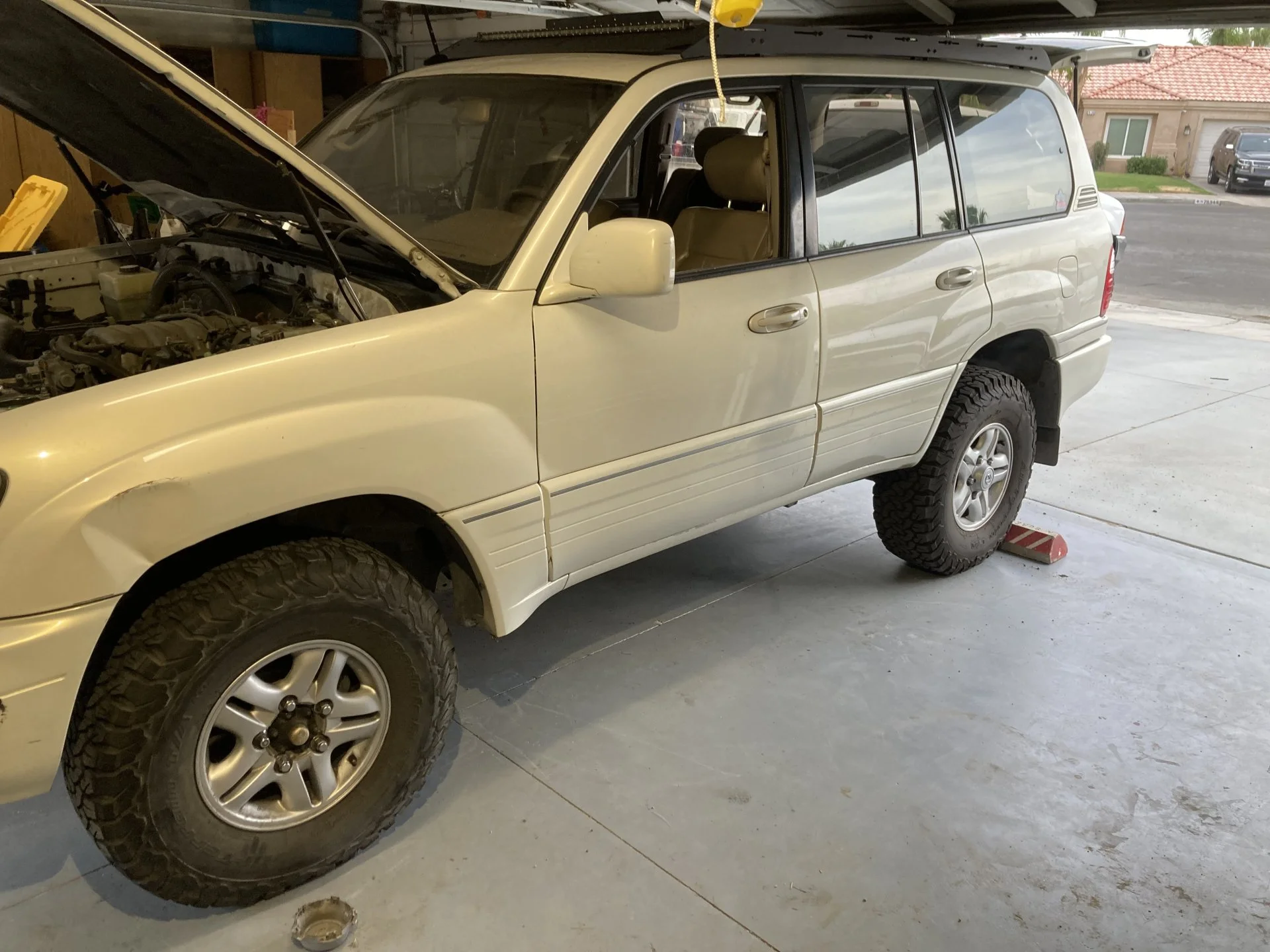

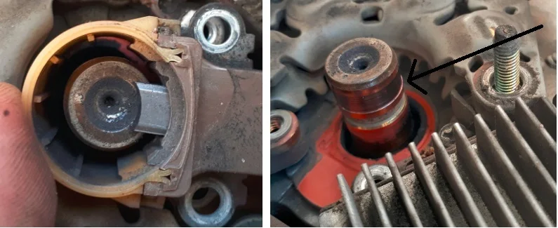

Replaced the original alternator as a PM (no current issues - 98 LX, 280k km). Replaced with the larger 100A Denso reman unit (210-0565). Struggled to remove (playing tetris for 45 minutes) before giving up and removing the lower rad hose - out in 30 seconds after that.
Brushes had over 1/4 inch left and there was less than .5mm wear on the commutator, so probably would have lasted another year or two, but didn't want to roll the dice that long. I will refurb this one and have a good spare.

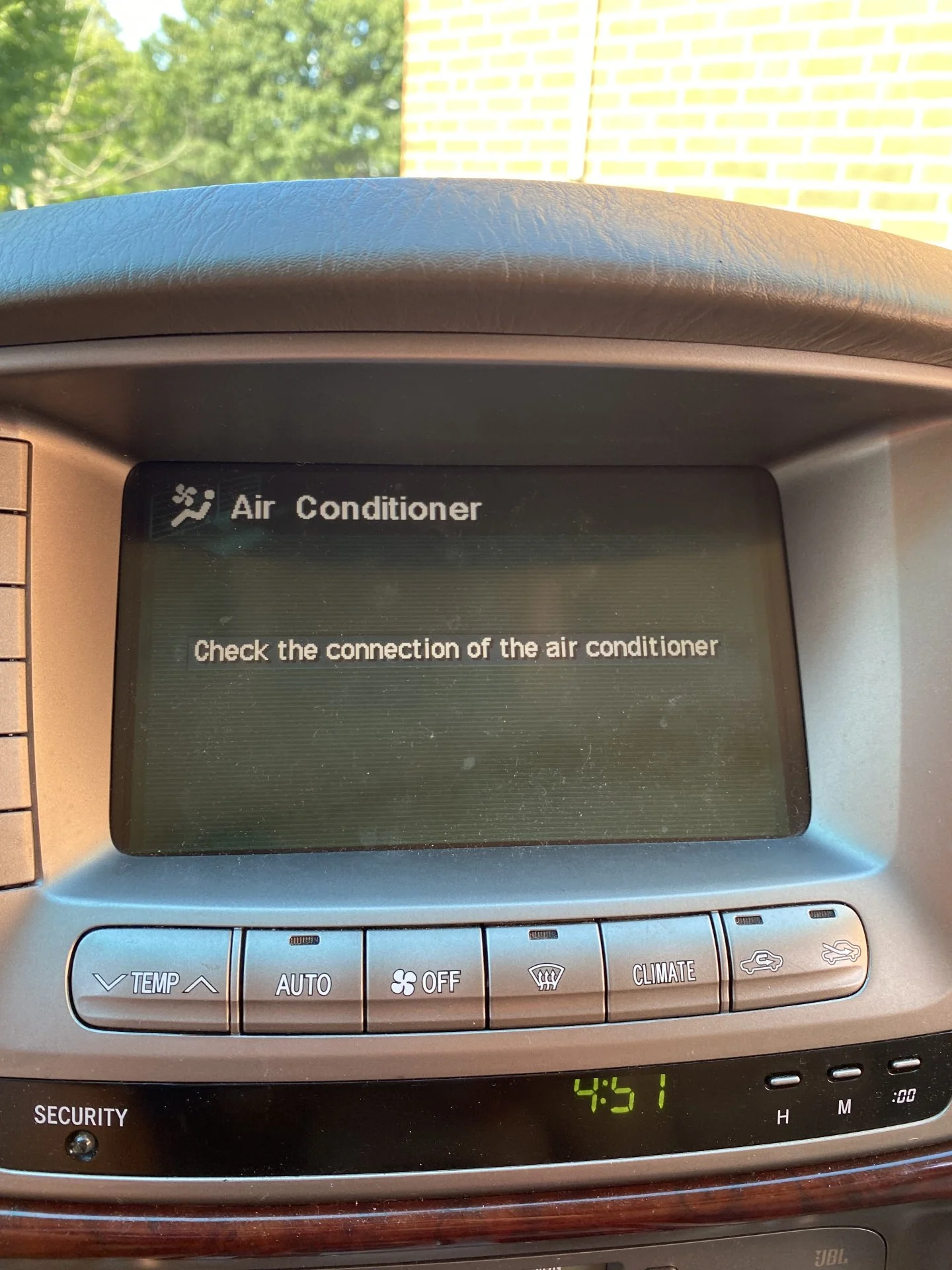

Broke something with the MFD. Audio plays but says “Audio Off”, buttons around the screen aren’t working, “check connection to air conditioner” shows when pressing climate button. 😔

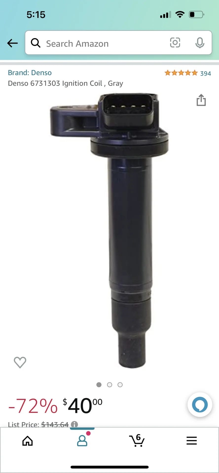

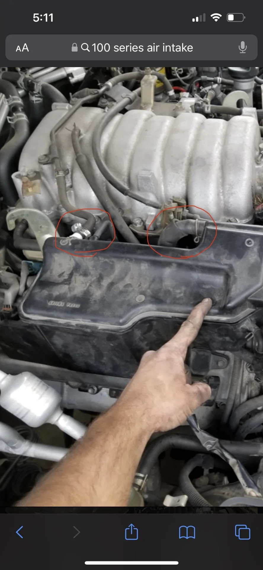

Changed spark plugs and coil packs on the 100 this weekend. Sweet deal on coil packs from denso on Amazon right now. 150$ from Napa auto and only 40$ on Amazon!!! While I was in there I noticed some old hoses going to air intake . Can anyone help identify these hoses in the picture? Toyota parts guys are useless here unless you give a part # (not my pic but you get the idea)

Changed spark plugs and coil packs on the 100 this weekend. Sweet deal on coil packs from denso on Amazon right now. 150$ from Napa auto and only 40$ on Amazon!!! While I was in there I noticed some old hoses going to air intake . Can anyone help identify these hoses in the picture? Toyota parts guys are useless here unless you give a part # (not my pic but you get the idea)View attachment 3081636
Snap that’s a great deal! I was only able to buy one at the $40 price right now, bought seven more For $49 a pop which is still great thank you for posting this!!!!
