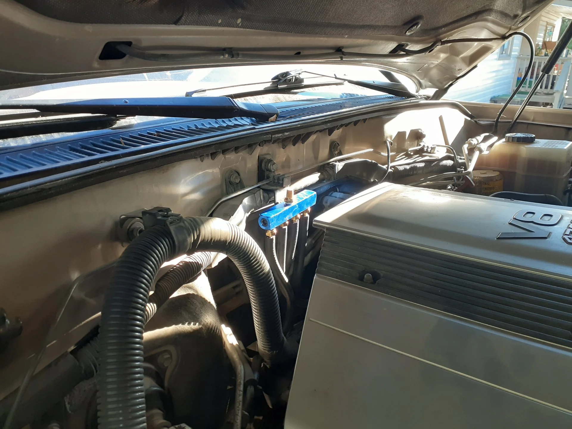

When changing diff fluids last month, noticed there was pressure when I opened the fill plug. Breathers were totally frozen solid. So yesterday I relocated all vents to the engine bay (followed one of the how to's).

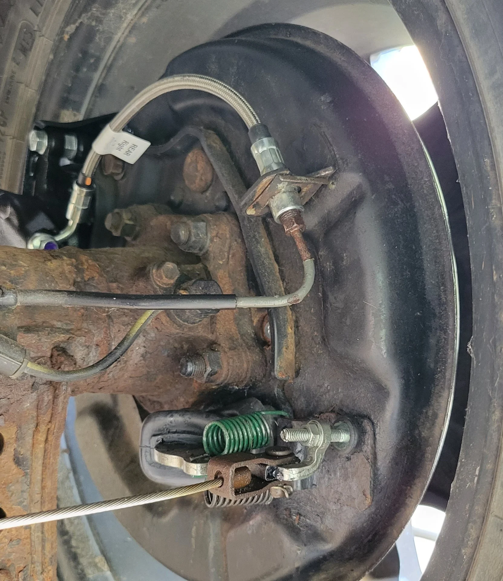

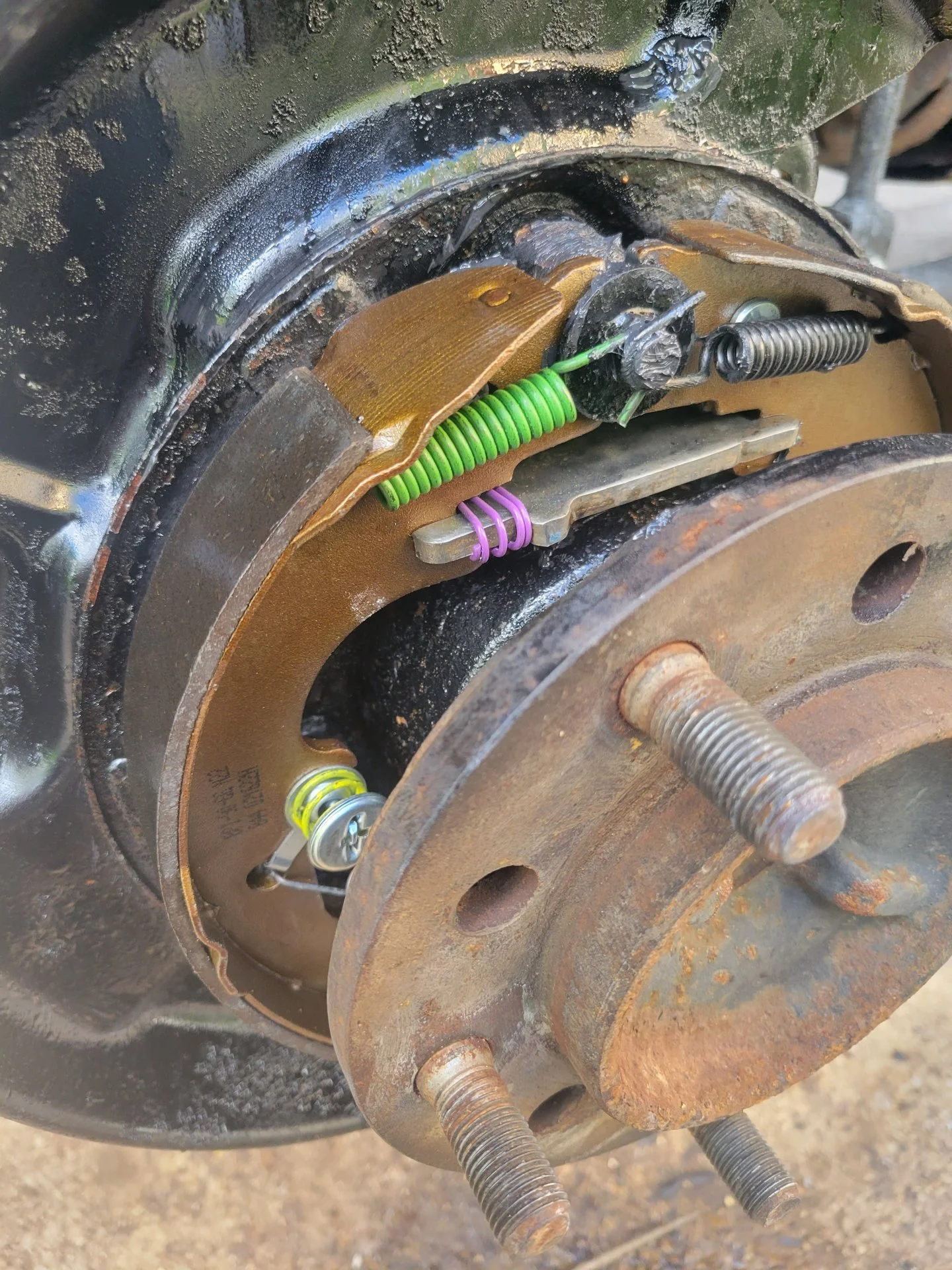

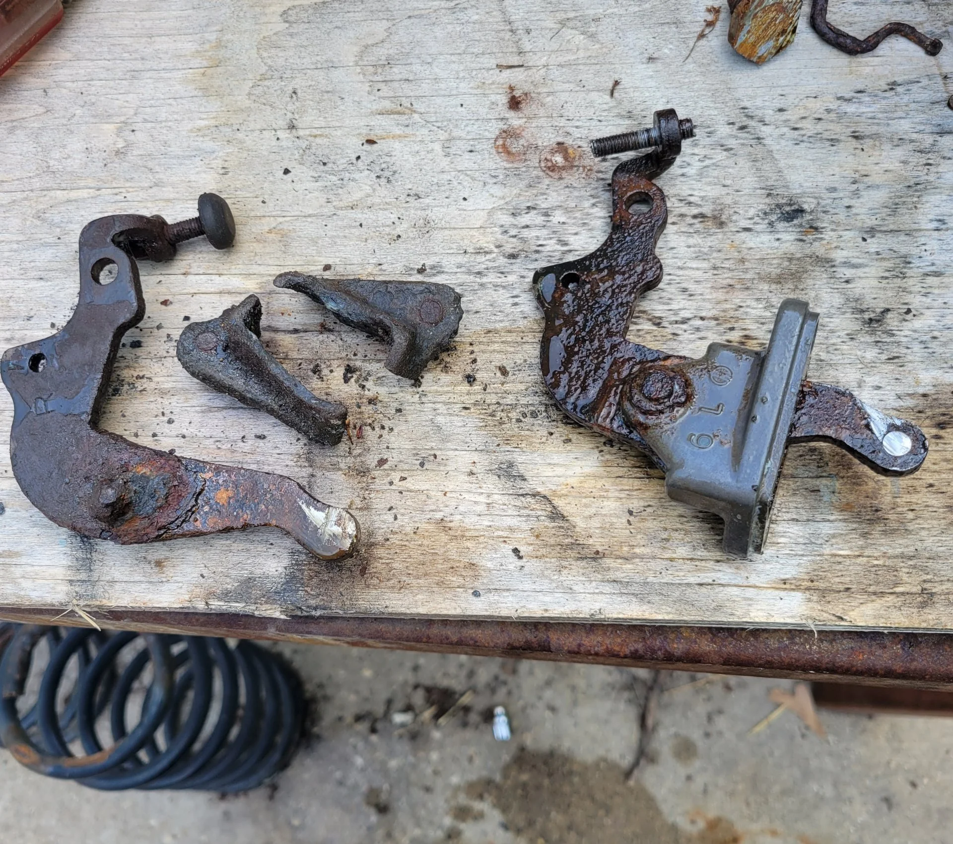

Parking brake done. Been a very long time since I messed with drums. New shoes,hardware,bell cranks,mounting bracketsc,boots, etc.
Estimated cost and time to do the work? I need to prioritize mine.

Got all parts from Partsouq with the exception of using a Raybestos hardware kit I already had that I got from Amazon. Pins and springs seemed quality though I did reuse the original adjuster as well as ordering Toyota outer spring hold down cups as the Toyota have a more pronounced cup to center the hold down spring. Pretty easy actually, maybe 45 minutes a side. Parts were under $100 total with another $45 for Raybestos Element 3 shoes.
