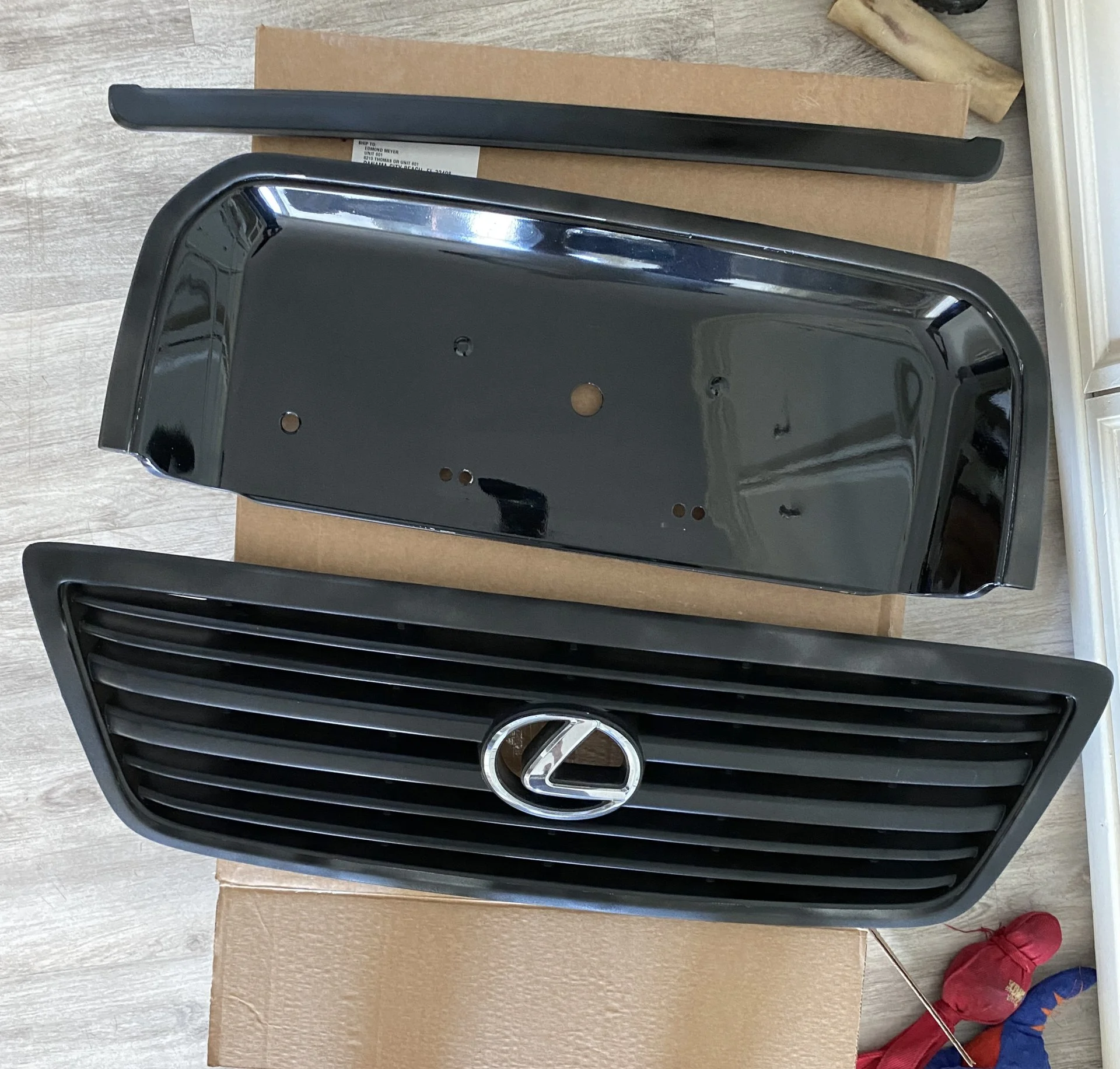

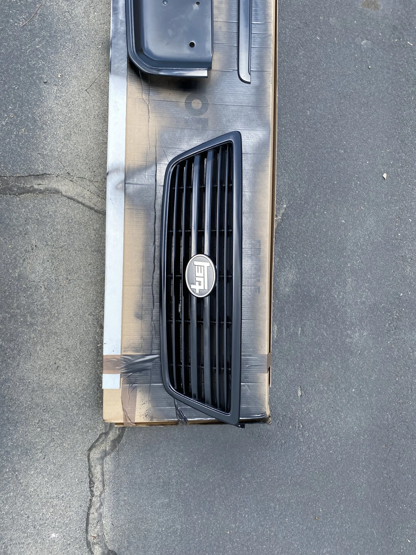

Looking good. I’m partial to the Lexus badging.

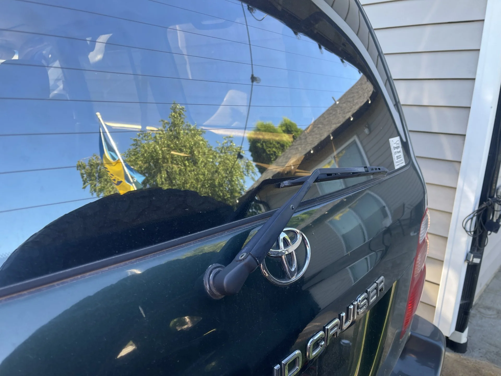

Question: how did you get the thin chrome trim off the top of the rear hatch? I was planning to paint in place with lots of masking…
Went with Satin black paint and a semi-gloss clear with a new "L" badge. If anyone has a black pearl OEM "L" please hit me up. I want it! Thanks for the confirmation. The upper trim was actually pretty easy. The lower section was the most difficult because of my big fat fingers. For the upper part, I used fishing line to cut through the 3m double-sided molding tape in between the two plastic studs. Pushed studs through gently from inside of the tailgate. I then took a 3M rubber wheel attached to my cordless drill/screwdriver to remove the tape residue from the upper hatch. Prepped surface with alcohol and laid down new red 3m double-sided molding tape. Put the molding back in place.

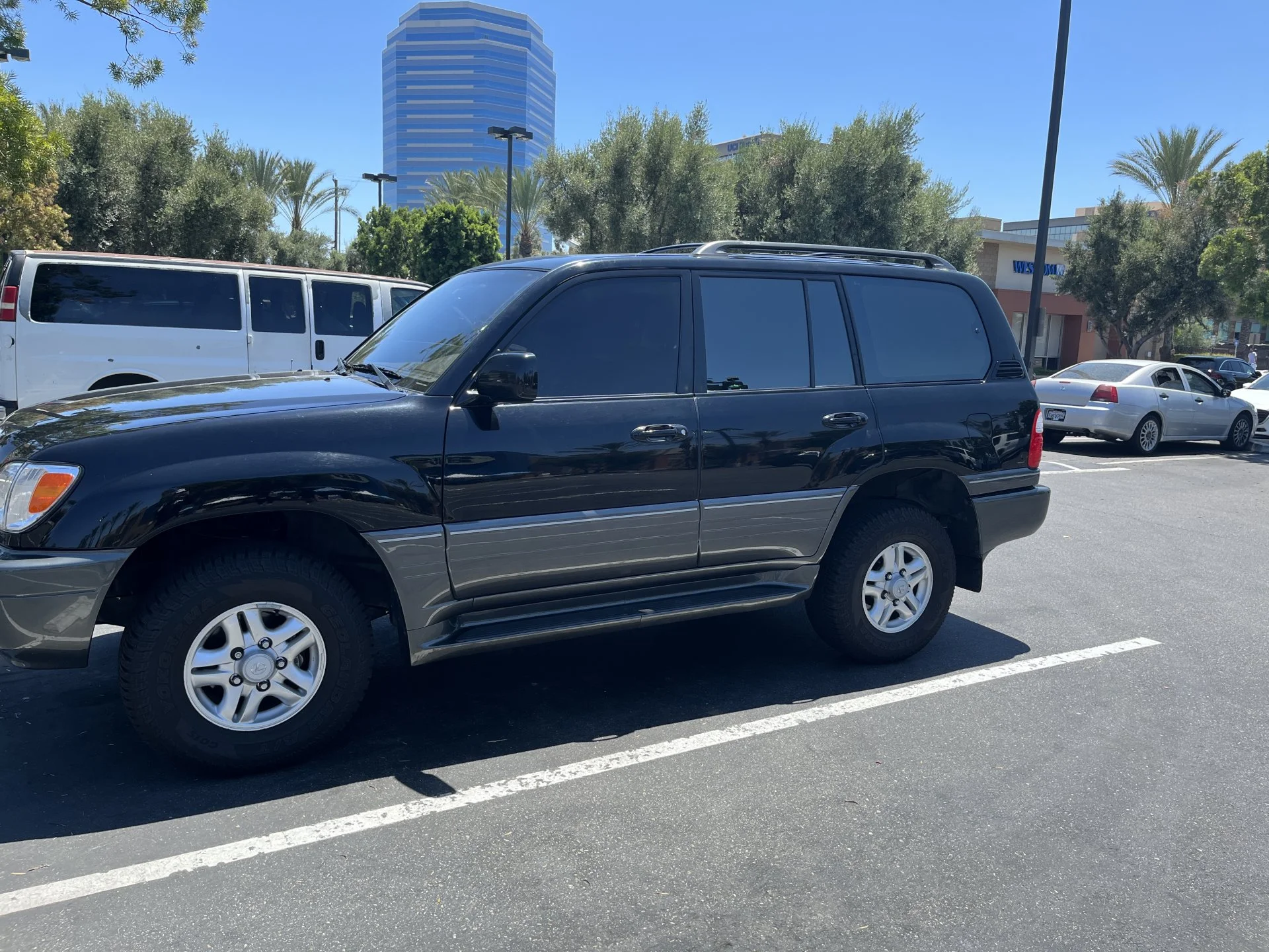

Got 3M Ceramic IR tint on all 8 glass panels done on my 2000 Mall Cruiser at OC Tint Solutions (SoCal) for summer protection. Jason and team were really nice to work with.
They do tint a lot of Teslas but I’d give them a 9.8/10 with the work on the Mall Cruiser. The films cuts go perfectly against the contours of the trims and weatherstrips. Final product was great with no bubbling. If you're getting some tint from Jason them know the Black 2000 LX470 sent you there.
Factory bronze tint + Ceramic IR gives a mirror effect 2nd row onwards.
3M thinsulate, 3M Ceramic IR, sound deadening pieces (they do double as weatherproofing) including butyl, CCF, MLV all make a difference in making the Cruiser a lot more liveable in NPs all season.
Can’t wait for the next trip!

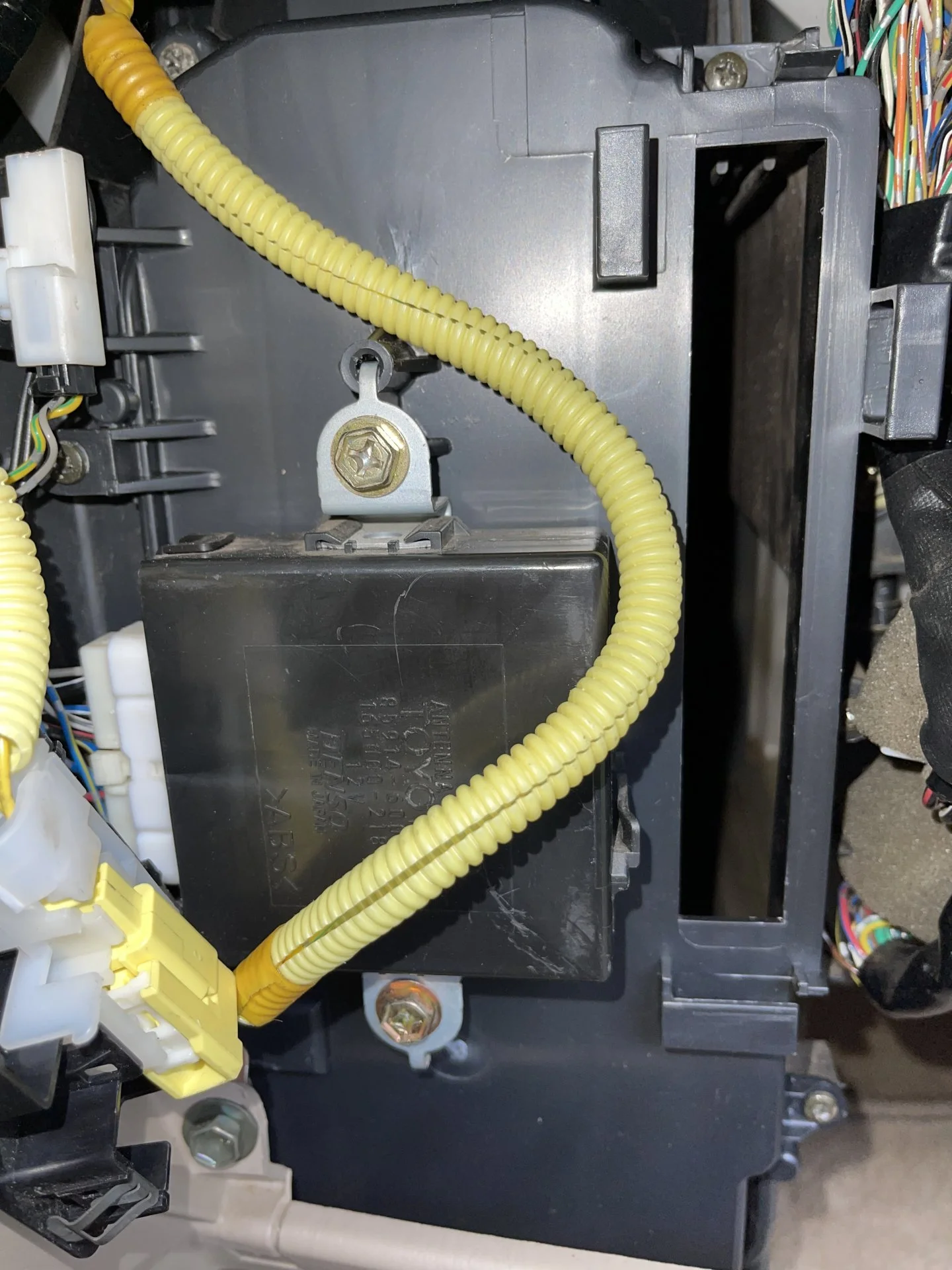

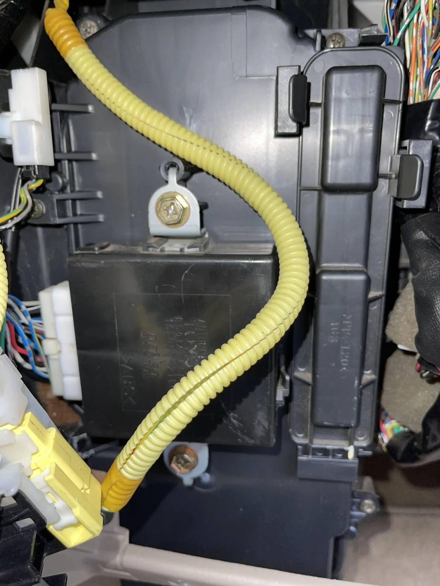

I have a 2000 LC and it has a slot for an air filter. There isn’t one in it. I’m having trouble finding the part online. Anyone know what fits it? Photo below of what it looks like.
If it's got the door, then it should accept any of the filters for a 2003+ LC/LX since they're all the same. There are two rectangular filters in there that stack, just make sure the parts counter sells two. It seems like lately they're happy to sell me a single filter for the same price I used to buy a pair at.
Thank you. It does look like the style that accepts two. Posting photos below for you took at. Thanks so much.
