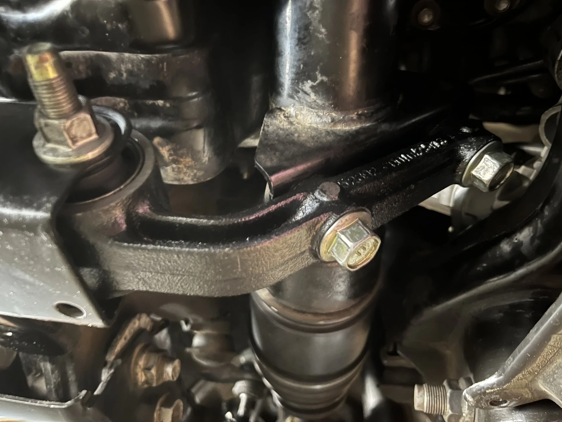

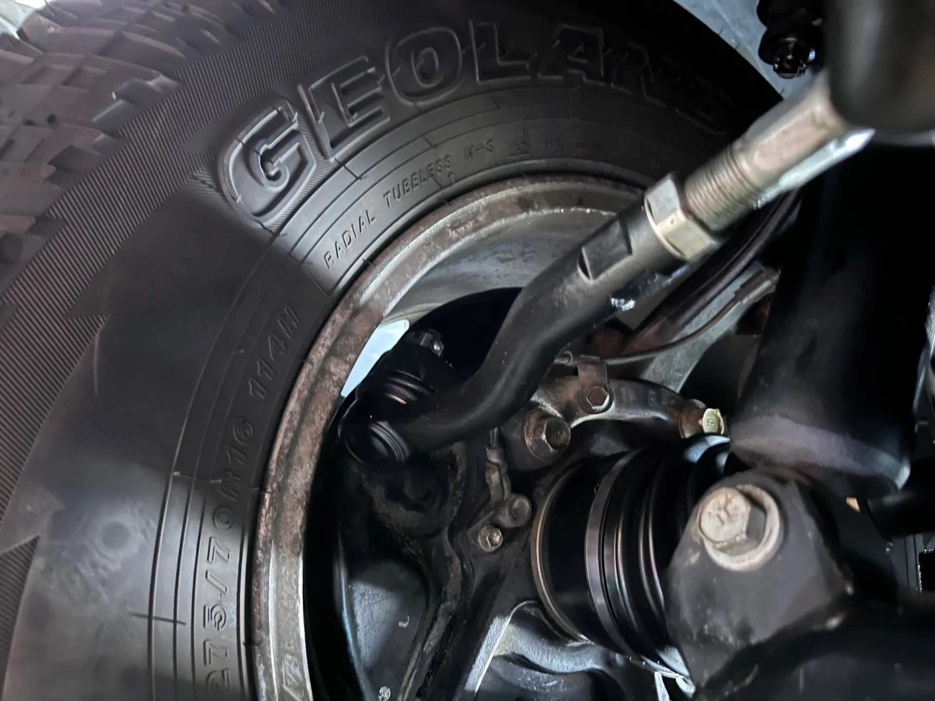

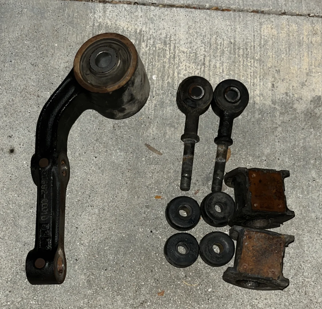

Replaced the
-All brake pads with Akebono Pro ACT Ceramics
-front diff side arm
-UCA boots with the Toyota boot kit
-sway bar links, cushions, d bushings
-Tie rod ends to fit my new OEM rack from Bell Lexus’s last cyber monday sale.
Replaced the front diff side arm, sway bar links, cushions and d bushings.
I did my sway bar bushings as well this weekend as part of replacing the drivers side axle and abs sensor that I trashed taking the axle off. I curse where they put the bolts to get the sway bar bushing off. Mine were original and very, very rusted. I used a torch to heat the bolt until they glowed and a special rusty bolt socket to get the top one off. I replaced it with stainless bolts, but that was a huge pita.

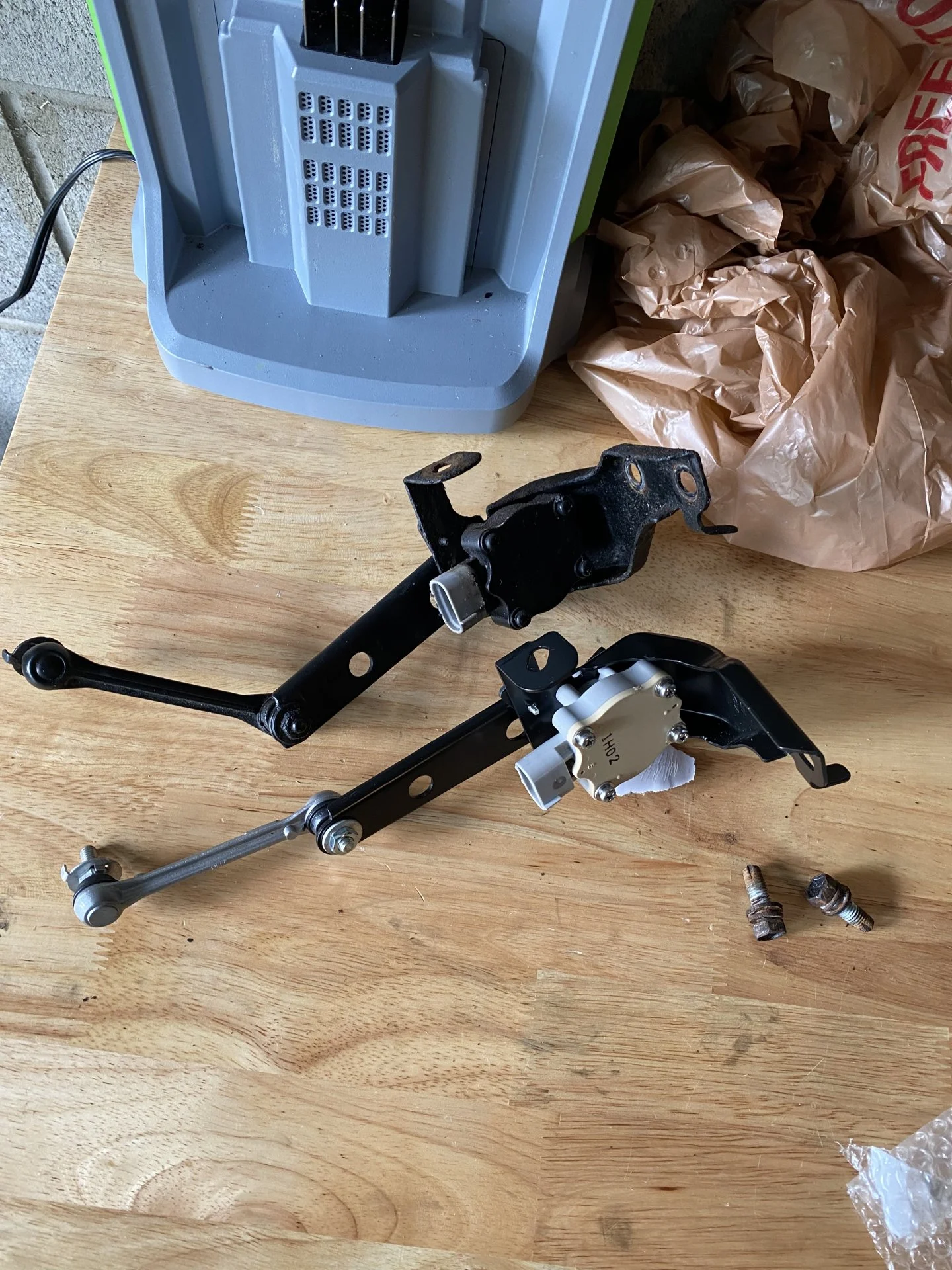

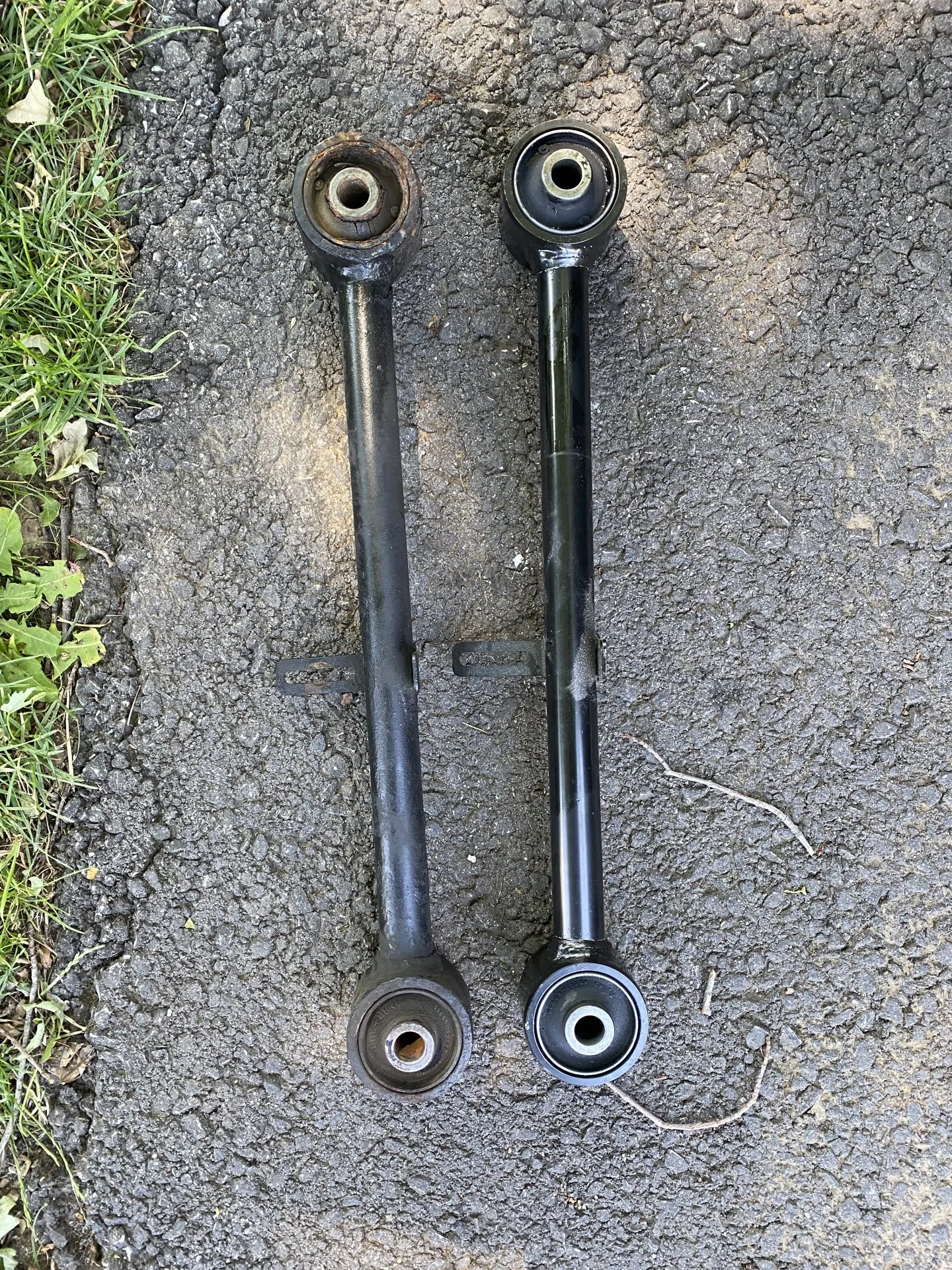

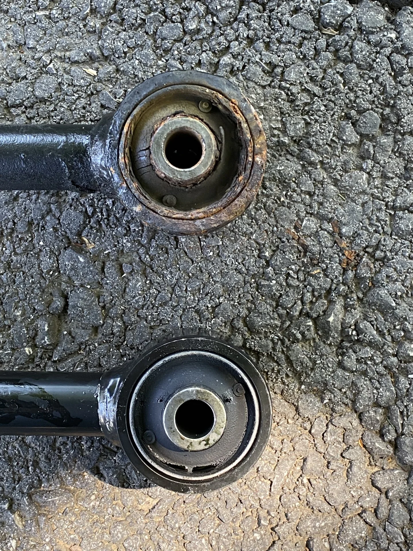

Finally got the new rear upper control arms (UCA) in that have been sitting in my garage since last summer. The old ones were pretttttty beat up.
A little tricky getting the passenger one in, had to ratchet strap the axle backwards and bottle jack the axle up a little bit to get it to line up.
I must have messed something up with the AHC sensor as it shows in Techstream as 7.2 on the rear sensor at all times and the AHC is blinking OFF while I drive. Code C1713. The arm must be stuck or not moving. I have a back up sensor but I have a feeling it’s something small.
Also my oil temp sensor is out (C1719), I wonder if I never reconnected it after my last AHC project 🤔.
Oh and new spare tire carrier, sans key. Do most people use keys? Mine was beat up.
Finally got the new rear upper control arms UCAs in that have been sitting in my garage since last summer. The old ones were pretttttty beat up.
I'd check the 50A fuse for AHC too!
I’ll take a look. I just find it weird that the sensor is throwing wrong numbers right after I changed the rear arm it connects to. Like I must have let it over extend or something? We’ll see. Good news is the dampening still works. Just can’t go up or down.
I really hope it is not that but at least once in the past my 20 year old rear height sensor stopped working when I replaced the rear upper control arm. Apparently it was on its last legs anyway but taking the arm off and moving it about accelerated its demise.
Good to know. I actually have a new rear sensor in hand but I was hoping I could keep what I got for now. Probably will end up just replacing

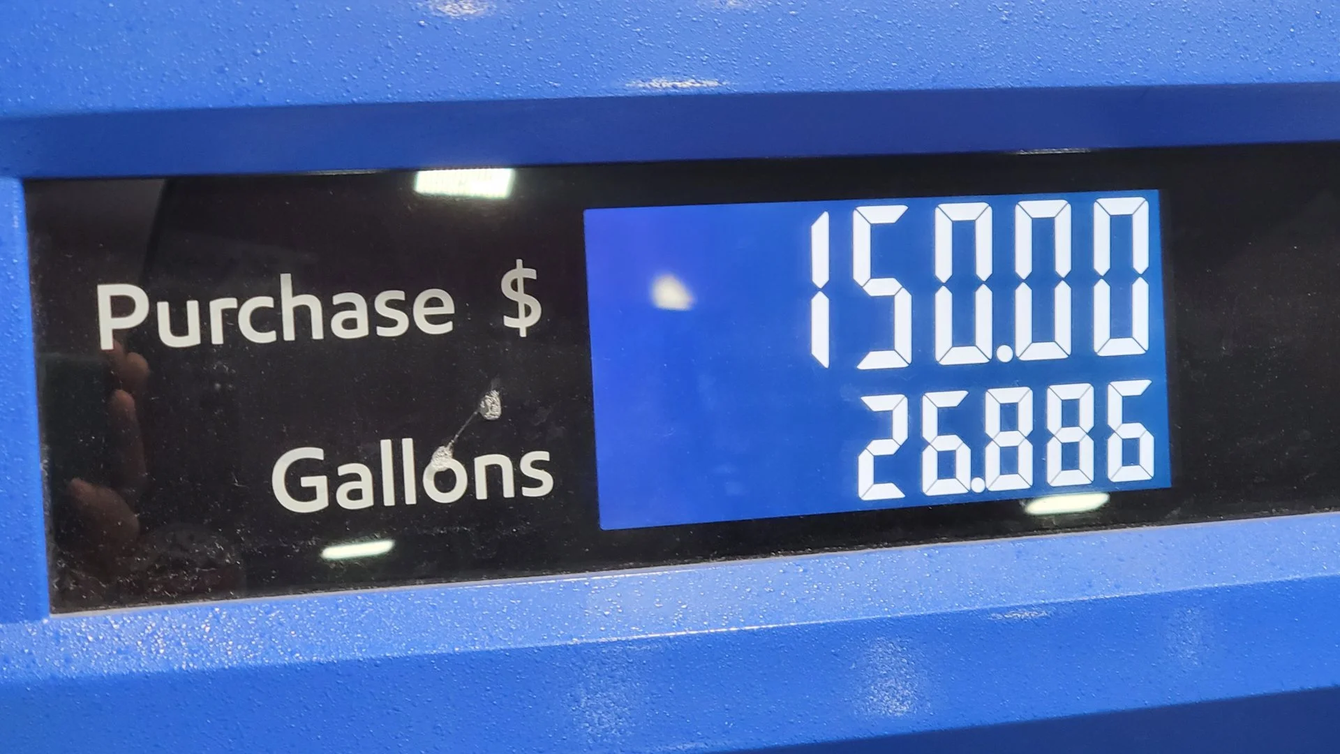

Tried to fill the 40G LRA tank but decided to stop at the max allowed by a single credit card swipe:

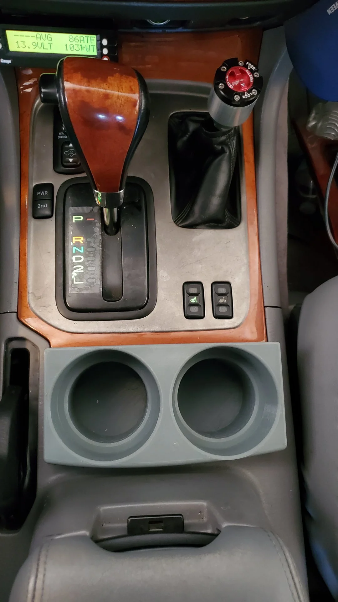

Then came home and added these cup holders from @CruiserDM. More details in my build thread!
Yup it was the sensor. Thanks for the info about yours. Made me feel better about just replacing mine rather than trying to diagnose. Also, I noticed my oil temp sensor was never reattached… been driving that way for months
