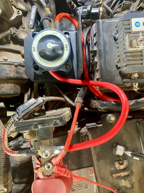

@mdcoa Awesome, thanks for the info! Do you know what the main dimensions of the bracket are? I couldn't find any listed on their site. I am looking for a mount to relocate my winch solenoid box to. Thinking I can use the circuit breaker cutout/holes to mount a blue sea cutoff switch for the winch and the solenoid box to the main section of the bracket. Just need to verify that the main section is large enough.

@saucebox I've had my eye on that as well, but given the dimensions, I don't believe it will fit both my Superwinch solenoid box and the cutoff switch I am planning. It looks like the OE mount @mdcoa used could accomodate both (crossing fingers it does). If it doesn't, then I may need both mounts!

The OE (not owl expedition—the other OE) mount is about 9.75x6” it’s got a jog in it so it’s not just a rectangle. Seems like a solenoid and a cutoff switch would both fit. Was already planning to mount a cutoff switch on mine, but haven’t gotten there yet.
Was also thinking of buying the owl expedition one for the winch cutoff—it goes in a completely different location so one could certainly run both….

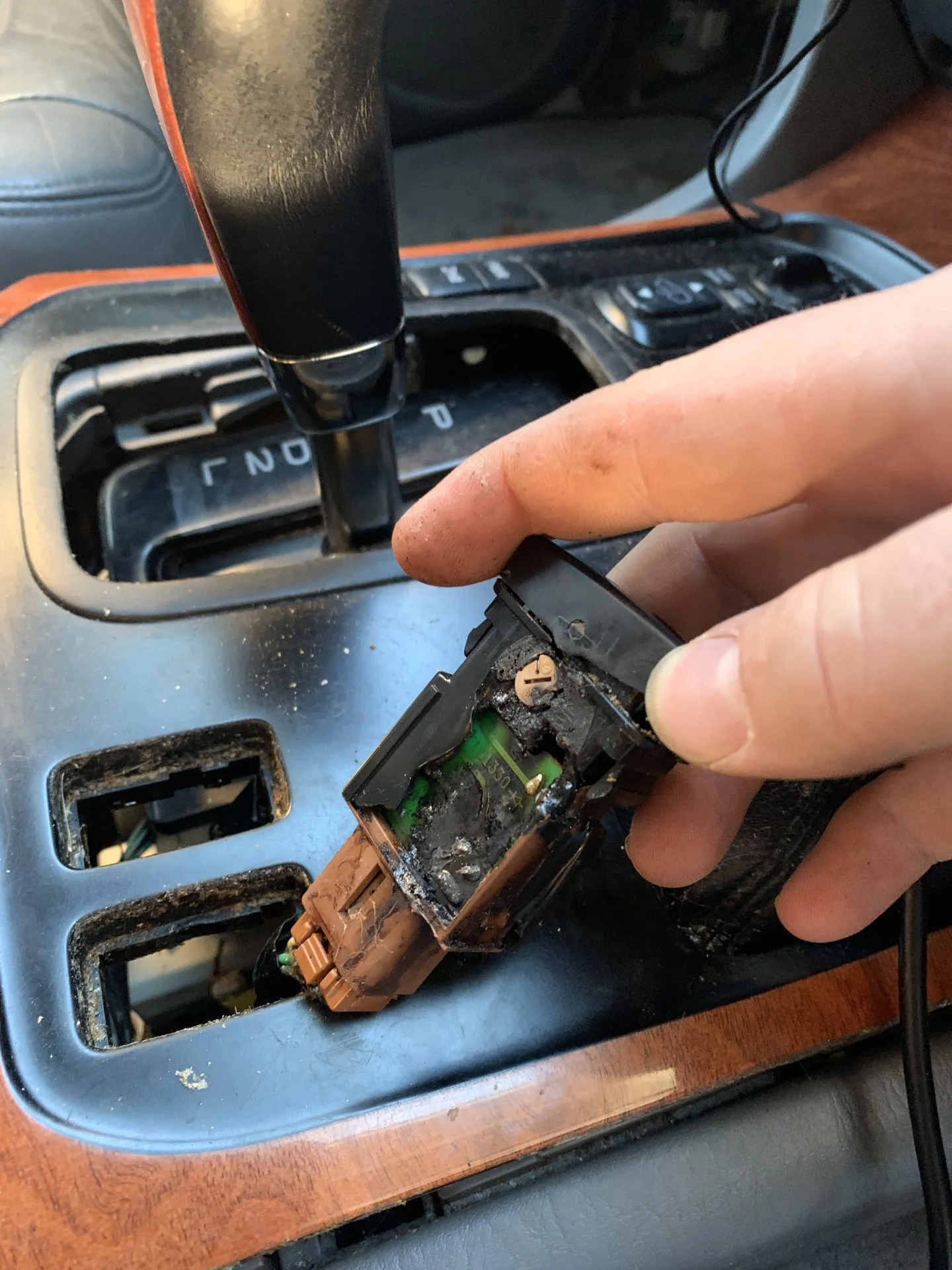

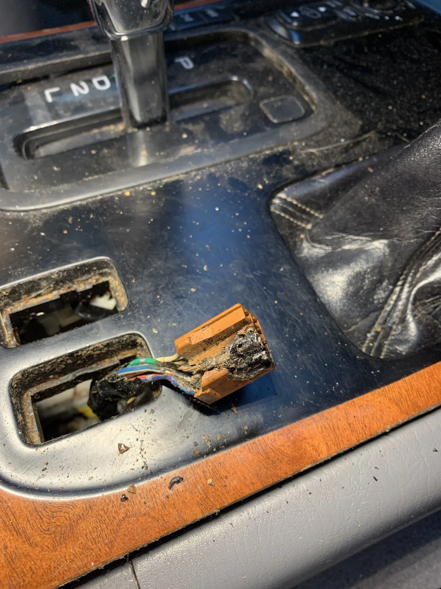

Never seen a better looking heated seat switch in my life, sadly the harness is fried too. Previous owner told me the seat heaters "didn't work.." 2 months later, I pull them and find the fuse was pulled on-purpose, and I found this.... Looks like little Johnny spilled his mountain dew all over this one a while back lol.

I'm pretty sure I have a spare heater switch knocking around if you want it. It'd be somewhat involved to re-pin those wires on a new plug, but certainly not impossible.

Much appreciated, I already bought a new switch which i popped in there not plugged in for aesthetics. Do you have the plastic connector that I could re-pin my wires into? Really all I need is the male end of the connector that goes into the switch itself..

I can look, but I doubt it. What I have came from an eBay console purchase, to replace the one I scratched all to hell. Seller just left in the switches.
I think you'll need 90980-10797 (DS) and/or 90980-10996 (PS) plus a handful of the pre-terminated wires from the dealer. They'll clip into the new connector and then it's just a quick solder job to wire them into a clean portion of the stock wires. It's been a minute since I was in the EWD, so I can't quite locate the part number for the wires.
Edit: I looked—no harness portions here.

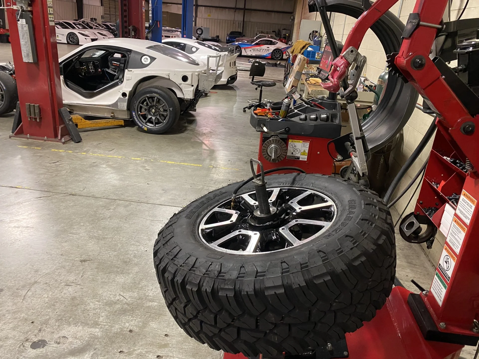

Mounted 275/70 Grabber X3's on my $150 set of TRD Tundra's yesterday (FB Marketplace Score).
I ordered Bora spacers Monday, but it sounds like I'm going to be waiting on them for awhile... I really want to knock the spacer/wheel install at the same time, but not if I'm going to be waiting a month or two...

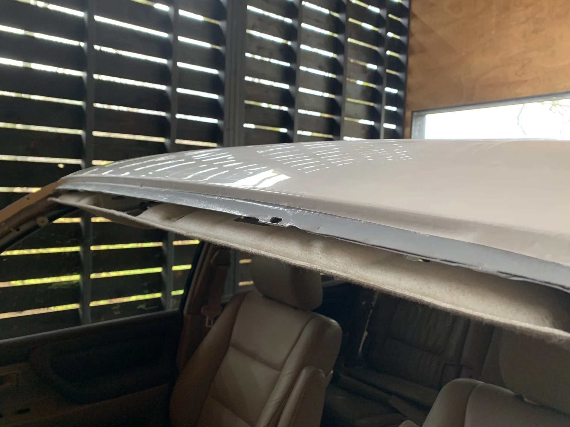

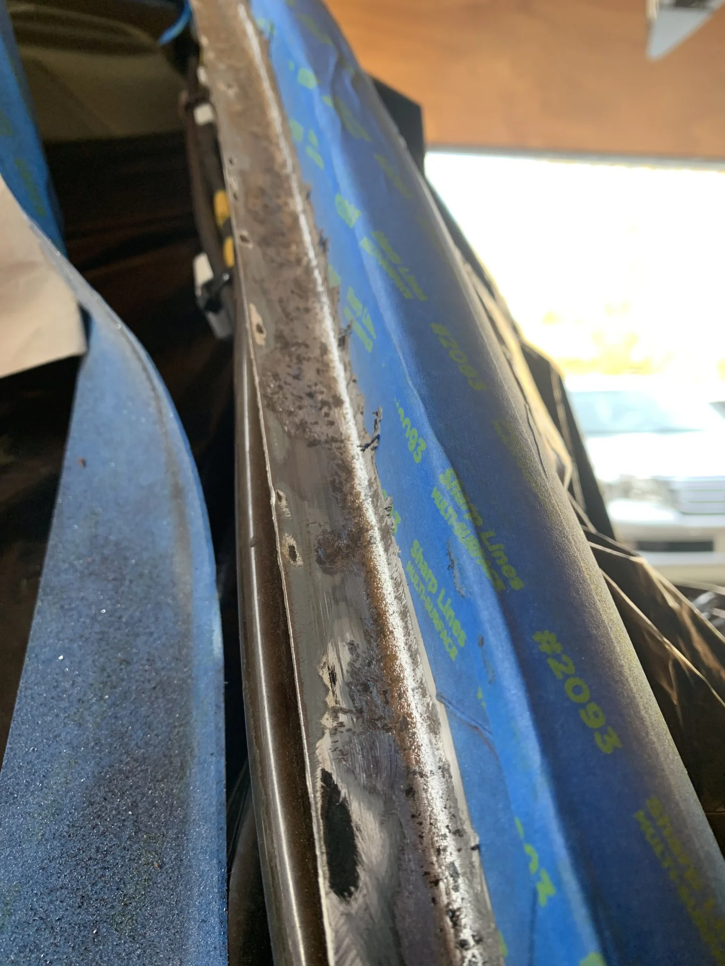

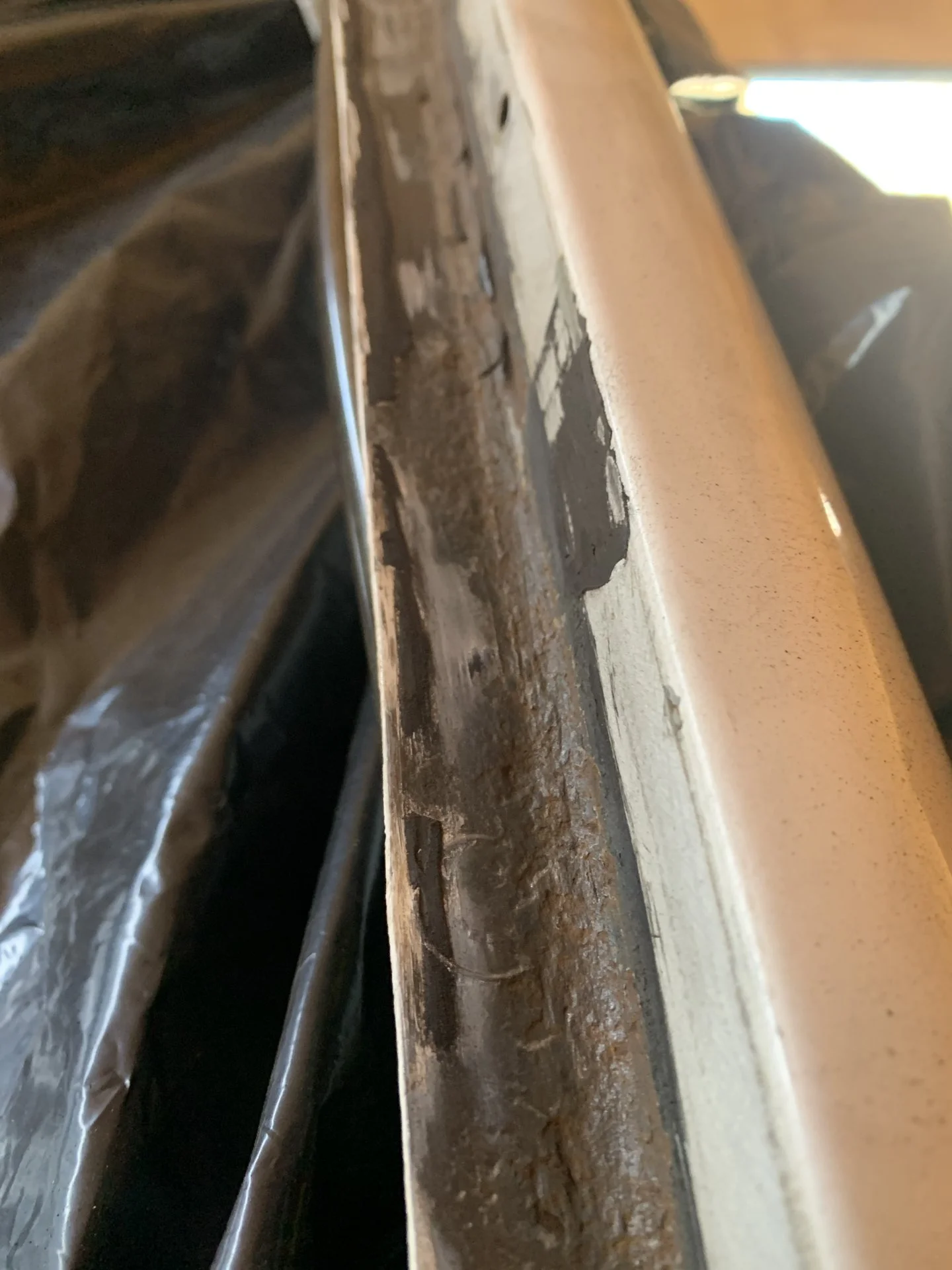

Tackled the dreaded windshield rust over the Xmas and New Year break. Windshield already had a crack from last year and couple small water leaks. Upon removing the windshield it was discovered that like most of these it was not done properly which in most cases causes the rust to develop, no signs of the oem dam and clips used. Also lucky that it hadn’t spread outside this area. Wire wheeled the loose rust, used some carbide cutters to lightly remove heavier spots, several applications of naval jelly and saran wrap over a couple nights to break up the remainder, and again with the carbide tools. Had a couple pinholes and used my welder to fill those in. Luckily I was able to get down to bare metal before removing too much of the base metal (forgot to get a pic of this). Epoxy primed around the pinch weld and top coated the trim mounting surface.
Nice job! A concern for every 100 series owner.

Thanks for the connector part #'s, much appreciated. There's gotta be a part # for the complete harness. I'll dig through some diagrams online, maybe I can find it.

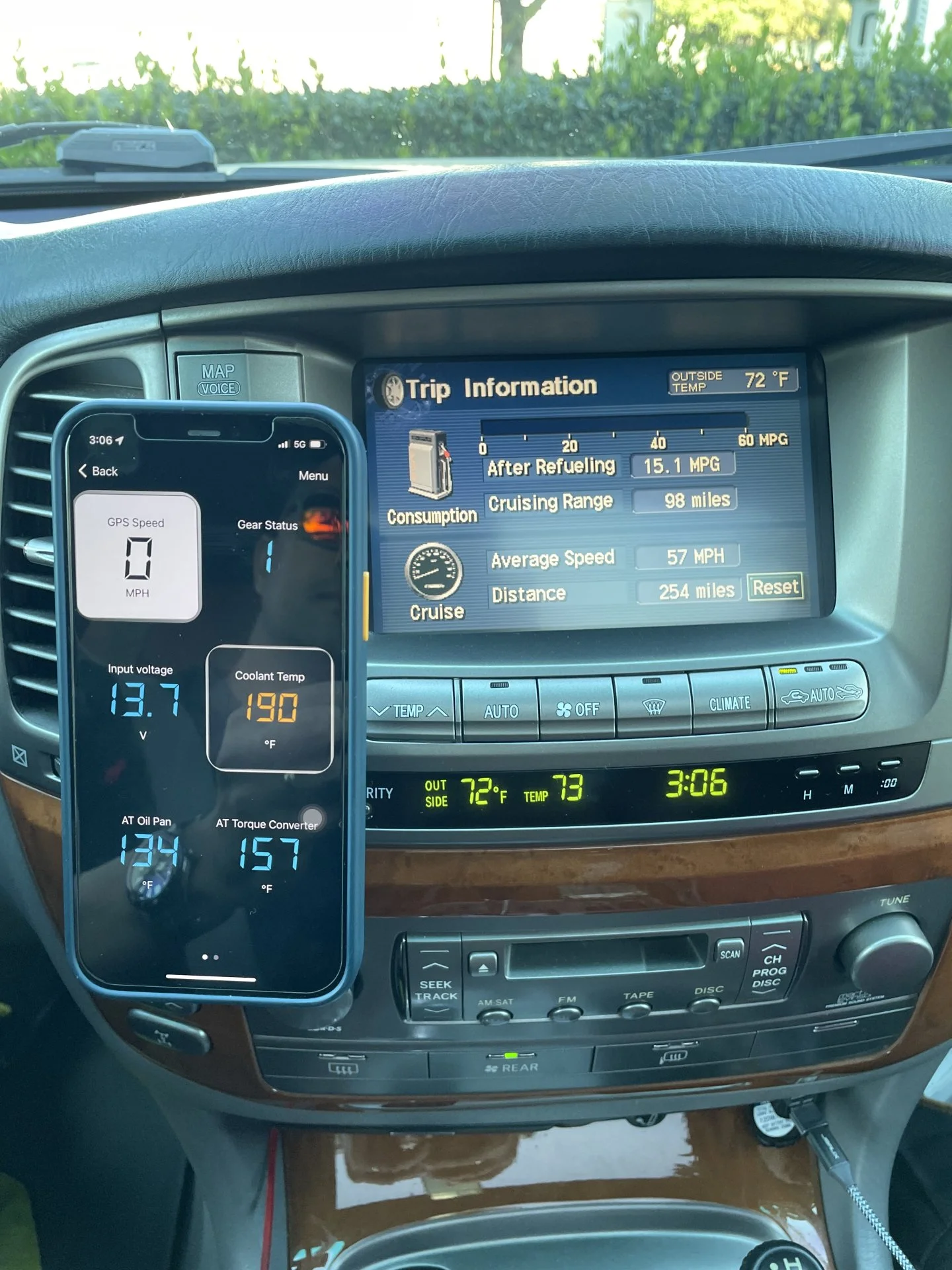

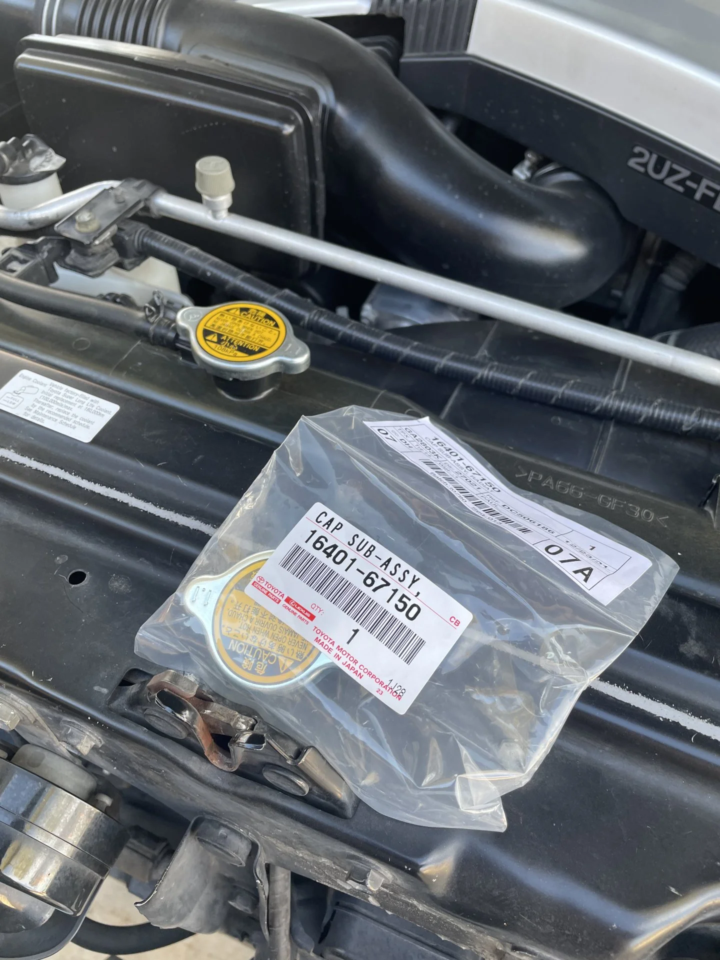

Quick escape from the dry cold of Vegas to SoCal, got to test the new oem rad cap
Readings seems to be okay
