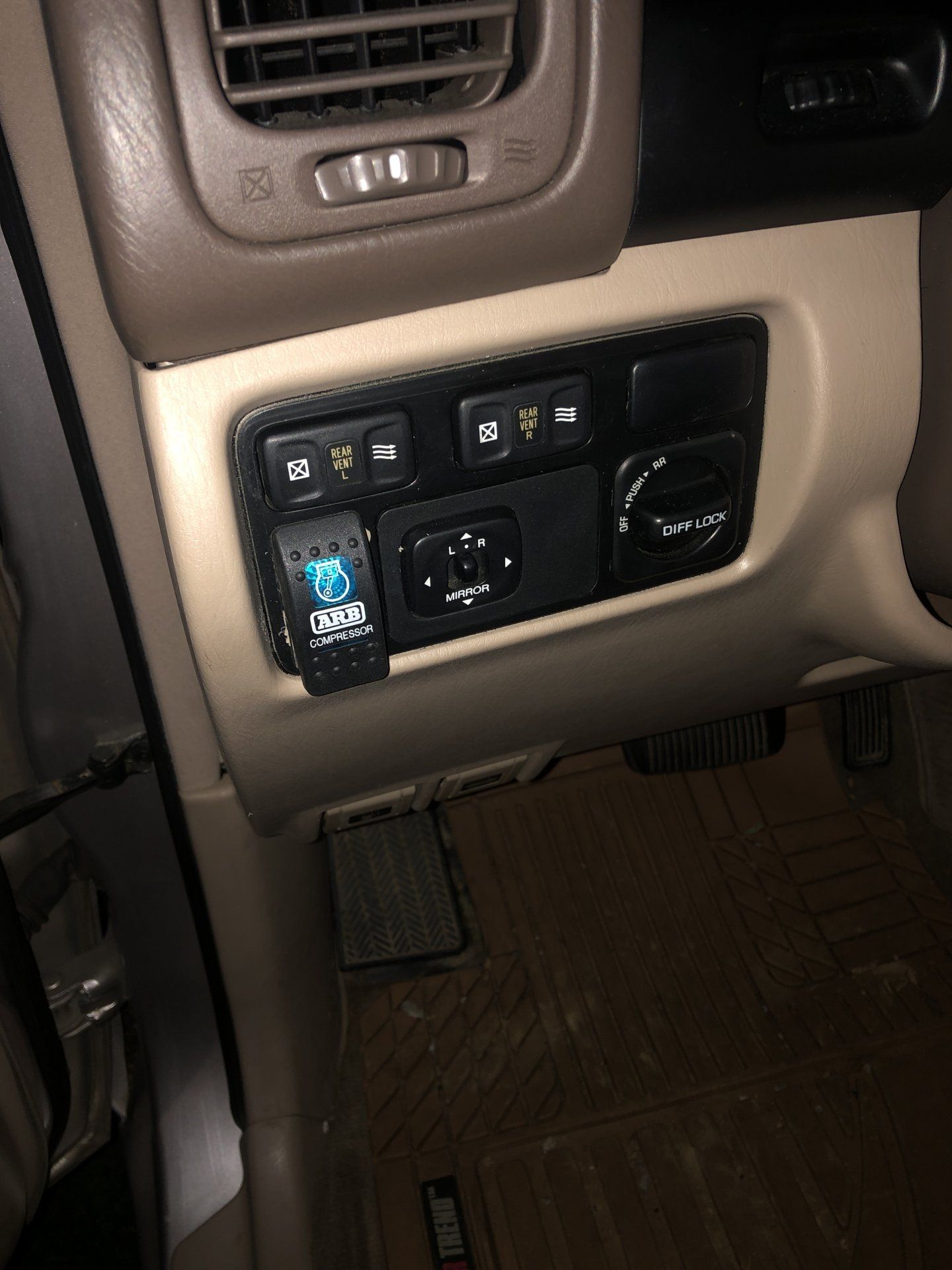

Bride has had the truck since we got it years ago. I dabbled with adding things but she told me to stop messing with her truck. I pulled stuff and put it into my pick up. Well, pick up sold and the 100 is passed to me. Reinstalled the red arc duel battery with optima blue top. Reinstalled the arb duel compressor and moved the switch to the dash rather than under the hood. Next up is figuring out where to breech the firewall to run two 4 gauge wires for the rear to service the refrigerator and cooking lights for the kitchen. Plenty to do, no time to do it.

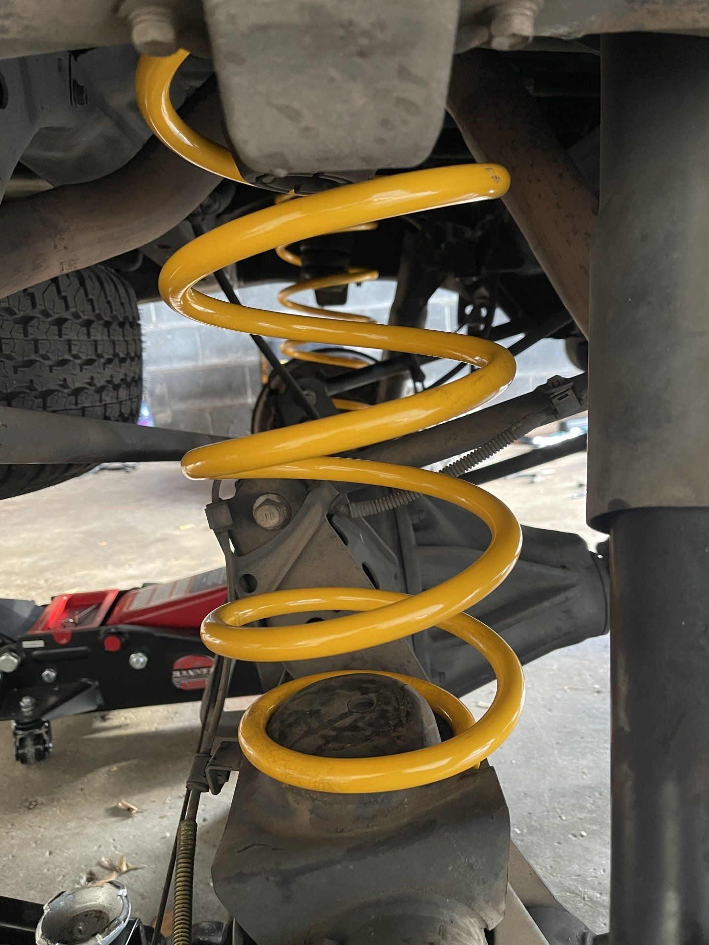

Put on Method 315s wrapped in 275/70/18. Slight rubbing on the plastic covering the pinch weld but I just used a heat gun to melt it back. Also installed King Springs and did a small sensor lift in front and out back. In front, I just moved the adjuster nut to the top of the slot; I didn’t touch the nuts on the heim joint. Appears to have netted an inch in front and back. No change in ride quality; have not checked pressures yet but I was just about in spec prior, so I’m thinking it’ll be the same or close.

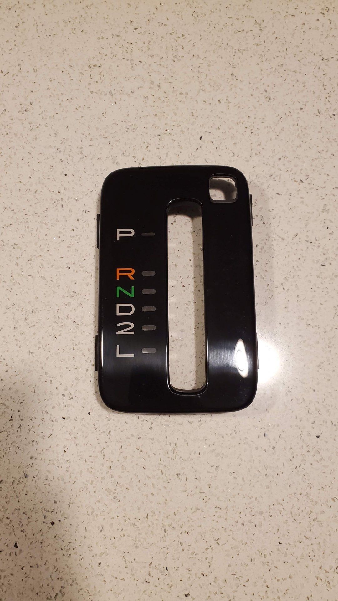

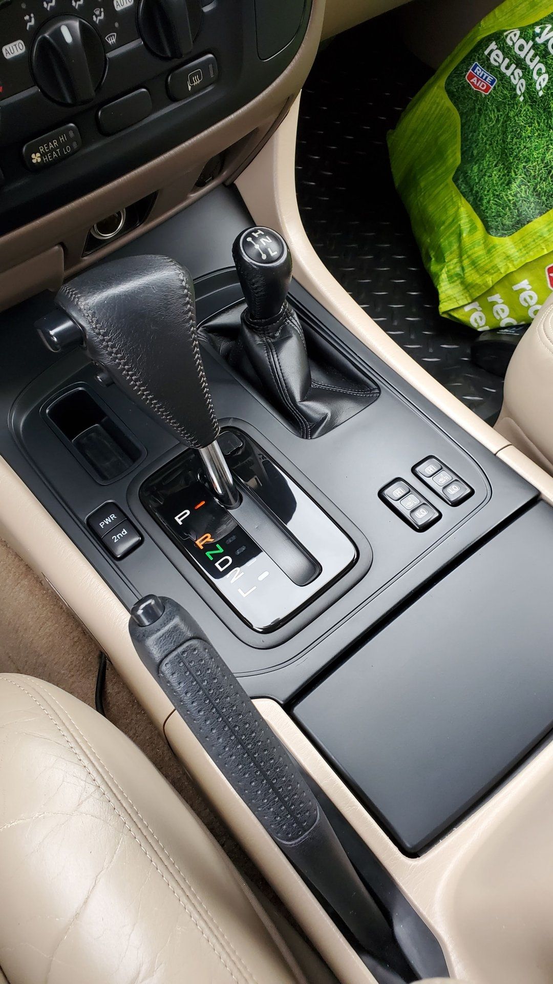

Installed a new shift indicator plate. Install was very easy (way easier than I thought it'd be), was in and out in less than ten minutes!
Part number 35921-60180, purchased from EB Toyota Parts for less than $130 shipped.
