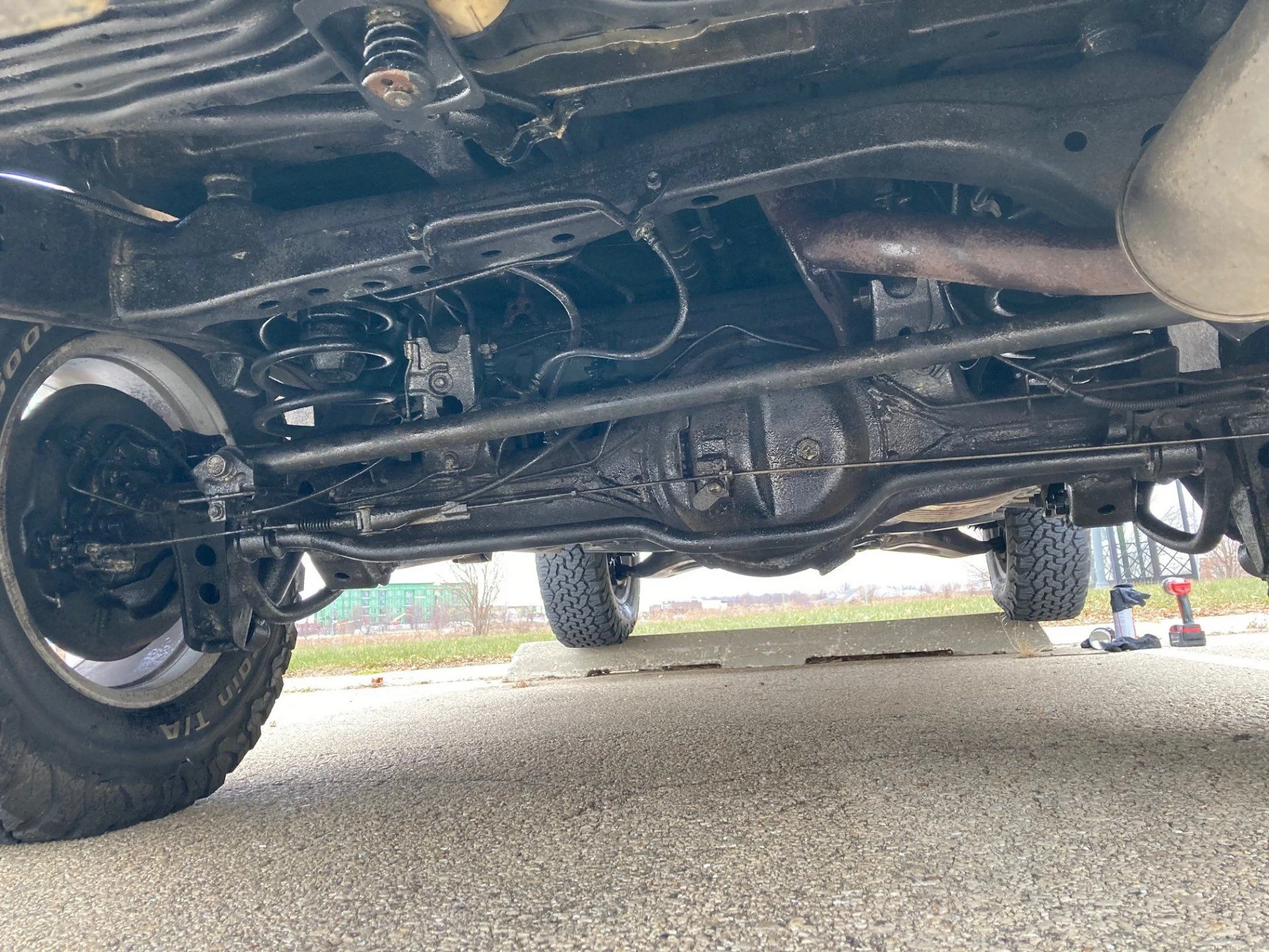

Per my usual late Fall/early Winter routine, applied 3 cans of fluid film to the undercarriage

Notice any change in exhaust sound? And drobe to speak of?
No change, at least that i can tell. Took my ever complaining wife for a drive and she didn't notice anything. I will be switching to a stainless steel setup from the cats back, including muffler in the near future as well. That might change the sound a bit.

Thanks for the reply.
It looks so clean tucked up.
This is on the short list. I had DT Catback but couldn’t take the drone at highway rpms
Keep us posted

I almost went with the Thorley system (had some nice headers on another vehicle a few years ago, loud and loved it). I decided to use a local muffler shop based on recommendations. With that said, the stock muffler without the resonator seems pretty quiet.

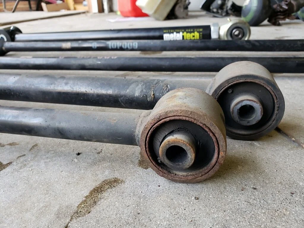

Drove truck in today after @Superdude gutted the AHC out for me. Front settled a tad, so i'll adjust preload on the bars this weekend. Truck rides great, had a rear trailing arm that had a chewed up bushing that was causing me a driveline clunk. All gone now with the MetalTech rear arms.
The suspension set-up (which was ordered for bumpers) is a tad stiff, but not uncomfortable stiff. Just not wallowy that the full soft setting was. Closer to the sport setting.

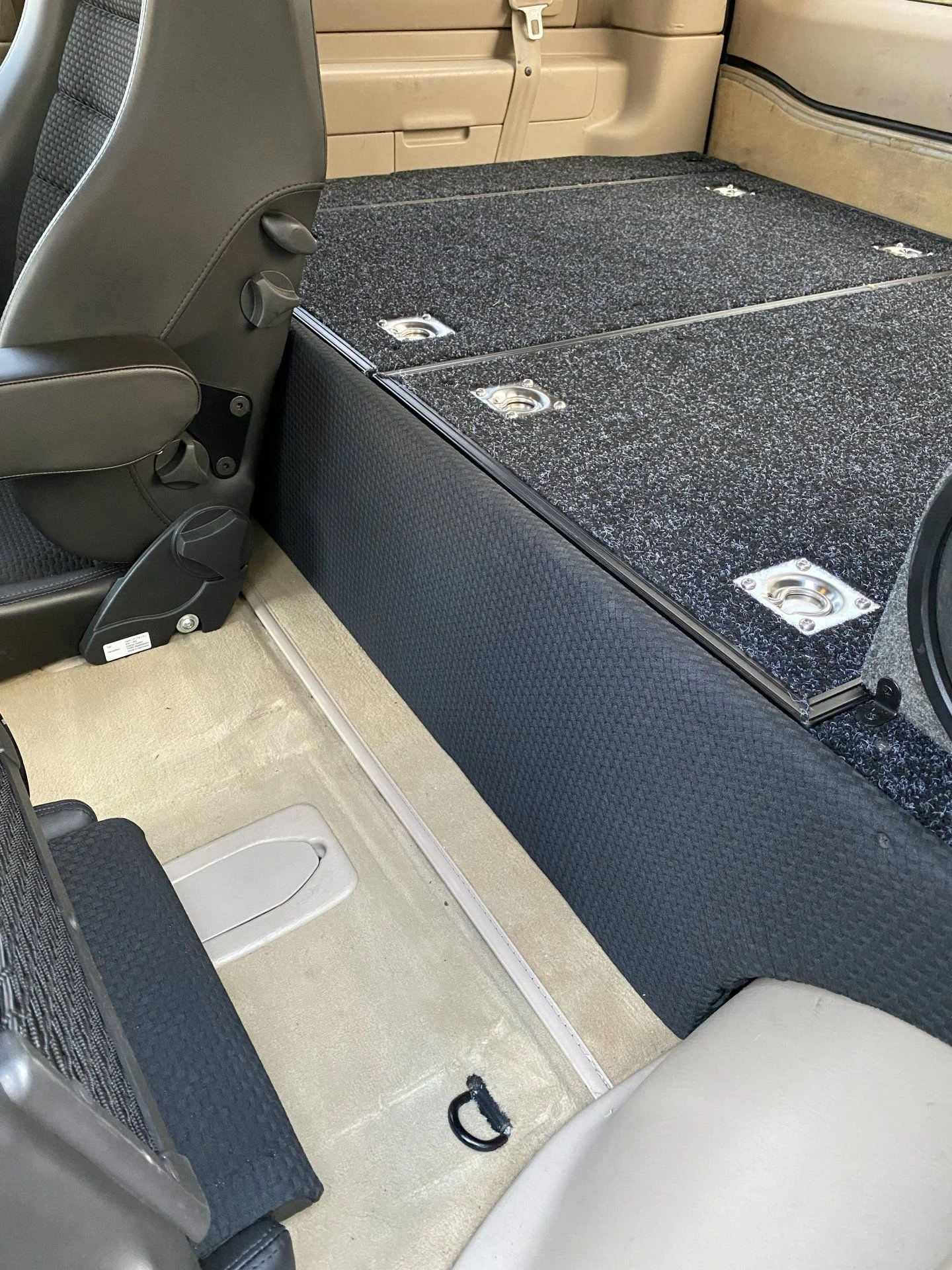

Hopefully later this month i'll get it into a friends shop to waterjet rear seat mounts.

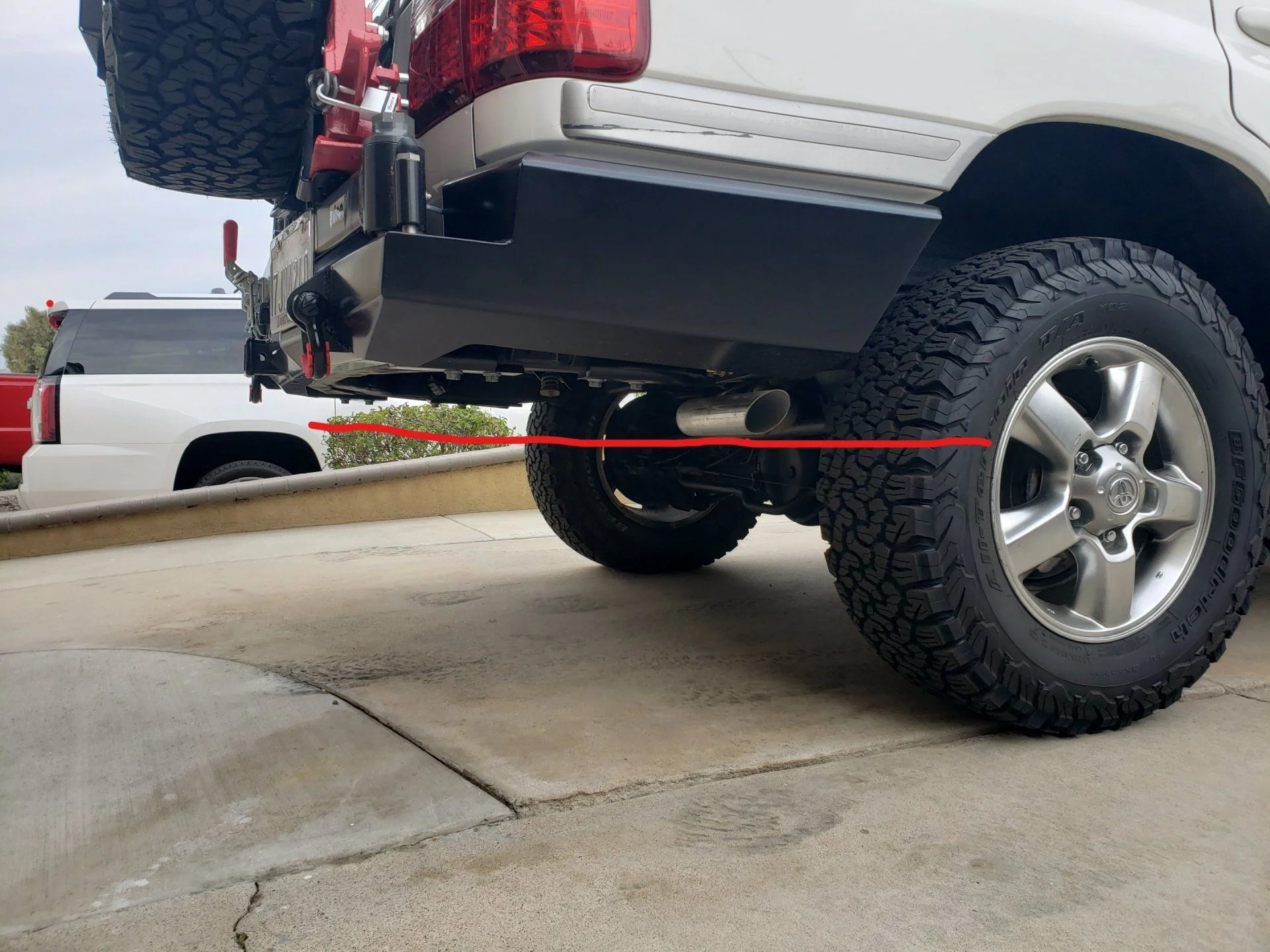

not sure where to ask but does anyone have a photo of what the stock angles of the CVs look like?
They should be very close to level all the way across at stock height.
