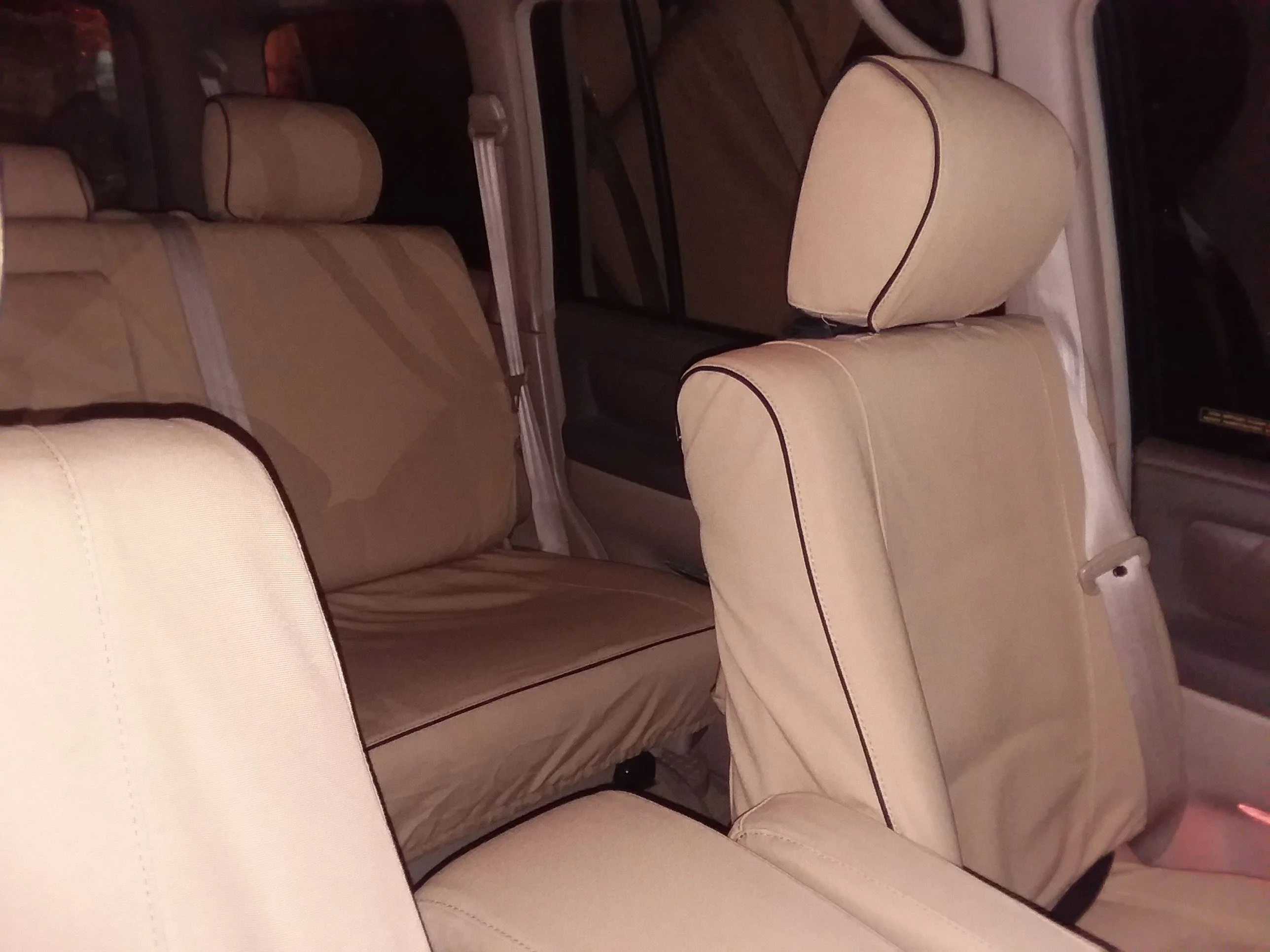

  • Installed Escape Gear seat covers - love them. Made from scratch and arrived from South Africa faster than I could get sliders from the west coast.

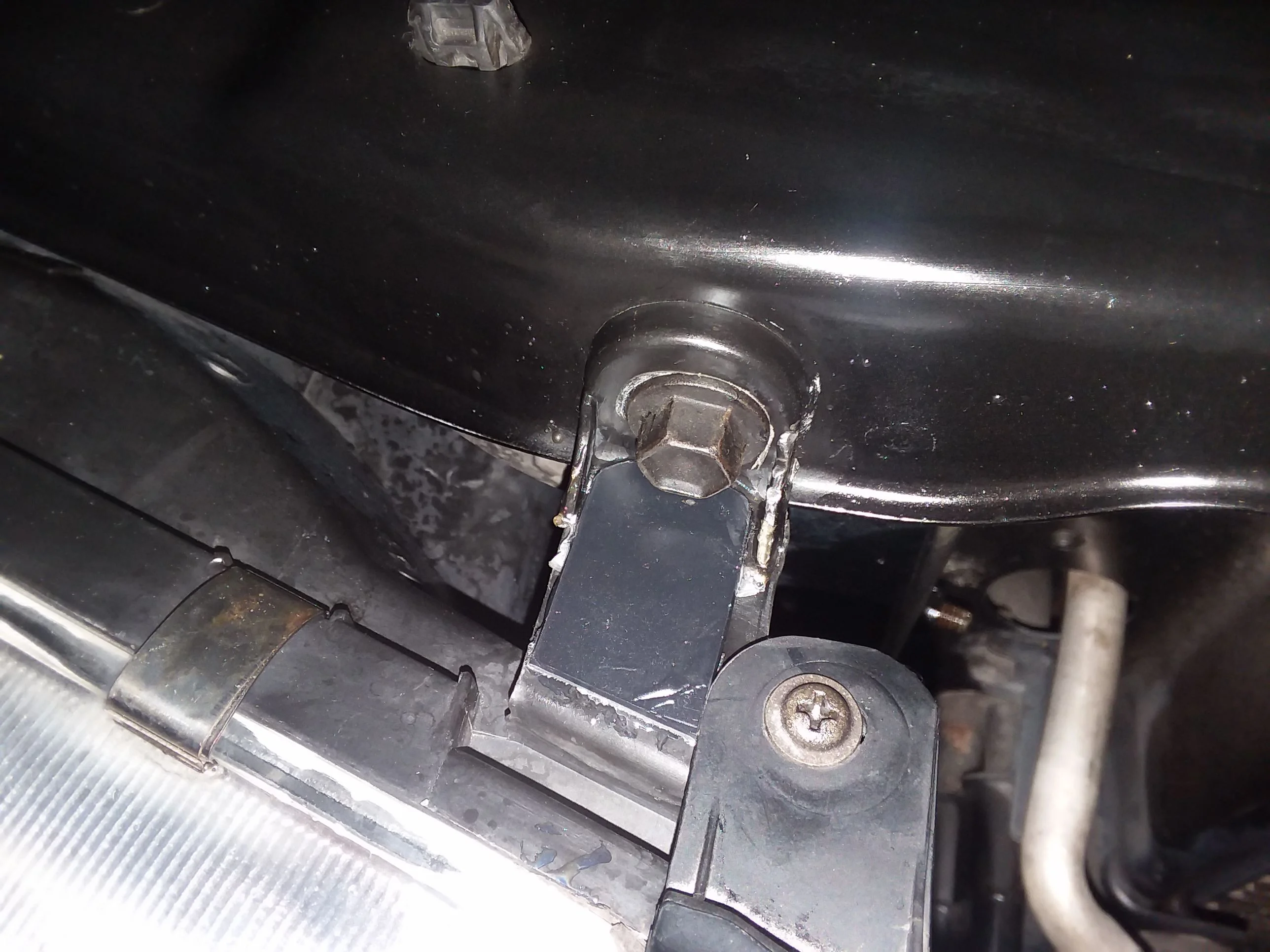

  • While taking off the grill I saw there were two broken headlight brackets on each side so reconstructed and/or buttressed the three worst using some Kydex and 5 minute epoxy.

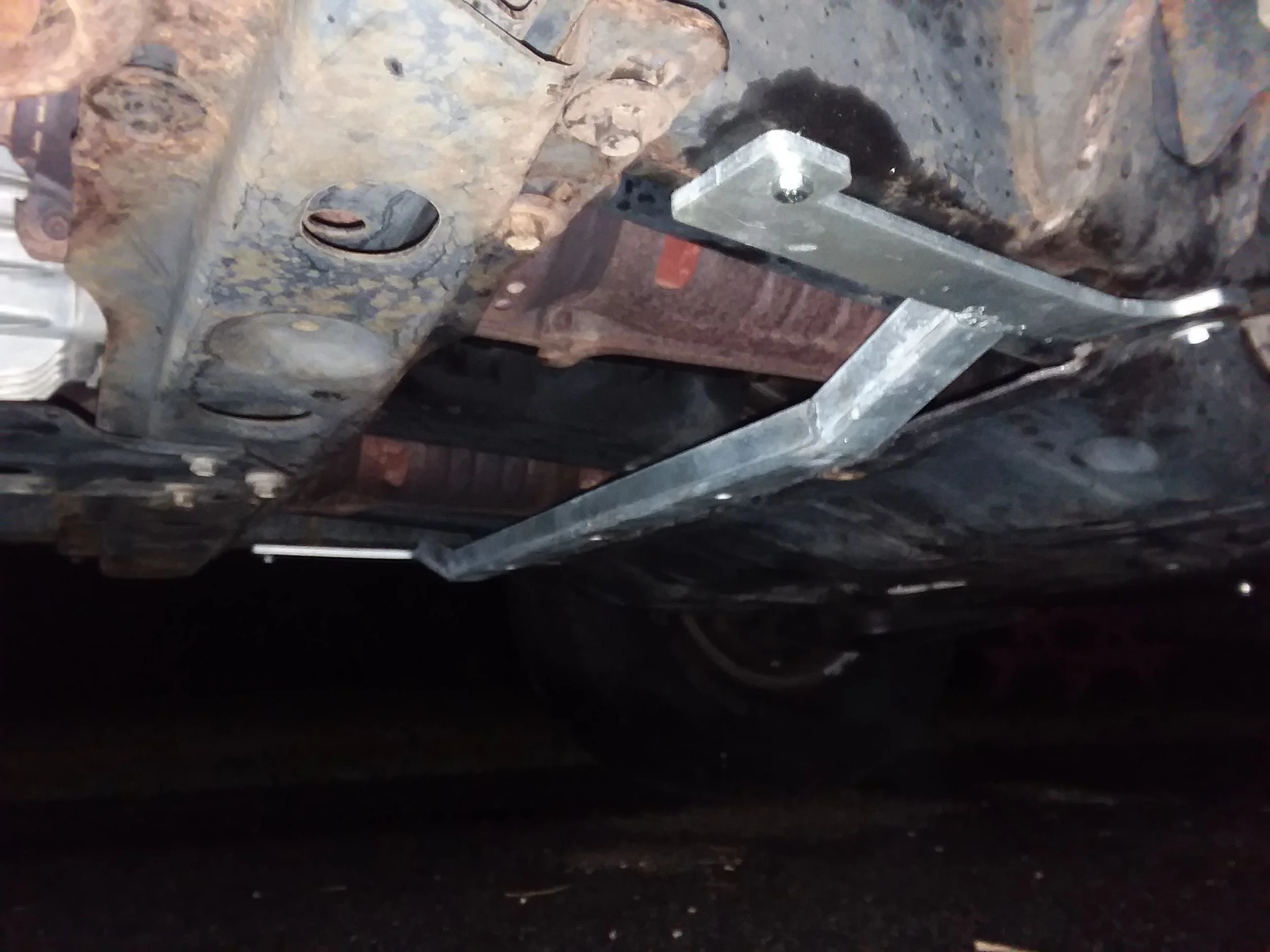

  • Installed the bracket for my ASFIR middle skid - cut back my factory skid a bit more and embedded *fiberglass into various spots on both hands. Went on much more easily than expected ~ that is to say it pretty much fit. Will massage one or two of the holes so they more exactly align.
